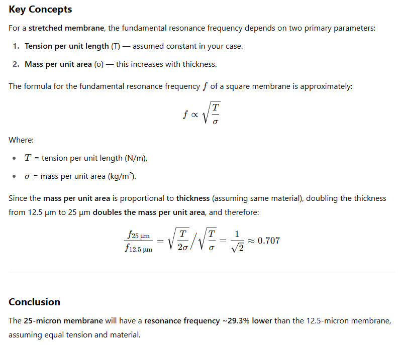

The main resonance on a double membrane electrostatic will be higher, not lower, this is easy to track on headphones.I remember Calvin writing about building double diaphragm els panels and that this setup would result in extended LF because the fundamental resonance frequency gets lower. I'm not 100% sure about this, for instance, would the resonant frequency be comparable between a double diaphraghm esl and a similar, single diaphragm panel which is double in height compared to the double diaphragm panel?
The thicker Mylar gives smaller compliance at same mechanical tension. It rises the resonance point, because the moving air mass a lot of bigger than the membrane alone. The additional mass of 25 micron mylar (instead of 12) is neglible at bass panel at basal resonance frequency.If it's a completely separate diaphragm, you could also try thicker Mylar for the bass section to decrease resonance frequency.
My AI friends and the books I have handy suggest that compliance changes related to thickness are not a significant factor affecting fundamental resonance in thin, tensioned membranes. They all include mass, tension, and size/shape though. When prompted for identically sized and tensioned membranes but of different thicknesses, ChatGPT simplified the relationship to this:
The basic relationship agrees with what I'm seeing elsewhere, though the equations are more complex if you want to calculate everything.
When prompted specifically about compliance related to material thickness, Gemini said: "Generally, the effect of increased mass due to thickness increase is more significant than the effect of decreased compliance, leading to a lower resonance frequency for thicker membranes."

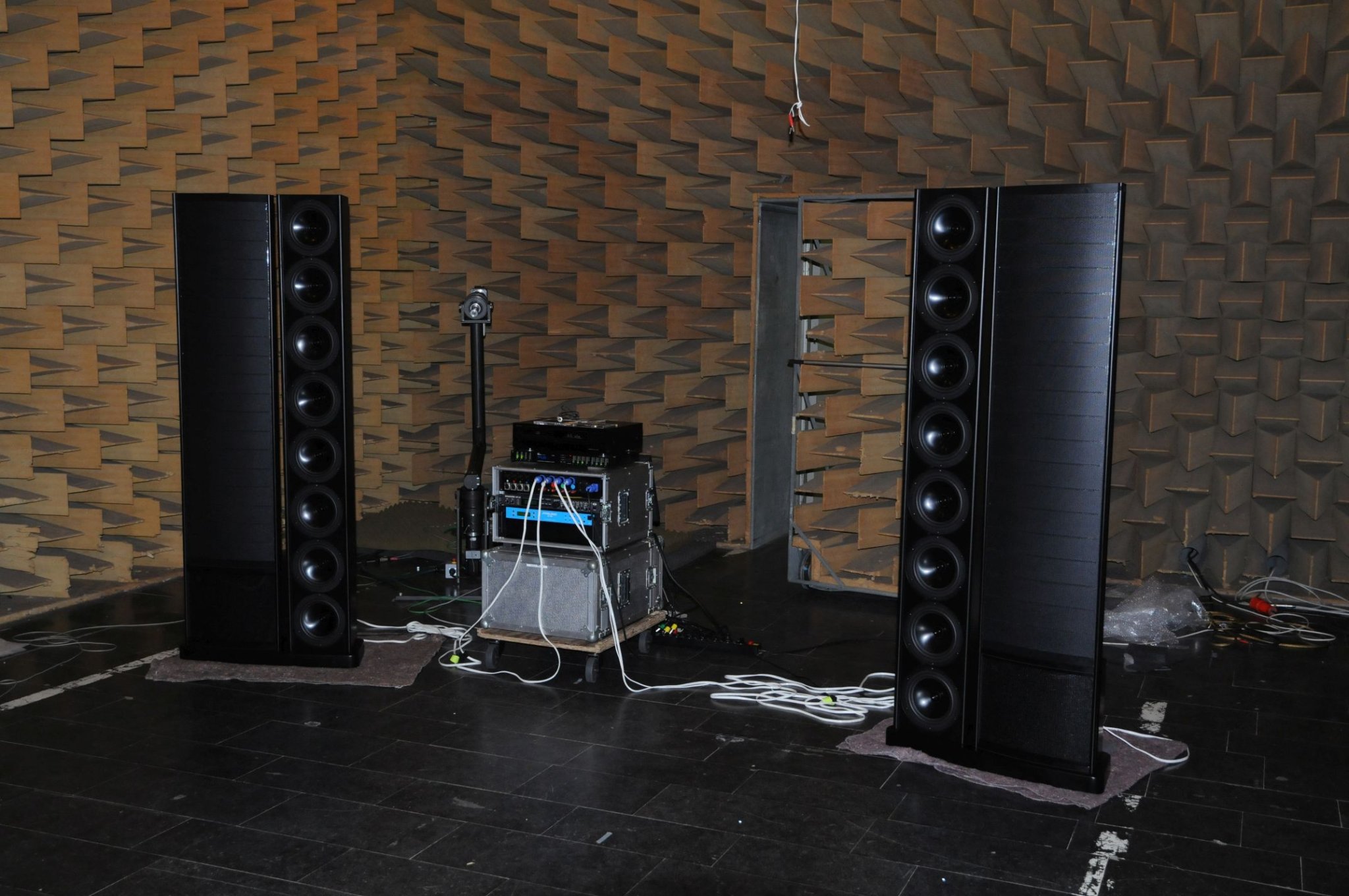

When fudging around with the XOver just make sure that the acoustic filter flanks are symmetrical.
If the XOver falls between 100Hz-200Hz You can just stay away of, resp. stay between the panel´s diaphragm resonance (lower) as well as the dipole array´s upper chamber resonance (higher).
Both resonances manifest as peak in the amplitude response with elongated decays.
While the amplitude response may be equalized the decay may remain recognizable.
Sharp notches -which are easy to implement with DSP filters may take care of that problem (as an electronic alternative to mechanical damping with mesh or cloth).
I try to xover around 170Hz-220Hz, which allows for panels with tight tensioned diaphragms and small d/s (<1.5mm), resulting in high efficiency (well above 90dB@4m) and stupendous dynamics, and at the same enough ´distance´ to the dipole bass´ chamber resonance (300Hz).
jauu
Calvin
ps. attached pic was taken in 2008 at Aachen University. The first big ESL prototype. Measurements by Prof. Anselm Goertz using their MonkeyForest/HD2 measuring and DSP-FIR/IIR-processor combo and Crown PA-amplifiers. After the digital ´signal conditioning´ major parameters like amplitude and step response were almost textbook ideal like. Sound: .... one of a few WOW! moments.
