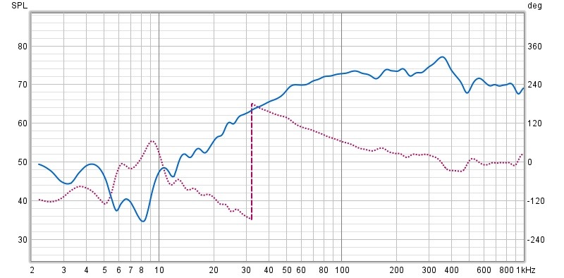

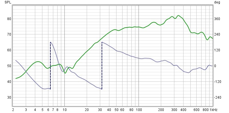

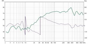

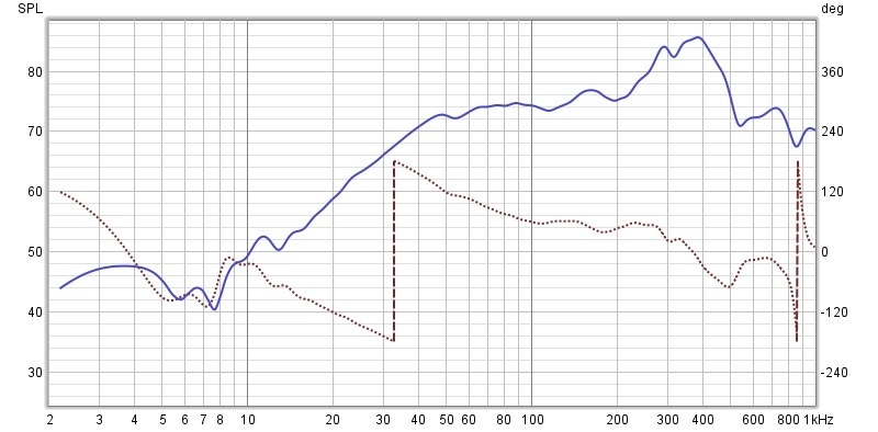

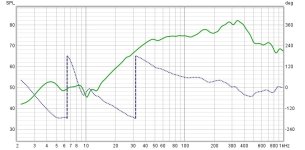

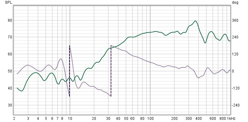

Here are some images of the measurements of the tapered u frame baffle:
front without stuffing
front with stuffing
rear whithout stuffing, phase inverted
rear whith stuffing, phase inverted
the measurements (nice job btw) prove the effectivenes of the damping where it´s required .... to get rid of the chamber resonance peak in the upper range between 200-400Hz.
Amplitude as well as phase response clearly profit from the appliance of the damping material.
Below 200Hz almost no damping material will have an considerable effect ... the mecanical dimensions are just too small.
So the useable upper bandwidth limit should not surpass 200Hz too far.

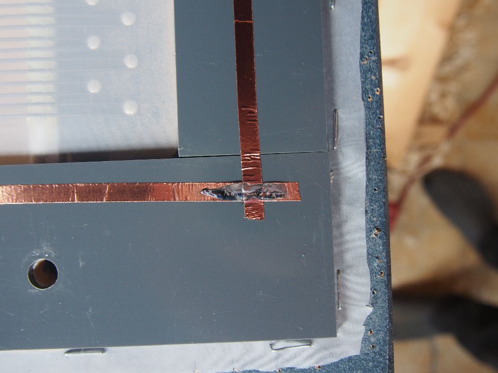

Hi all,

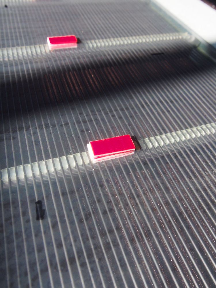

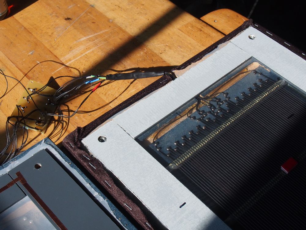

about 2 - 3 months ago, one channel of my stats got much lower sensitivity... I was unable to compensate with my DSP. So I built a pair of simple OB speakers, which sounds fine, but I miss the sound quality of my stats.
I ruled out the high voltage supply and the external resistor network. So it must be in the panel itself. Fortunately, I made everything dismountable / removable.
There are no hissing noises like my previous stats, since I use meshes on both front and rear of the panels. I would expect the cause beiing some leakage of hv, but not sure. I have to investigate...
I talked to a former Quad ESL owner, who told me he had to replace his diaphragms after only 2 years. I heard many more similar stories about stats losing their sensitivity. I'm wondering: are these examples of design errors, or is it something inherent to stats running on hv?
Use a simple neon oscillator to check the current draw of both panels. That will tell you if they are leaky.
What coating did you use? It is not uncommon that the coating looses conductivity over time. Try breathing on the membrame while it's playing. The moisture in your breath will temporarely increase conductivity. If this results in increase in volume your coating is eol.

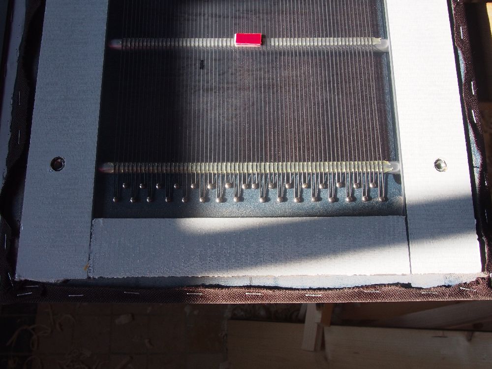

Hi, first of all, thanks for the good suggestions! I just opened the stators this morning, and I was surprised how good they stil look after 2 years of use: optically they look clean and like new!
I just cleaned some spots with alcohol, just to be sure. But I didn't see any strange things. I have an external pcb with resisors for electrical segmentation. About 1,5 years ago, I put some super glue on 1 spot because it arced, creating noise / flashes. Since then, it functioned correctly. I detected a lot of dust on the pcb, so I cleaned it, together with everyting in the electronics box. Unfortunately the panel plays still way too soft.
I will try the moisture / diaphragm / coating test! I use a proprietary caoting by M.J. Dijkstra. If the coating would be the cause, I would expect the other, well functioning panel, to have the same issue?
I have neon oscillators on the HV pcb's, and it does't have a higher blinking frequency, so this gives me the impression it could be the segmentation resistor pcb. I will short all segments, bypassing the resistors, to see if there are connection errors here. (I already measured all resistors which measure ok).

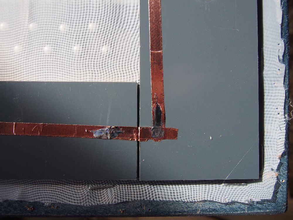

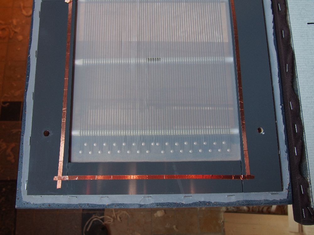

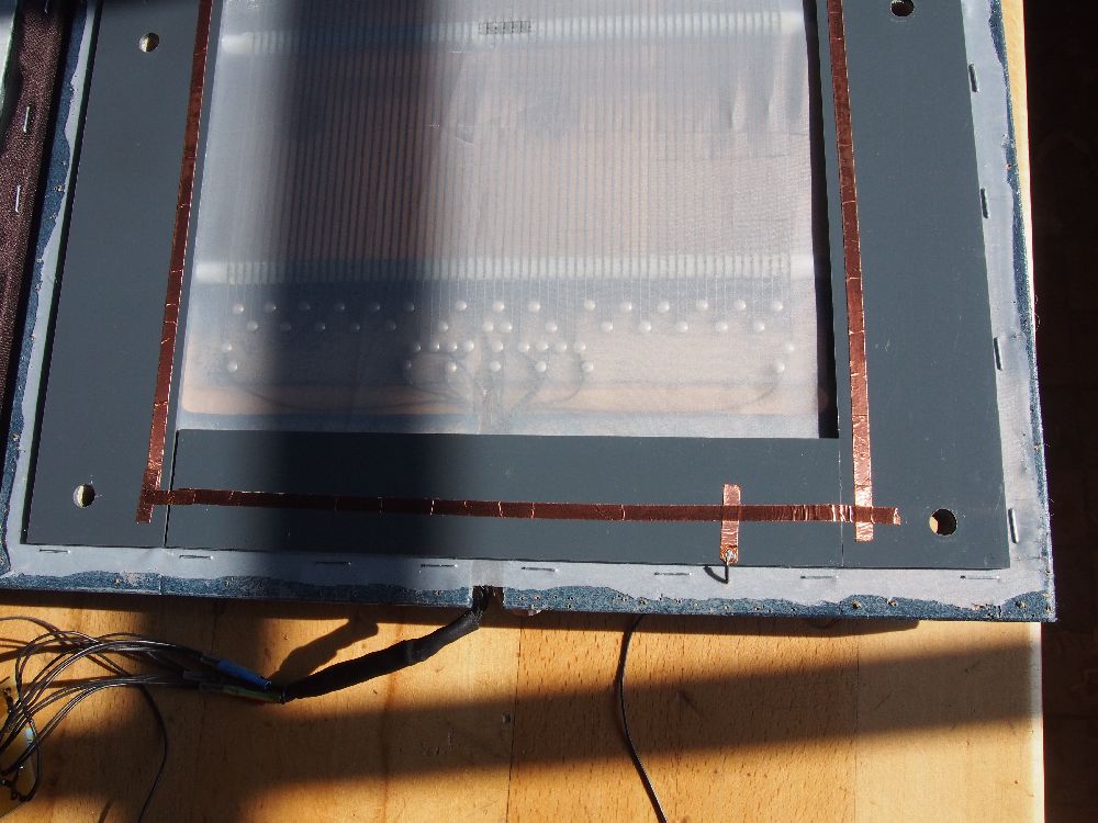

@mattstat: my stats are built als follows: both stators are MDF frames, and on both inner sides there is a pvc sheet around the perimeter for electrical insulation from the MDF framing. One stator has a mylar diapgragm glued to it, using double sided floor tape. Although this doesn't sound high-end, it functions very well! It was a bit of a risk to try this, but it still works well after > 2 years of use.
On the mylar film is the propriety coating by M.J. Dijkstra, pointing towards the copper strip on the other stator. The other stator has a 5mm (?) wide, thin, copper strip, which is thin. It consists of several seperate parts, taped over each other(overlapping), in order to make eletrical contact. It makes pressure contact with the mylar.
Yesterday I managed to solve the problem, which is something I didn't expect! I started measuring the copper ring by connecting the digital multimeter on the connection wire which is soldered at 1 point on the copper ring. I put the other DMM wire on several other points of the ring. At about 60-70% of the measured points I measured a infinite resistance. So I cleaned it with vinegar, as this should remove copper oxidation, if I understand correctly. I also soldered all overlapping copper tape strips, and made the solder also as thin as possible, which was not difficult as it spreads easily across the copper surface.
I assembled the stats again - I made everything removable / detachable, so in about 10 minutes I can (dis) assemble one stat, which is very nice and practical!
Unfortunately there was no noticable difference in sound pressure (sensitivity).
Then I decided to re-apply a new layer of coating on the diaphragm. This made a big difference: the panel plays as loud as the other panel again!
I didn't made sensitivity measurements, unfortunately.
This leads to the question what would have been the cause of this error? Was it only the coating near the small copper strip, or the whole diaphragm area which was affected? Was it only a mechanical problem (both stators not making good physical contact), or something else, like interaction of copper oxide with the diaphragm coating?
@neodymium: unfortunately not at the moment, as I don't own a HV probe. But maybe I can make a HV probe? I do see an increase in neon flash light flickering frequency after applying the new layer of coating.

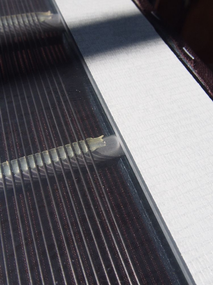

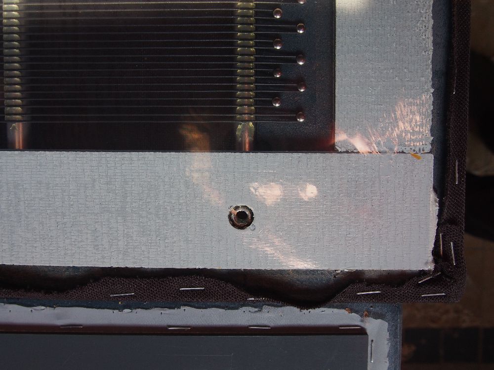

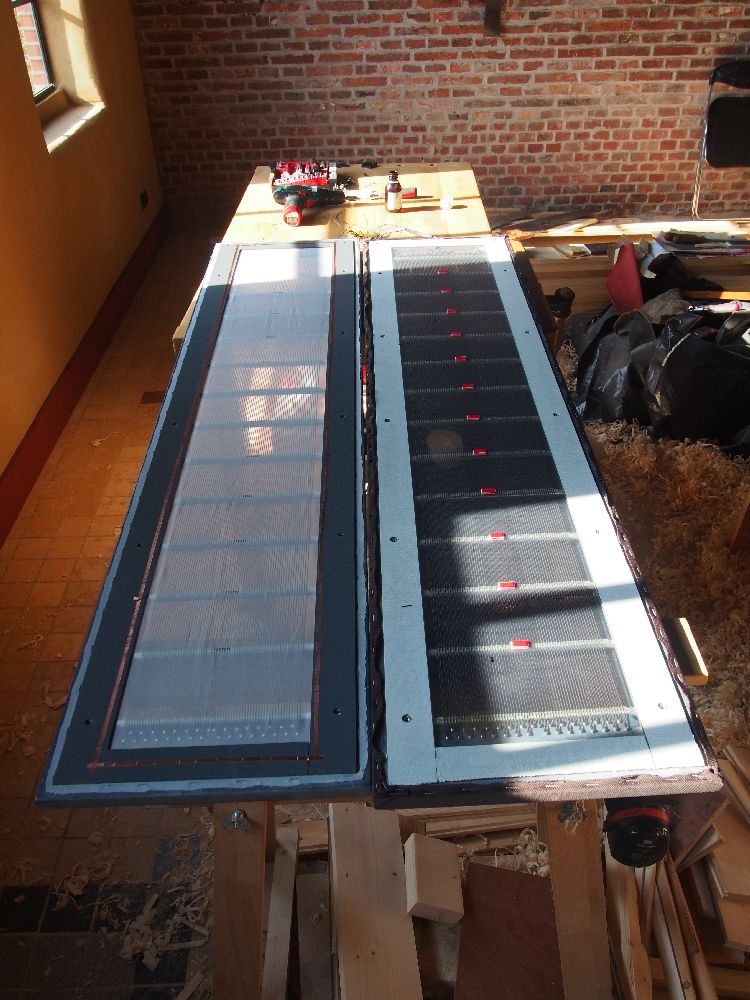

I made some pictures during the debugging process:
P1012149_resultaat.jpg P1012150_resultaat.jpg P1012151_resultaat.jpg P1012152_resultaat.jpg P1012153_resultaat.jpg P1012154_resultaat.jpg P1012155_resultaat.jpg P1012156_resultaat.jpg P1012157_resultaat.jpg P1012158_resultaat.jpg
The coating comes with an instruction guide. This guide also recommends how to make the contact between copper and coating. My advice is to use the described method instead of the current one. By the way my guess is your coating fluid must have been expired for quite a while. It expires within 6 months after ptoduction (see bottle) while I havent distributed it for some time.
