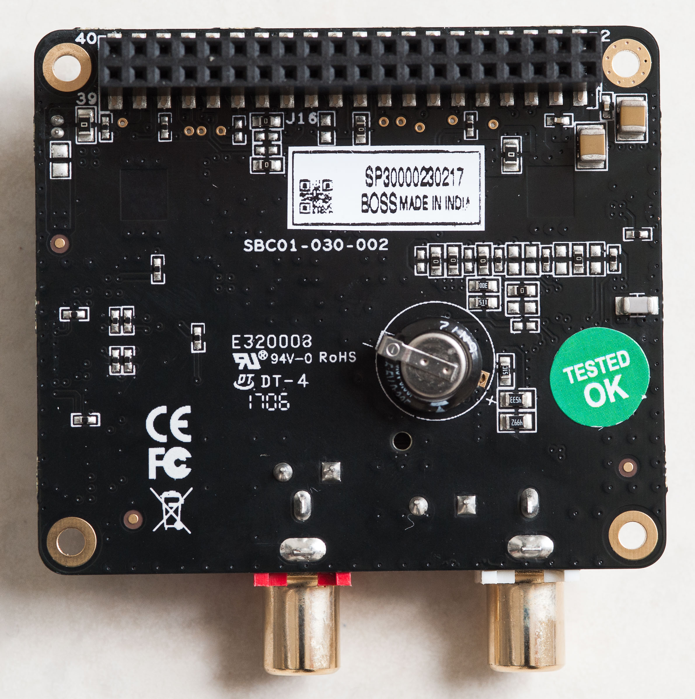

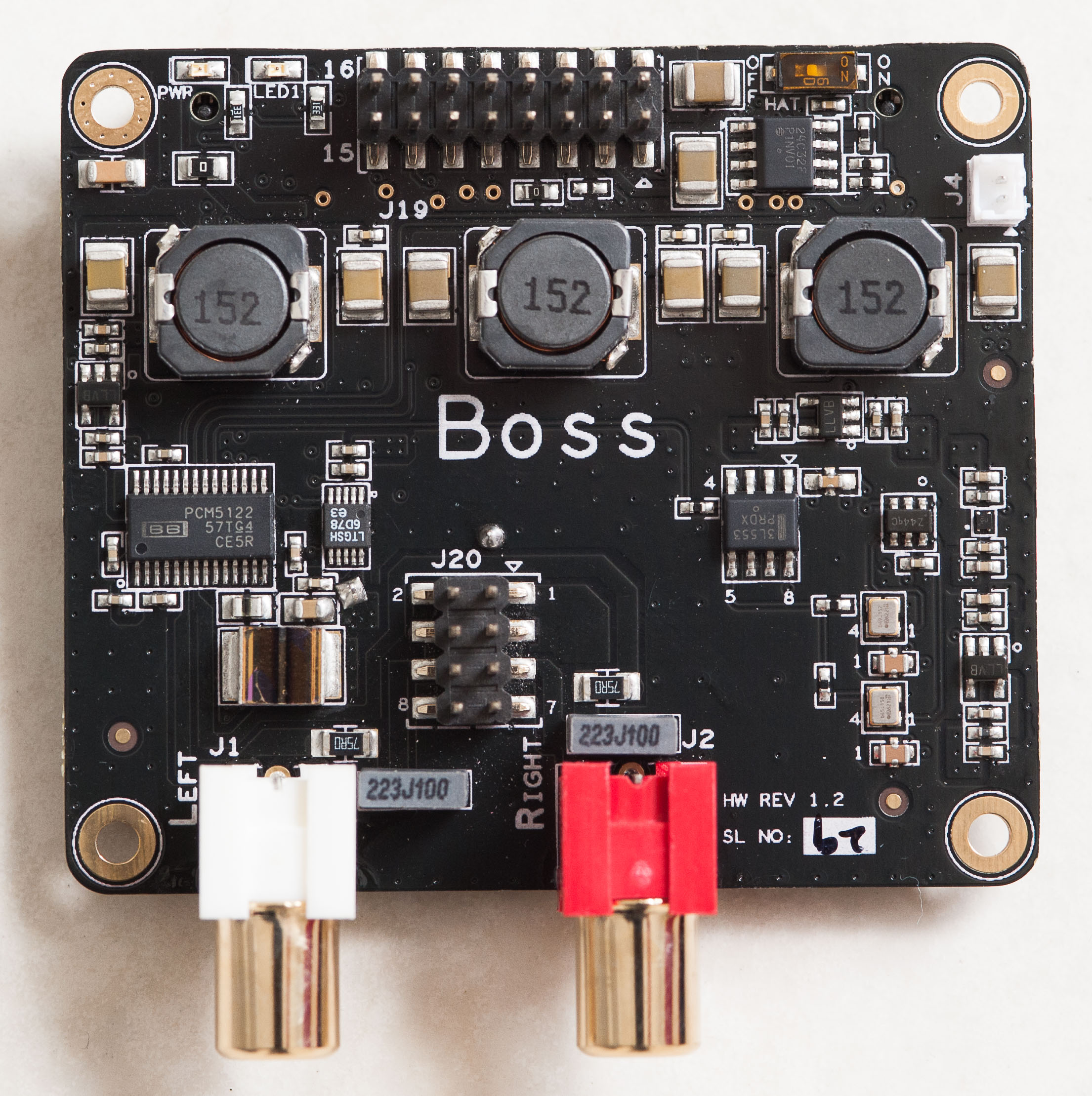

Attention: sckramer is wrong with his info (reply #104): (pin14,15 GND) (pin1,2 5V)
If you check the document, it's: (pin15,16 GND) (pin1,2 5V) ... pin14 is GPIO22 / MUTE_AMP
I attach two very detailed pictures of the BOSS DAC, where you can see all the details of the ICs, even the oscillators ...
As DimDim already mentioned, the LDOs are:
- LT3042 = LTGSH (picture)
- LP5907 = LLVB (picture)
