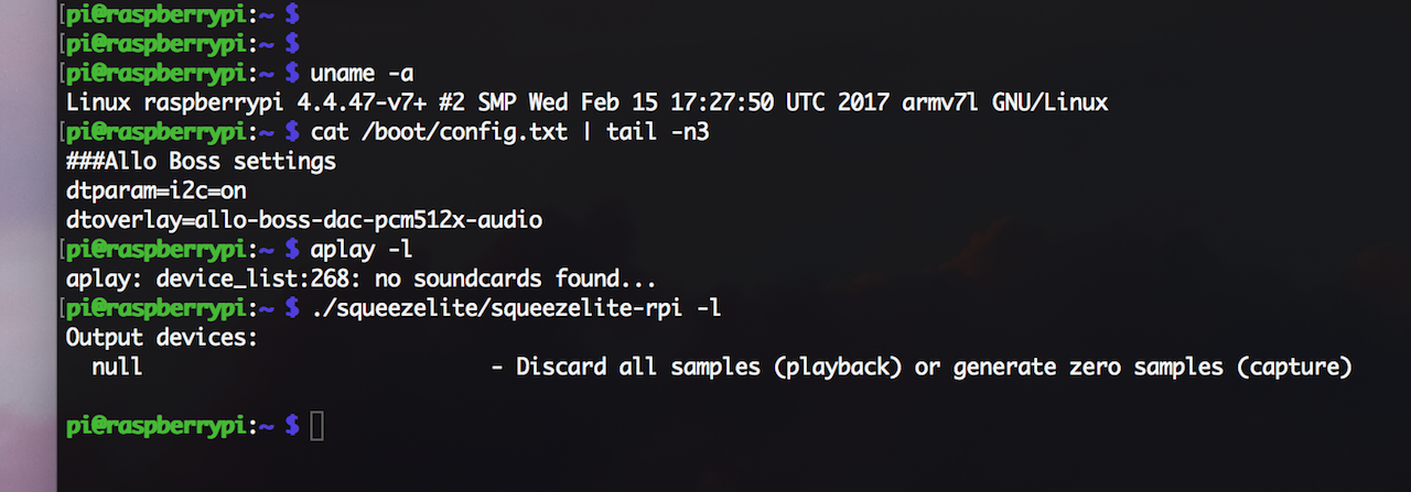

Did miss that... but still just will not light up-- frustrating.
I started with fresh "raspian lite" to compile allo's branch. Is that the problem?
Also tried the these defaults
Code:
# Uncomment some or all of these to enable the optional hardware interfaces
#dtparam=i2c_arm=on
#dtparam=i2s=on
Don't mean to start a linux support tangent, but maybe it's simple -- I can suffer w/volumio in the mean time
The driver is not (yet) part of the stock kernel.
You'd need to patch the kernel and then you need to activate the module.

Know all that, I do the modules and kernel from the allo branch. Raspian is just the linux I use to compile on.
