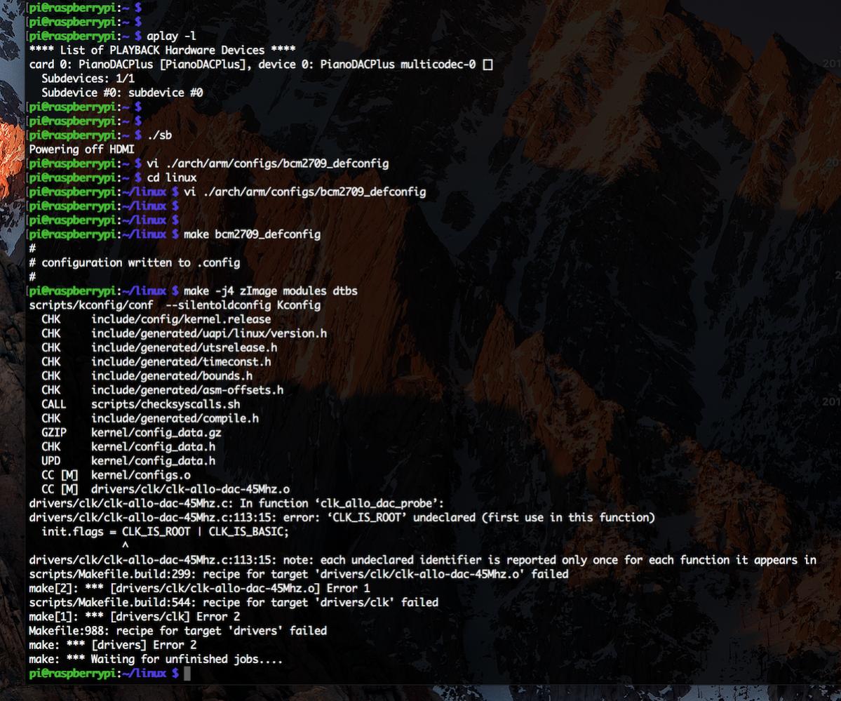

Yesterday had to manually add this to the default config:
Code:
vi ./arch/arm/configs/bcm2709_defconfig
CONFIG_SND_BCM2708_SOC_ALLO_PIANO_DAC_PLUS=m
CONFIG_SND_BCM2708_SOC_ALLO_BOSS_DAC=m
The piano plus worked, but boss would not compile. Looks like they committed changes to that just a few hours ago. Will see if the default config works also...

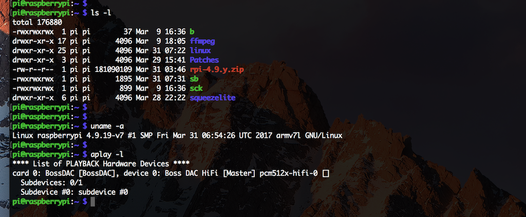

Boss in Official 4.9.19
Clean compile and no tinkering after the latest commit (4.9.19+) -->
Tested master and slave mode, works good. Sounds good with squeezelite.

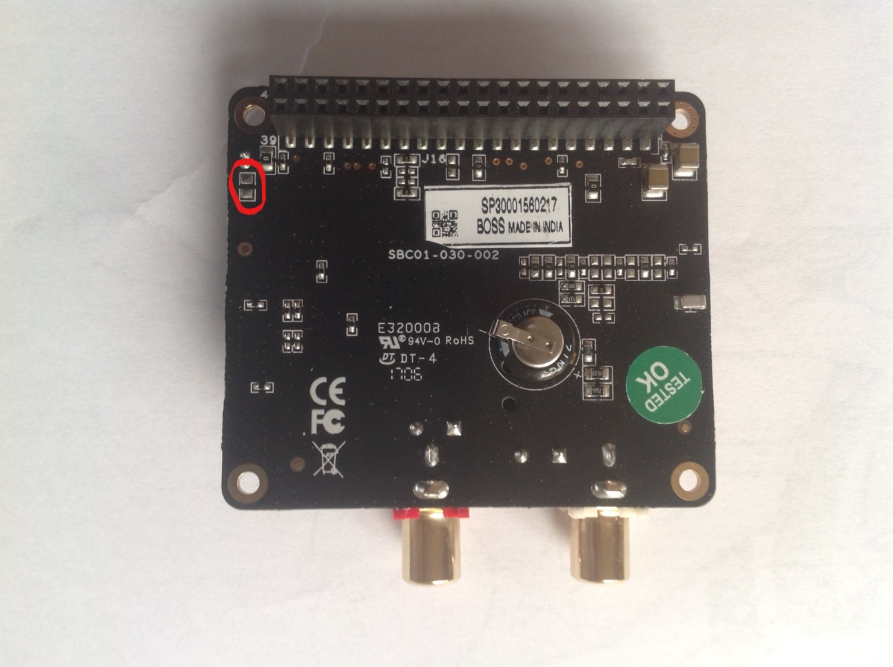

Have a look at the external power doc .
Good luck.
Thanks.
I did, I followed the instructions but without success.
I desoldered the resistor. Then I connected J4. It didnt work. I tried another 5V powersupply. I didn't work. I made another J4 connection cable. It didn't work.
So I compared the photo of the PCB on the Allo website with the Boss which I have here. And there was a difference. As the photo (post 95) shows in the red circle resistor R828 is missing. And on the photo of the Boss on the Allo Website the R828 is present. Hence my question. Is R828 missing on my Boss Dac? Should I solder a 0 resistor on this R828 place? Maybe then it works?
