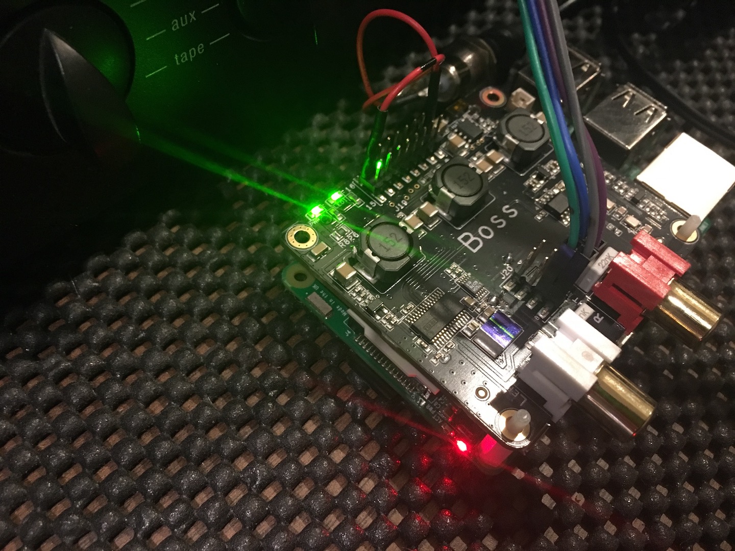

I mailed cdgames/Allo and received a reply: soldering a 0 resistor on the R828 place is indeed the solution.
Hi All,
To work from external 5V ( BOSS J4 connector) need to solder 0 ohm resistor on R828 Location.
-Remove (desolder) R826 - 0 Ohm
-Solder 0 ohm on R828 Location.
Regards
Attached were updated BOSS External Power Connector Instructions which, undoubtly, will be published on their website monday.
I followed the updated instructions - I moved the 0 resistor from R826 to R828 - and now it works!

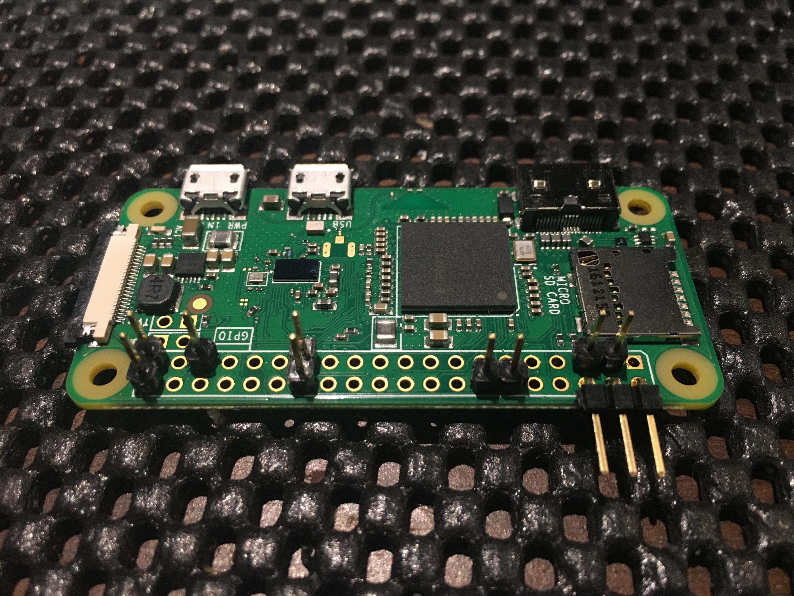

@DJ le Roi,
Oops, you was going to let you know this alternative before soldering, both will work fine.
You can power the boss from it's header: (pin14,15 GND) (pin1,2 5V)
I use a zero with 5V, 3.3V not connected.
