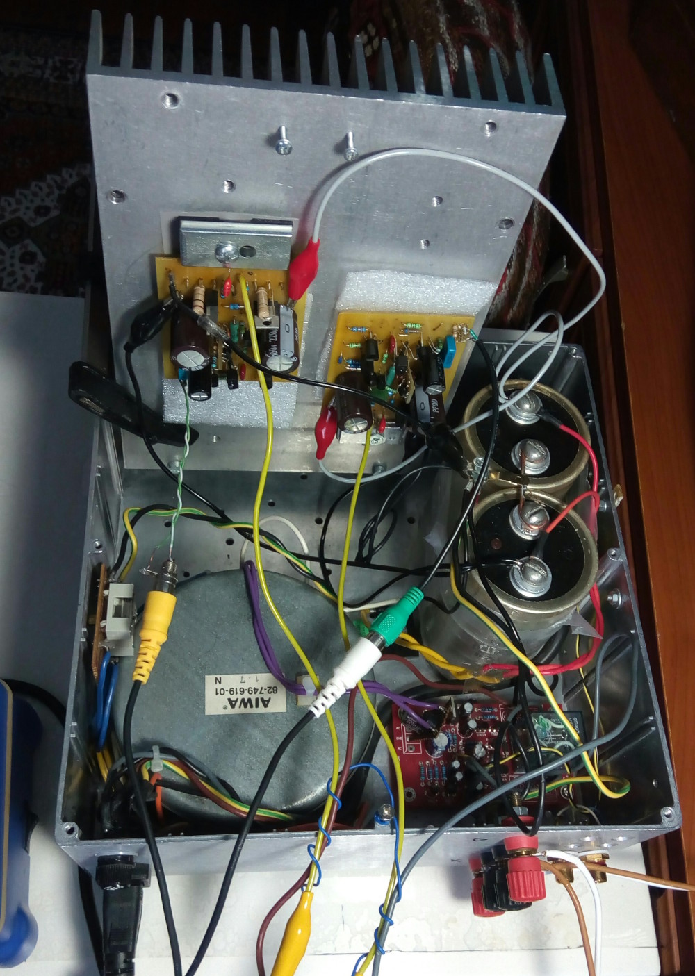

Terranigma, what was the highest rail voltage you tried with HexFet circlophone version? 50V ?
I said that I used 50V rails with my Hexfet build earlier but it appeared to be 45V. Sorry for my bad memory. I changed my LTP transistors with high HfE BC550C's accordingly since they are 45V rated. This is the highest rails that I can afford now.
I guess I could test up to the 65V region if I have a suitable transformer but the HEAT dissipation should be considered seriously at this level (you already know this). The big heatsink in the photo is barely handling a single channel at full power. It can handle both channels at moderate listening levels.

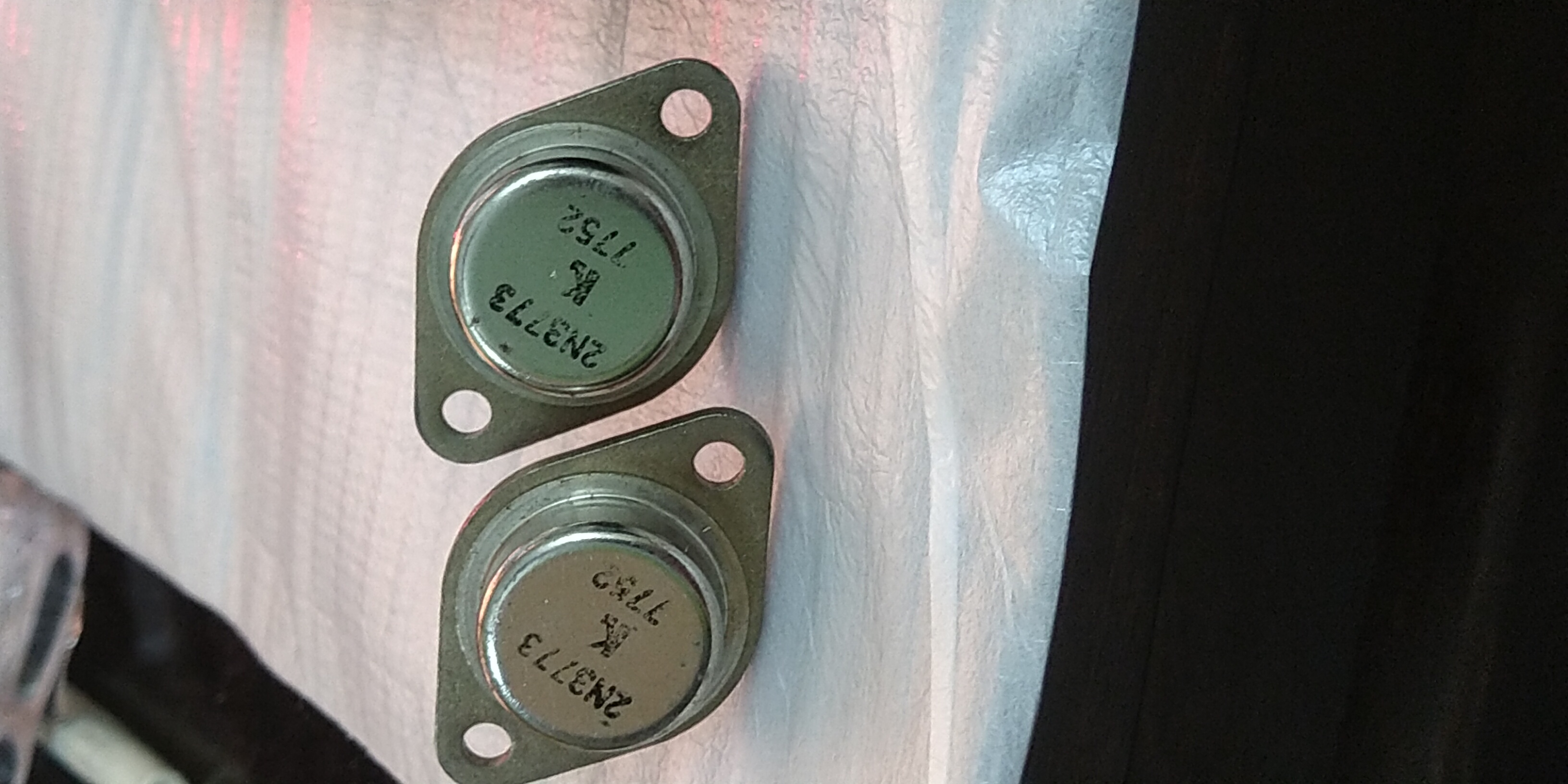

One channel of Circlophone with 2N3055 @ 14=0-14 AC transformer is working very good. I have received a Toroidal transformer 24-0-24 AC. I therefore want to cahnge the output transistors to a higher voltage Vce. I had purchased three 2N3773 a long back in the year 1980. They have not been used as yet. Their make seem unknown to me. It is stamped "K". As far as I remember it could be "Steel". However I am attachind photo. I need your advice.

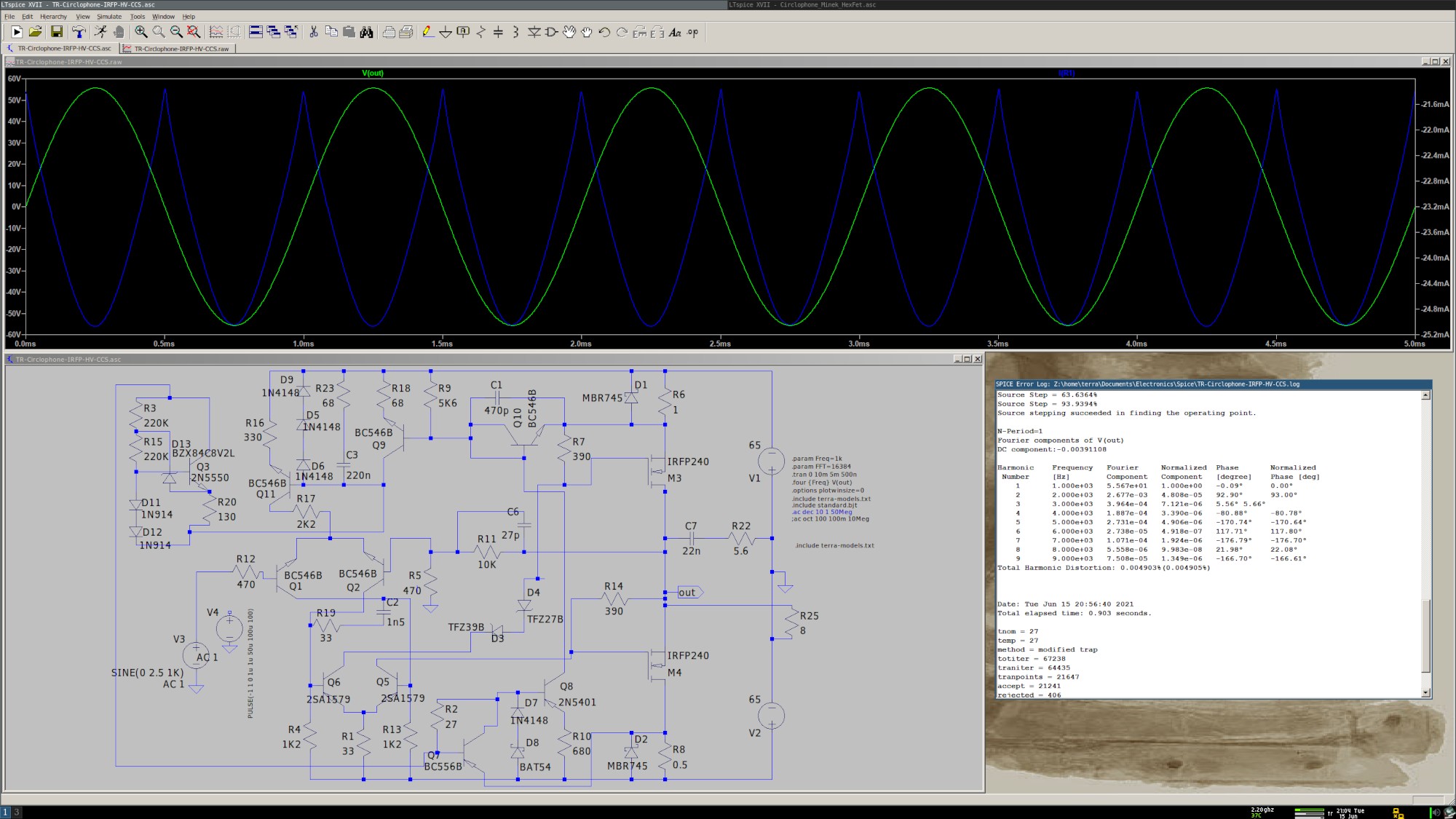

Hi Minek,
I think you asked because of your failed simulations of hexfet Circlophone on builders thread. Probably the cause of the failure was the P-channel hexfets at output as Elvee mentioned.
When I refer to mosfet/hexfet Circlophone it is an "inverted" version which allows you to use N-channel mosfets. I simulated N-MOS version so many times and never had such an issue, even with much higher rails.

Yeah, that's what I ended up doing - inverting the schematic, even if it didn't look 'natural' to me.
Eventually it worked perfectly.
I can even reuse my PCBs, just change polarity of everything..
Still have plans to build HexFet circlophone, that would be my third 🙂
First two BJT circlos still running very nicely.
I see you have nice CCS instead of R21. I also used CCS, but simpler one...
When you do, you can consider Fujitsu mosfets. When I look at their datasheets, I'm quite surprised. They have high transconductance, low capacitance and low thermal resistance (even TO220 ones). I think they are not so popular on audio because they have no P complementaries. Since we have Circlophone, who cares? Example ones: 2SK3549, 2SK3678, 2SK3533, 2SK3875
