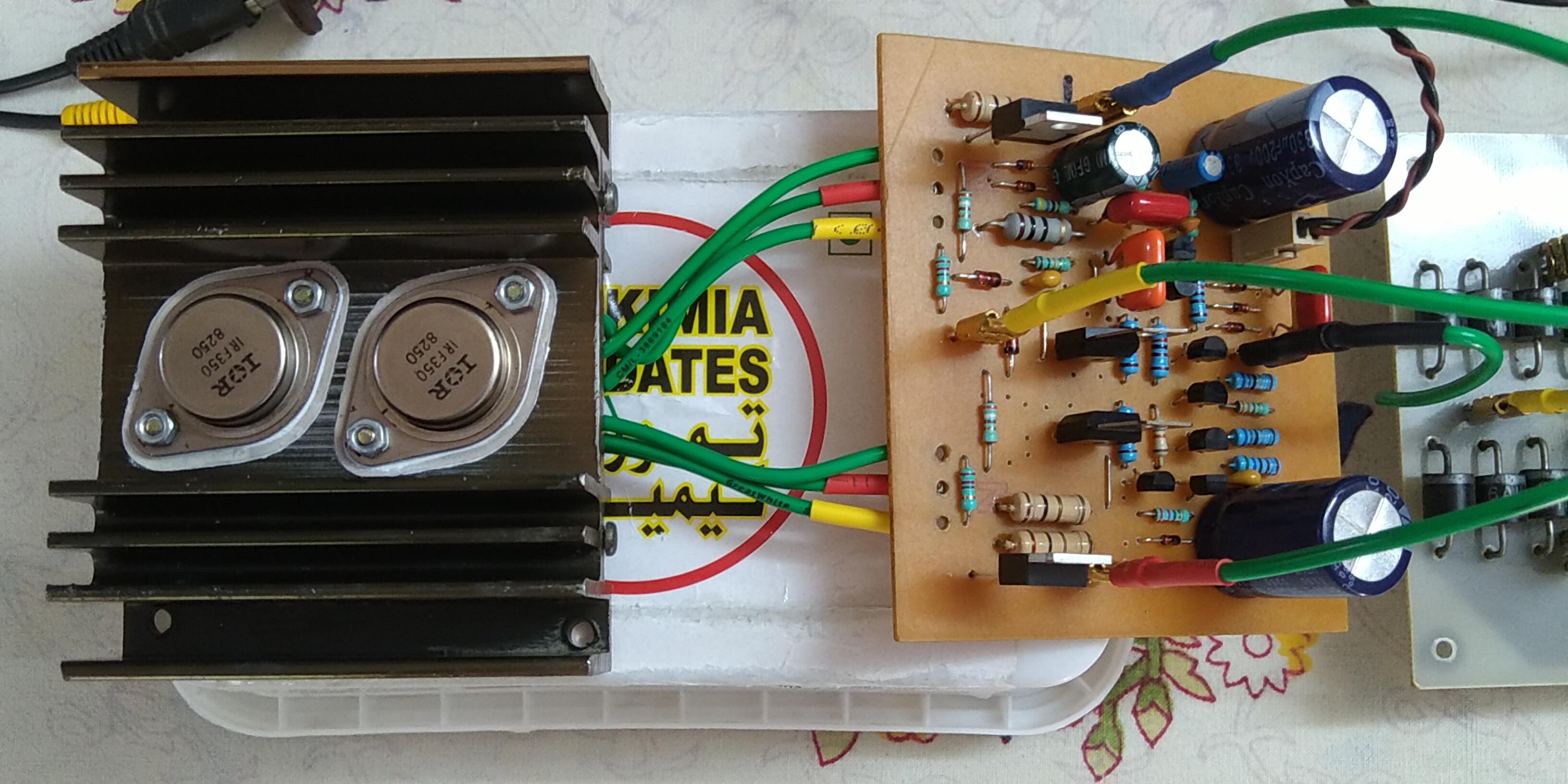

Mr Elvee,
Today I tested Circlophone with very old IRF350 metal case MOSFET purchased in the year 1985. Surprisingly this circuit is also accepting those MOSFET's not specifically made for audio circuits. This is a switching MOSFET with high input capacitance of 3000pf. I therefore pretend that any high power MOSFET not specifically made for audio may be substituted in the circuit.
The heat dissipation is high and need bigger heat sink. The amplifier has been power on for more than 12 hours without any failure.
Mr Elvee,
On voltage measurement, I have found that there is mismatch in GS voltage of both MOSFET at steady state with no signal. The MOSFET on the negative rail side measures 3.70V while that on the positive rail measures 3.5V. What could be the cause of this mismatch?. The voltage across 1 ohm resistor on negative side measure 185mV.
With this setup I didnot find any distortion and steady state operation is stable. I think I will need a bigger heat sink as this heats up quite high. VAS transistors heating is normal.

Mr Elvee Thanks, for the reply. That means GS voltage will vary with Gate-Source Threshold Voltage of each MOSFET. I have further two more questions:
1. Since R8 & R11 are current sensing resistors, what type of composition would you prefer. Carbon, Metal, Metal Oxide or Wire wound.
2. I would request you to please refer to Post # 1850 of Mr Terranigma where in he has actually shown square wave pattern with and with out R18 and C12. He has found out that without R18 and C12 the square wave is smooth. In yout MOSFET version simulation you have used them. What is your recommendation.
Since the dissipation in R8 and R11 will typically be lower than 0.25W, you are free to use any type, but WW resistors being inductive, they might have small parasitic effects therefore I recommend any other type. Accuracy is not critical, and plain carbon types are perfectly OK, as are metal and MOX, of course.
The reality always wins against simulation, and I have not built the MOS version, unlike Terra, therefore I suggest you follow the path he laid.
It is understandable: MOSFets have a large input capacitance, and the GS resistor is larger than the BE one of the BJT, meaning they mostly self-compensate
