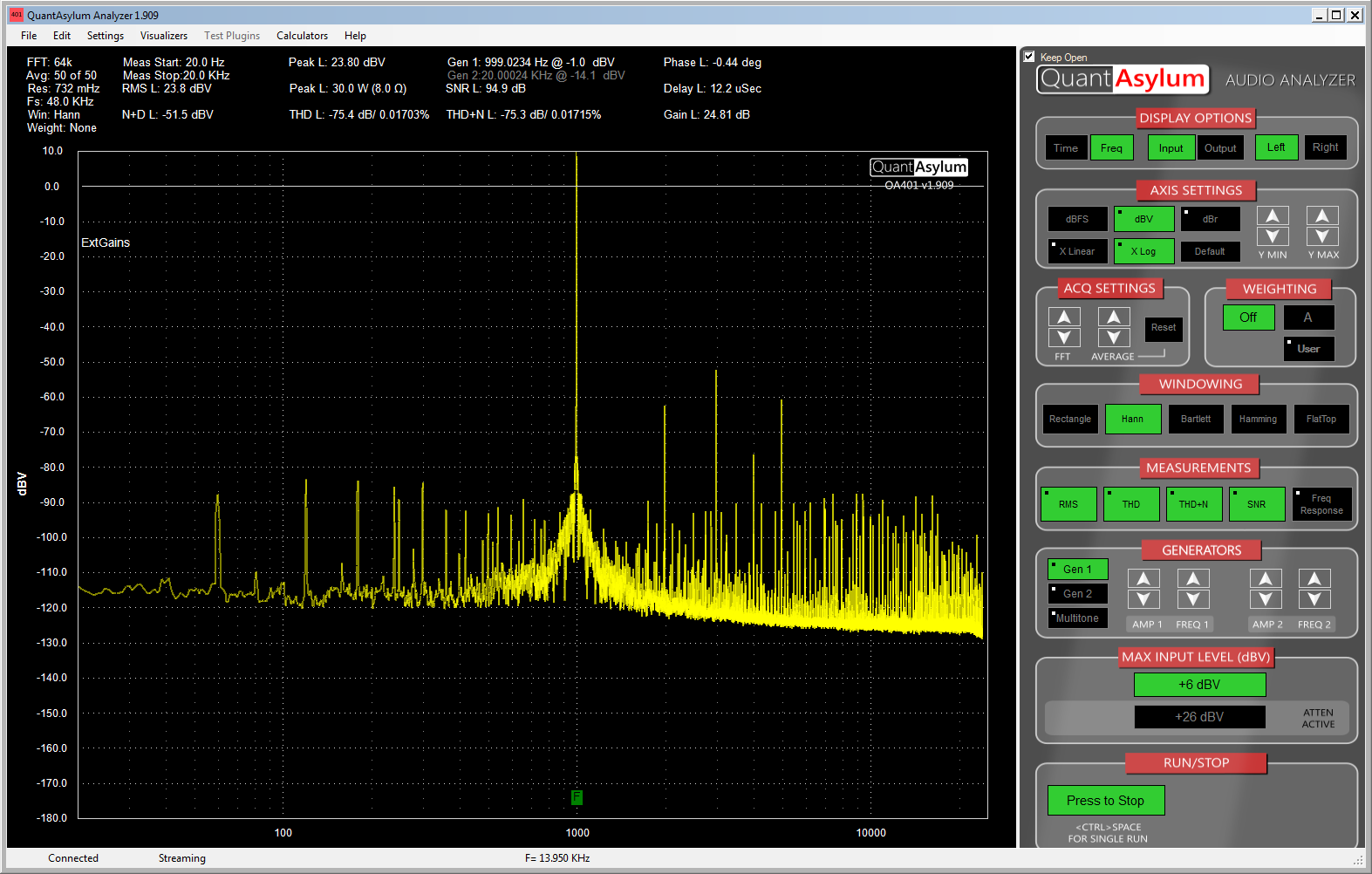

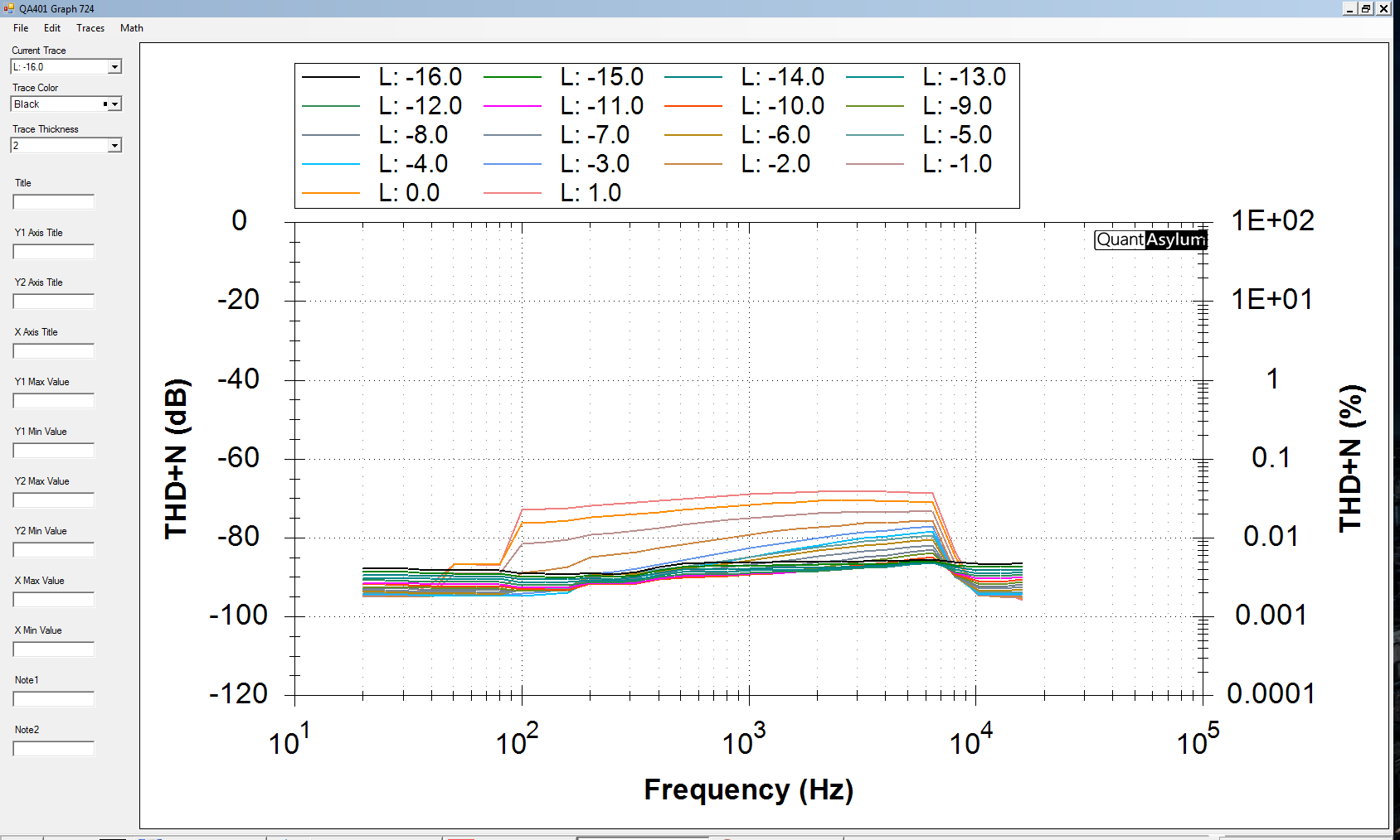

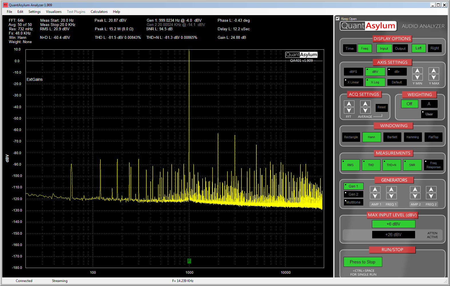

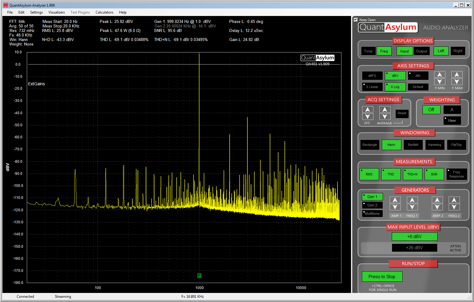

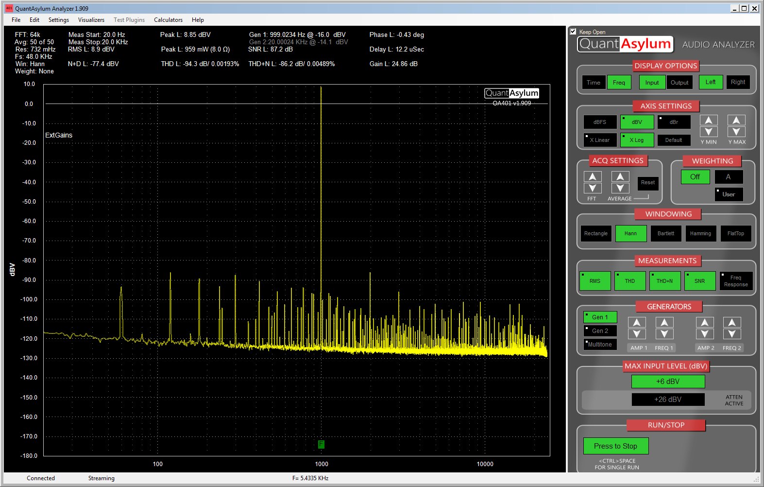

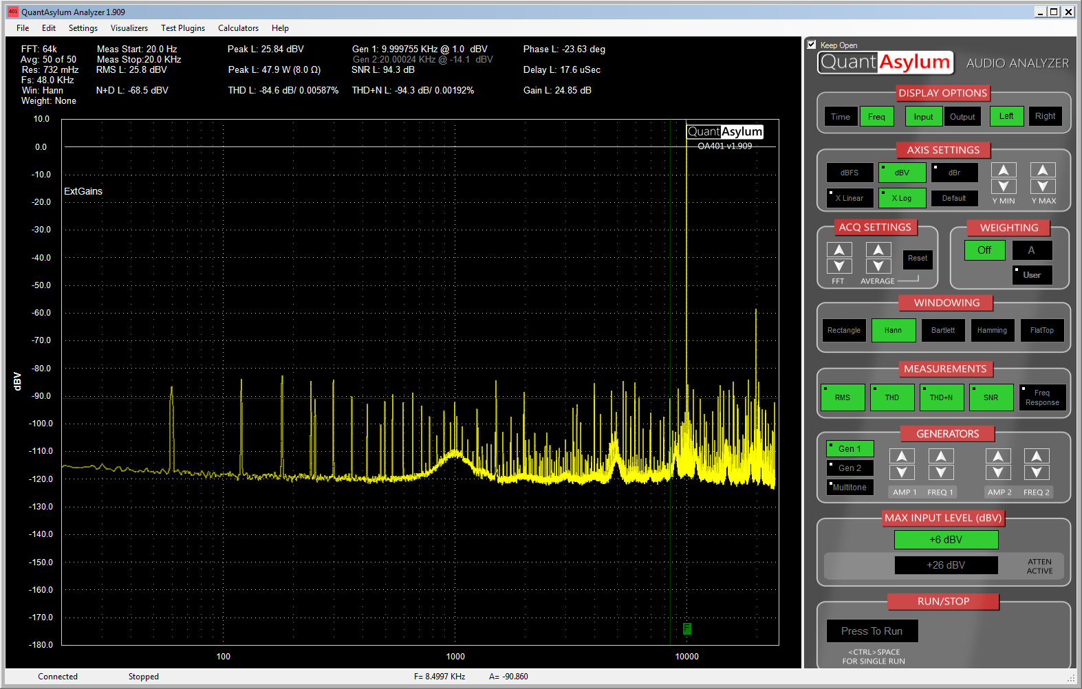

Not sure if anybody needs to know this, but here are my measurements of my circlo build with QA401 audio analyzer.
Rails were 42V. Load 8.8 Ohm.
Thd from 0.0019% at 1W to 0.035 at 50W.
Very linear with frequency.
Edit: interesting thing - in my un-experienced eyes, it seems that circlophone measured slightly better than Elvee's active current dump amp. Will re-test, and publish results.

Thanks for sharing your results with the community. High quality, reliable measurements are always welcome and useful, and you seem to search for perfection in this field, just as you do in your builds (which are masterpieces!).

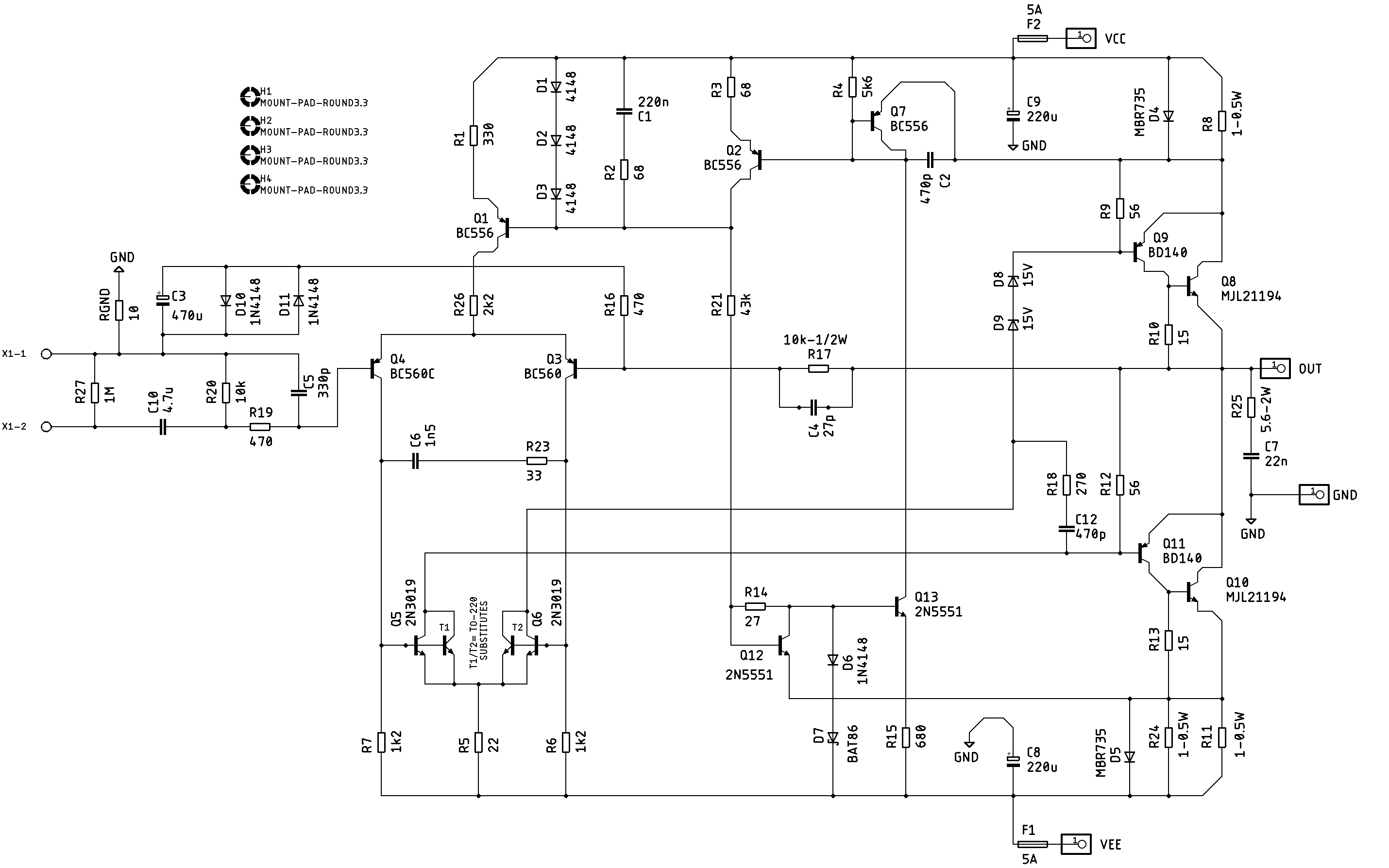

Dear Mr Elvee,
What type of capacitor C4 across R17 should I use?. Ceramic type may cause noise as it may act as a condenser microphone. Mica /Slvered Mica is very expensive and not available easily available in India. Could you please advise on this issue.
COG ceramic is very little microphonic, and C4 has no DC voltage across it.

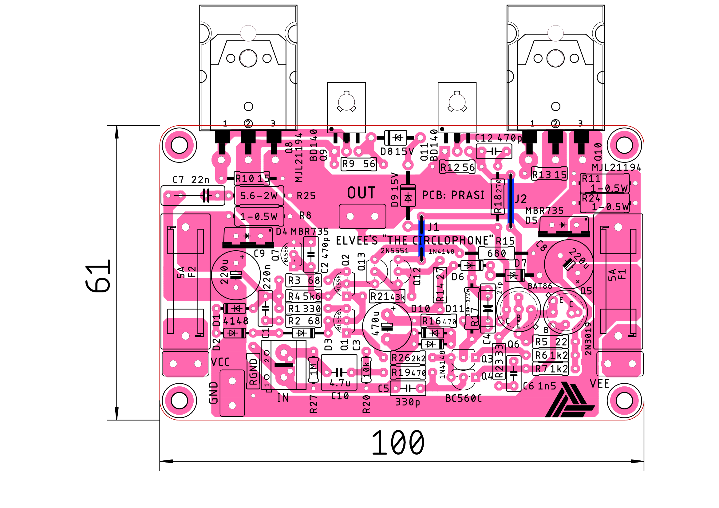

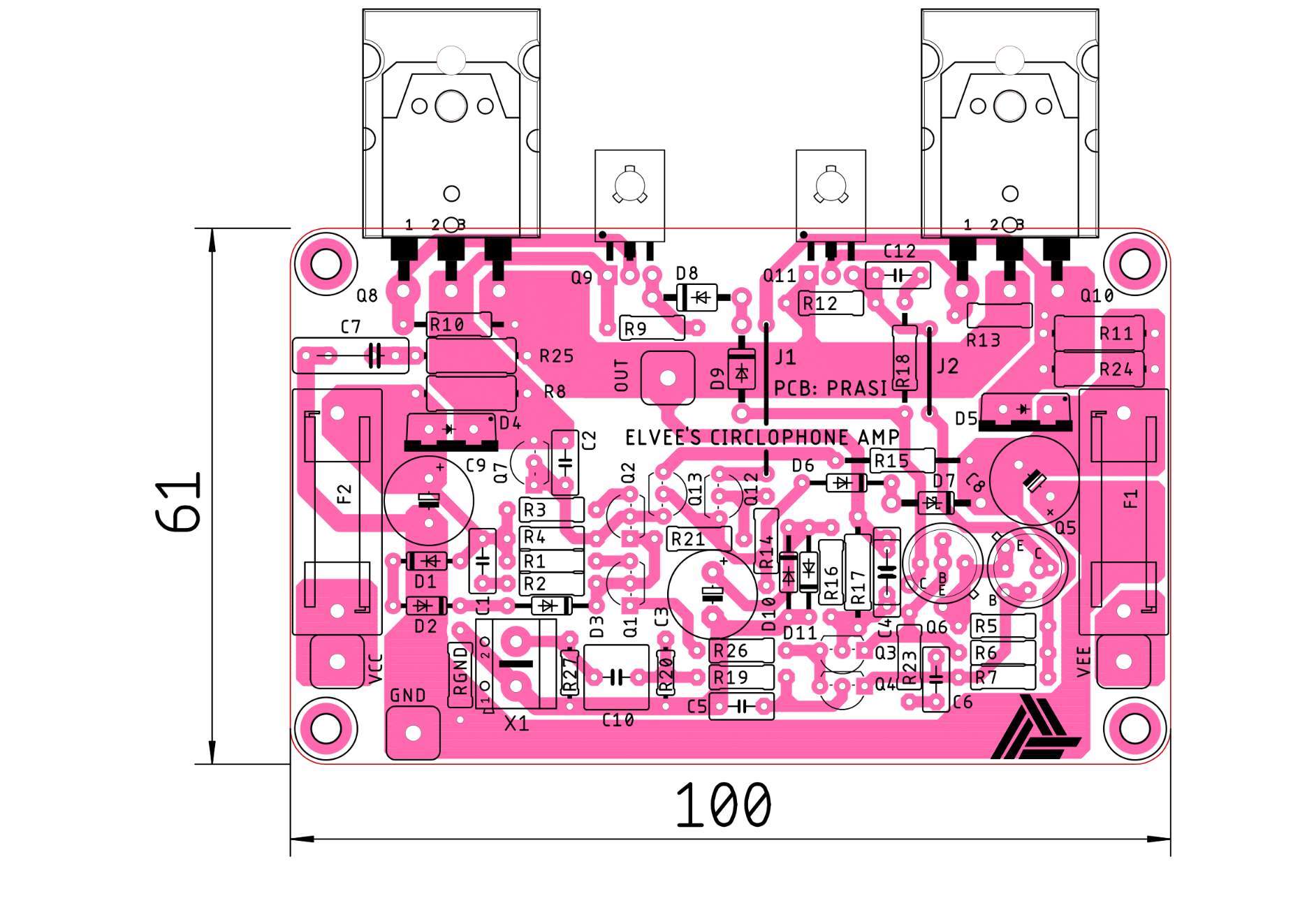

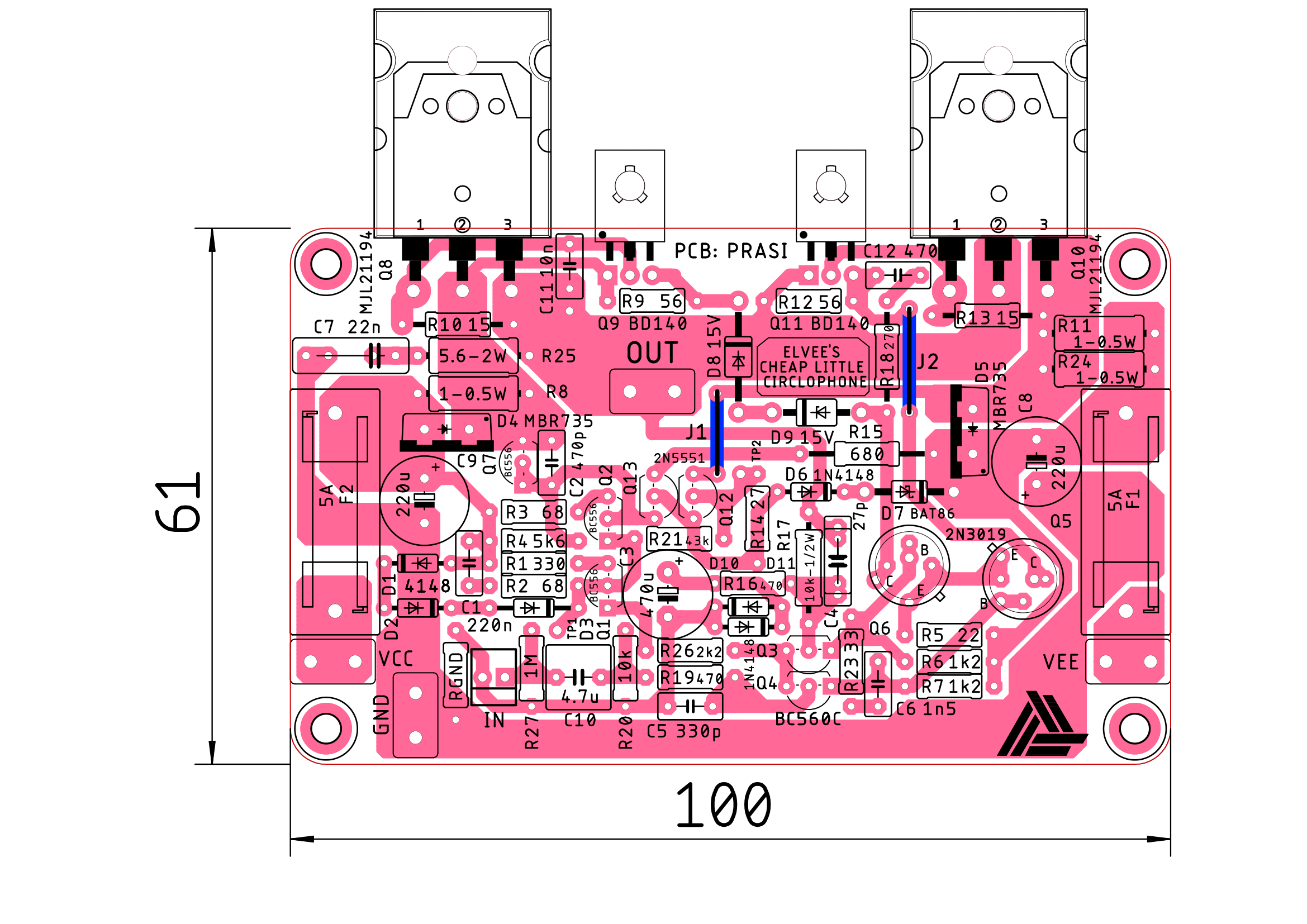

Hello Elvee,
Here is another "done to Death" layout for vanilla version for your amplifier.
Can you tell me if 2sc4793 is suitable for Q5/Q6 or 2sa1837 for Q9/Q11? Sorry if this already answered before, i only had speed-read the long thread.
In layout, I have provided option for TO-220 pads for Q5/6.
regards
prasi
regards
prasi
Slightly revised and with component values.
I liked your layout. If this one appeared on this thread earlier, I would not make my own PCB which looks similar to yours.
My suggestions are:
It seems you omitted optional 10nF cap (C11 on original schematic). This cap is needed when higher speed output transistors used.
You can preserve more space around Q5 and Q6 because these are running relatively hot. They must be apart from C8 for same reason.

What is the reason for putting R Ground as this will float above 0V and is als not as per tested original schematic designed by Mr Elvee. Which TO 200 transistors you intend to use for VAS. C10 seem to be Metallised Polyster Capacitor could you please send the name of the seller. Thanks

Hello Katiyar,
Rgnd is just as a ground lift option for experimentation, if not required, can be replaced with link.
TO-220 replacements are given somewhere in build thread.. 2SC5171 i think.
4.7u in 7.2mm x 7.2 mm case is made by wima and kemet.. https://www.mouser.in/Passive-Compo...Z1yznbzsZ1yznbzqZ1z0vn48Z1yzuws0&Ns=Pricing|0
but one can easily fit a nice bipolar panasonic SU or nichicon muse in its place.

Thank you terranigma, for your kind words.
With a little bit of move there and here, I have managed to leave some space around Q5/Q6. I plan to use 33VDC, so for that, do I need to sink Q5/6, I see that in original Elvee's build , I could not see heatsinking. correct me if I am mistaken.

This is much better. I think you will omit C11 (10nF) anyway.
When I first built Circlophone with 33V rails (like yours) I noticed that they are too hot to touch. Even though Elvee said that it is safe (because they're running in Class A) I felt more comfortable with heatsinks. Also heatsinks makes the board looks better. In short, they are safe without heatsink but you can attach a heatsink if you prefer like mine.
Elvee's post regarding this issue is at #383
Edit: I see that you fit C11. So avoid that part from my post above.

For moderate supply voltages (up to +/-45V), no heatsink is necessary (it also depends on the case: a TO126 or 202 can dissipate more that a TO5)
