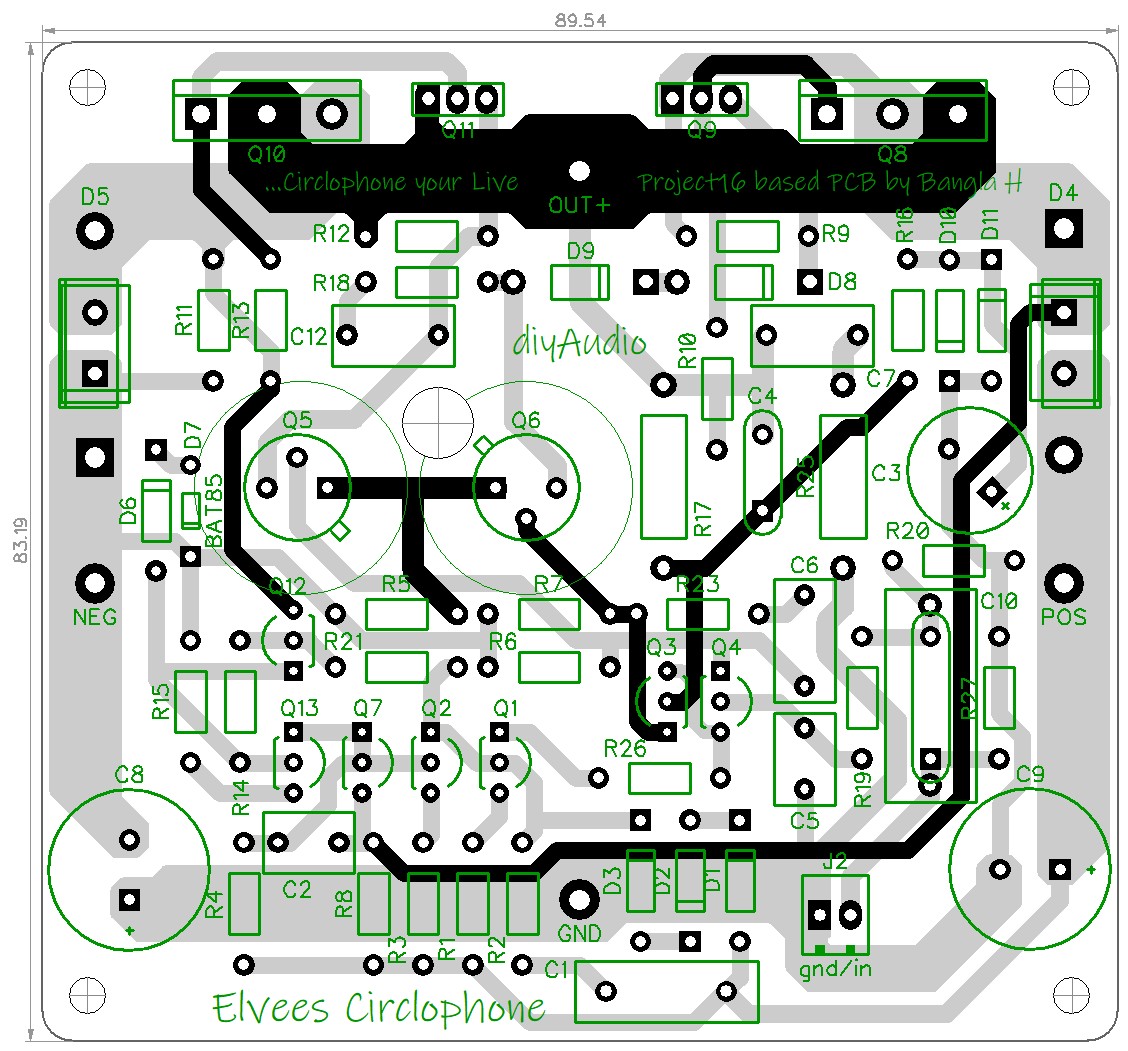

My build is not dead silent when inputs are open or connected to a source. I can hear a annoying HF noise when I sit close to the speakers. It is not 50hz mains hum. But when I short RCA input, it becomes dead silent even if I close to my ears to the speakers.
Does this behavior give you any idea regarding the source of noise? My PCB layout is here. I did not separate low level signal grounds from rail ground as you can see on PCB layout. Since noise is not there when inputs are short, does it mean that layout is ok and I have to look at somewhere else?
Mains earth is connected to the chassis but entirely isolated from amp.

i have done a board based on project 16 showed here.
If you like you, and other please, can look in detail if all is correct done.
I have ordered a batch by pcbway any time back but not started assembling now.
Regards

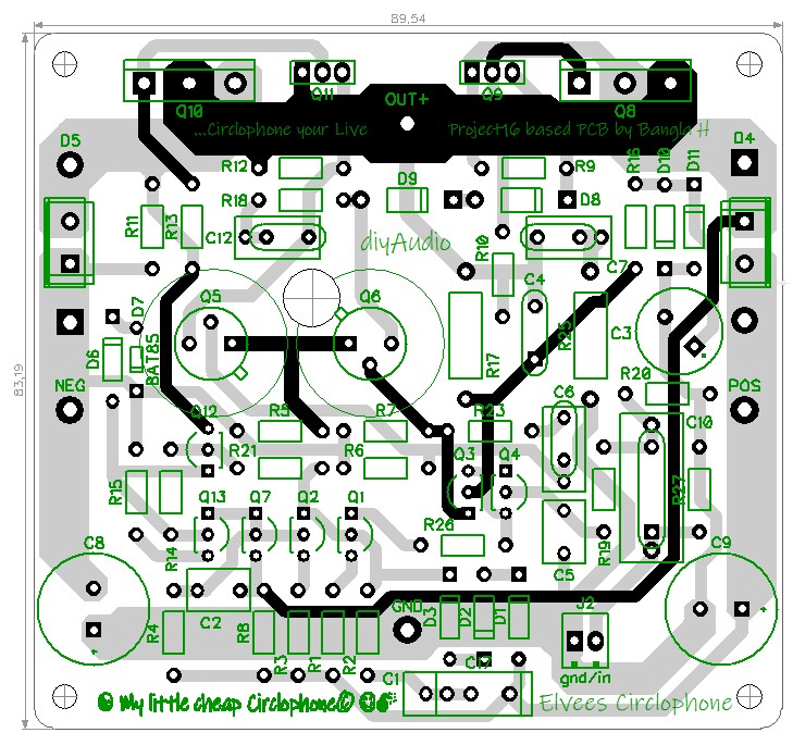

Thank you Elvee,
i've done a copy of a nice layout project 16 based board.
For better placement i have added pads to some capacitors.
Revisited Board.

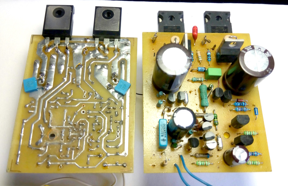

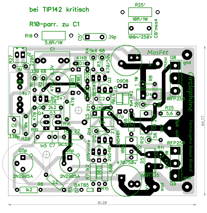

On Terra's MosFet circlophone with Darlingtons, on my not that good self etched board, a helpful guy heightened
R25 to 10 ohm and C7 to 100n, also the FB C4 to 39p
and added a R 5,6 ohm 1W to C1 parallel if i remind correct.
Maybe that helps too?
I have later recycled it.
Later done a new board, but not connect to rails and speakers yet...:tilt:
  • Circlo Pro16 uni_rev_gerber.zip
Good to see that someone took a fresh look at mosfet version. I wouldn't do two layers since the board already has done on single layer many times. Home builders may prefer one of those.
If I go for a new design, I would avoid tht components as much as possible except output devices, bypass caps and sockets and maybe other transistors. When you do own pcb's at home, drilling is the real pain besides etching.
I think such thing is missing on Circlophone side: Compact, multilayer fabricated PCB with full of SMD components (except those components above).
