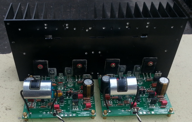

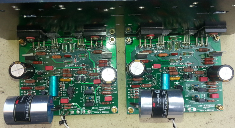

I completed my Circlophone today, both channels tested and all ok.
Some info:
I use 2x 0-24V to create +-30V DC PSU.
D8, D9 = 14V so I will get about 45W
R21 = 35K7
I use
- Onsemi BC560C for input, I tried 2SC970BL, 2SA1016, 2SA1015
- 2SC3423 for VAS with 4.7pF N0P ceramic capacitor
- Phillips BD140 for driver
- MJL21194 for output driver
- input cap = Claritycap ESA 4.7uf 250V
- dc block cap = Tantalum 150D 150u 15V
Sound ok for my taste.

Congratulations! very impressive build. Do hear any low level hiss or noise with MJL21194's when you close your ears to speakers? I used these transistors but they weren't dead silent.
When I connected my source, I can't hear any low level hiss and noise with MJL21194 at normal condition when my ears was closed to the speaker. I'm not try to do that in the middle of the night when other sound is minimal.
I heard some very very small noise before with my prototype but not with the final PCB.
Very nice build. If you have spare boards, you can offer them for sale: I think some members would be interested, for example:I completed my Circlophone today, both channels tested and all ok.
I have 4 boards left from the order. But the shipping fee from my country seem very high so it is not worth it. But I can share the Geber files if any one need them.
