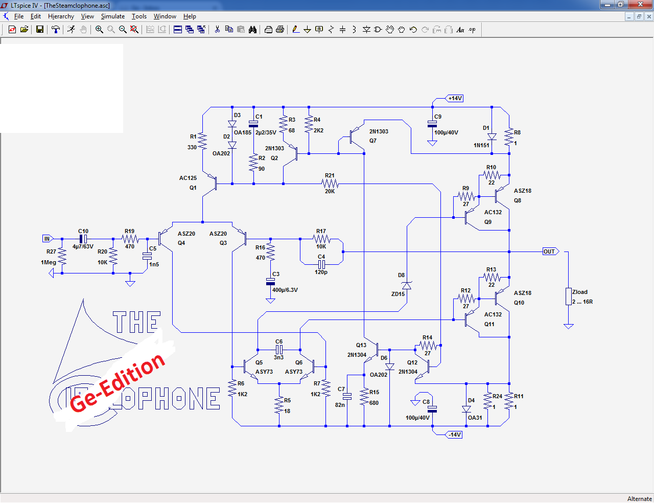

I see ASY73, Germanium NPN, TO5, 0.14W, 30V, 0.4A, 75C, 4MHz, 30pF, HFE20. . .All? No, something is missing.... but the gap is going to be filled very soon, thanks to the "Steamclophone" 😀 ....... Details will follow
The steamclophone is born 🙂

The Circlophone has successfully been built in all shapes and flavors: N and P, BJT, darlington, MOS....
All?
Details will follow

I like this schematic, had a good experience with some similar topology, about very low THD, some warm class AB, and what i want to try is this schematic with the 2N3055 replaced, correctly polarised by P210 russian, or ASZ15, pnp Ge power transistors because in my youth I had a very positive experience about how the slower Ge power-ends sounded.
With such a low output rezitance try listening with high sensitivty speakers mounted in horn enclosures, and we'l talk again.
That is here----> http://www.diyaudio.com/forums/solid-state/269928-circlophone-germanium-edition.htmlI like this schematic, had a good experience with some similar topology, about very low THD, some warm class AB, and what i want to try is this schematic with the 2N3055 replaced, correctly polarised by P210 russian, or ASZ15, pnp Ge power transistors because in my youth I had a very positive experience about how the slower Ge power-ends sounded.
You won't find Class B on an amplifier tracks the bias always ahead--that is Class AA.

A rather important - at least for my purposes - feature is missing, a symmetric input. My DIY preamp has symmetric XLR outputs only. For the active speaker with two circlophones i want eventually the advantages of symmetric signals .
What is the simplest way to upgrade the standard circlophone to XLR input? I made a test with an opamp OPA 627 and 2 voltage stabilisator ICs but got some hum which is not there without this pre-stage.

for my active speaker project , 50 watts for the woofer/midrange is enough above 150 Hz, for the Dynaudio tweeter, according to amplitude/frequency statistics, 20 watts will do.
So question a.) is what is the lowest supply voltage for the circlophone without negatively affecting performance?
and b.) what is the simplest method to reduce the supply voltage accordingly ( and most important the idle dissipation as heatsink size is limited by speaker dimension) ?
Of course the voltage reduction should be near loss-less. Thus a dc/dc converter?
I think it can be done without inductors, capacitors only.

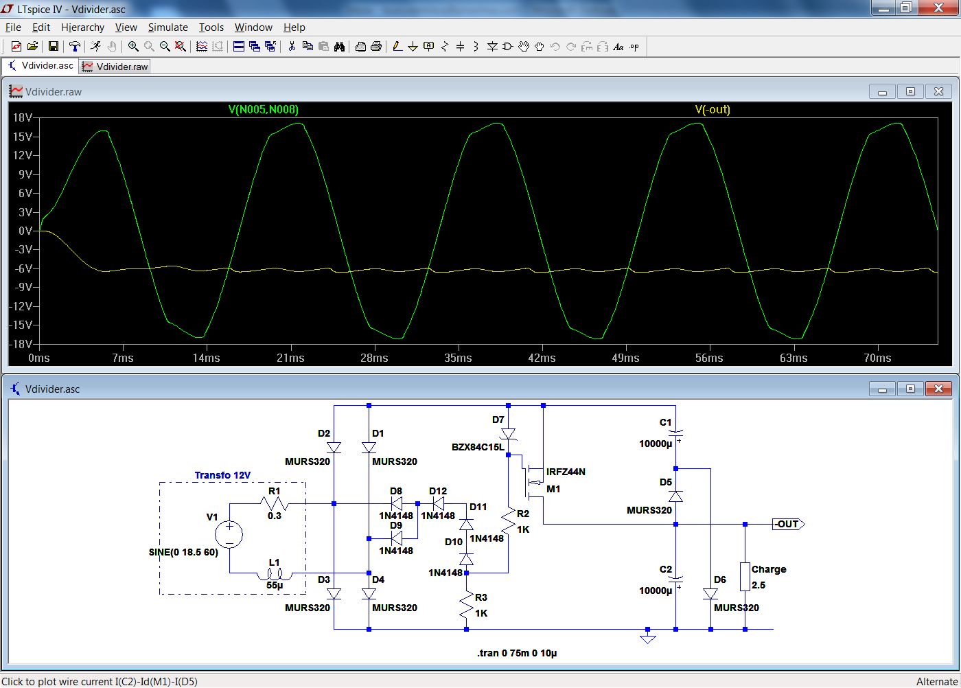

Yes, it can be done with capacitors only, but I am not sure it is the simplest solution: a single inductor synchronous buck converter requires less switching elements and is probably much more efficient.and b.) what is the simplest method to reduce the supply voltage accordingly ( and most important the idle dissipation as heatsink size is limited by speaker dimension) ?
Anyway, I don't think I have a capacitive voltage divider in my files for such a power, but I think I have a voltage dividing rectifier (the reciprocal function of a voltage multiplier). Would that be suitable? If you start from a conventional 50 Hz AC PSU, it should be OK
Thanks so no problem with lower supply voltage . About the voltage dividing rectifier, i suppose it can divide by 2?
OK, here is the power rectifier/divider 🙂2). Not exactly simple, but it does the job.
It could probably be coupled/merged with a synchronous rectifier for improved efficiency, but that would require a significant design effort.
Maybe I will make an attempt when I feel like it.
if the ratio of powers low/mid to hi is say 50/20 the ratio of voltages must be the square root of 2.5 . There are tons of dc dc step down converters even inexpensive with adjustable output - via pulse width - but i don't have any experience how these would do in audio amp applications. As far as i see it at first glance your voltage dividing rectifier can only produce half voltage, thus would yield a ratio of powers of 4. That could do perhaps.
If you chose an over-dimensioned type to take into account the peak supply current (instantaneous) plus some margin, and you add a sufficient bypass cap (eg. 4700µ) it should work well enoughif the ratio of powers low/mid to hi is say 50/20 the ratio of voltages must be the square root of 2.5 . There are tons of dc dc step down converters even inexpensive with adjustable output - via pulse width - but i don't have any experience how these would do in audio amp applications.
YesAs far as i see it at first glance your voltage dividing rectifier can only produce half voltage, thus would yield a ratio of powers of 4.
