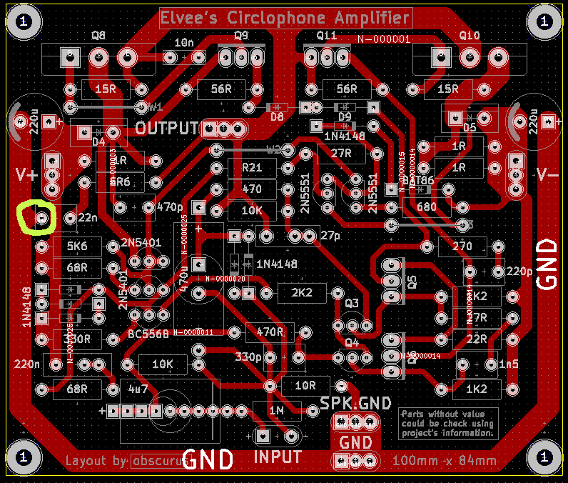

After a look at my layout. I spotted one thing. The zobel network GND at ouput was connected to the main cap GND rail. Could it cause a ground loop problem?

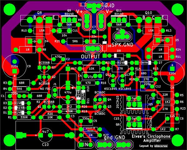

I think I'm done with my Circlophone protype, it is quite good and I'm enjoy listening to it even I only have one channel. So I want to start make a final layout for the amp. But I need help on some points:
1. I think Q3/Q4, Q5/Q6 will work better if direct thermal?
2. Q2/Q7, Q12/Q13, What is better? direct thermal of side by side?
3. Which type C6 is preferable? MKP, MKT, Micca or N0P?
Thanks!
Q3/Q4, certainly, especially if you make a DC-coupled version.
For Q5/Q6, it is not really required: they are already "in the loop", and even large inbalances will easily be corrected, with practically no impact on the input LTP
Side by side is sufficient, provided there is no source of heat in their immediate vicinity
Any type will do, NPO/COG is probably the easiest to source in that kind of value

Thanks! My final layout will look like this.

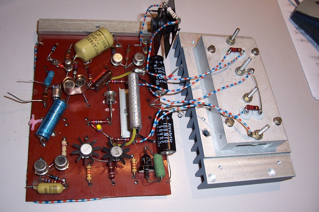

The Circlophone has successfully been built in all shapes and flavors: N and P, BJT, darlington, MOS....
All?
No, something is missing.... but the gap is going to be filled very soon, thanks to the "Steamclophone" 😀 .......
Details will follow
