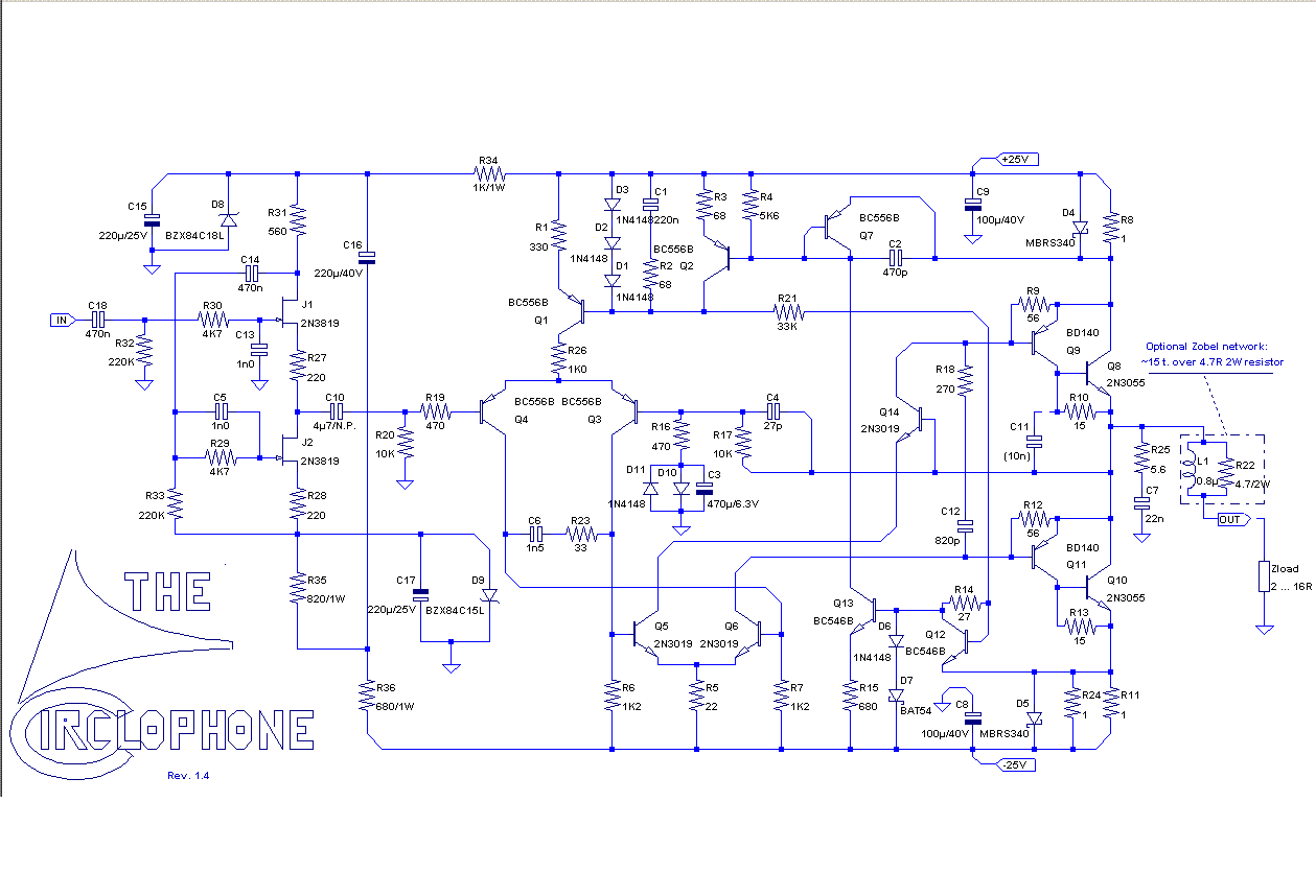

I think i will try the buffer on breadboard to check it out. Since my jfet are difference. What is the current need to get throught jfets? Which prefer type of 1n capacitor? Could i bypass the 470n cap?

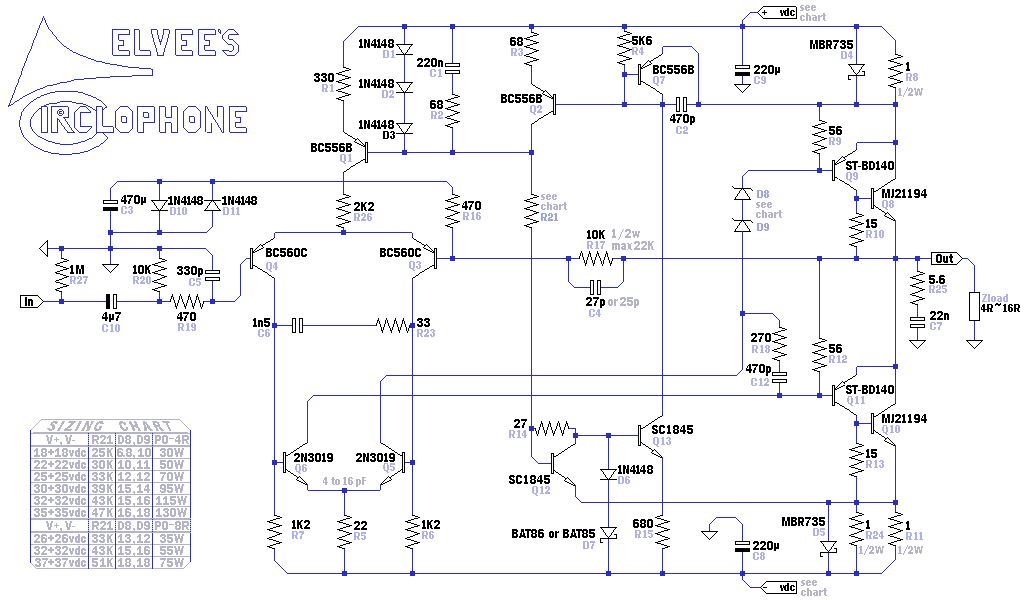

I may sound dumb, but has anyone made a BOM for the dummies (e.g., myself)? I'm already in new territory on this with etching my own board, I need to be as paint-by-number as I can since I don't have a scope.
Here is Elvee's original Circlophone with just enough modifications to support a wider voltage range.
454782d1419069488-building-elvees-circlophone-documentation-parts-accessories-beginner-friendly-circlo-headline.gif
Actually I'd like to double-up the 220u caps (C8, C9) to 220u||220u (440u) for more "bass slam" which is unnecessary but fun.
JFETS will decide their current by themselves, according to the 220 ohm resistor. Use "normal" fets, for general purpose applications, not high Idss types for switching
Ceramic COG, film PP, PS, PC, and even PET if you find them in this value. Not critical.
No, don't do that: just use a cheap fim cap, like mylar, that will be OK. Bypassing might bring problems

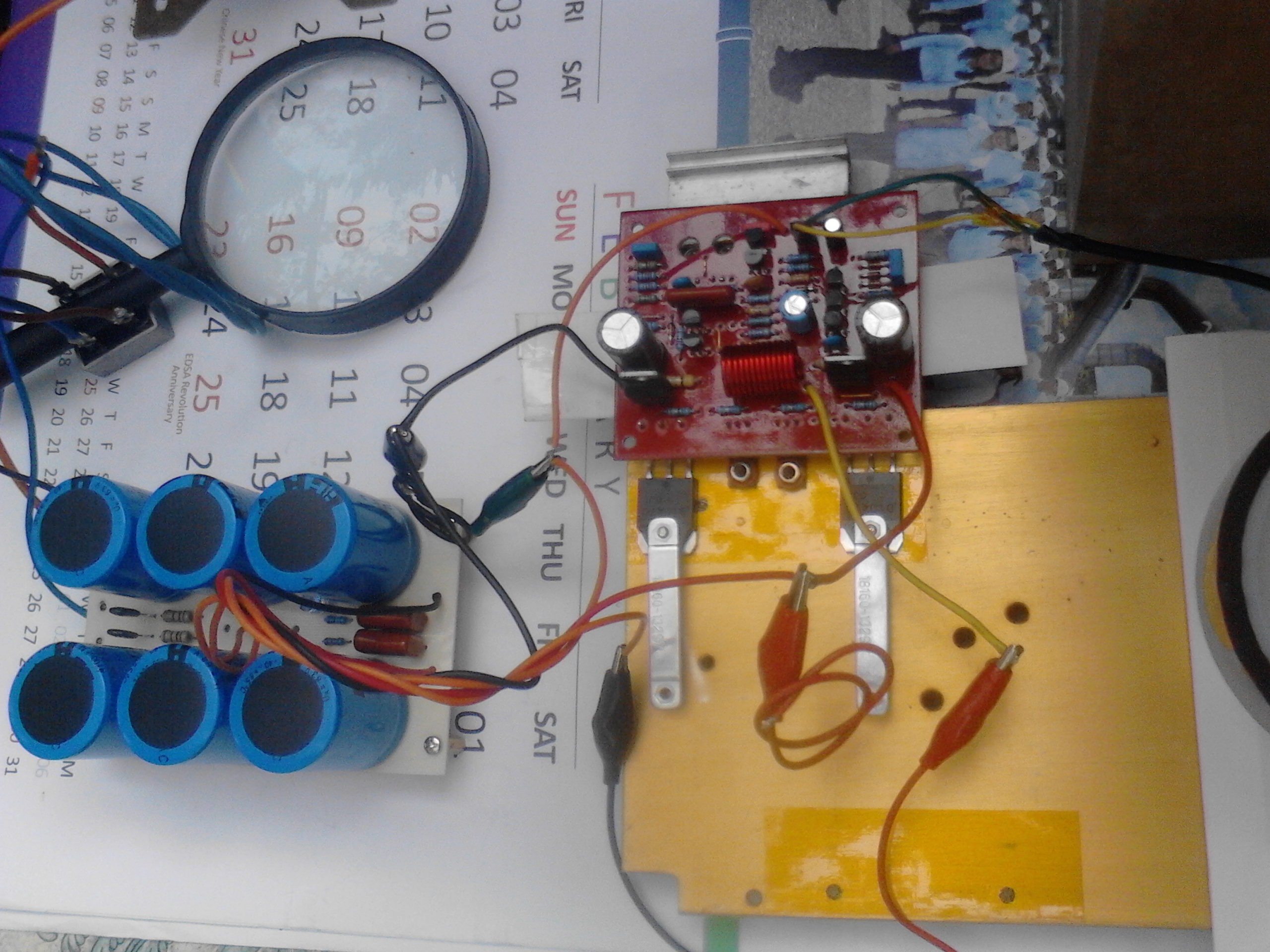

Made these circlophones today. Very compact, exactly 2x smaller in size compared to some layouts that were published here.
If everything turns out stable and nice sounding, than they will be multiplied for crossover amps on each speaker and layouts shared here in forum.
2N3019, these will be replaced by 2n5551 with an additional custom radiators on them.
Few questions, is there a must to mount drivers and outputs to the same heat sink or could i keep them separate (1x smaller for drivers and 1 huge for outputs )?
Can i use MUR2020CTPBF as a barrier diode instead of MBR735 ? 😀 Or there are better alternatives ?
Also there is zener BZXC12L....and BAT85/86, they are either expensive or hard to get...
I have lot of other type of zeners ranging from 0.5W to 1.3W, but ZERO barrier type diodes.
