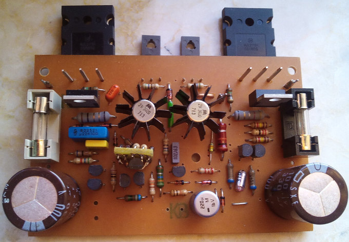

Which version of circlophone did you use? I saw 2sc5200 on your pcb which not for original Circlophone.

I got lots of output transistors to choose from, will try all of them there. Most compact sized will be chosen.
Renu
There are preferable ouput transitors on:
http://www.diyaudio.com/forums/solid-state/209907-building-elvees-circlophone-documentation-parts-accessories-beginner-friendly.html
May be you can check it out. I used MJL21194 and found it is fine to me.
I will try these first then.

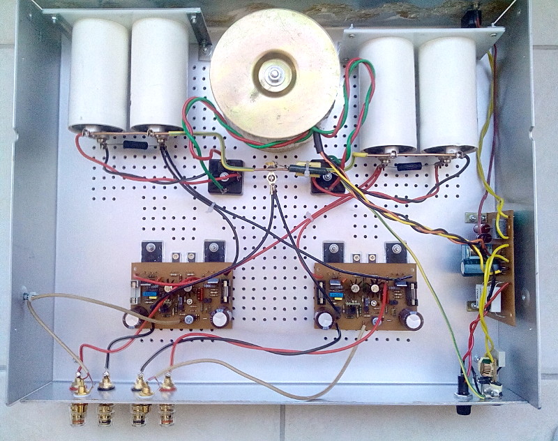

Thank you Daniel for input. My last build is using BC560C as input pairs, Moto 2N3020 (80Mhz version of 2N3019) as servos, Philips BD140's as drivers and MJL21194 as outputs. It is dead quiet when no signal applied but it is a roaring beast when it comes to do its job. When you see it is singing, you totally forget its bias cost. It is definitely worth to 200mA bias according to my last point of view. I believe that I could save extra 50-100mA with proper adjusting but I have no idea about which transistors are going to be reduced to its performance margins and no sure about the affects on all transistors are going to be equal. I could experiment on this subject later but no priority for now. One of my concern about bias was related with cooling because I'm using amplifier case as cooler. I'm using a bigger case (it is actually an electricity control panel cover) with many drilled holes now and heat dissipation and ventilation is quite sufficient.
My Darlington builds was sounding very good also but they weren't dead quiet that seems they required to rework the compensation. That's another thing that I learned according to my experience.
