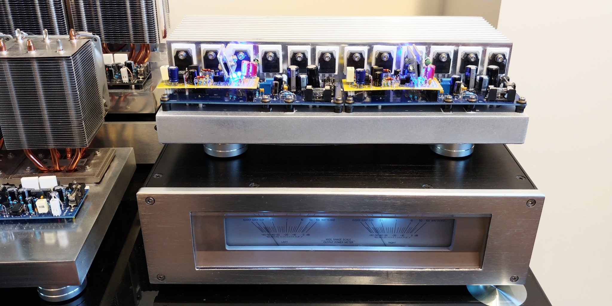

I don't doubt that's no problem but that's something that could be improved easily and since looking at it, I thought I should mention it. The amp enclosure with the chinese dual VU-meters looks very nice, sleek and minimalistic, elegant, I really love that. The amp on top looks nice too, blue fans but not hugely wild RGB, but if you'd like to use it without a case, I'd also mount a heat sink with cooling fins to the front, that would surely look nice.
That enclosure - it's not amp, it's a PSU with VU meters (not Chinese, they are from old Bang Oluffsen), and with speaker protection.
I use this PSU for (almost) all my amps, another example below. That's slightly different enclosure (newer) with VUs from old Technics amp.
Please don't be offended by what I wrote. They (very likely) copied the B&O VU meters but I haven't seen the B&O original.
Both are very nice. And I love the fact you've used the heat-pipe CPU coolers for an amp. Not only is that a very cool and unusual look, that's great use of resources and a very effective and efficient way to cool an amp!

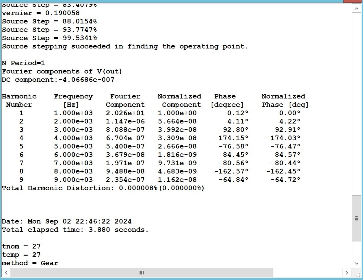

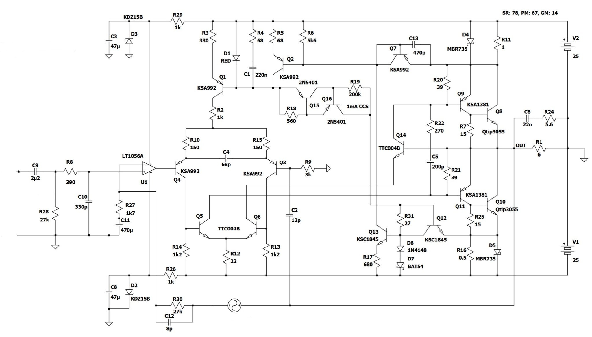

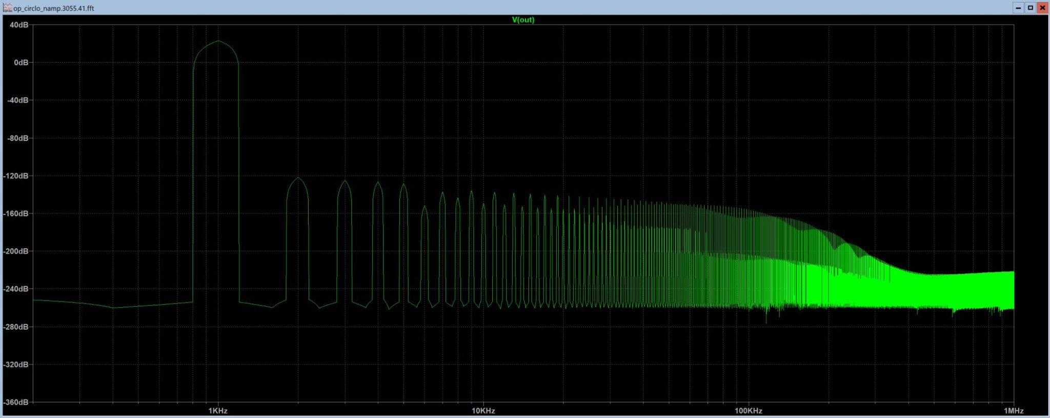

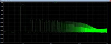

While waiting for a PCB to arrive, I was trying to simulate op-amp based circlophone with cheap output devices, namely QTIP3055.
Rails at 25V, and final results are outstanding - same performance as with bigger MJL transistors (Thd, FFT, perfect squares).
Changes to the schematic were minimal: Zener resistors, and compensations caps: C4, C12, C2.
I guess that's because QTIP3055s are not really that much different than MJLs.
Bigger challenge would be try it with faster outputs, but I guess there is no need.
Even with slow 3055 outputs, the amp is still very fast (estimated Slew Rate at 78 V/us)...
Even if in reality it might be 50V/us, it's still more than enough.

After it's built with LT1056, I'll test TL071 (should work for sure), and with other typical suspects (LT1056, LF356, TLE2071, TLE2081, LT1357, OPA134, LT1360)
I strongly suspect, that with current schematic/compensations AS IS, only LT1056, TL071 and TLE2071 will work without changing anything.
Any chance for testing some opamp models that I linked at post#2474 ? Especially Jellybean types like NE5534. It would be very interesting to see a super slew rate opamp in sim such as LM6171 at the link.
I think the best would be to sim it first.
If I had BJT op-amps in my stash, I would try them, but I don't have any. I was always using JFET opamps.
As for "super slew rate opamps" in audio amps, from my experience (trying E.g. LT1360 with 800v/us or LT1357) in my previous amps,
it's almost impossible (at least for me) to make them stable.
Not worth the trouble. <joke>20V/us should be enough for everybody 🙂 </joke>
The fastest amp I built was 140V/us, and it barely made it to be stable/usable.
So I would say 100V/us AND very stable - is as good as it gets for me.
