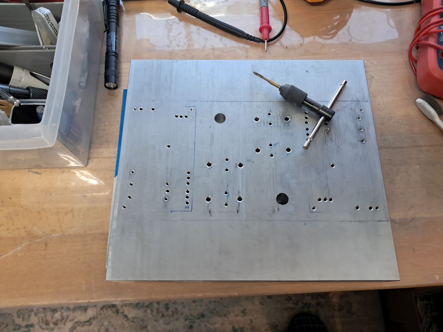

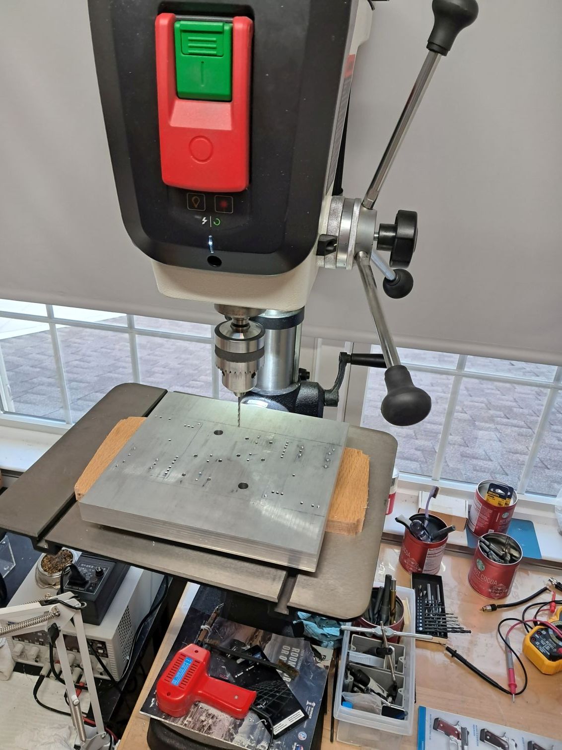

Drilling, taping and the mock-up of the chassis.
Alu slab 9 x 10 x 1 inch
Holy smokes MineK. That right there is a chunk of Aluminum.

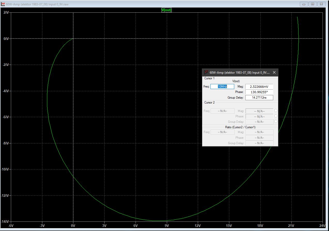

Hi, I see a lot of simulation diagrams here with THD values, FFT's and Bode diagrams. Who uses Nyquist diagrams to see if your amplifiers stays stable even in the Mhz regions?
^Hi,
How to plot the above graph? and what does it says? Can you share an .asc file as an example?
Thanks!
Thanks!
Some theory about stability at this link and this link.
When you do an AC analysis of your circuit e.g. ".ac dec 100 10 10e6" the standard plot is a bode plot. When you right click in the left margin of the plot, you can choose a representation from a list. Choose the Nyquist, that's all. Maybe you have to resize your window to get the picture right or change the X/Y-axe max values.

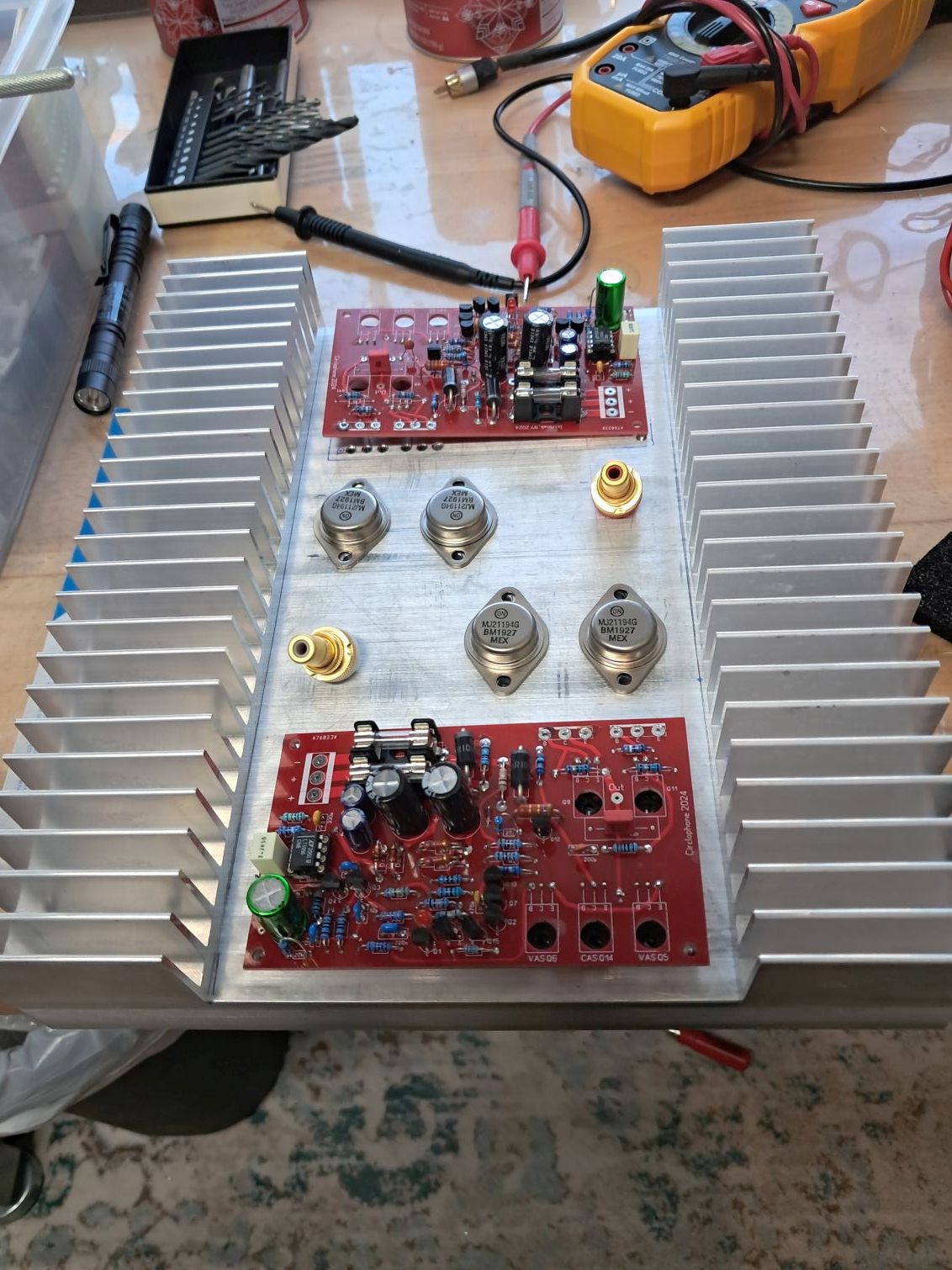

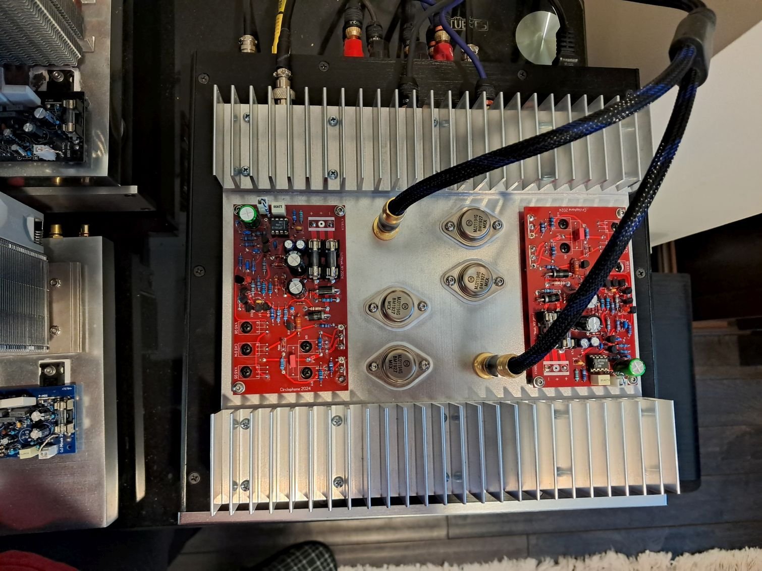

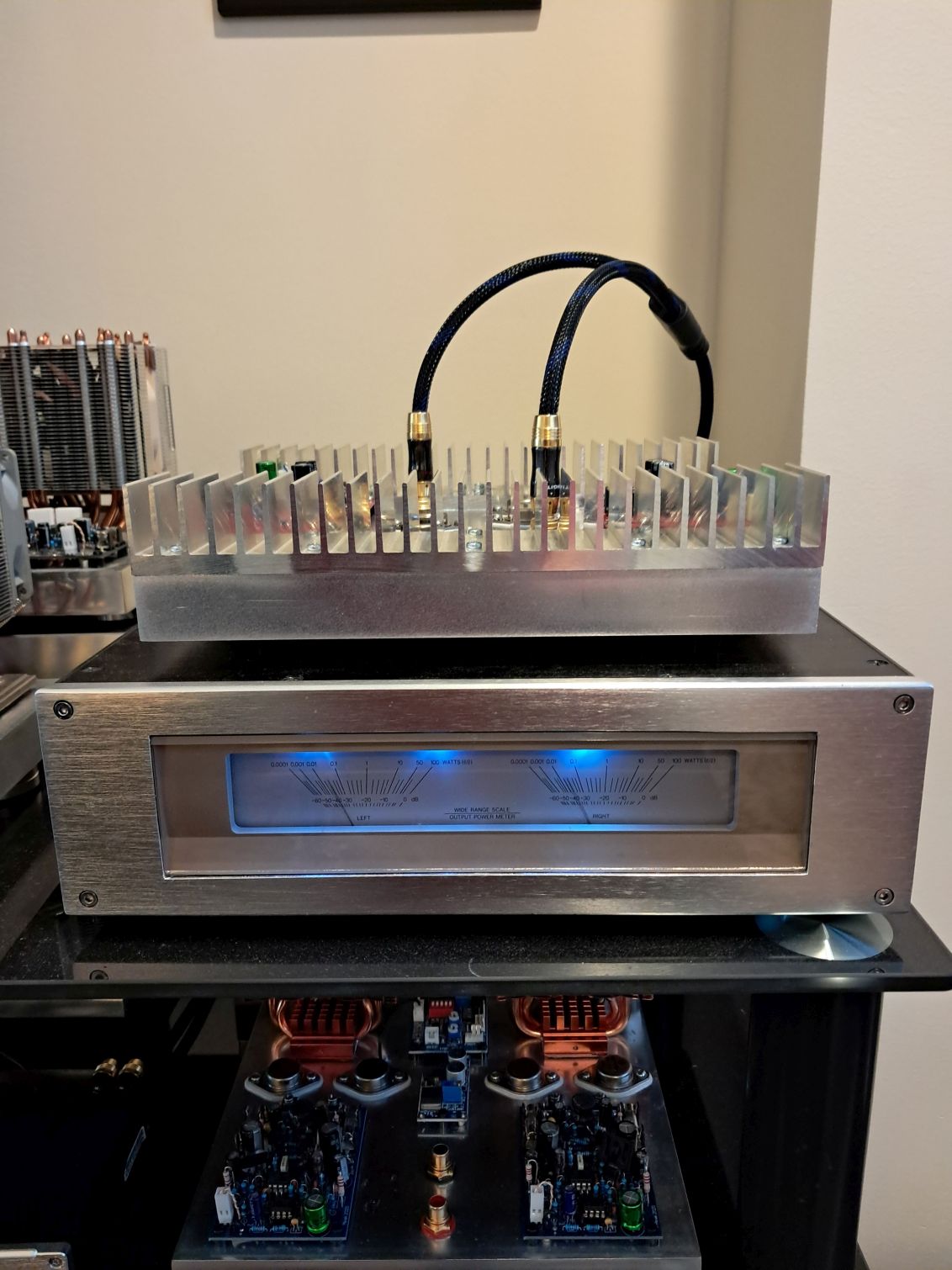

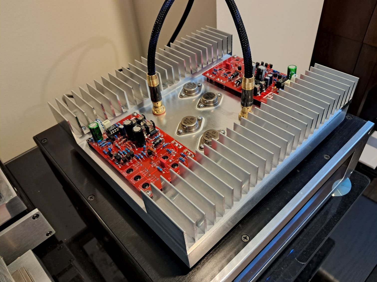

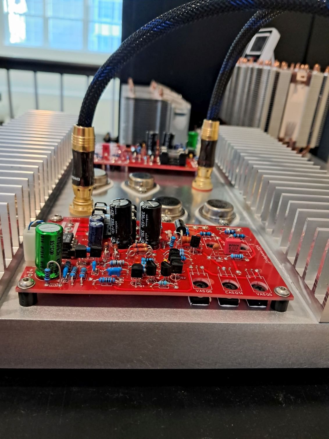

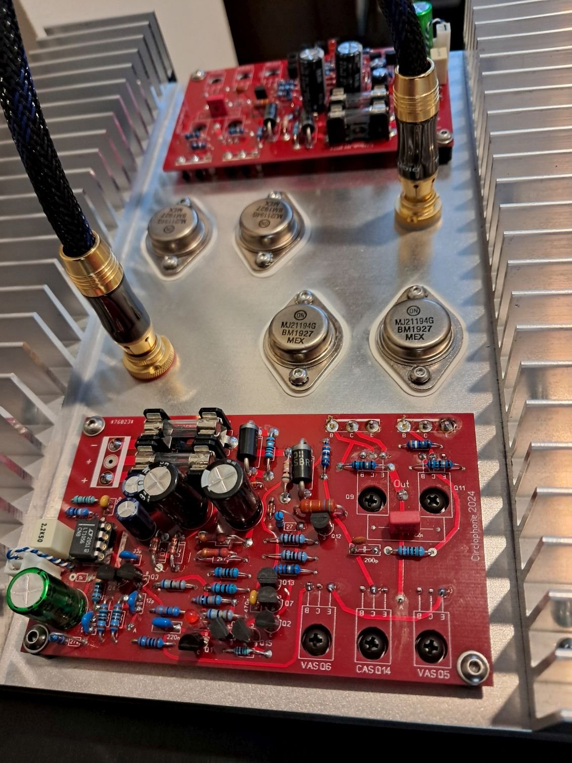

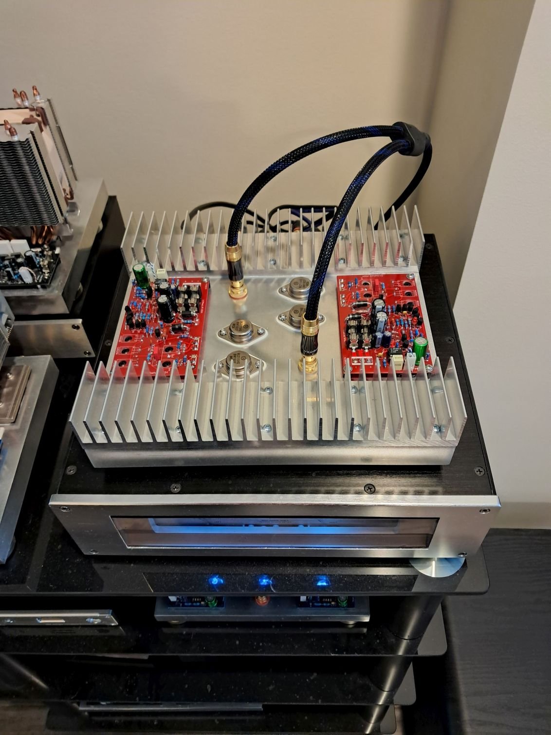

My op-amp based Circlophone is officially completed.
Plugged it on this morning, and it's playing music right now. I compared the sound with the original Circlophone, and:
a) they sound the almost same (but that's true for most of amps..)
b) new one is also dead quiet when idle (no noise, no hum, etc..)
c) as far as I can tell, the sound has slightly more more bass
d) DC output offset is 0.3mV
Schematic as in post #2486 and PCB from post #2504.
It's currently running with 40V rails (maybe slightly less under load).
Under normal listening conditions, this bulky aluminum chassis (1 inch thick slab + heat sinks) is maybe 1-2 degrees above room temperature,
output transistors barely warm.
