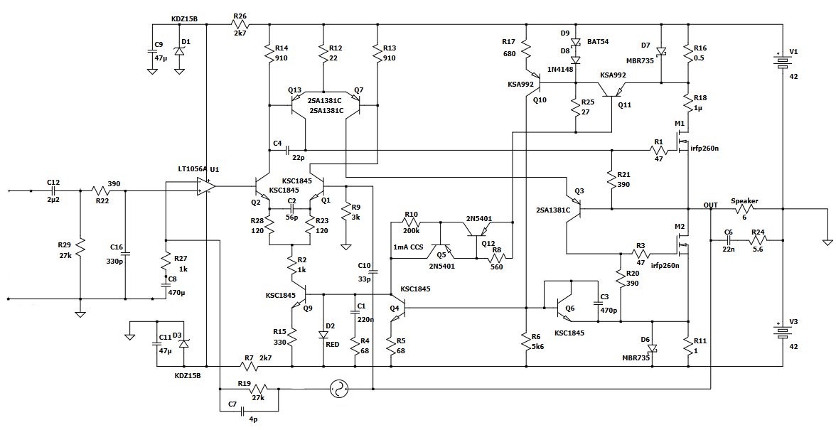

Here is the half-baked HexFet version of op-amp based circlophone.
The whole schematic had to be re-drawn upside down with opposite polarity devices.
Irfp260 were chosen for the output devices, because I have lots of them, and they need to go....
Feel free to replace them with something else, models are available in my spice lib included in the sim.

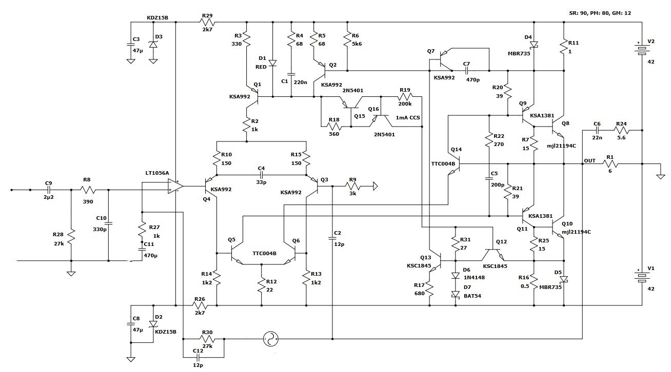

Here is seemingly final BJT simulation that looks promising to test it in real build.
I redrawn some portions of the schematic to make more readable, and renumbered all transistors for backward compatibility with
original Circlophone numbering scheme. One cap was also tweaked compared to the previous version.
SlewRate is estimated at 90 V/us, Phase Margin: 80, Gain Margin: 12, Thd: 0.000018% at 1kHz, 0.00084% at 20kHz.
Square waves looking good, and clipping also is not bad - there is a little bit of latching, but it looks clean, and as far as I can tell, it's
unavoidable with op-amp driven amp.
Any suggestions for further changes?
Re: HexFet version from post 2485: if I replace IRFP260 with IRFP240_ model, suddenly sim looks much better....
Of course the compensation caps: C10 and C4 have weird values for now, the best would be to get rid of C4 completely, and keep/adjust
C7 and C10 only. C10 is way too high judging from my previous attempts.
Regarding the Hexfet version, I think I have proposed a bootstrapped version, to allow the erasure of the Vgs and arrive at a swing amplitude comparable to the Bjt version.
It must be somewhere up there ^ . Maybe someone remembers where to find it.
It would be an useful inclusion for a FET super-circlo
Elvee,
Question (referring schematic from post 2486):
C2 is connected between B of Q3, and output.
Alternatively, it can be connected between B of Q3 and B of Q11. Sim results are the same as far as I can tell.
Which option is better/correct?

Yes, it is. However, the values should probably be adapted to the gate resistors.Was it this one?
If C2 is connected to the output, the compensation is output-inclusive, which should benefit the linearity, and to B/Q11, the loop is shorter which should benefit the HF stability.
If the stability is OK, the output-inclusive option is better (in principle), but in practice I doubt it will make any significant difference

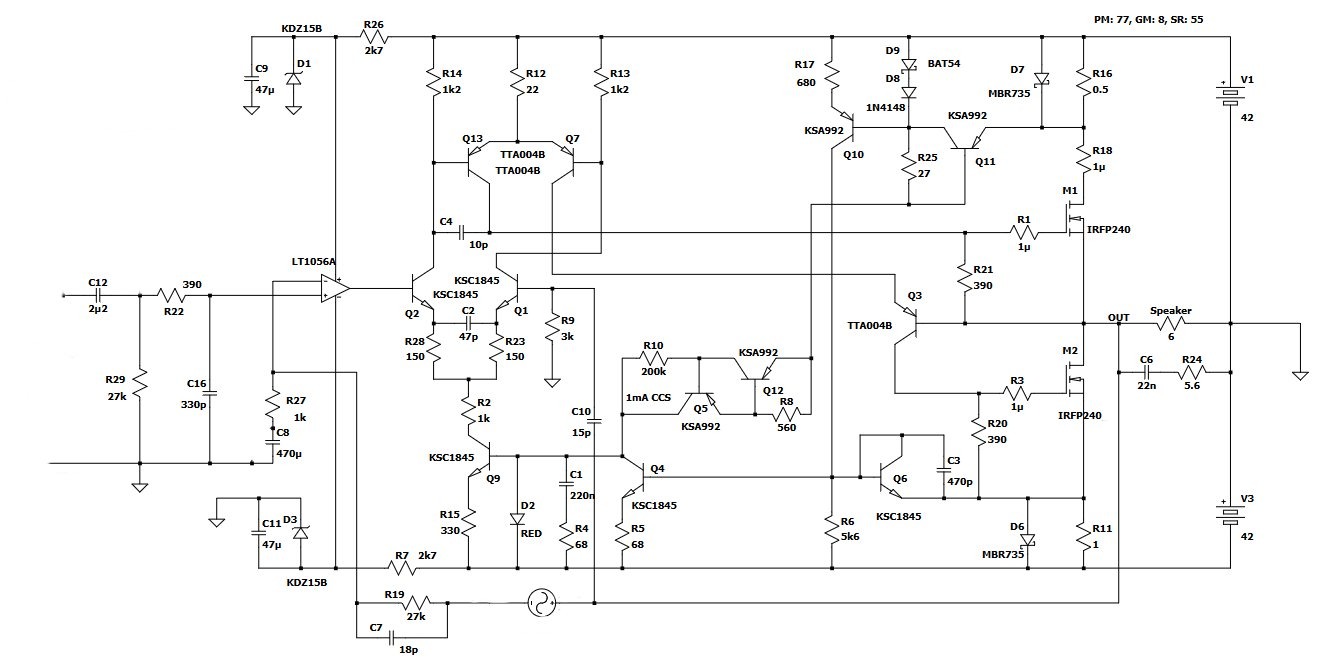

In fact I was not talking about gate stoppers (which should be minimal or completely eliminated if at all possible) but the G-S resistors.
Now that I have located the bootstrapped schematic (thanks to the help of the community), I see that they are 390 ohm, but the bootstrap components are 1K-100µF, which is more reasonable (but there is certainly room for improvement)

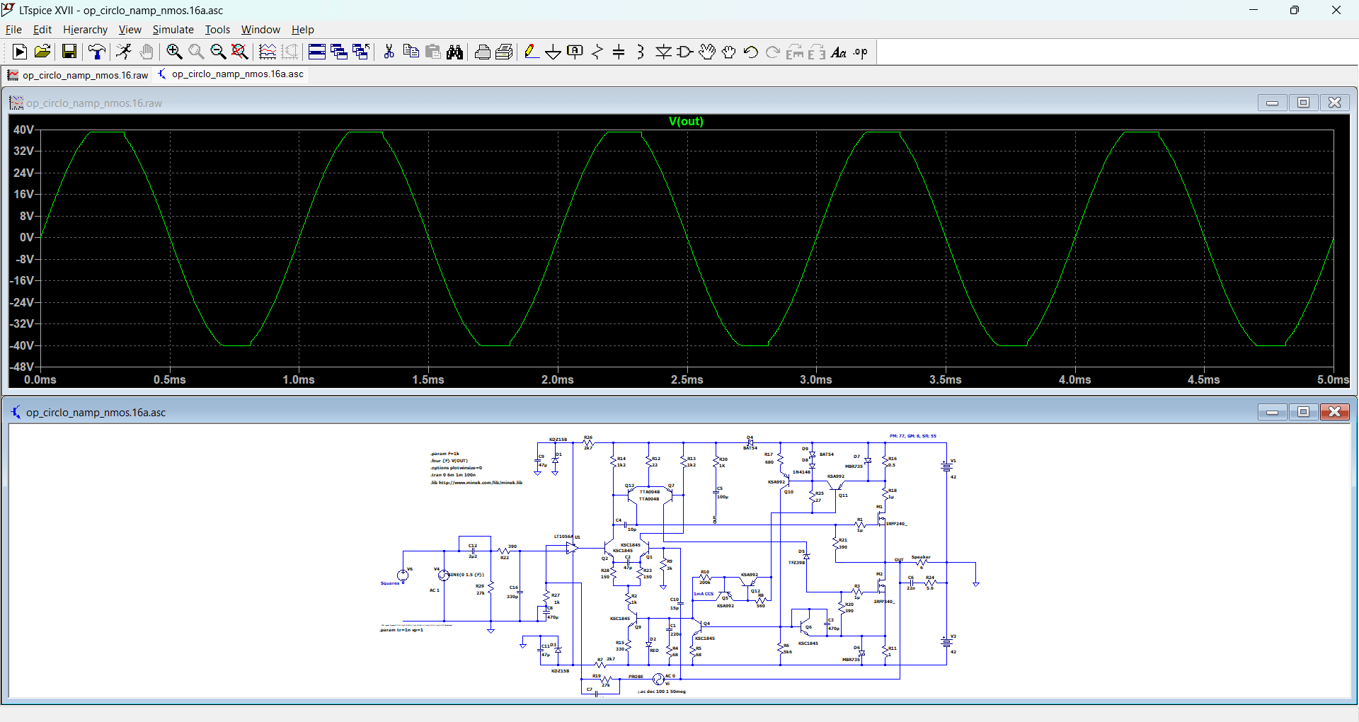

I tried that bootstrap, and I don't see any difference in output swing....
Perhaps because of the op-amp? Or I did something wrong....
Anyway, here is the latest sim of HexFet version, and everything looks good.
PM: 77, GM: 8, SR: 55
Good square waves and stable. No gate stoppers.
Overall results slightly worse than BJT version.
Perhaps you guys can make it better?
I'll focus on the PCB for the BJT version.
PS. Ignore these 1u Ohm resistors in the output. They should be removed.
PS2. I'll still try to re-do this sim with IRFP260 outputs; have to get rid of them somehow....

I suspect that it is caused by Q3, limiting the output to Vto at most. Needs confirmation, I'll make some sims to be sureI tried that bootstrap, and I don't see any difference in output swing....
