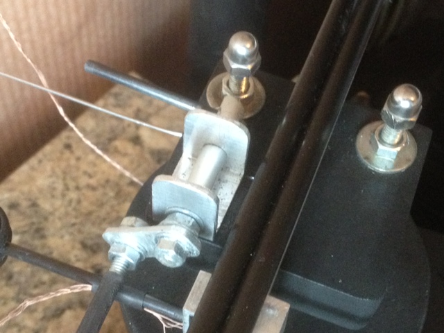

Having reminded myself of my cats whisker test I just refined it a bit. I'm currently running my arm using ball races. These are Boca hybrid-ceramic 3x10x4.
My cat was unwilling to give me a whisker so I used one from my shaving brush, just as good. I superglued this to a rod with 30mm sticking out so that I could be as consistent as possible.
I balanced the arm to zero tracking force. I then used the hair to push the carriage side to side keeping the rod perpendicular to the movement. The first thing I noticed was the deflection was not even for left and right movement. I had levelled the arm with a spirit level as accurately as possible. I have just inadvertently discovered an even more accurate method of levelling. I fine tuned the level until whisker deflection was even then measured the deflection required to just move the carriage. Then using my digital stylus balance measured the force required to achieve the same deflection.
A force of 0.20g was required.
My carriage weighs 50g.
The coefficient of friction for the bearings must therefore be 0.004.
My cartridge has a dynamic compliance of 20um/mN. Static compliance is probably not far from this. A 0.2g force would give a stylus deflection of 0.04mm, not surprising we're finding it difficult to see this with the naked eye on a moving record.
A 0.04mm deflection at the stylus would mean that the cantilever is being deflected by 0.4-0.5degrees. Much more than I had anticipated.
I can't say I'm overly concerned by the level of LTA error as the sound quality is spectacular dispite it and the only way to significantly reduce it would require an air pump and loss of mechanical grounding.

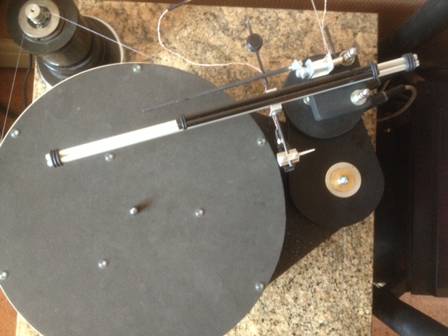

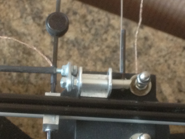

Have been playing a little bit today fitted the cartridge and completed the wiring set it up to give it a test run and can say that it performed well sound wise though it needs tweaking. I cannot tell you how many times I was behind the setup looking for me balls. The enclosed runners makes it tricky to set the balls correctly but I've now had a lot of practice 🙂
Squiffything that's look nice and quite interesting, did you use two "downward" rods or is just one holding the wand?, how did you place the rails inside the main tubing?
Just one, the other in the close up pic is the stem to my spotlight.
The lower rail is fixed into the wood and lays on the bottom of the tube

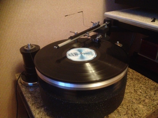

AN UPDATE
Hello Everyone
I've now been playing around with this arm for a couple of weeks and have to report I'm very pleased with its performance. Having leveled everything properly and ensuring the bolts are good and tight on the mounting block, everything was lifted to another performance level. Additionally, the low slung counterweight was very loose on the wand and so I added some 'O-rings' to ensure it was stable-the bass and separation have again gone up a couple of notches.
Wandering balls? Not a bit of it. As long as you are not ham-fisted, there aren't any issues.
Will have a few more ideas when I have the time- Good Friday and the weather in Cheshire super! Will it last?
As an aside-anybody been buying the jazz re-issues on DOL Records. Look them up on Amazon. Superb back catalogue and incredibly cheap. The recordings are superb and the vinyl is ultra-quiet. 150 g vinyl too- got the Miles at Carnegie Hall concert (2 lp's at £4.60 each- NEW) the recording blew me away!!

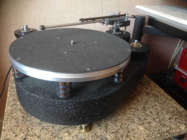

Finally a couple of piccies to whet your appetites.

very nice TT Chris, do you use it for different projects or are you planning on keeping it with this arm?
from what I can see you included a "lift" mechanism, did you make it from scratch or it comes from another TT and adapted to this tonearm?.
Hi
This deck is my 'test bed' as the arm changing process is so easy. It's a combination of an original Gyro platter (with my own weights added) a new Gyro bearing (best I've used) and a dc motor with silk drive thread. It's an excellent deck.
Re the arm lift-made from scratch, works very well and easy to make. I'll post some close-ups later on today.

Hi Chris,
nice build! What's the ø of the tubes? I'm going to give this a shot and will order some aluminium tube, my guess ø is 3 - 5mm...
Hi
The tubes are 6mm aluminium. Top tubes are also 6mm but carbon fibre- I just had it lying around. How does it perform? Flawlessly. I had continual problems using ball races but with this, it has tracked everything I've thrown at it with no problems. And I have a few more improvements up my sleeve-when I get the free time of course!

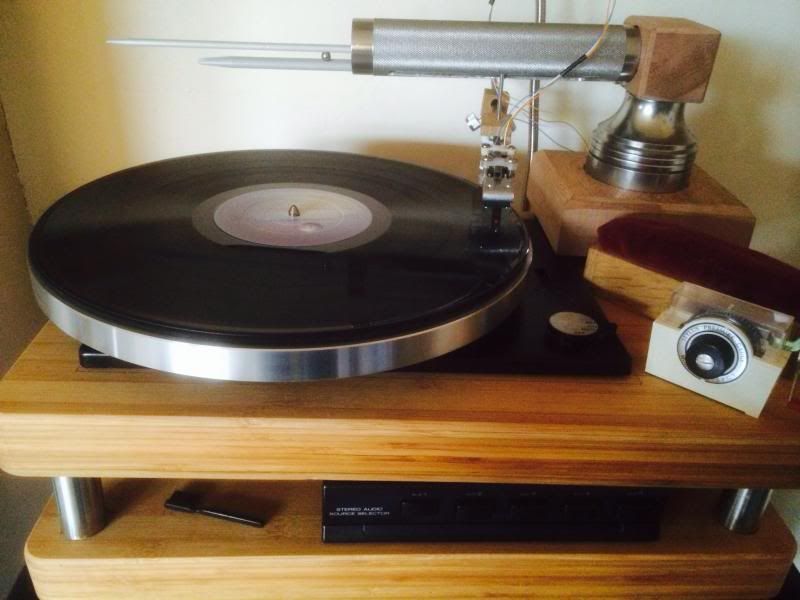

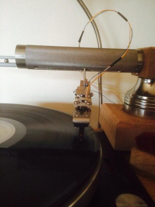

Had a day over the holiday replacing a front wheel bearing on our Ford Cougar. I was rewarded with a job lot of steel balls of a larger size than the ones I had been playing with. Never one to miss a chance to reuse and recycle two of the balls now grace the arm. Works a lot better in my setup and much easier to sort out due to the larger size. Not sure of the exact size but I would say 8 or 9 mm Still sounding lovely and open. Not perfect but I know its the wiring on this one. Once I get chance I will be trying a more flexible type.
