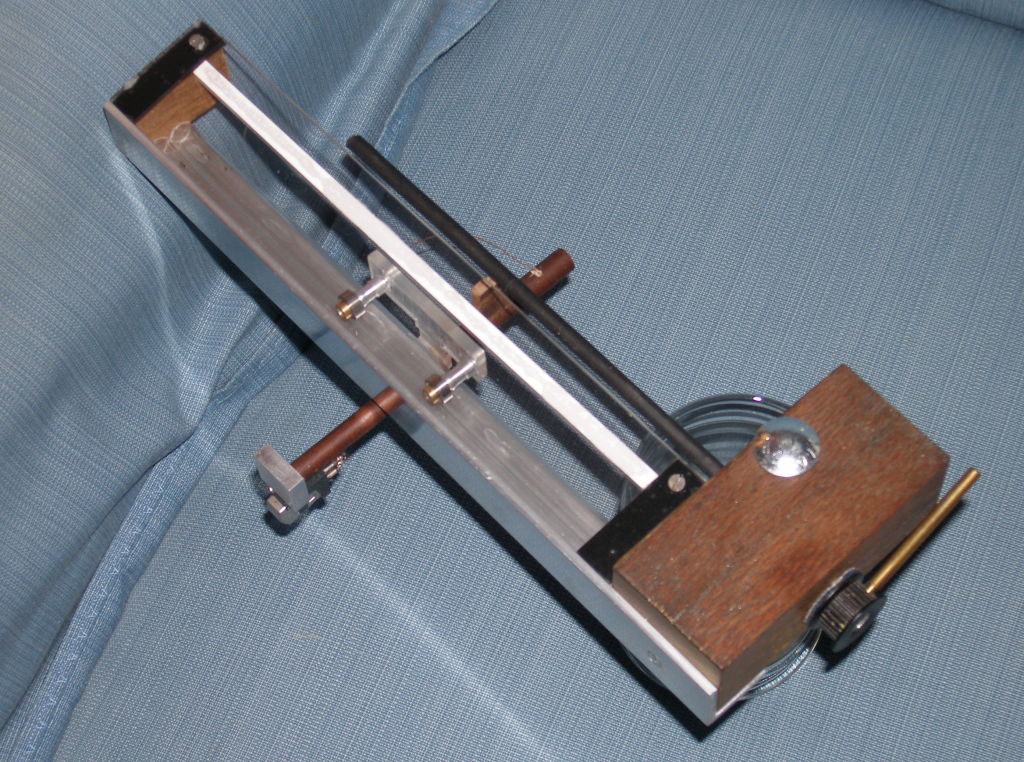

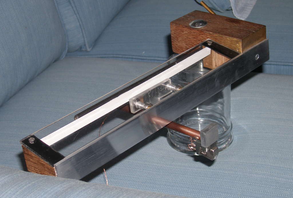

Hi Chris,
Yesterday I put crude prototype together out of stuff I had on hand and spent the evening listening to records. Used the ADC-XLM cart, 4 10mm glass tubes, an old junk 1/4" dia aluminum tube and some aluminnum plate to hold it all together and drop into the mounting stand for my 2 tube linear tracker. Pardon the lack of workmanship, it is all held together with CA and hot melt glue, a real mess! But performance wise it is an outstanding gem! Absolutely the cleanest sounding arm I have (not)heard. Those 2 balls in intimate contact with the tubes and with enough mass to keep it that way eliminate (imho) all additions or subtractions to the recorded signal. The transparency is amazing. What was that about hairs on the back of neck? Tracking is flawless so far.
Are you using smaller diameter tube/rod for the carriage? With my 10mm stardard weight tube I'm getting about 45 grams for the carriage alone. 61 grams for the whole carriage, cart/wand,cw. Tracking pressure is 1.6 grams. I'm not aware of any problems due to the heavier carriage weight.
Tracks like a champ. Put a small felt disk about .200 inches thick under a good record and let it play. That is a substantial warp. I was aware that the sound during the warp had something not right about it, but I couldn't detect any change in pitch wow. Listening to the "warped" record was clearly possible and not unpleasant. I think the 2 ball system recaptures the benefits of Colin's 4 bearing 1 tube design while eliminating multiple contact points and loose bearings etc. This design has 2 balls with 8 contact points total. The small ball bearings we have been using have 5 balls with at least 2 of them in contact with 2 races. That adds up to about 32 contact points for a 4 bearing 1 tube design. Maybe half that for a 2 bearing Cantus style arm. Going to try to include some pics now. Two of the pics are of the 2 tube 2 bearing design. The other one is the 2 ball design.

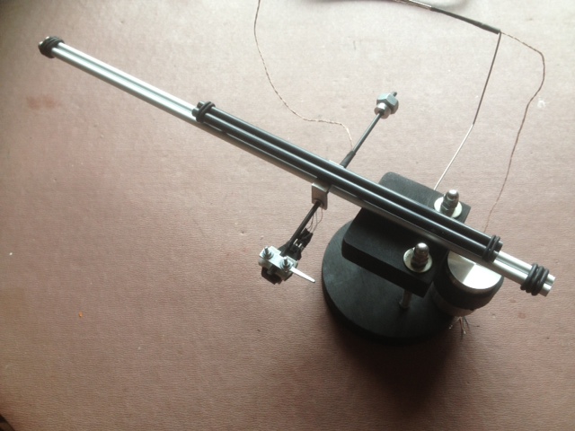

Hello Everyone
As you can see, I'm getting very close now. The base is quite clever (or so I think!) and is very stable-it also allows for easy adjustment. Final version will be more aesthetically pleasing. The wire you can see on the side of the mount is for holding the pick up wires. The cartridge will be mounted in the same way as I have done with my version of Colin's design. By the weekend-up and running and will then report back.
After hearing Bill's comments, I'm really looking forward to this one!

It's amazing how three different designs of the same principle are coming together and seem totally unique in the approach. Glad to hear yours is sounding so good Bill. Are you going to turn it into something more permanent?
I like your cut down F1 approach Chris. I wondered about what the weight would do and how much strain it would place on the stylus tip but pleased to hear from Bills report that its able to cope. Had a busy weekend so couldn't take mine further yet but hope to get something sorted over the next few days

Hi Chris and Niffy,
Interesting thoughts re diamond shape etc. 2 wheels and a diamond frame, are you guys building a bicycle?
I've been thinking on a light weight very rigid wand configuration as well. For my gussied up 2nd generation of the 2 ball system I really think I will go back to Bo's 2 thin wall tubes spaced further apart at the back end. While the proposed hypotenuse from headshell to one end of the moving member will for sure stiffen things up, I suspect you are slaughtering mosquitoes with elephants. Give it a go anyhow.
Given my higher mass carriage (which may even be a bit on the light side) but will certainly give extra rigidity, and add a Cantus style arm wand methinks we will have an optimum design. Just when I was being convinced that a simple short CF or aluminum tube was all that was needed. (sigh)!
