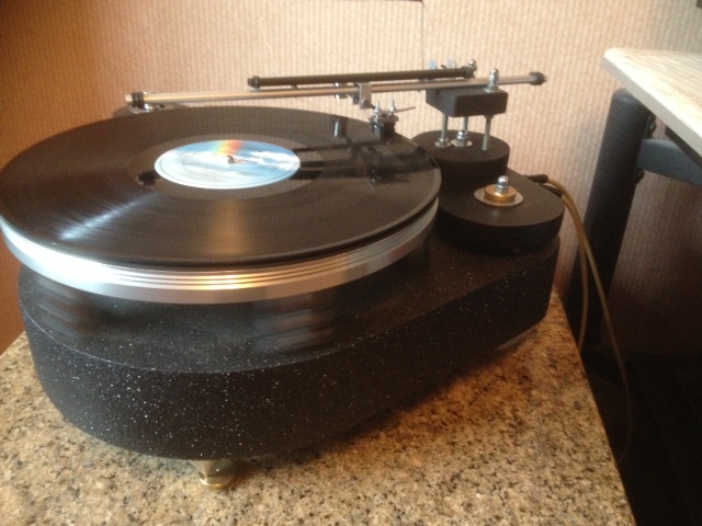

Hi Chris.
That's a really elegant arm you've made, both visually and in terms of engineering. This must be the simplest arm design ever, and there's a lot to be said for keeping things simple. I think Colin's design of square headshell and low slung triangular counterweight would work really well on this arm, both sonically and aesthetically. I might be tempted, looking at your photo, to make an arm with twin arm pillars, one at either end of the long rail. But then I might just have German blood in my veins as I seem to share this nation's love of over-engineering.
Niffy

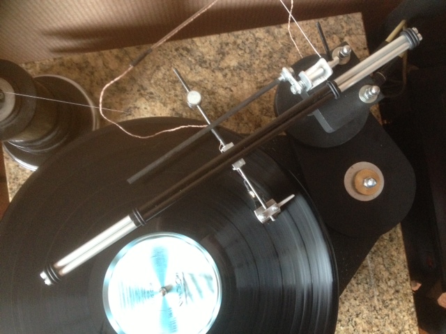

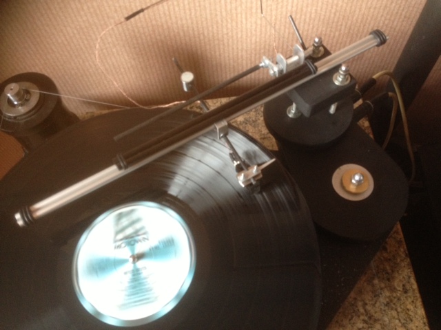

Arm Up[ and Running!
Guess what Guys? It works! And it works excellently! I still need to adjust it properly and ensure that arm height, geometry etc are all correct, but I couldn't resist just trying it out.
Only one downside- I lost a ball (!?) when adjusting it on the deck-thank goodness the 10 I had ordered from EBay arrived this morning. However, once set up I don't think I'll be having any more losses (fingers crossed)
Chris 🙂
- Tracking-very smooth and sure footed. It moves so much more smoothly and easily than with the ball races. The tracking weight is also much easier to adjust as 'up-down' pivot motion is much free-er (!)
- Bass is excellent-immediately noticeable after a couple of bars.
- Stereo imagery is improved and images are more solid.
- This arm has a lot going for it
Chris 🙂

Perry's Questions:
Hi Perry
Hi Perry
- Rails are 340mm
- Carriage is 180mm
- These dimensions give plenty of movement across the record
- The carriage is carbon fibre tube-reason: I had it lying around
Very neat Chris lovely example of the concept and once again a very professional looking execution.
Hi Perry
Chris
- Rails are 340mm
- Carriage is 180mm
Thank you.

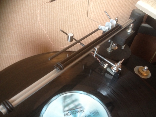

Rigged up a version of this using 6mm glass tubes and 4mm balls , there is a weight limit definitely to how heavy you can have the top tubes. Surprisingly enough contrary to what I would have thought the lateral friction is not lower than my radial bearings and with the added weight of the sliding mass on off center records I am noticing the cantilever skewing as it stops the added mass to swing the opposing direction . Perhaps I'm in the minority here but if anyone else would play an off center record and watch the stylus it would be much appreciated 🙂.
Colin
Colin

When I was testing my original bearings I knocked up a simple test rig to test relative bearing friction, as your arms have the centre of mass well below the pivot this should be very simple to try. With the rail set perfectly horizontal balance the arm so that it has zero down force. Then using a cat's whisker try and push the carriage from side to side. Look at how far the whisker bends before the carriage starts to move. It's a good idea to cut the whiskers tip off so you can more easily ensure that you are using exactly the same length of whisker for subsequent tests. If you don't have a cat a bristle from a soft brush will do. This test is much easier than trying to see a microscopic cantilever movement on a moving record.
Niffy
P.s. I did use a naturally shed whisker.
Niffy

Hi Colin
I'm surprised about your comment concerning lateral friction-On mine I have found it significantly less-and I don't believe I had poor ball races on the other arm which worked very well. However, my carriage (top tubes and arm) only weighs in at 12g anyway and glides across very easily indeed.
Chris
