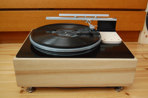

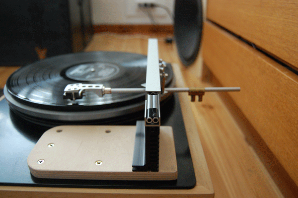

Here's my first mock up with broken cart. My balls are too big! 😀 (from Geomag). I ordered 3mm, 4mm & 5mm chrome balls. There's still some work to do before I can try it.

That's only a problem when you sit on a broken plastic chair!😱
Looking very slick Pete🙂
Ball resonance and interaction with rails (or rather rail material) will obviously be a significant factor here - eager to understand your findings when you try the different sizes. BTW, did you weigh your carriage? Interested to see folk's thoughts on different carriage masses (although so far, wand + counterweights are additional factors too).

I have mine built.....unfortunately I've developed a problem with my tone arm wires.....AND one side of my phono stage is gone.....*Poof*
I did mange to "watch" the album spin with the cartridge/arm on it.....lol.
Very smooth movement, even with an off center album I tried.
My bottom rails are solid Pyrex tubing, the top rails are carbon fibre tubes, same as the wand itself. The bottom rails sit on a flat piece of aluminum with a small
carbon rod used as a spacer. This separates the bottom rails a bit to let the bearings "seat" deeper in the groove to stabilize the arm when manually moving it back and forth. Seems to work, but I've spent my fair bit of time on the floor
searching for bearings.
Its pretty well a knock off of ChrisG design, but it seemed to make sense to me.
The arm weighs in at 42.8 grams with the Sumiko cartridge and counter weight attached.
