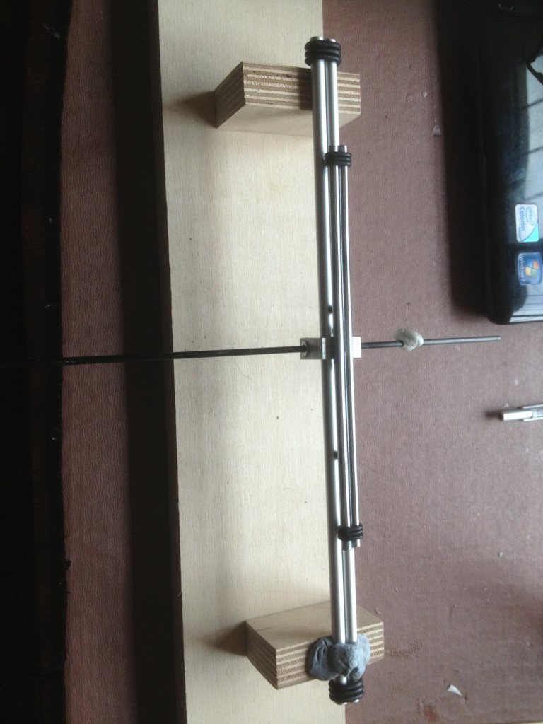

Well project number 1499 has begun 🙂 a couple of hours down the shed following a few ideas running around my head and its coming together. Based on Soyuz' idea the base, bottom runners, balls and arm are semi sorted and dry fitted to give me a feeling of how it'll look. What the initial opinion guys?
Still got plenty to do and the head-shell/cartridge holder may be changed depending on weight.

It's amazing what can be done with a £10 torch, a couple of old mouse balls, some scrappage wood and a few knitting needles 🙂 I can't wait to hear how it sounds but I've still got to cut a slit down the length of the tube and set the upper rails. Then work out the best way to attach the drop arm for the headshell to attach to it
As for the use of wood I've got an idea to use bamboo to match in with the turntable 🙂
I have a very straight thin piece and I know its lightweight so would suit this job nicely. The wiring doesn't need to pass through which also lends itself to use it. Either that or a carbon fibre arrow shaft very thin and light.
I think the mouse balls may be a little too large for the job (it was a big beggar of a mouse 😉 )
The wood body should allow me to fit some type of arm lift contraption though I'm still thinking on how I'll deal with that. And I'll need to arrange some kind of wiring harness. I think the base will have to have a wooden plate under it so will probably fit a couple of RCA connectors on that. As it is at the moment it's a little top heavy so it'll need a support of some kind. All good fun working out the solutions to the problems. Thanks again Soyuz for the initial idea.
I've been working a little more on the arm having received the steel balls through the post. It's still in dry fit mode so its not totally set correctly and the cartridge and wiring need sorting out but I put it all together to test the theory. Damn it works and is very smooth and light running. I went with the carbon fibre wand as the lighter stronger option and 7mm balls as opposed to 5mm
The arm can be adjusted for length and I may need to shorten the drop arm to suit the table which is a fairly simple job. I'm pleased with how its going.
when I was testing for the first time I was happy to see that the carriage was very light with very low drag BUT when I started doing the wiring things got bad, the wires added too much drag and I realized it is a critical part of the design if I wanted to get the full potential of the arm, I ended up using solid core enameled copper wire I don´t know the exact diameter but is very thin (I had it in my workbench) other thing I found was that is a bad idea to do the cabling trough the wand so I did it directly to the pins of the cart, I know that a lot of tonearms are made the other way but in my case the experience was not good, I also twisted the wires of each channel to get a better noise rejection and that works well too, in any case I got the least movement interference doing an arc above the arm with the cables something like this (BTW mechanically I did not like thais type of cable at all)
The cables are through the arm at the moment purely to keep them out of the way. My intention is to have them loose as you suggest to allow the least resistance to the flow of the arm. It's surprising how stable it becomes by just hanging the arm to the top runner. It all came together once it was in position.
Next job is to fit a cartridge and to measure it up on the table so that I know how much drop it'll need. Then it's fitting it all together as a hard fit and to get the angles sorted so that the top runner is level on the vertical. The arm itself will probably need to extend forward a fair bit because of the setup on the table. I can't wait to see how a cartridge plays on this arm.
