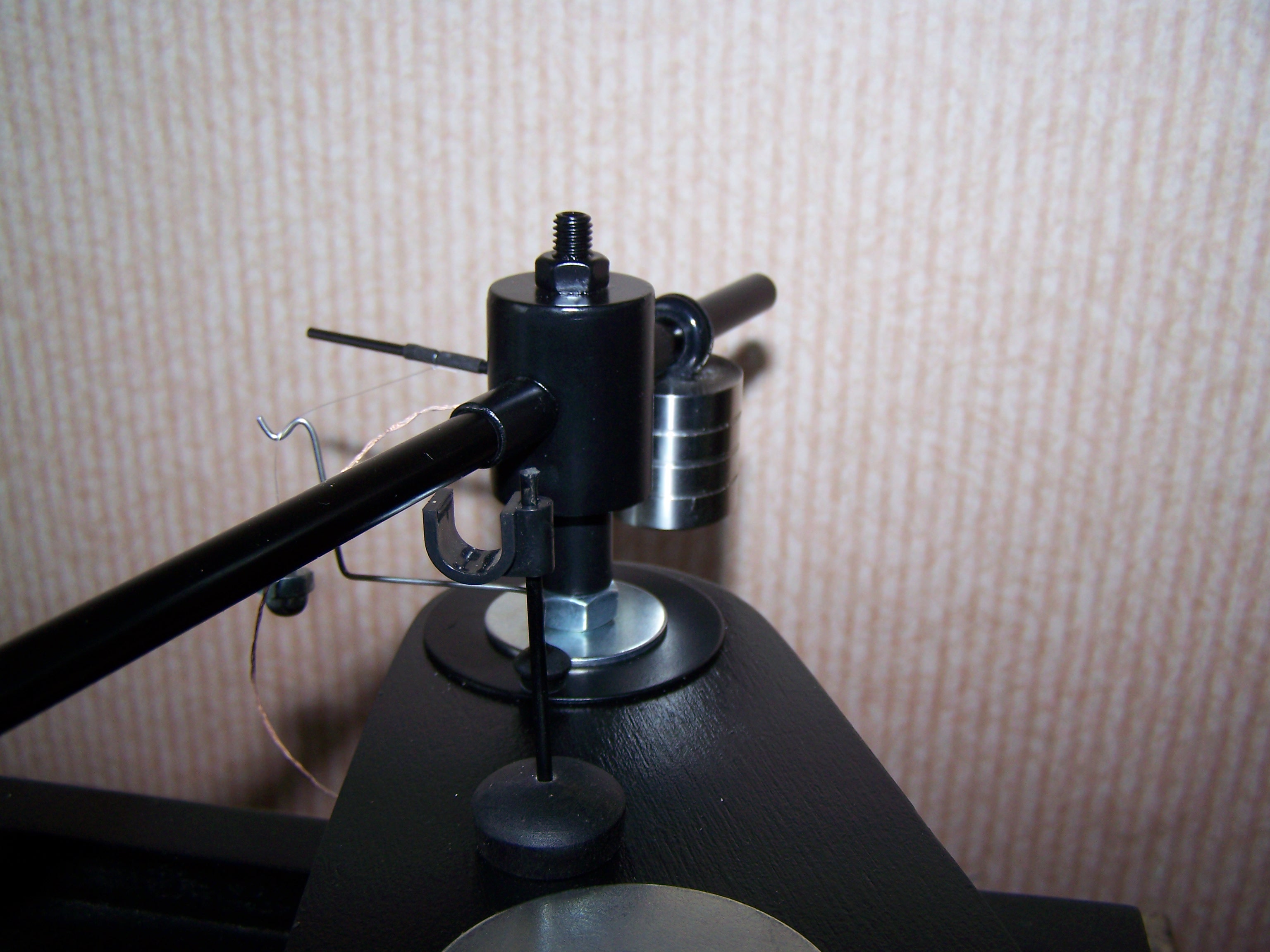

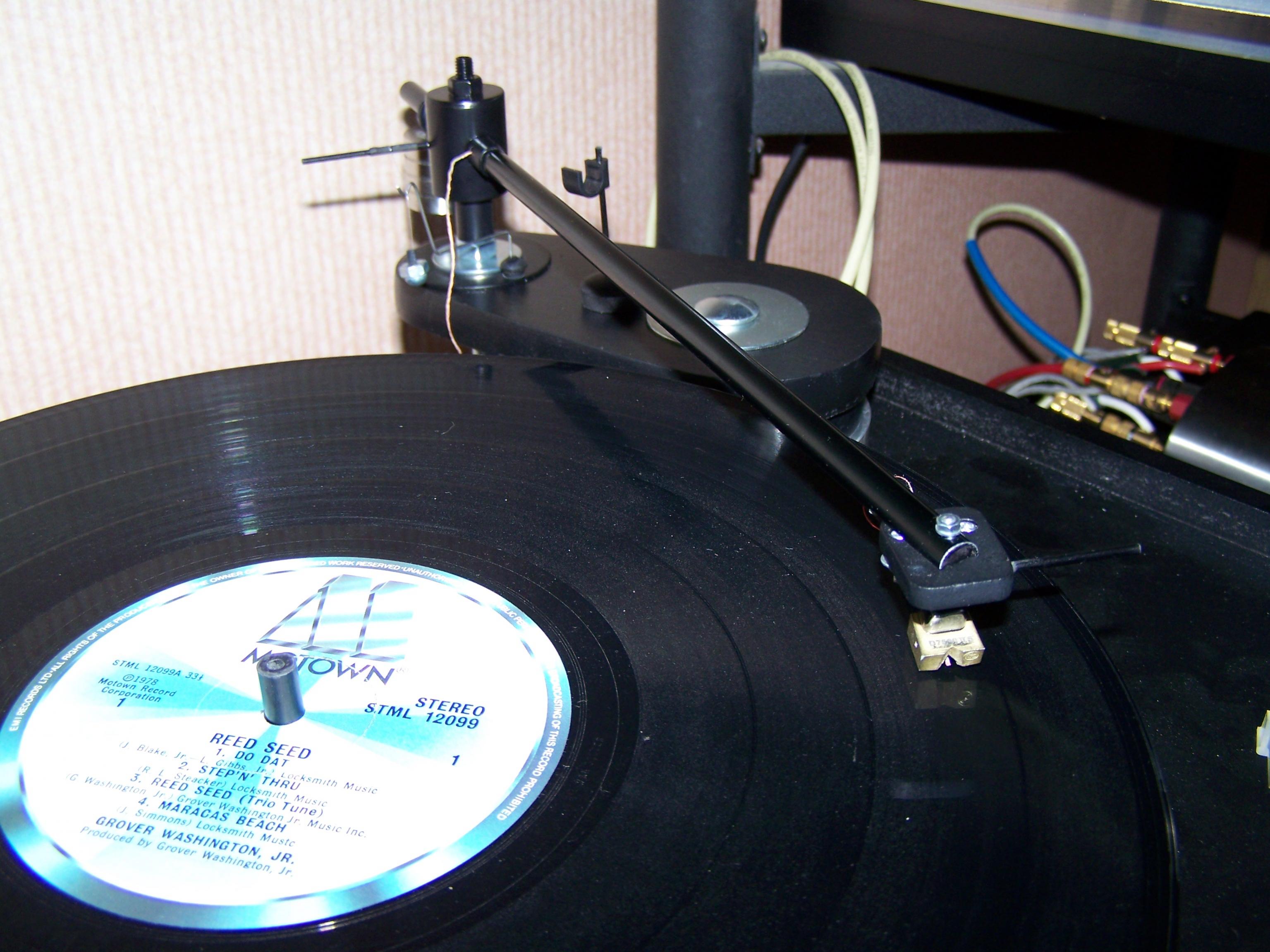

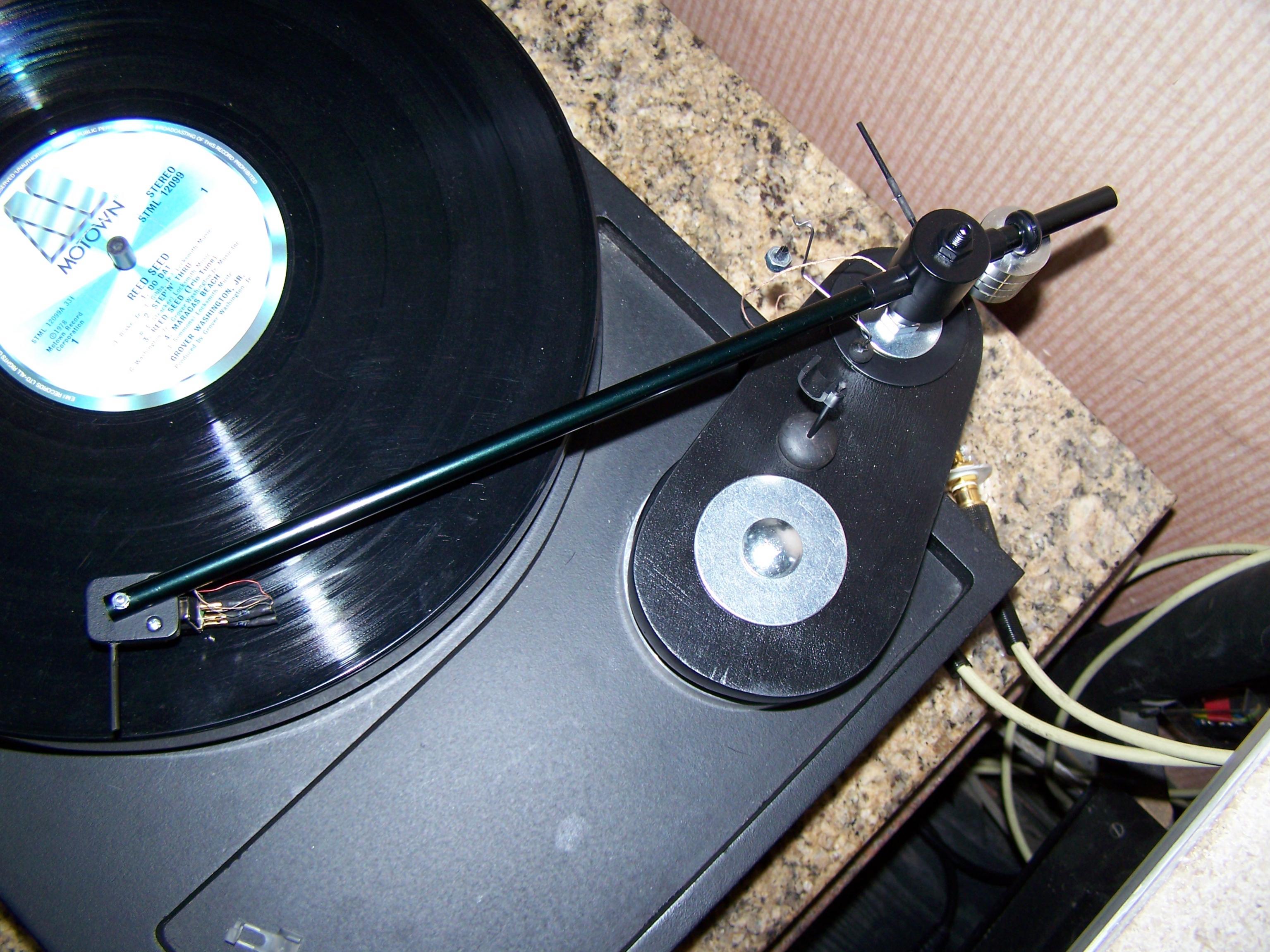

Stealth Mk 3
Hi Folks
I've been a bit quiet lately as other projects have been taking up my time!! Anyway, I keep going back to the unipivot, and, whilst walking our pet Choccy Labrador, came up with this design. It might remind you of another arm-forgot the 'naim'!!
It's quite a re-working-the pivot is much more in control than my other efforts-still one ciontinuous arm tube with no breaks or joins. The ball point nib has been replaced by a 2mm ball bearing-I've used this on other arms and found it very good indeed- and it means I don't have to mess around with that awful ink that gets everywhere when you start to cut up the refill.
I'm currently tidying up the pivot on a second version which doesn't have the protruding set screw and nut on the top and looks a whole lot neater.
Sound quality-I never cease to be impressed- I'm never going the commercial route ever again.
Here are some pictures- I'll post some of the 'refined' version when complete.
Hi Folks

Chris:looks very nice. Not what I would do, but different strokes for different folks...it appears that you are using the top bolt has a holder for an "upside down" pivot vs what I do. And the mass about the pivot (a deep cup?) can help with some lateral stability issues, but if carefully done the original style works just fine. There are other means to this end that I think are somewhat more elegant than a typical oversized "cup", although many manufacturers did just that with unipivot type arms.

Now regarding damping:
Ff course there are a few ways that this can be accomplished. External mechanical, fluid and internal mechanical (such as the Funk Firm are but a few. For me when I calculated the effective mass of the tonearm, cartridge, mounting screws and wiring, I ended up with a Fs of something in the order of 8-11 Hz. As is I haven't tried any dampening method, nor any anti-skate. I can say that dampening may help, particularly if the mass of the arm or if the cartridge/mounting screws etc., are much heavier than mine. Now of course in those situations may help. Where minimal damping is required, carefully located O rungs can be added, or pure latex liquid theatrical paint, or even specifically applied heat-shrink tubing.
hi guys,
thought I'd come back in and check things out as I haven't for some time.
jackinnj: As I don't have a subscription to Linear Audio I can't really comment. I'll PM you though...
Calvin: I am not against the use of carbon fibre. I just do not have the capability to ensure that any possible airborne particles do not make it into my lungs and thus caution all regarding the risk involved when working with carbon fibre. I also do not believe that it can provide a benefit as it may be much too light when using typical cartridge, mounting screws and wiring.

Hi Stew and Chris,
I did some thinking about de pivot, and came to the conclusion that using a bigger pivot housing, you'll be able to lower the center of gravity, thus creating a more stable arm. IMHO this works the best with and normal ( not upside down) pen nib pivot.
Grtz, Mark

Hi Stew and Mark
No-I'm not using the pivot 'upside down. What is protruding from the top of the housing is the grub screw which has the cup-the pivot is attached to the arm pillar as with all my arms. I don't believe the design is adding or taking anything away from the performance compared to my original efforts. What I have been trying to do is improve on the aesthetics.

hi guys...
Chris: OK so you've got an adjustable height pivot that moves the cup, which within limits is useful in designing and experimenting. with. When I designed the arm (even though it may look like there was no design involved) I conscientiously did a little math and paid attention to a few details that (to my way of thinking) results in something that approaches an inherently balanced tonearm. The manner in which the cartridge is mounted and the location and use of the "hanging" weight is not an accident.
Mark: Using a bigger housing to hold the cup ("right side" or nib pointing up from the stationary postup) is not the only way to accomplish this. As long as one ensures that the cup is above the radius (as seen laterally), the CofG is guaranteed to be lower than the pivot.
To this end I took great pains to set the pivot slightly higher than what I thought was ideal so that the CofG was slightly lower than the pivot. As the arm is then inherently stable. Think of it like a teeter-totter, but with one side slightly heavier than the other.So out of proper balance, but no far gone as to tilt the teeter-totter enough for it to approach the ground. It will then take almost no additional mass to move the slightly heavier side towards the ground. I actually looked at the mass I was using for a counter-weight and calculated where I might like to have the pivot , so as to allow me enough tracking force while still allowing space for the counter-weight. It wasn't all fluke 😉 . If I were to use a lighter counter-weight, then I'd need to make the back end of the arm longer.
Hi Stew
Good to hear your thinking on this. You are correct about the ability to experiment with the pivot on my arm.In the configuration I have ended up with, I have achieved more stability than with my other arms-and from experience, more than with arms made by Hadcock, Opera Consonmance (I've been experimenting with their 12" unipivot) etc.I'm currently building a 10" with the grub screw not protruding from the top of the housing and it looks much neater.
As I'm writing this, you have triggered off another thought which I'll experiment with-ah 'Happy Days!!'

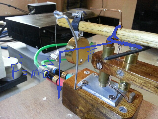

Added antiskate to my 219:
I am thinking of refining the anti skate mechanism. I didn't use any science while making mine. The slots are cut at 5 mm intervals, the weight as you can see is from a bolt, hung on the thinnest fishing line I could get (not supple enough). In other words, the weight isn't calibrated.
Any idea how I can have precise calibrated weight when placing the string on slot number 'x'? What are the calculations involved? Spacing of slots? Length of string? Mass of the hanging weight?
Kindly advise. Thanks in advance.

The 219 does not require anti-skating, but a convenient azimuth adjust...
... would be nice.
Okay, if anti skate is required or wanted here's a thought. Usually anti-skate is approximately 1/10th of the tracking force. Most adjustable anti-skate mechanisms use this as a starting point.
Remember that anti-skate is a force and actually acts as torque. So:
T:= F X r [eqn1]
And
F= m ∙ a [eqn2]
Because we can't change [eqn2], that leaves [eqn1]. Keeping the mass constant, that leaves r. Increasing r will result in more anti-skating force, else the mass must be increased.
Your picture actually allows for an azimuth adjust, not anti-skating. I'm attaching a jpg that shows the scheme required.
Regarding string, just use good thread. I often use upholstery thread to good effect

Thanks, Stew. Let me chew on this and try and digest it.
I'm still not clear how hanging the thread on a particular slot affects the torque. I understand that the more distant the slot from the pivot, the higher should be the torque.

jls001,
Moving the string will increase or decrease the length of r. Increasing the mass, m will increase the value of F. But as vectors they don't "add" in the usual way, they follow "vector mathematics".
Anti-skating must be to a pure lateral pull in a uni-pivot such as the 219. If Gimbal bearings are use in a tonearm, then the "anti-skating arm" can be rigidly coupled to the arm in any lengthwise direction (compared to the arm tube). In a uni-pivot, the force must be applied laterally so as to not "twist" the arm towards the "anti-skate arm".
If you like I'll do a very quick sketch that might help you see this more clearly (if need be).

The lateral pull explanation makes lots of sense!
You're right that what I'm doing now is actually skew my azimuth.
Kindly make the drawing. I need to change it to the more correct arrangement.
