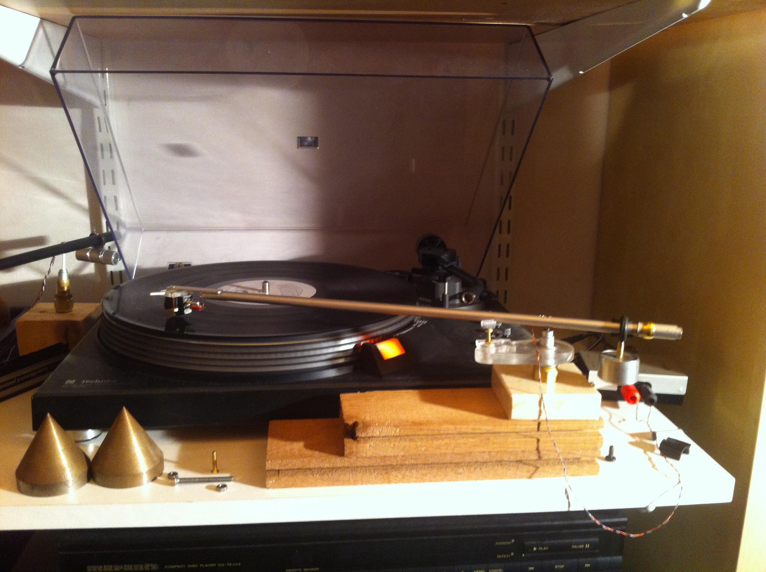

an armlift solution.
This is what has stopped me from pursuing this as a commercial design. I could buy complete tonearm mounts with an arm lift, but they are a little on the expensive side and would take away from what the arm is. If I could get something made, then maybe not.
I know I could use something as simple as a piece of brass rod bent into a suitable shape. I do like the idea of a good, "proper" lift though.

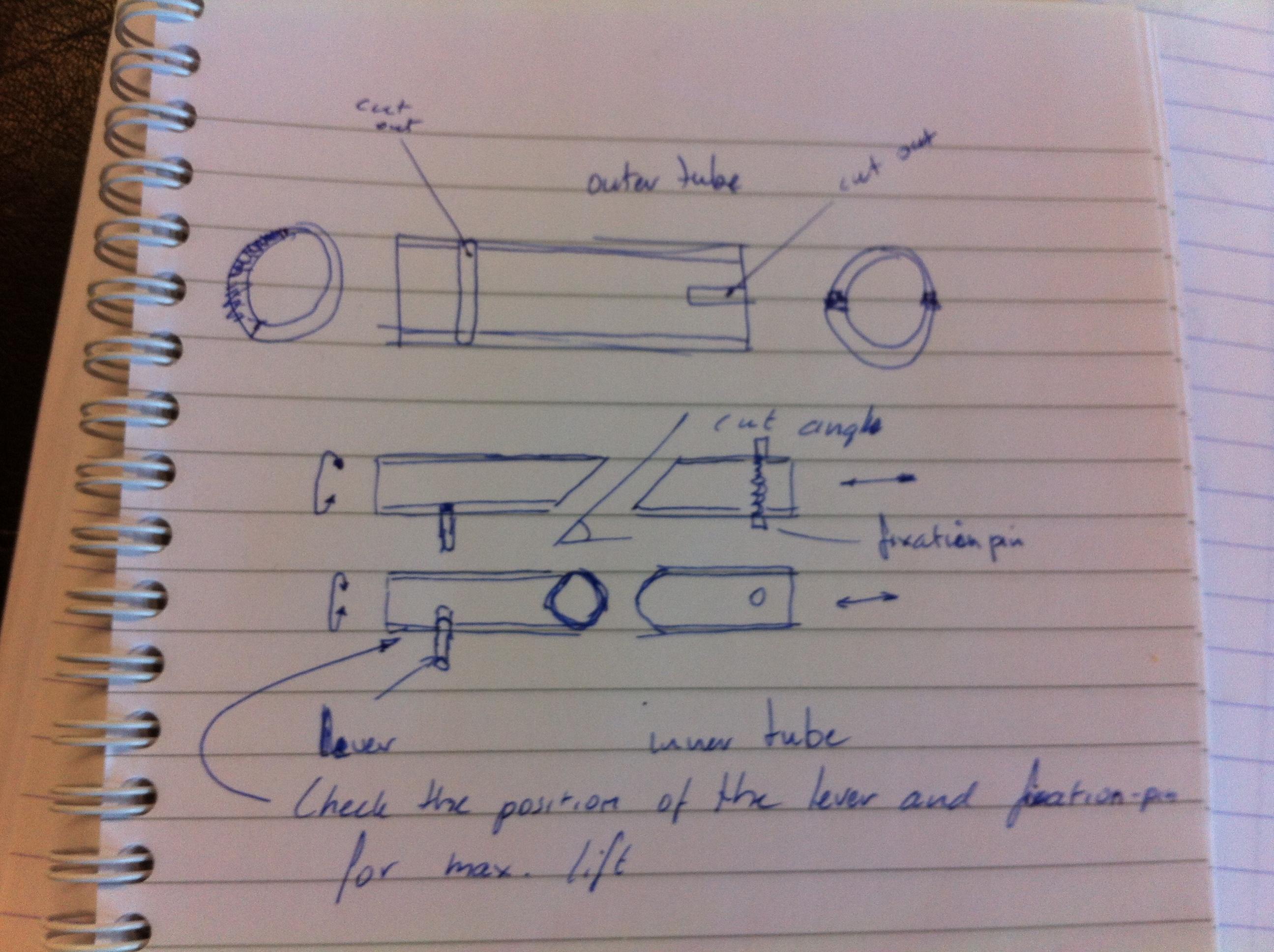

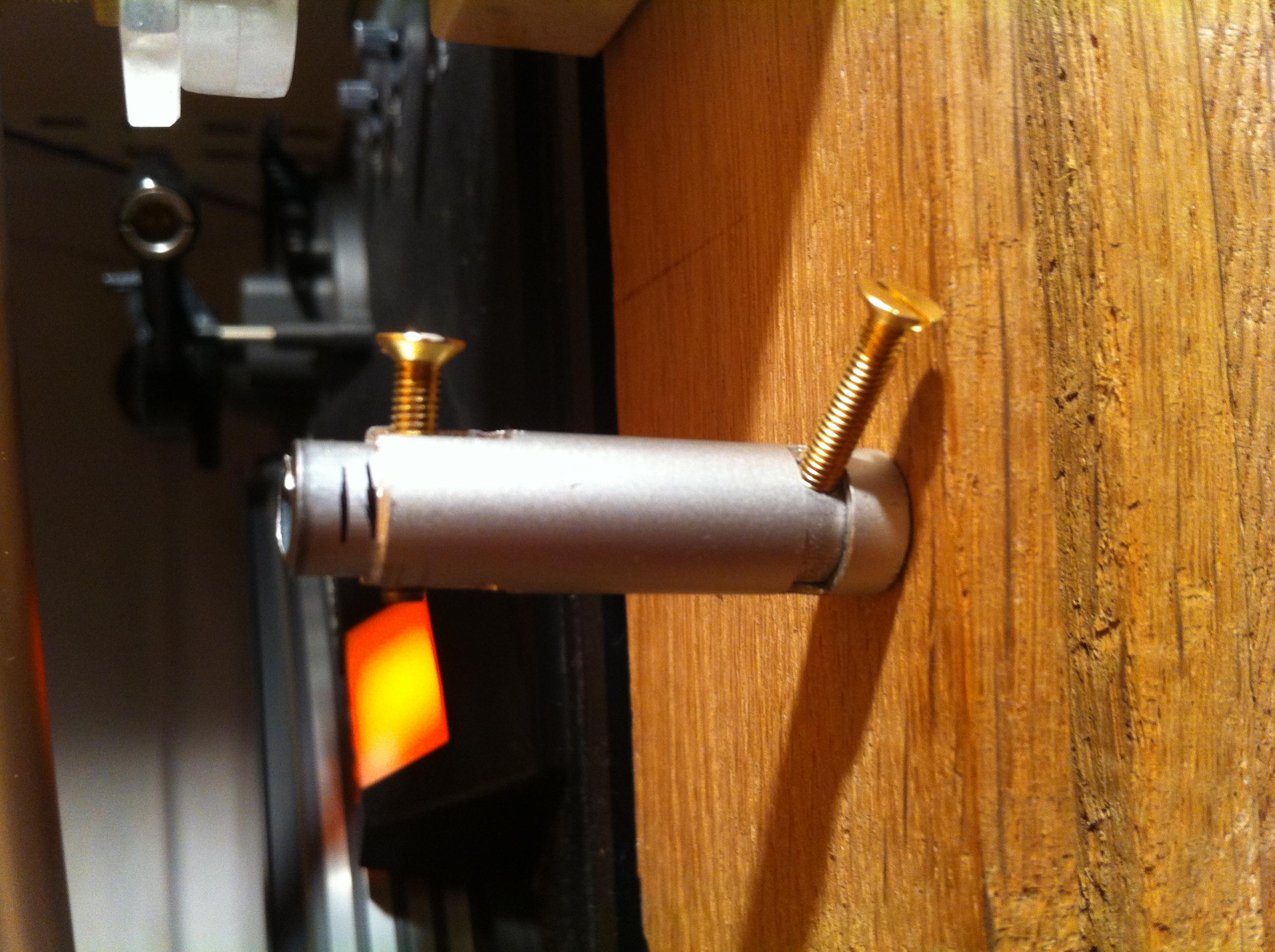

Think out of the box
Maybe we should use radial movement to create a steady axial movement to keep it simple....
This can be done with a couple of tubes.
I'll try to work this out this afternoon
Grtz, Mark
Grtz, Mark
I like the design. It is clever and simple. I think I'll steal it
Sincerely,
Ralf
Hey Ralf,
Please show me the results when finished.
Succes
Grtz, Mark

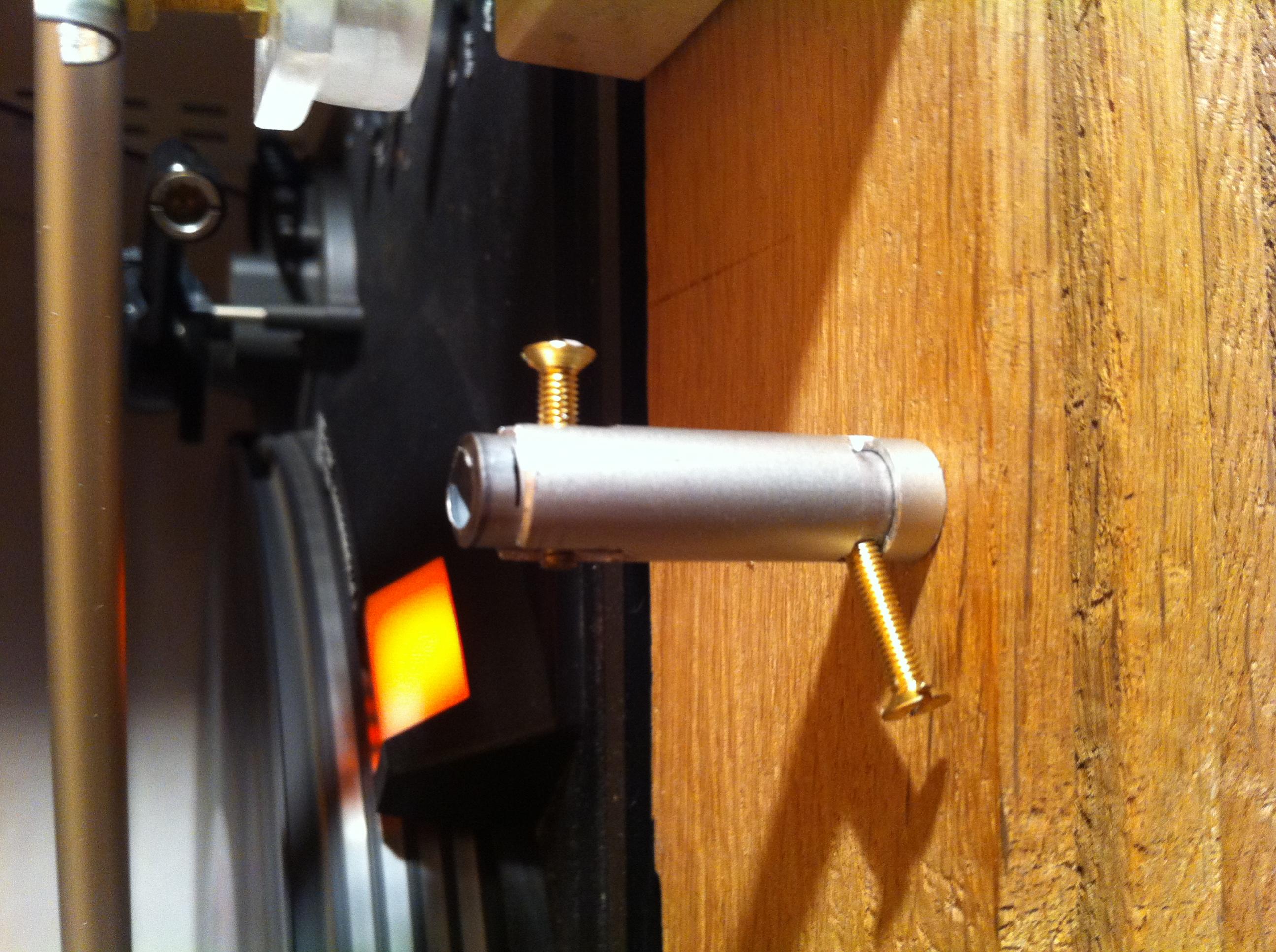

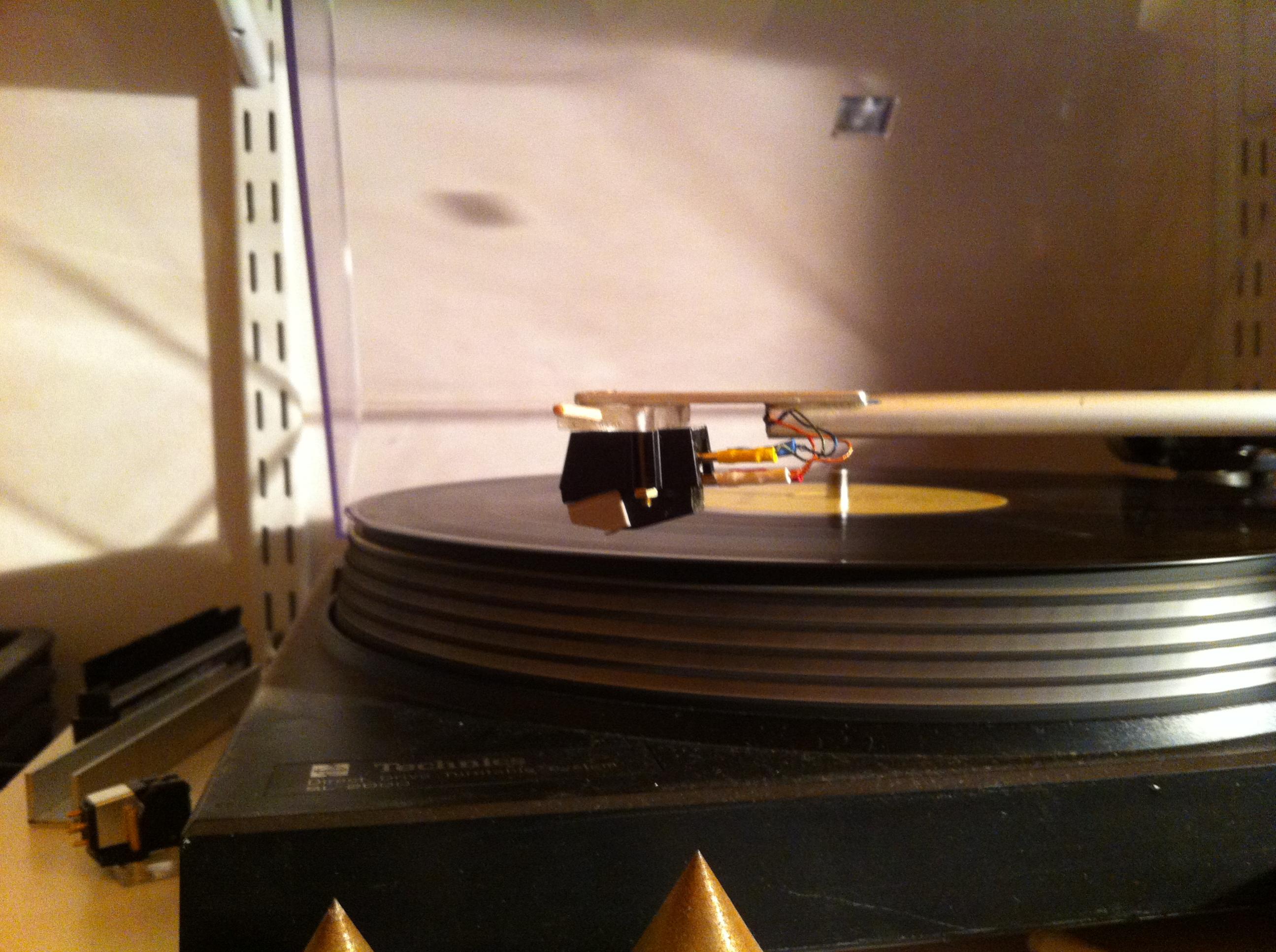

Turning te bottom lever delivers a lift of 2,5mm (photo 2).
I hope this will be enough...
Grtz, Mark

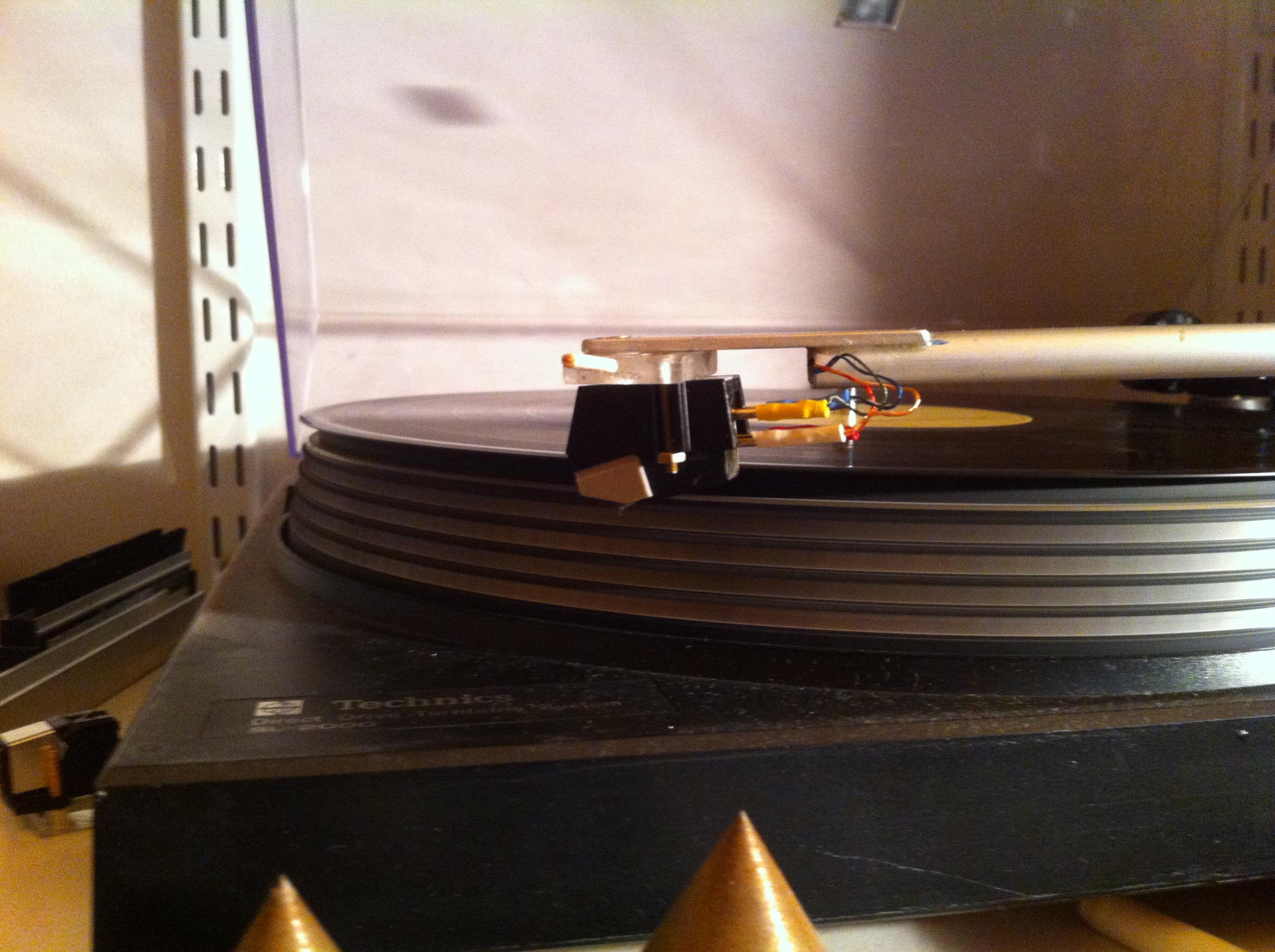

Around 2 mm of lift at the lifter translates to a lot of lift at the headshell.

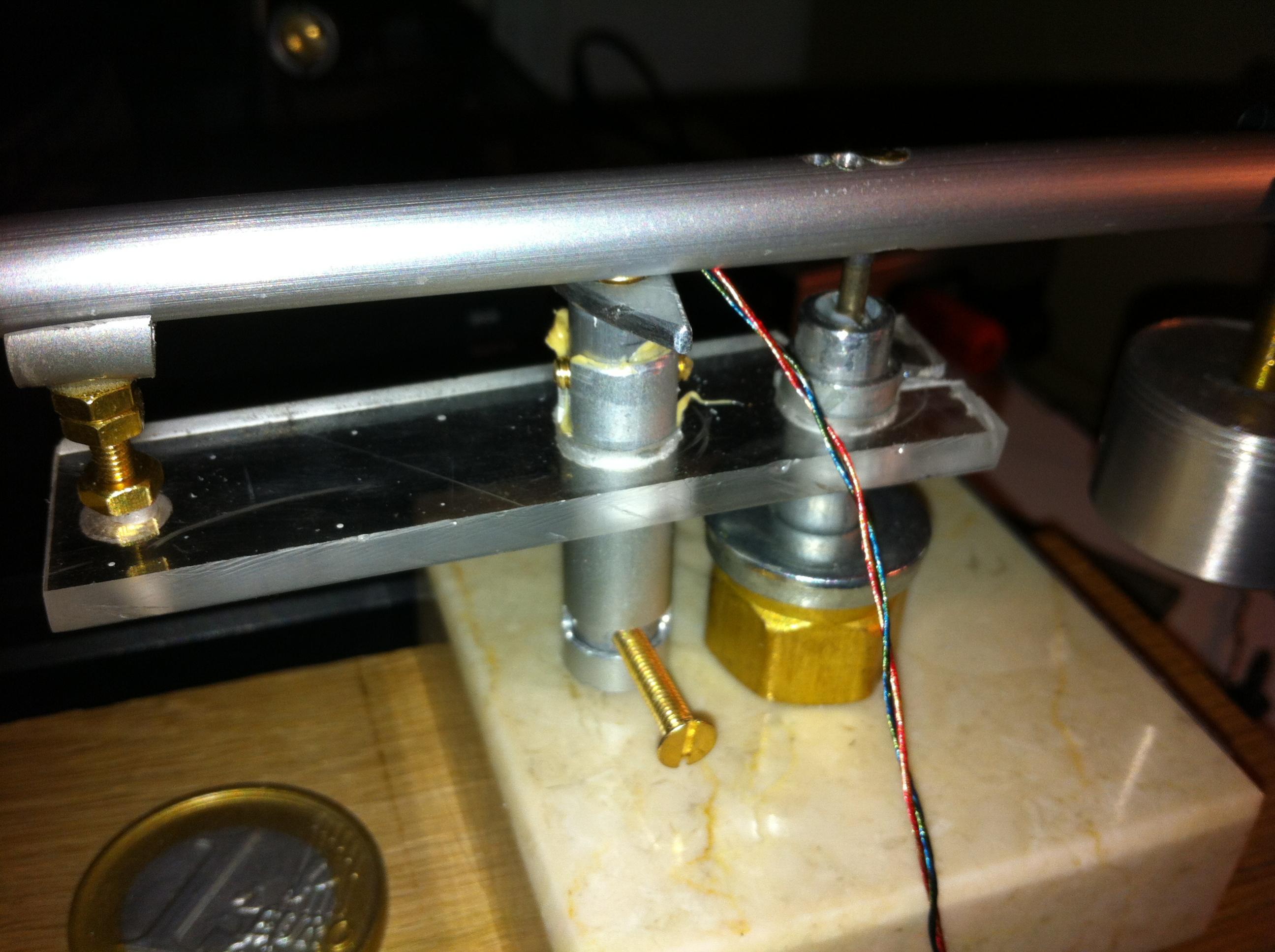

The POC of the armlift works.
It need some refinements, but the POC has proven that the principle is OK to use. Images will follow...

Whate else?
No not Nespresso, but creating an armlift whith such a tight fit between the tubes that nothing wiggles.

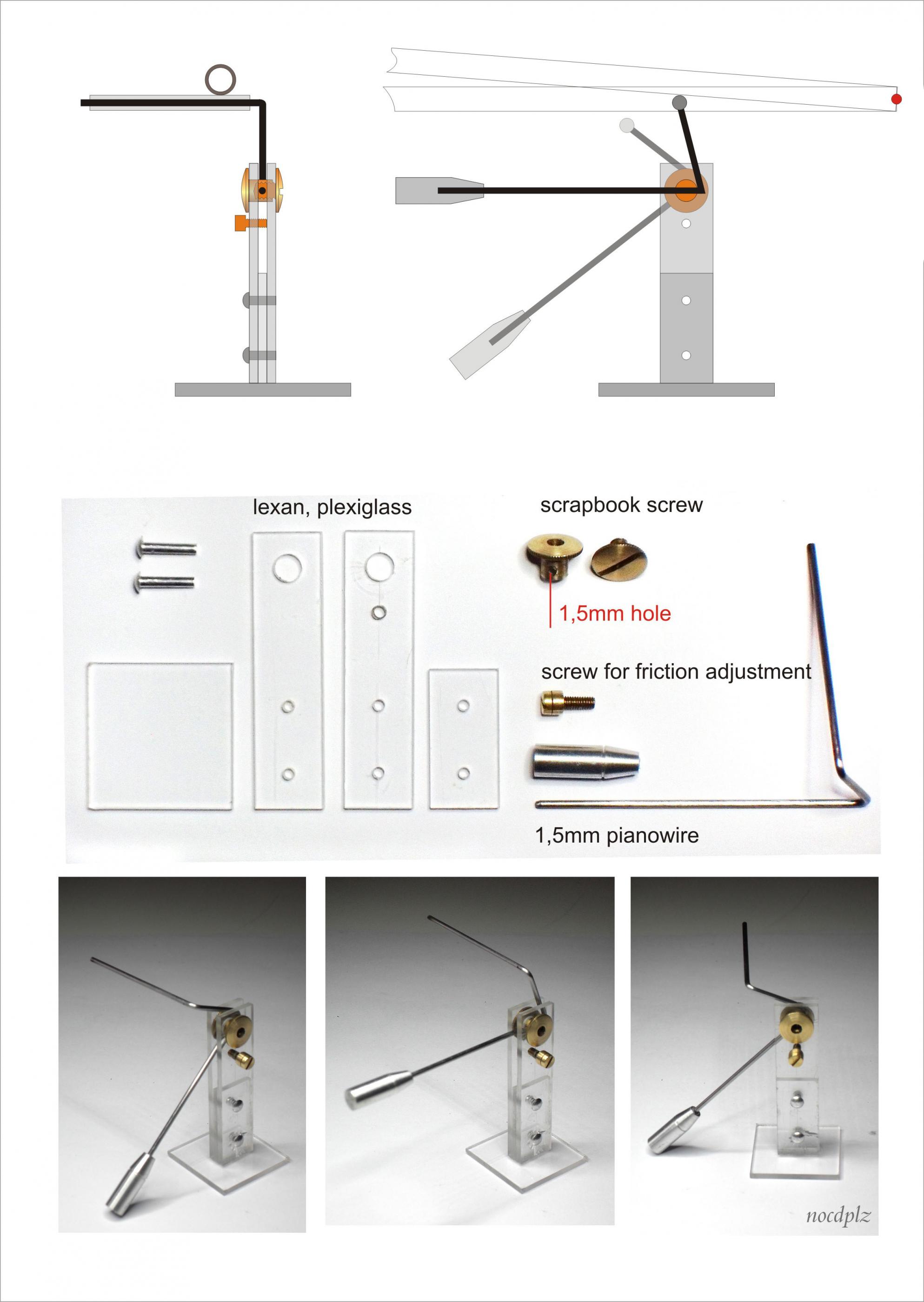

lifter
nothing new but in the easy way, without any lathe.
May be build with some pieces of plexi (or lexan), 1.5 mm piano wire, a scrapbook screw, and one of 2.5 or 3 mm. The hardest thing is to make the 1.5 mm hole into the scrapbook screw. The 2.5 screw is there to adjust the friction.
Hope this helps - Carlo
