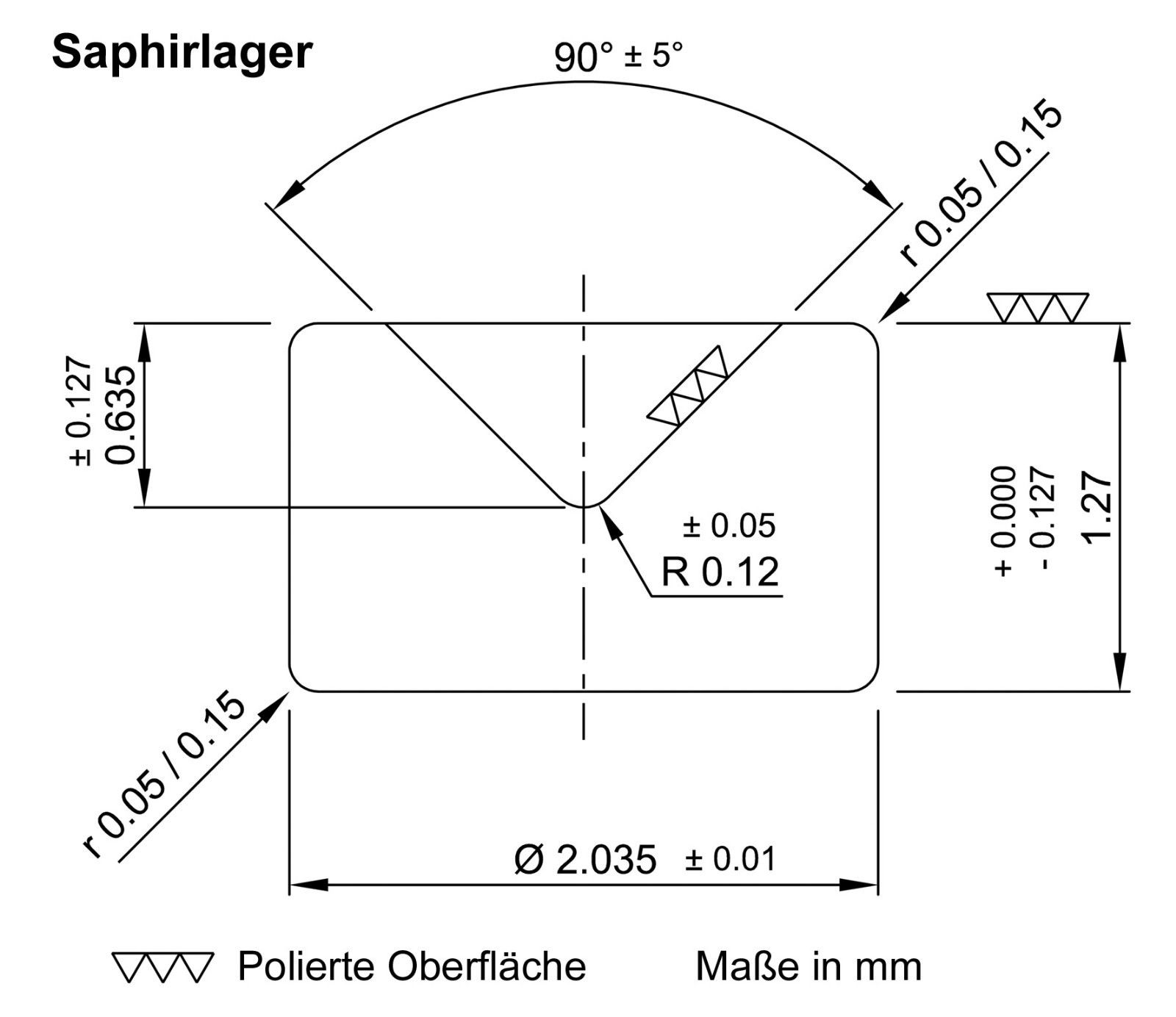

Hey there,
sachin recommended this thread ( and Tone-Arm) as a great read and addition to my lenco.
i am wondering how hard it is to set up for a noob, i am building a plinth for a 12" Arm with a mounting distance of 290 / 295mm.
By going through the almost 100 pages here i stumbled upon some use of Sapphire Vee Jewel Bearings and i found one locally here for quite cheap.
its tiny though,its probably too small to use for this application, especially with a ball pen-male?
maybe a bigger female? It seems worthwhile to focus on the Uni-pivot bit of the arm since it is the only bearing here 🙂
maybe one could use a needle of a compass (the one for drawing, i might be missing a word here) in a small drill chuck. still all second hand stuff or really cheap to get.

yurgs, welcome to the frenzy...(well not really a frenzy)
sachin: is pretty good guy and is smart as well. If he suggested this thread to you (does he know you personally?) there must be something here to glean from this (somewhat) long thread.
I've stated so many times that any variance from the "recipe" I've provided for the 219 tonearm results in an arm of unknown quality and character. I'm not saying these variances are bad ... just that there are so many that I can't comment on what the sound might be like.
I did think of using jewel Vee bearings as a further refinement. I'm not sure what the sound would be like though. The use of a sharp steel phonograph needle (replaceable types like this ) would be very good I think and perhaps easier to get and hard enough without being too hard.
