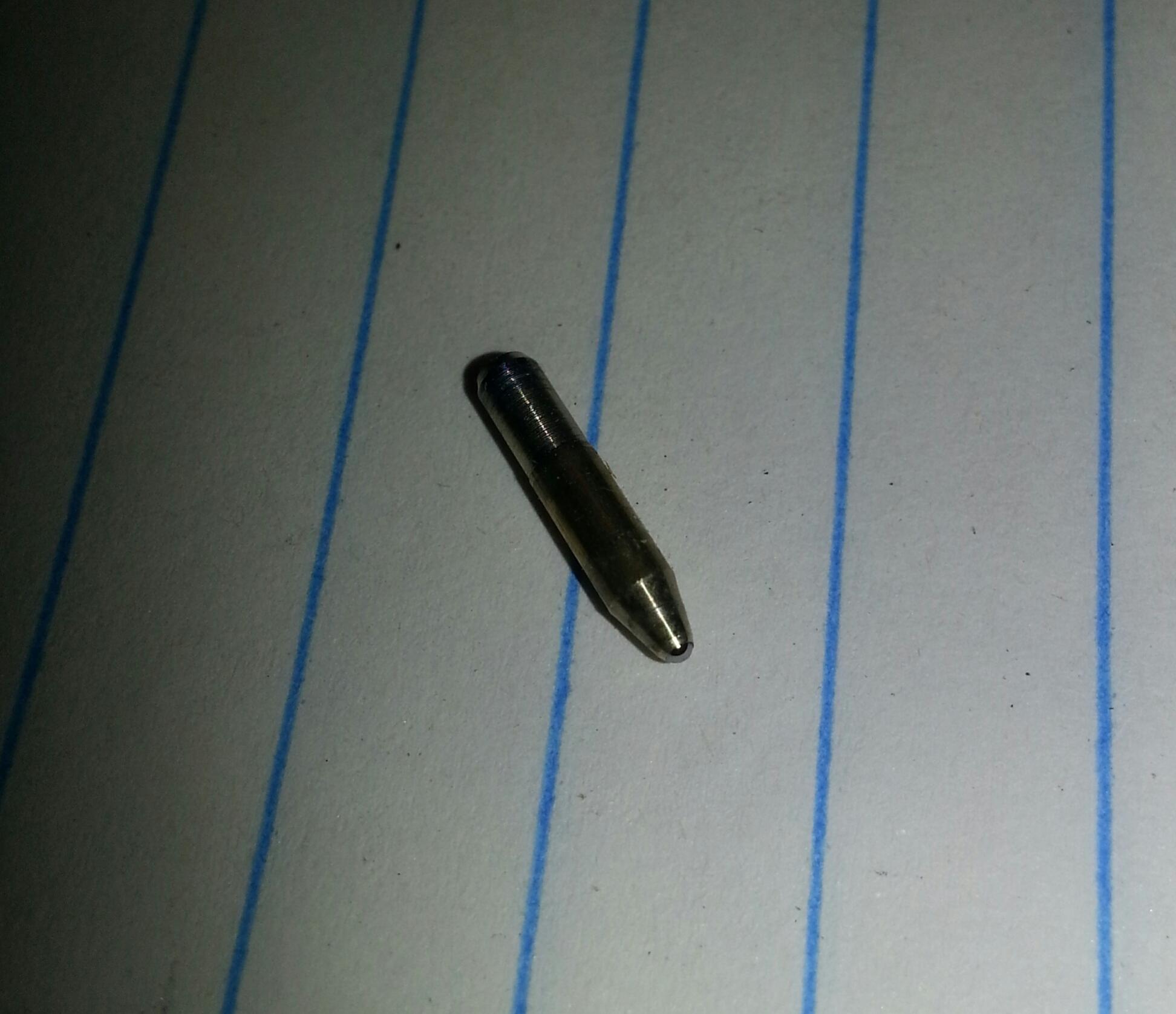

Is this pen nib a suitable pivot or is it too fine? I have the female part of a jewel vee bearing for my cup but no male part. Please see attached pic. Thanks in advance.
Looks fine to me. The female part in mine is just the indentation left in the top of the shaft from drilling the entry hole for the nib into the tone arm. It's nice and snug, and doesn't allow the pen nib to jump out easily even when using the arm lift.

The taper of the male bearing should be narrower than the female by, say 15-20 degrees. This will give the arm sufficient room to wiggle in both the vertical and horizontal planes without being restricted while avoiding being toppled over easily. The pivot point - the point where the male and female meet, must be slightly above the axis of the arm tube. So make the hole for the female bearing accordingly.
