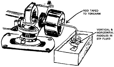

Anyone done anything like this ?
Tonearm Damping Article By Bob Graham The BAS Speaker Volume 3 No. 4, January 1995
Not sure I can see the need myself, my arm tracks warped records beautifully!
