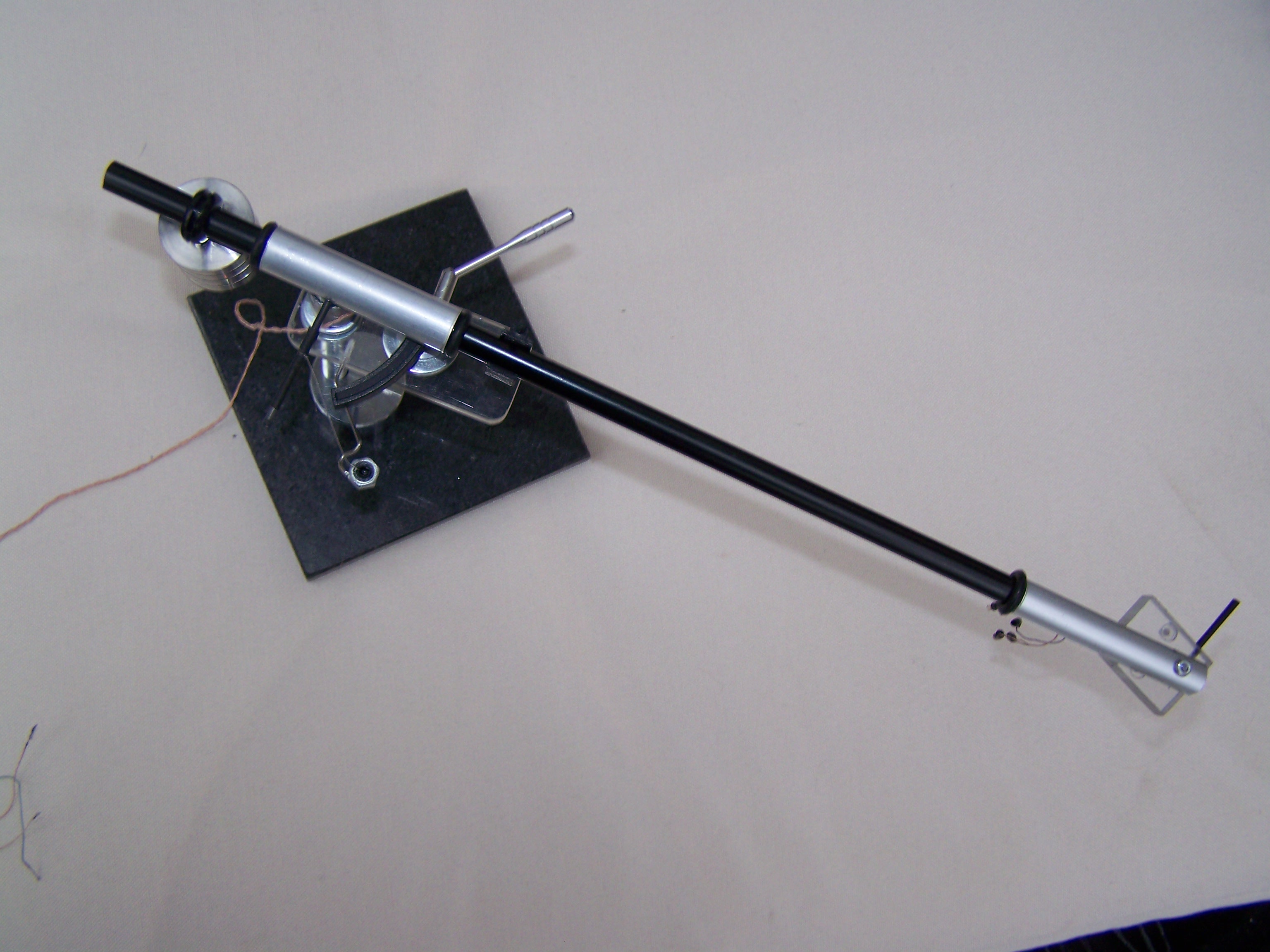

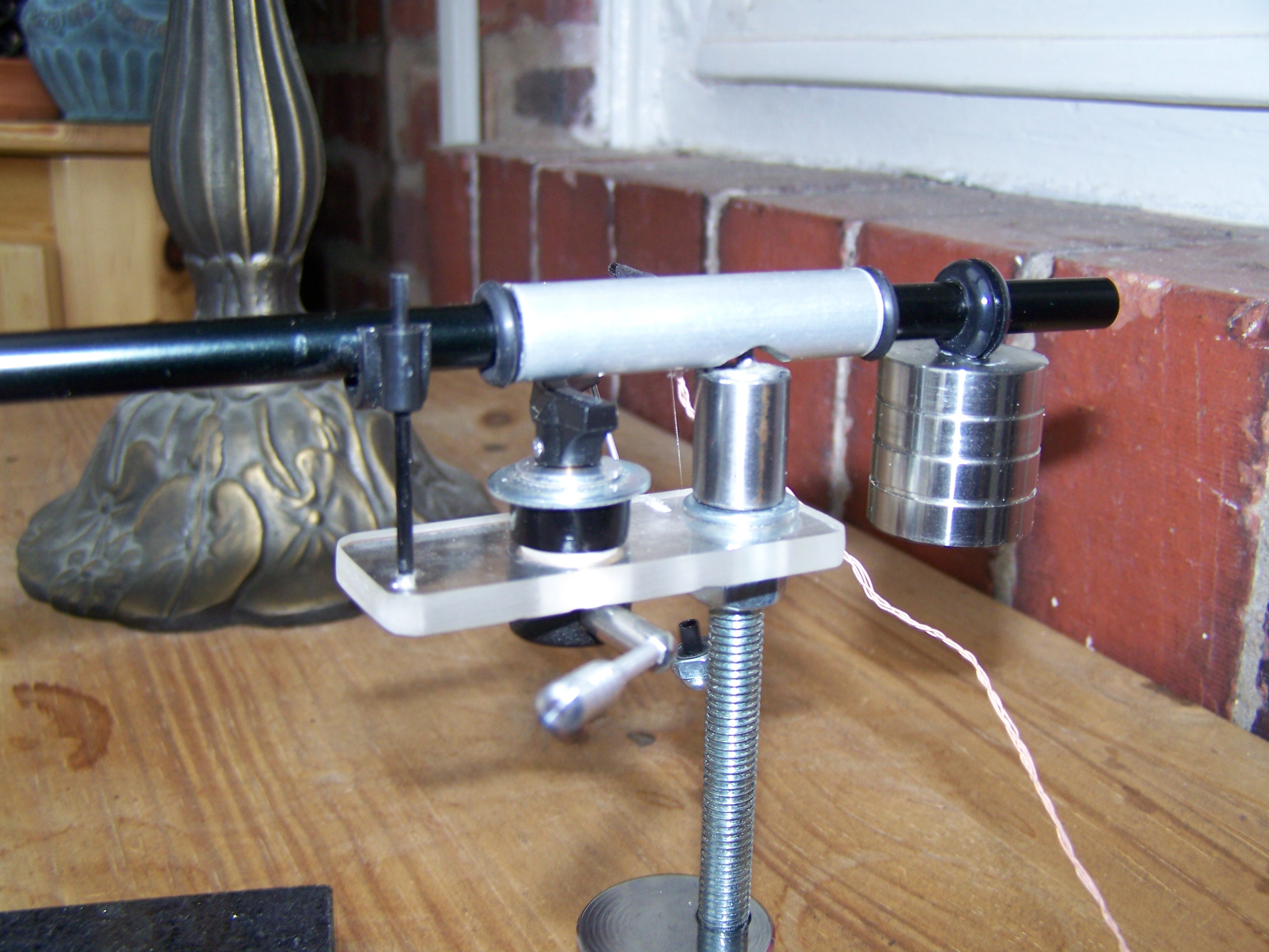

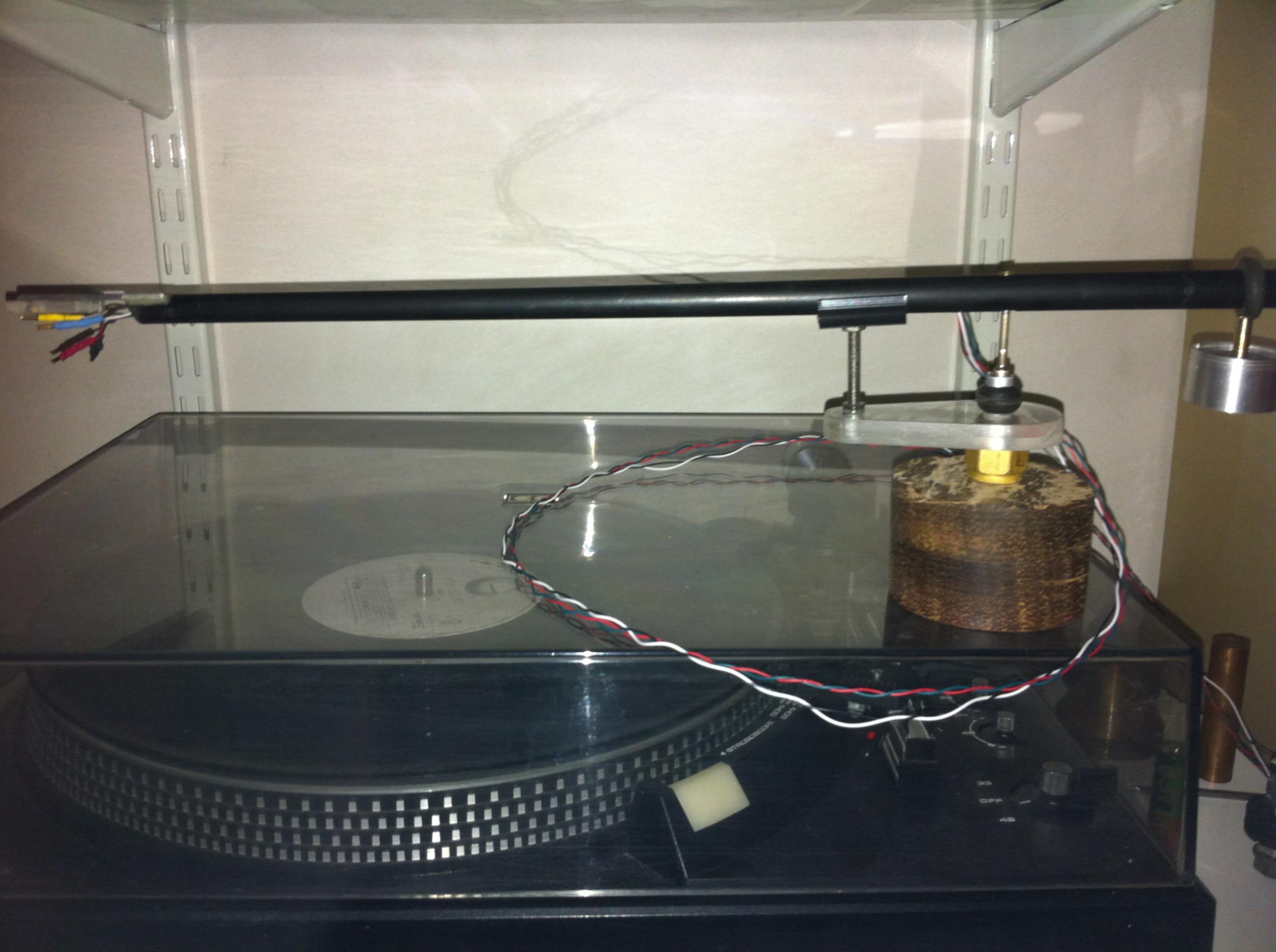

Made a neat solition for the counterweight en pulled some wires in the arm. Still puzzling what the armbase will be.....
I'm progressing........slowly

What you have looks good. The bigger issue is whether or not you want to attach the armboard to the existing turntable or have it free-standing. It seems like many go for a free-standing mount instead of an armboard.Well, I do!
Made a neat solition for the counterweight and pulled some wires in the arm. Still puzzling what the armbase will be.....

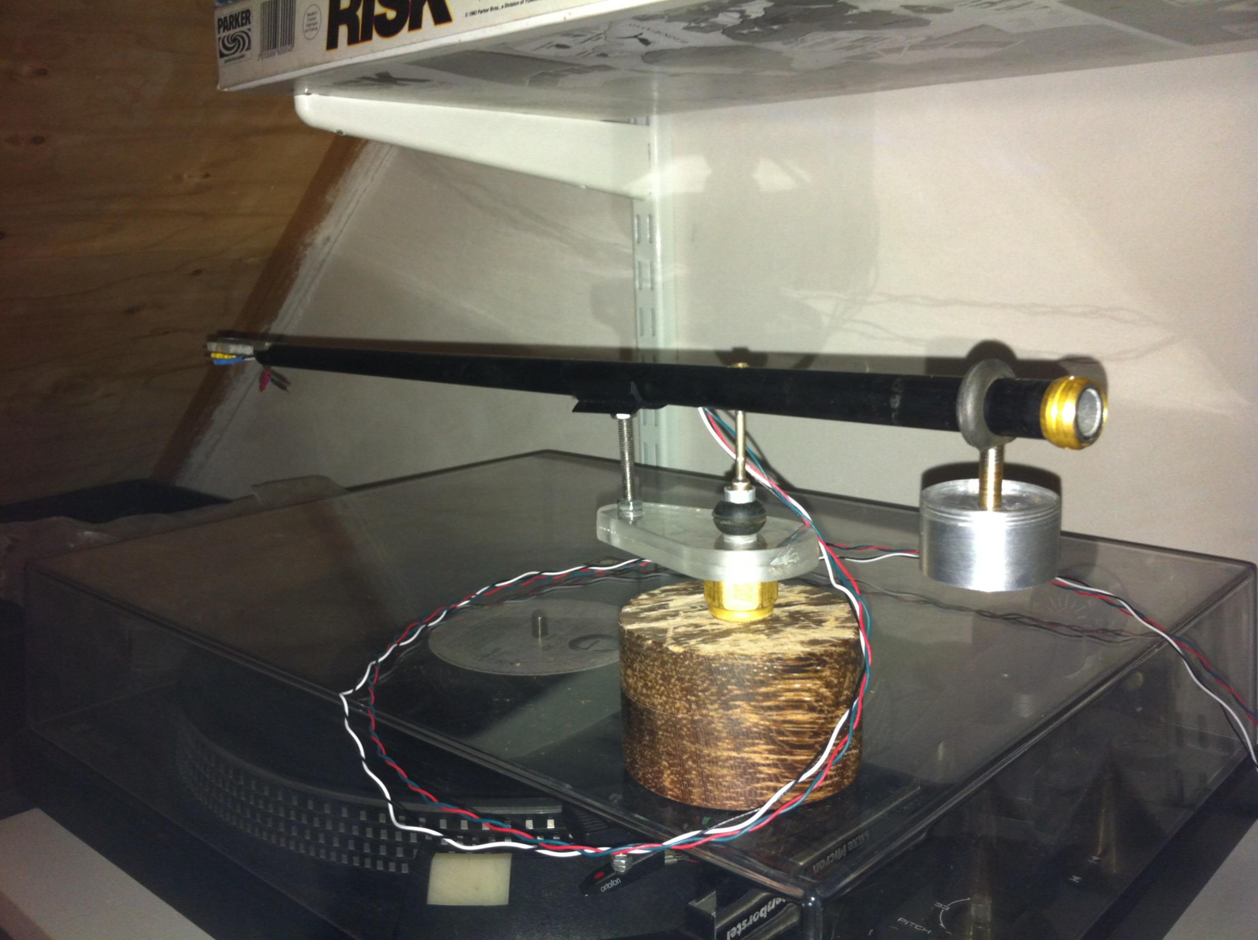

To fix or not to fix..... The armbase. Well, due to the lack of space on my Technics TT, and the possibilty to use it on a renovated Lenco L75. I opt for a free standing armbase. The height adjustment for on or beside the deck will be the trick. And an armlift is still spooking around my brain, i refuse to make to make a good sounding tonearm out of spare and by an armlift for €50. Not my style!

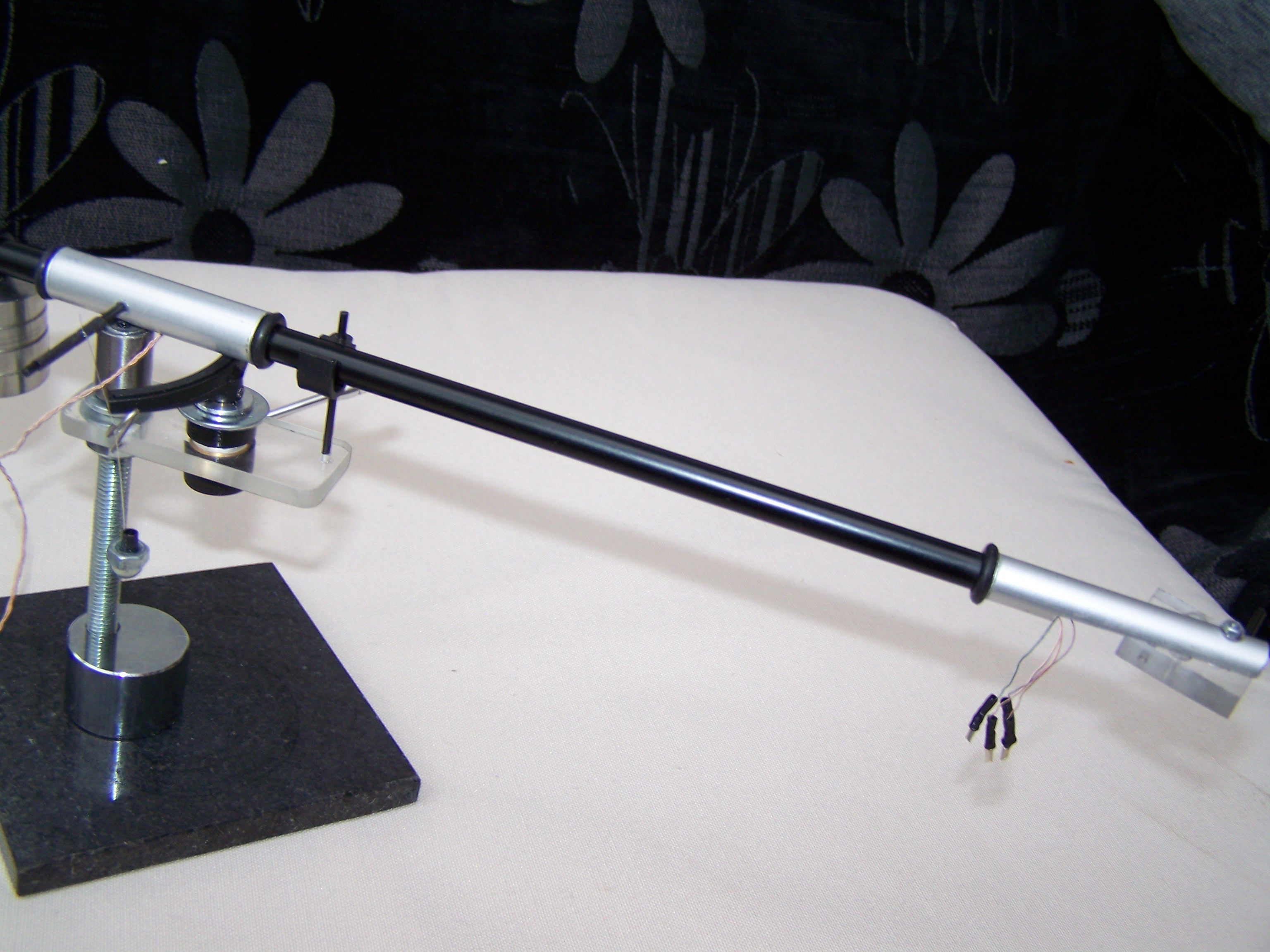

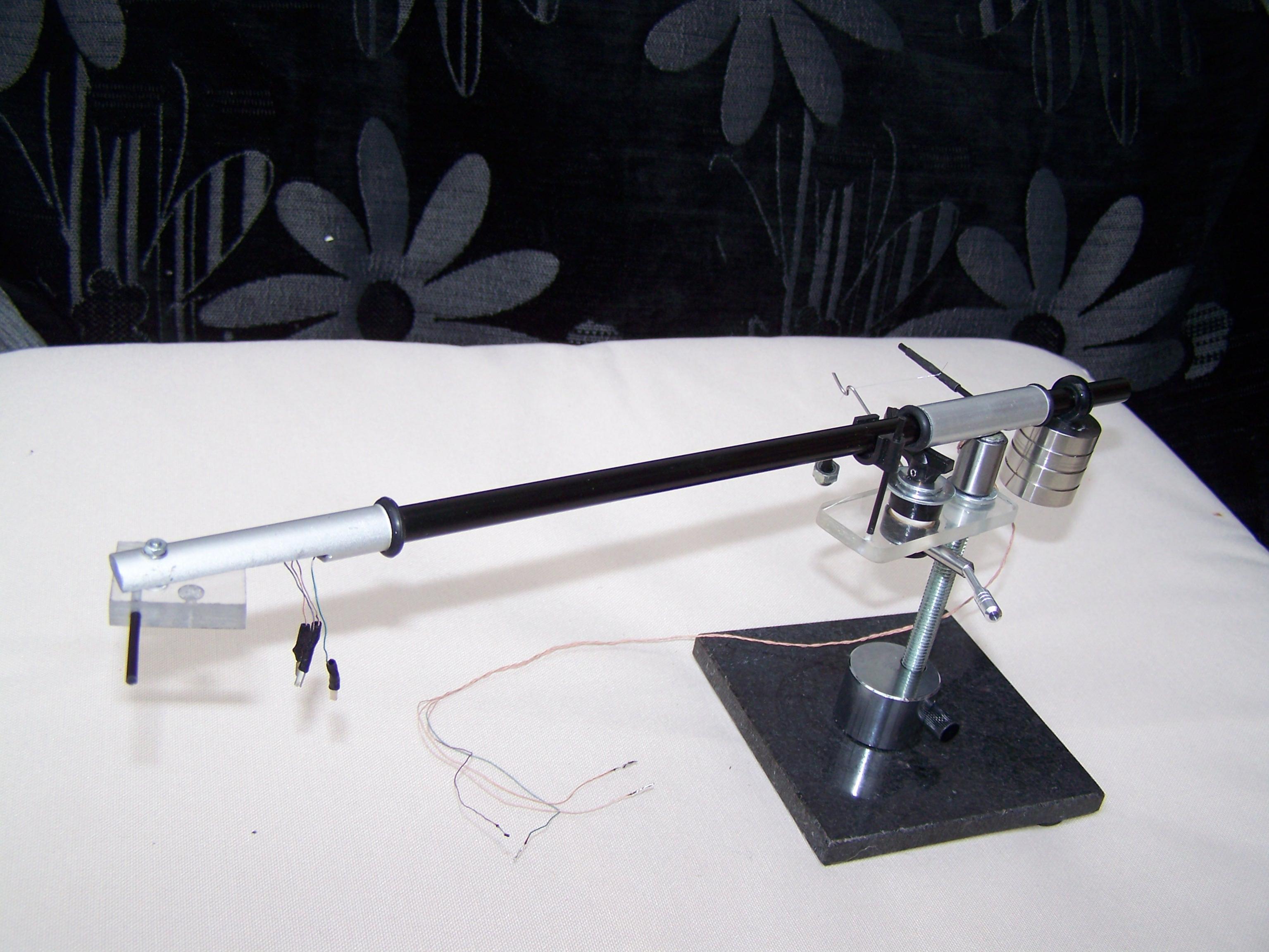

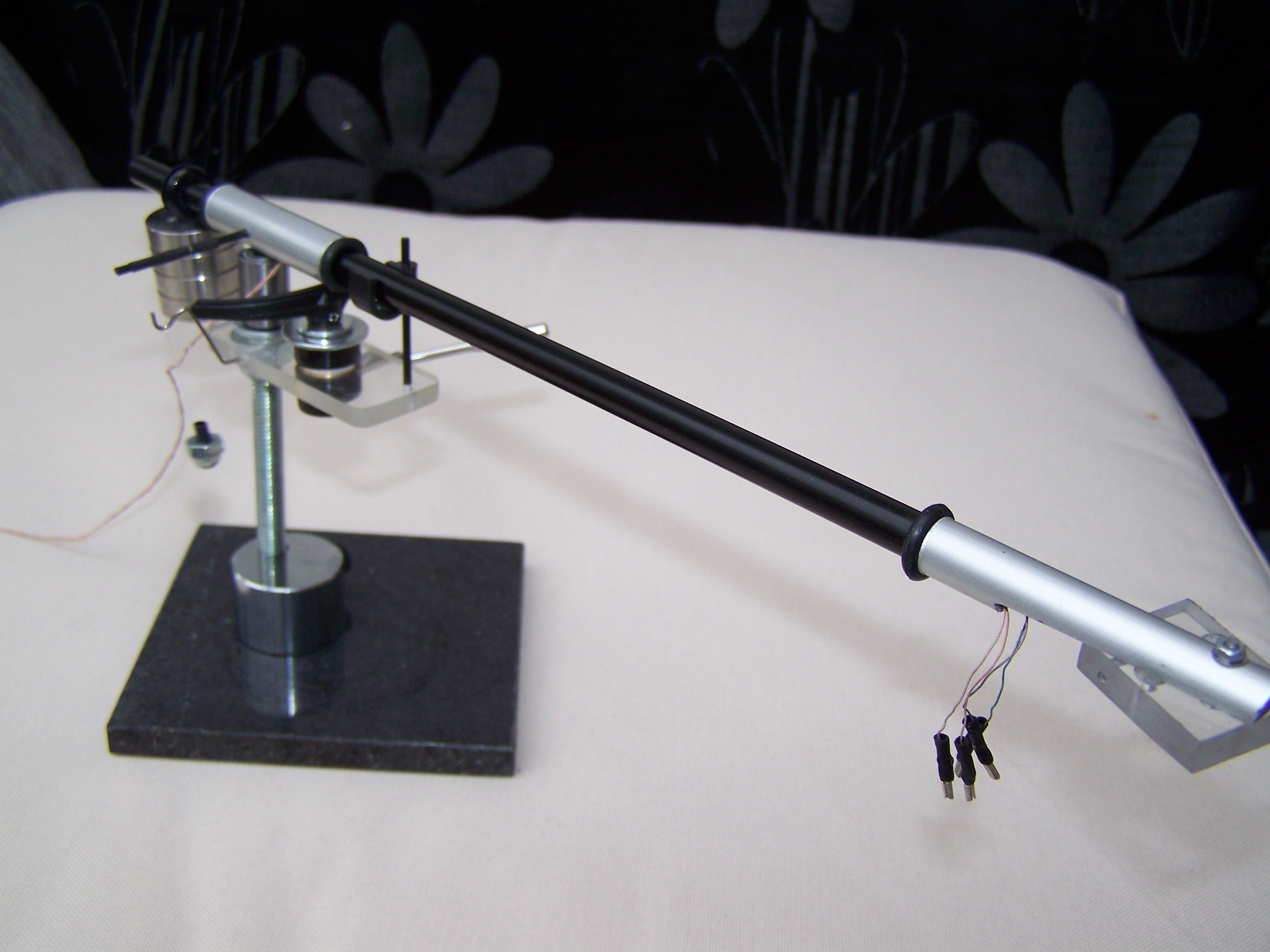

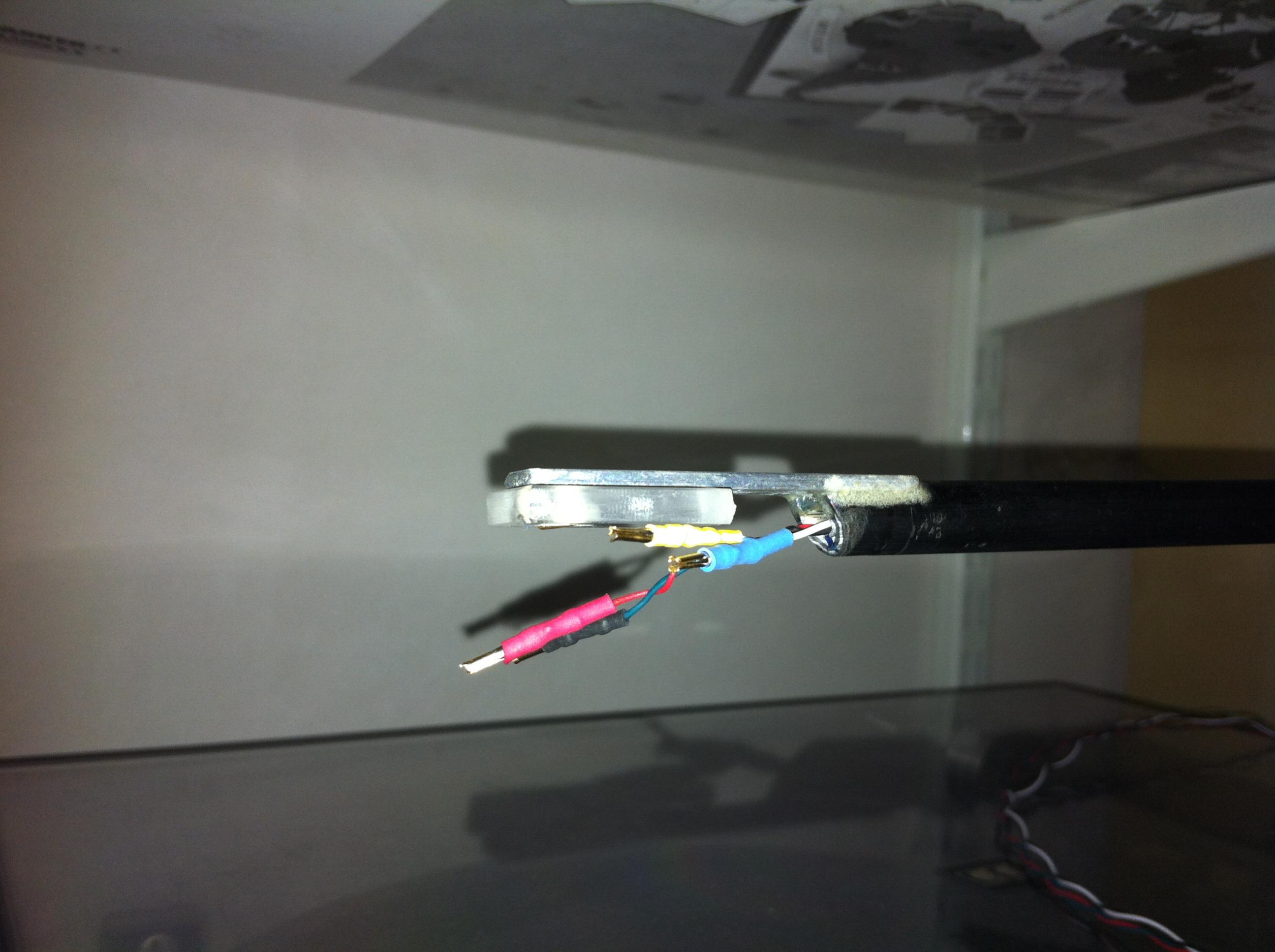

Hi Everyone
Been a bit quiet of late-lots to do at work and in the house-I hate replacing silicone sealant in a shower!
Here are some pics of my latest arm. Let me know what you think.
Regards
Chris
Hi Everyone

Hi Chris ,
Well , I was thinking about using the same design as per Nanook's .. but just a shorter arm tube in order to lower the effective arm mass , making it a better match for high compliant carts .
Cheers ,
Paul
I can't see the problem Paul. Just shorten the rod and balance it with a somewhat lighter couterweight...
