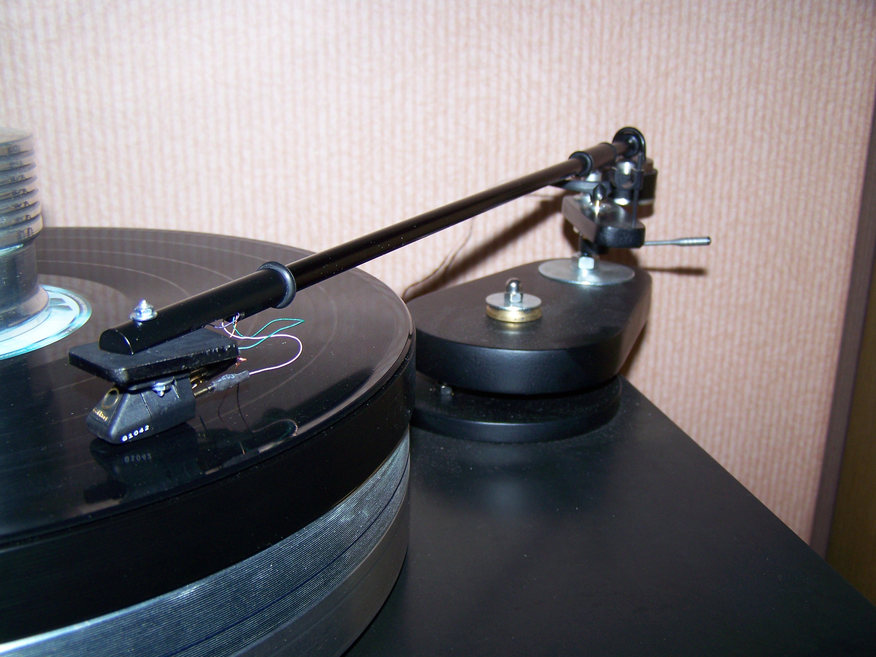

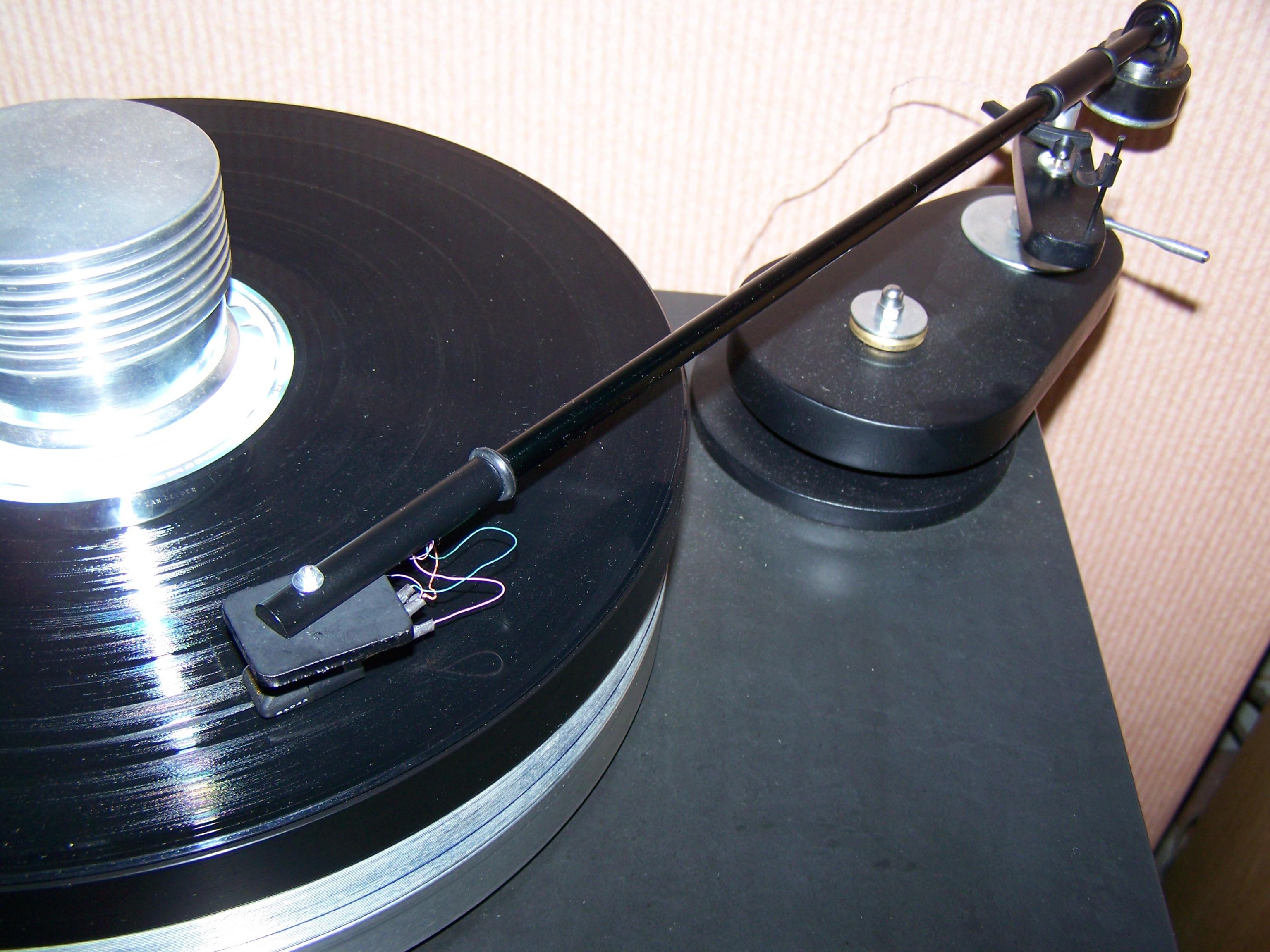

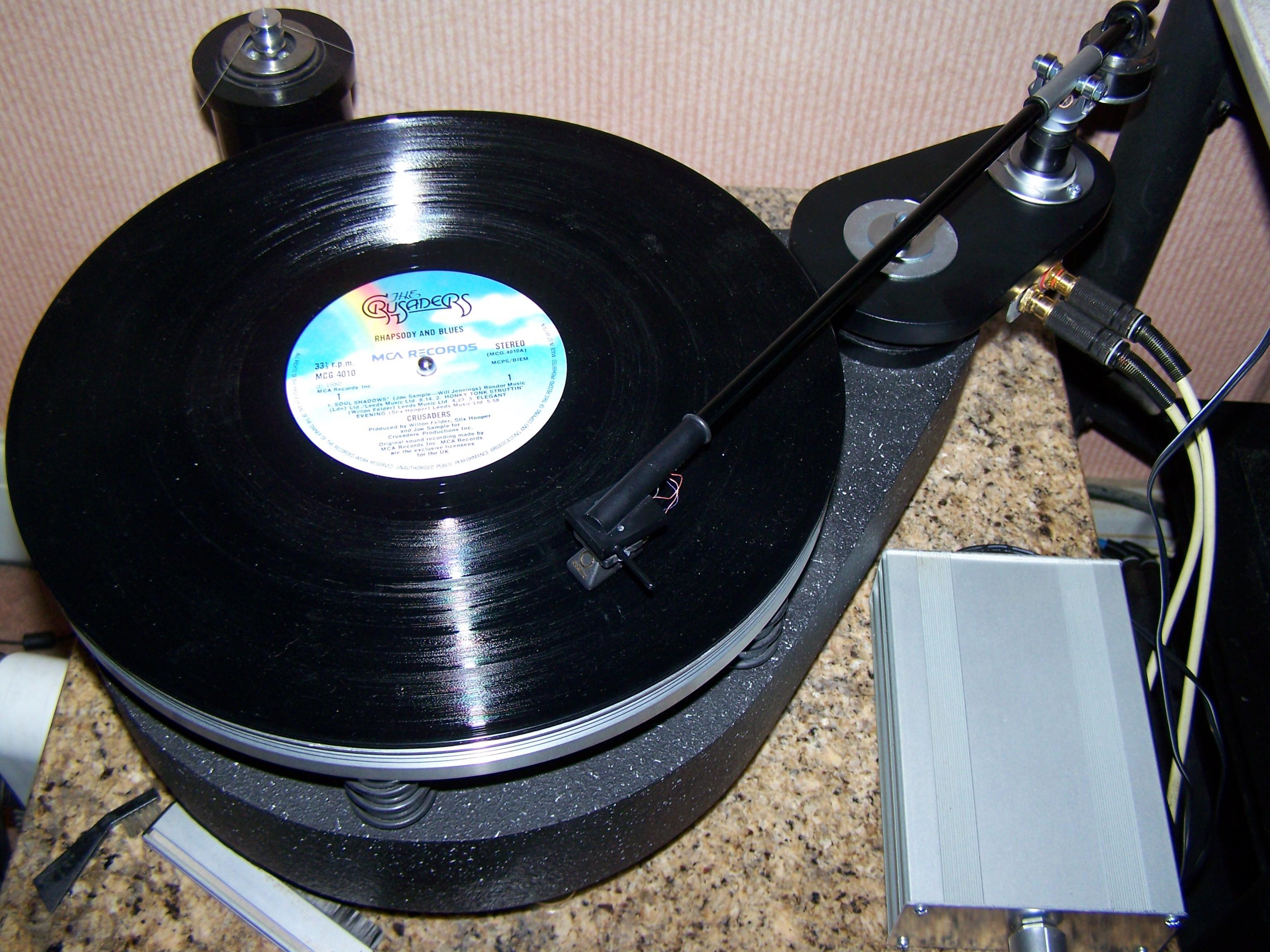

Hi Stu et al
I finally understood the need for the stylus to be in line with the arm tube and pivot and carried out the mod to the headshell this morning-around a 15 minute job. This is not the final product as it was a piece of oak I had lying around and roughly the right dimensions.
Incidentally, the arm is now closer to 14" than the original 12".
Plugged in the Goldring 1042 and you know what-sound quality had gone up several notches in every respect.
The headshell is till very easy to make but will be used on my other designs in future-should have listened around a year ago!
Thank Stu!!
Chris

Stew,
Your comments regarding keeping the stylus in line with the pivot interest me. If I am planning to make a fixed mounting distance arm, would I be wanting to make a straight slotted headshell like your original, or would I be better to make an angled one with an offset headshell?
I see you're able to move your base, and that makes alignment much easier to achieve with your headshell. I intend to copy most of an existing 12" arms geometry such as an SME V12, but a unipivot of course. The headshell has about an 18 degree or so angle to it, so would I just make my slots the same angle to allow my headshell to move for and aft to get the stylus in line? This is the arm I was using as a visual, hence my using it as an example:

I am still confused on the level of the pivot. Is the pivot at stylus level preferable to a pivot above the stylus? I get the center of gravity principle, but the actual location interests me.
Thanks in advance.

Morton:
I'm very familiar with the SME tonearms (I own one of the newest 309's, with magnesium armtube). Not a 12", but it fit the existing arm board (sort of) on my old Oracle Alexandria tt.
An aside: Anybody that has complained regarding the Alex's sound most certainly has not heard one properly set up with a decent or good arm on it---the Oracle Prelude arm is such a POS, it actually hurts the performance of the Alex.
and now back to the question at hand... The location for the pivot (vertically) is typically about half way through the arm tube. This helps to stabilize the arm. Think like the broom on a finger, or broom held by your index finger and thumb being hung below . Which is more stable? Ideally the pivot would be in the exact plane as the stylus, but this is not practical. So I use a vertical pivot approximately 4.5 mm inside the arm tube (when using an arm tube with an OD of 23/64" or 9.12812 5mm).

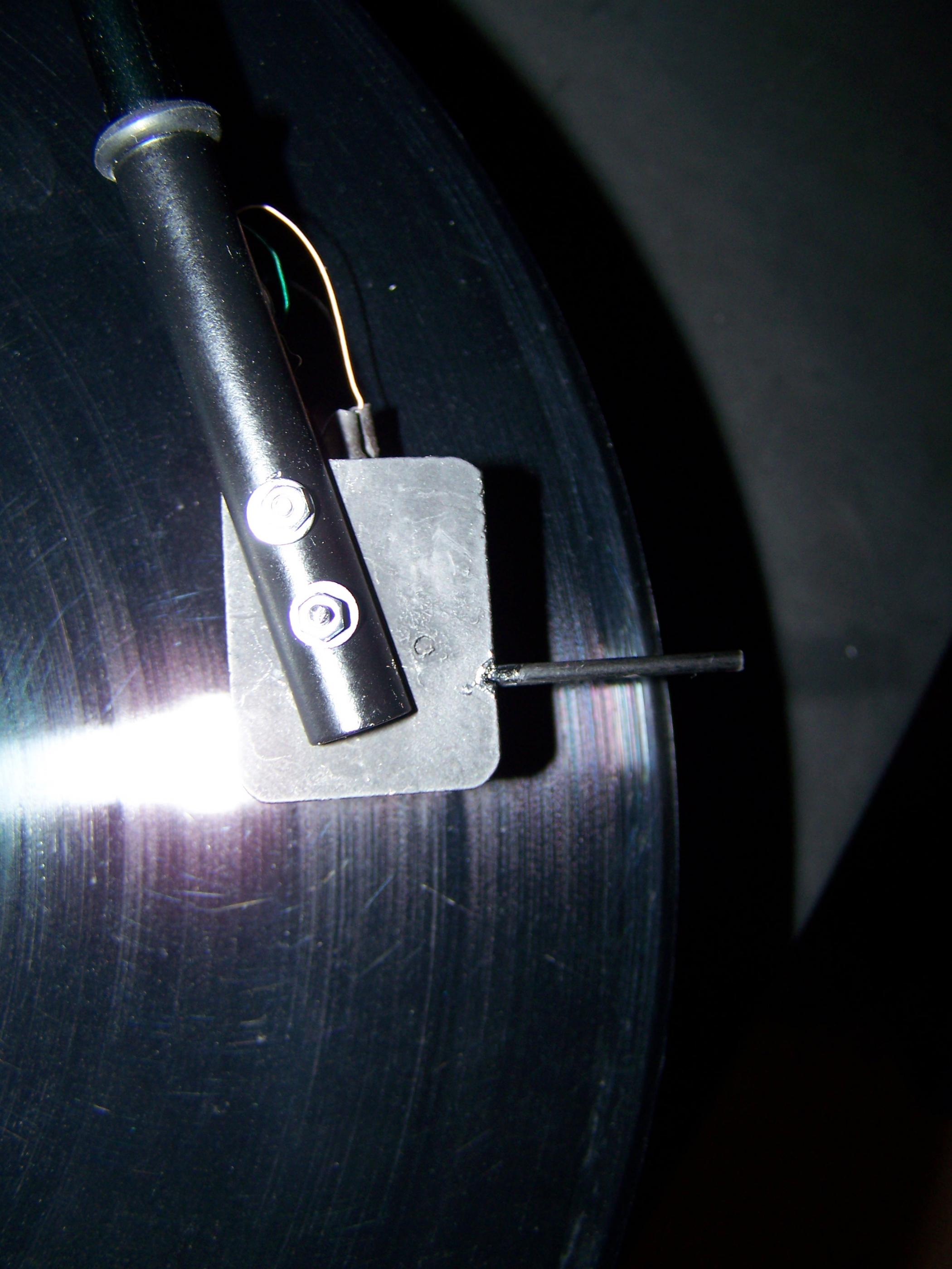

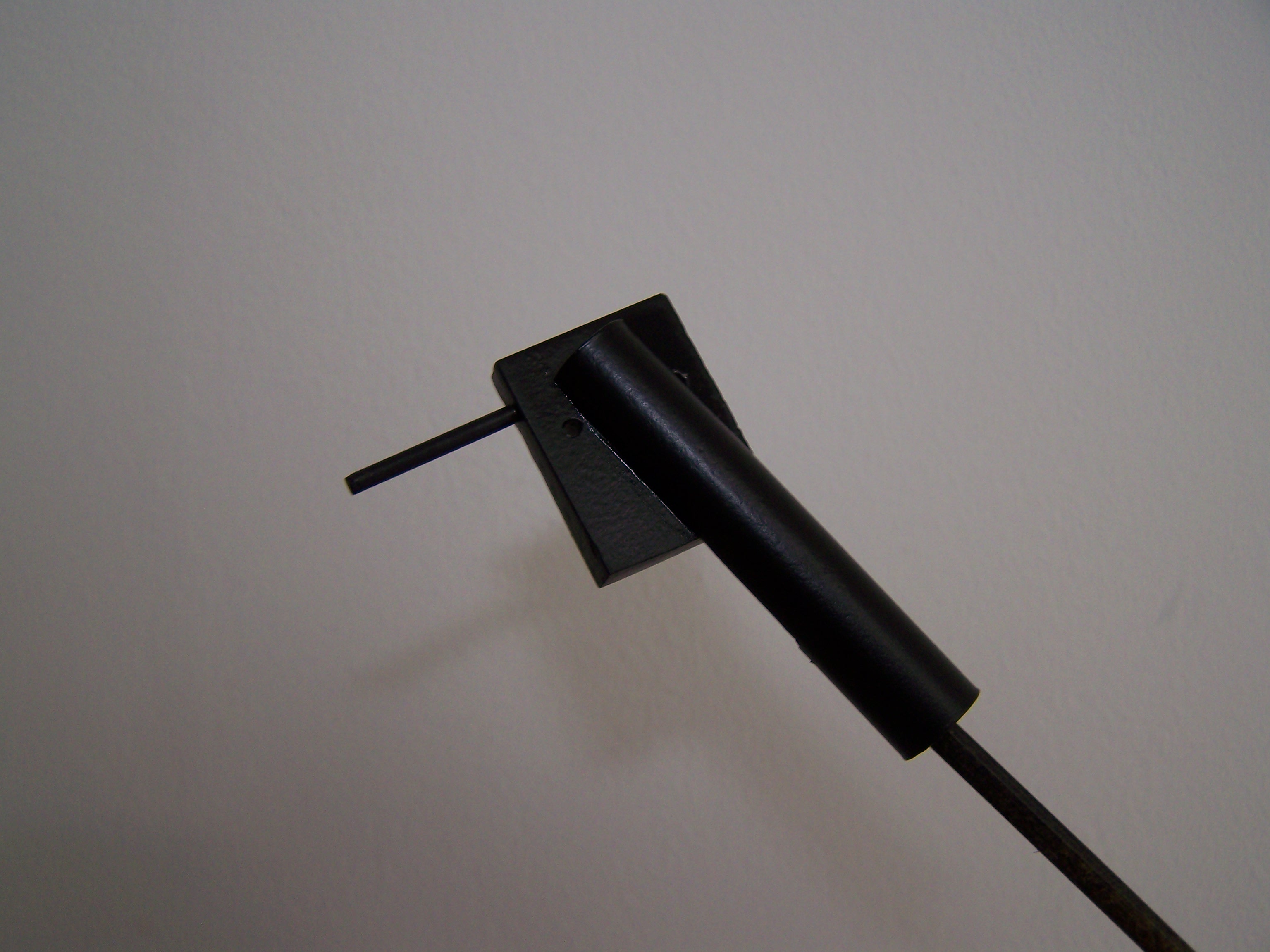

Headshell
Hi Everyone
Close ups of new headshell-a real success now I've cottoned on to the fact that the stylus needs to be aligned to the pivot down the centre line of the arm tube.! Put a second bolt on to ensure a snug, secure mounting-again, it worked superbly!
I'll be making one out of perspex-it'll look prettier.
Chris
Hi Everyone
Chris

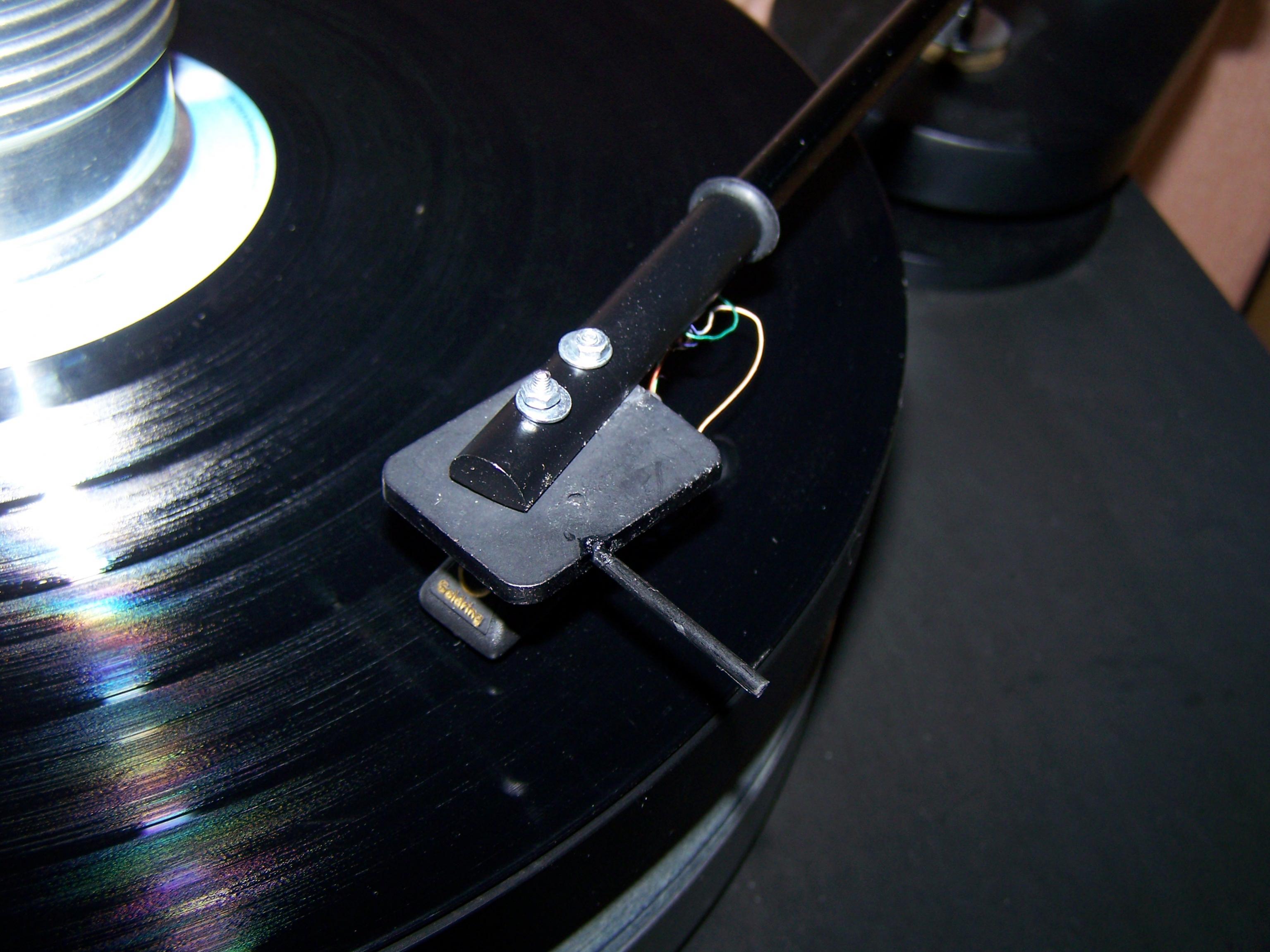

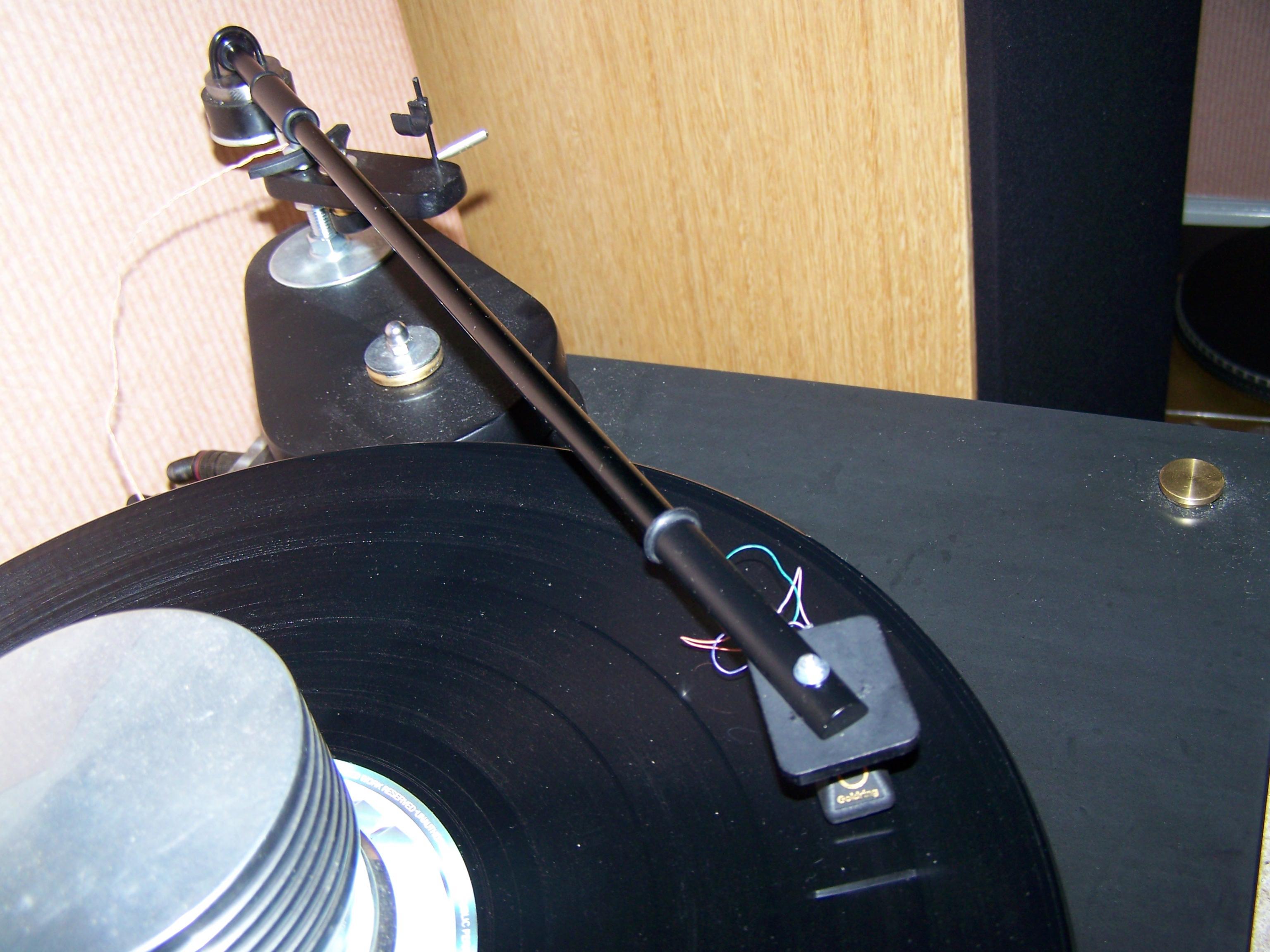

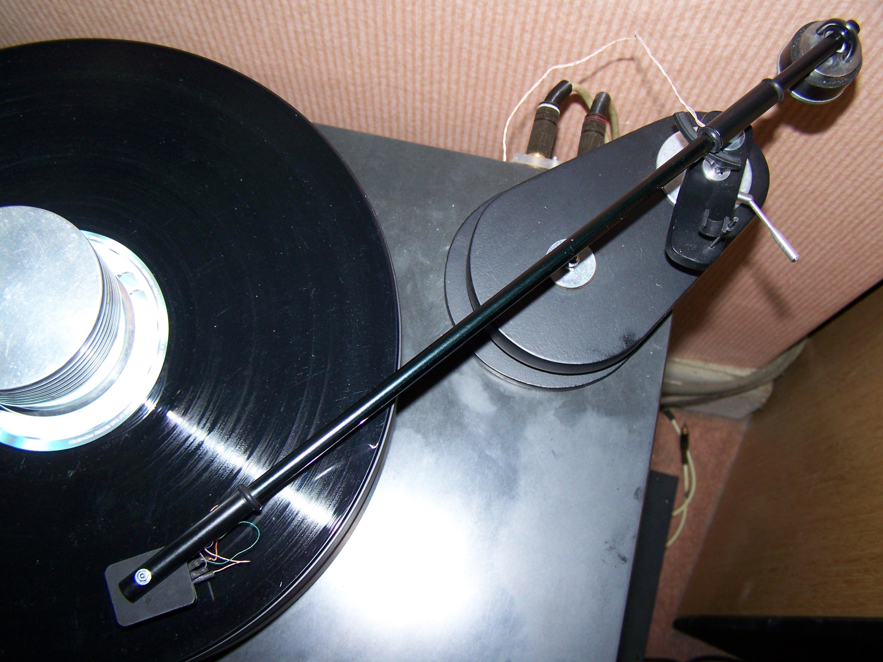

Latest Perspex headshell
Hi Folks
This is the latest version of the headshell and it looks like this is the one I'll use from now on. The mounting plate is perspex and it looks a whole lot neater than the previous one-and is probably sonically better as it's more rigid.
Chris
Hi Folks
Chris

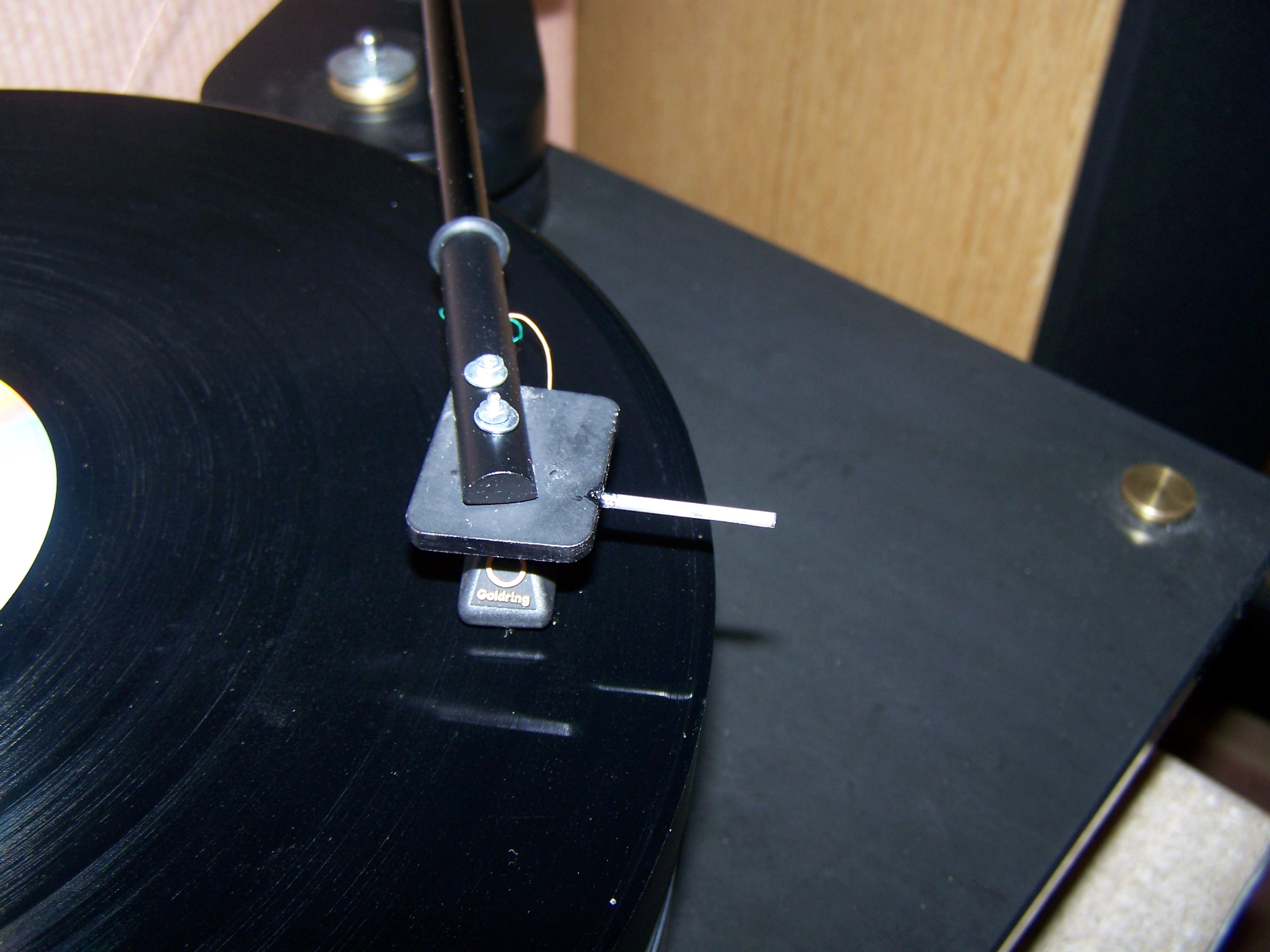

Headshell
Hi Mortron
No-that's just a kebab stick used for holding it while I spray it! Still using Easton Gamegetters-had to buy a dozen-get two arms per shaft so plenty left.
I've been experimenting with another configuration-watch this space-it looks mighty interesting.

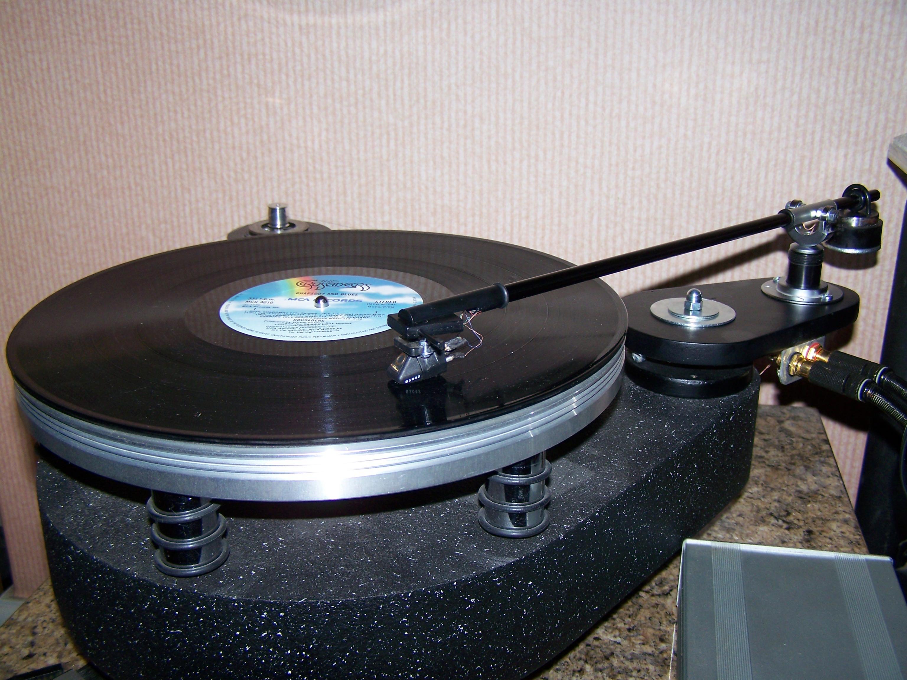

New Headshell in Action
Hi Folks
New headshell in action-very pleased with it. However-the 'business-end ' on this is not a unipivot-I've been playing around with this a while and decided to get it up and running this morning-it's super!! Can anyone guess what I've done?
Regards to All
Chris
Hi Folks
Regards to All
Chris

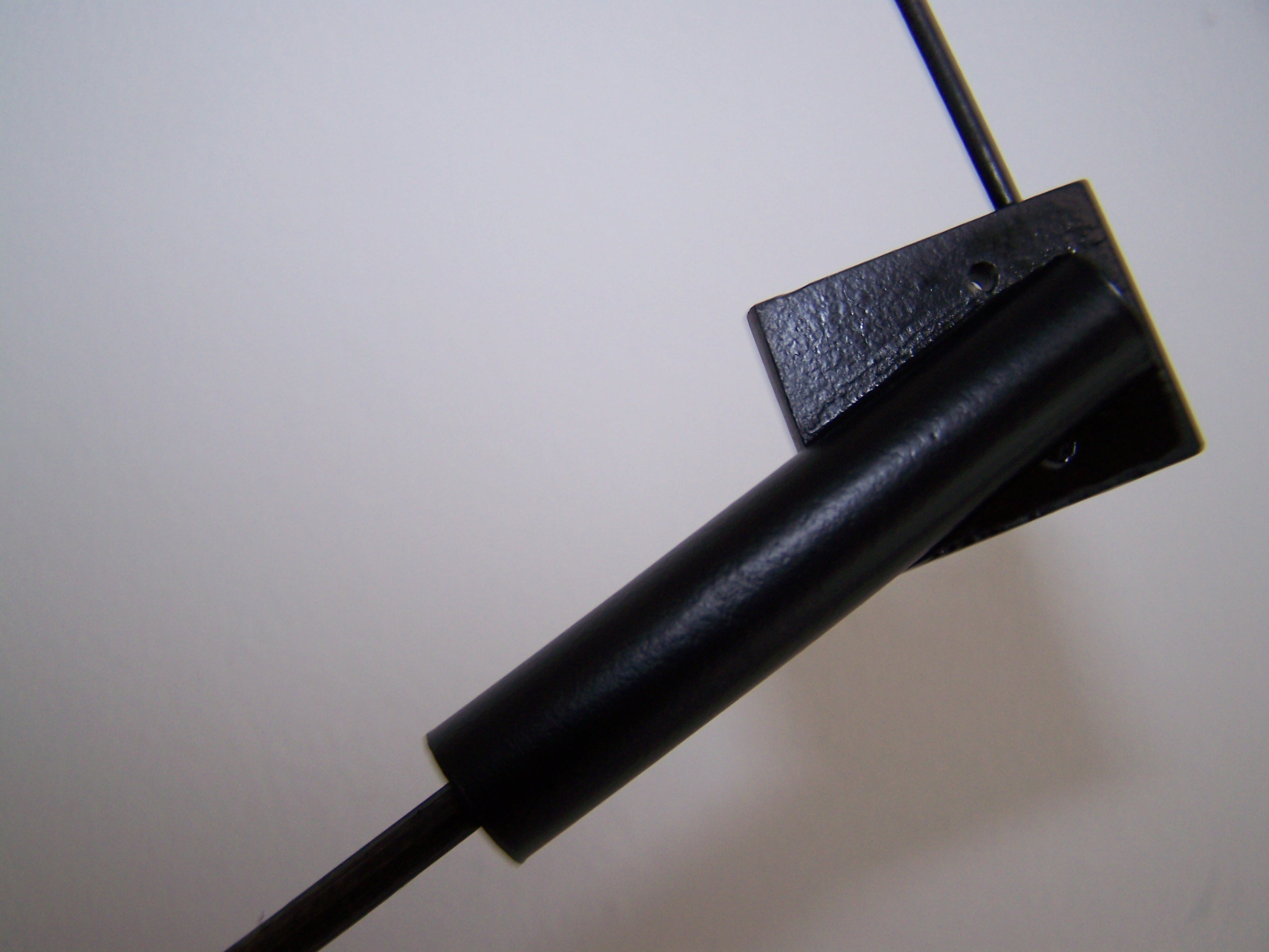

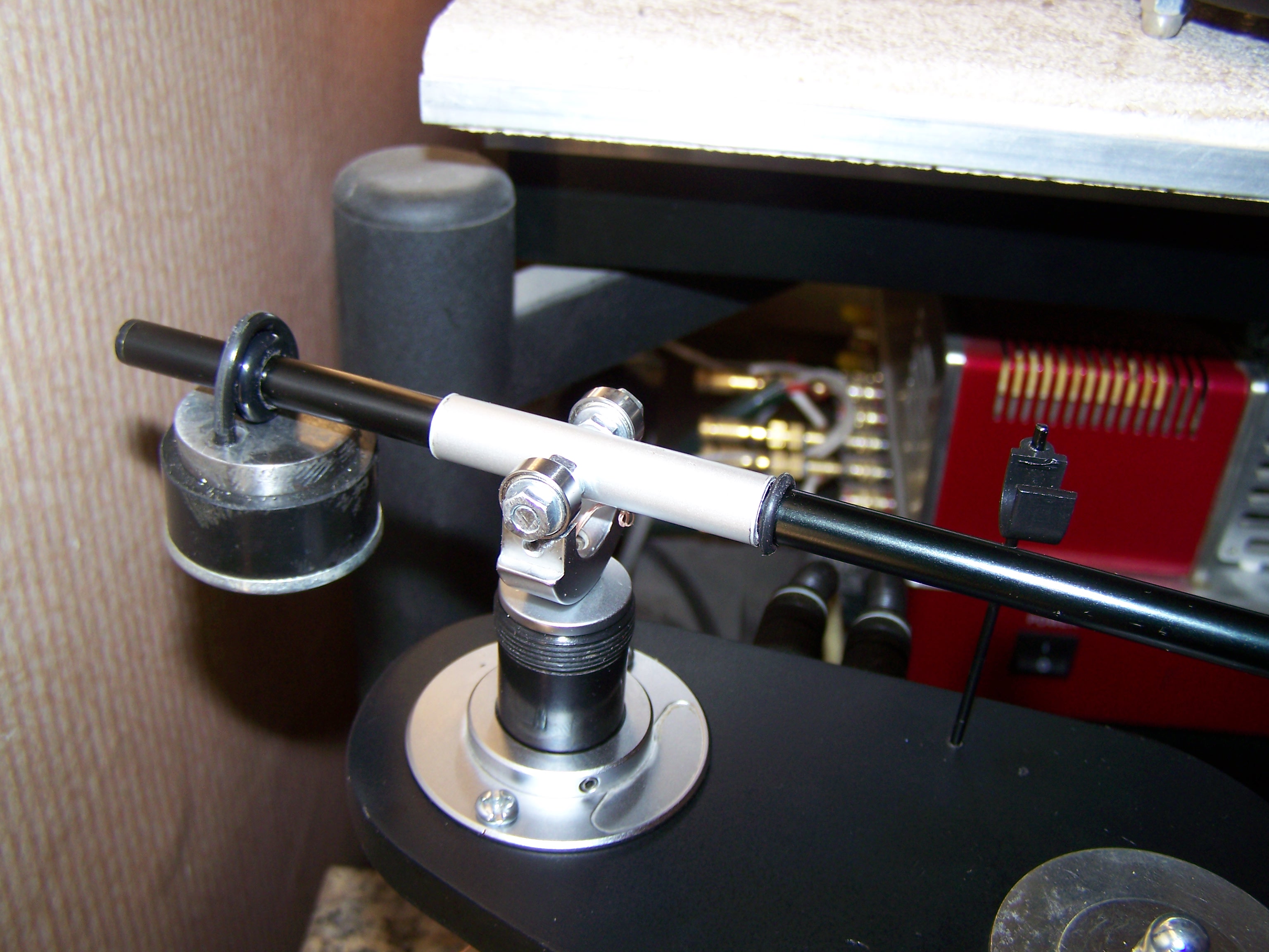

SME Pillar and Pivot
Hi
As promised. This will be the last post on this as it isn't a good unipivot design!
It is ,however, an excellent performer! You need a round file to file down the 'v' on either side to ensure a snug fit with your chosen bearings. Then use industrial strength superglue and there you have it!
Regards
Chris
