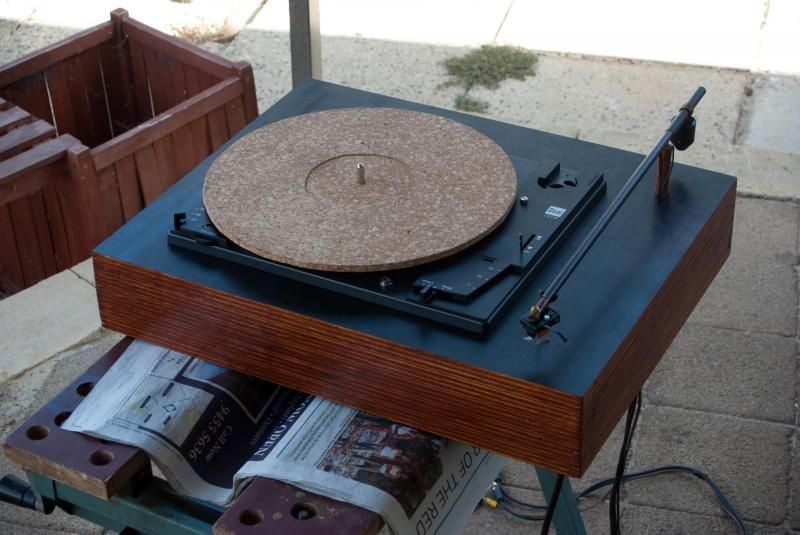

Thanks for the thread guys especially Stew. I have been following this and the turntable thread since Christmas... And now built a dual 1210 based manual (auto stripped replinthed) turntable with a pretty faithful Nanook 219 12" tonearm. Will take some pics and post them later this week however here are some pics of the work in progress. Wires are temporary in these pics.
Cheers again,
Dan
P.s span it for the first time Monday... It's AWSOME!
I'll add detail on the dual side of things in Stews turntable thread.

Thanks Mark, it's bolted securely down, suspension springs are gone and the travel bolts are holding it in place. In fact I gutted everything off it I could, only the idler and pitch adjust mechanism remain. Cam wheel, everything else is gone (except the tone arm lift lever which now releases the idler mechanism). I'll post a full run down on the Nanook turntable thread as soon as I get a chance on the weekend.
Nanook 219 totally worth the effort.
Wow, tone arm is amazing! Not only is the treble and bass tighter (idler drive versus direct may account for some of the base improvement), but orchestral music is more focused with better separation than I thought my At120e was capable of. Best investment I've made in my system for a while (and cheapest).
Next job is to tidy the wires and make an arm lift.

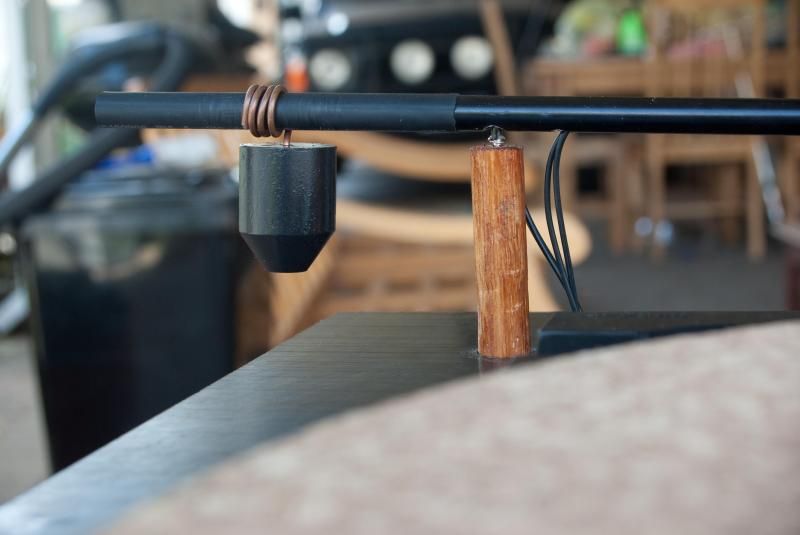

Okay details on my arm.
I have tried to stay fairly faithful to the principle design as it has unfolded through this thread. To that end effective length is exactly 12" with an extra 4" behind to allow my 90g hanging counter weight to be hung off copper wire wound around heatshrink.
The arm is of course an aluminium arrow. The pivot is a Parker pen refill inserted into a 12mm diameter dowel which is snuggly fitted into the plinth to allow height adjustment. The female part of the bearing is simply the dimple left by drilling through the bottom of the tone arm through slightly into the top. No dowel or other packing was used at this point.

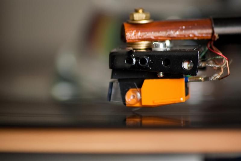

The head is held to into the end of the arm via a honed wooden dowel, which is flattened on one side to allow the passage of wires and the secure mounting of the cartridge assembly.
The dowel is a tight press fit into the arm. The cartridge is mounted in an old very light headshell that has been cut down and drilled to pivot directly at the effective length of the tone arm so I can pivot the cartridge to the correct angle whilst keeping the stylus tip perfectly in line with the arm (looks off in that picture but is adjustable... I'll slide it back into alignment!).
Wires are headphone (type where individual strands are coated in some sort of plastic). Probably the weakest link in the whole thing but it is a 219 tonearm! I didn't strip off all the cable sheath as the wire would snap. Arm tube is stuffed with synthetic cotton wool stuff to dampen it.
As an afterthought a basic fishing line and weight antiskate device has been fitted. I feel safer knowing its on there, but I'm not convinced its an improvement to sonics.
Cork Matt has also been spun out of a floor as an improvement over the old rubber plastic mat that was sucking the bass out of everything.
Turntable as previously mentioned is a stripped down Dual 1210 that I have re-plinthed. I'll post a link on its build when I post it shortly.
Cheers Stew and everyone for this thread, its nice to put something back in after having a good read of everything that's been posted!
