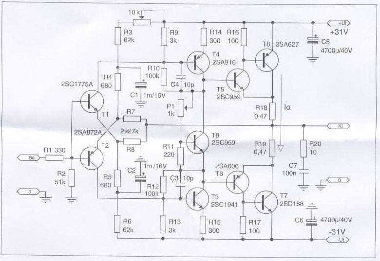

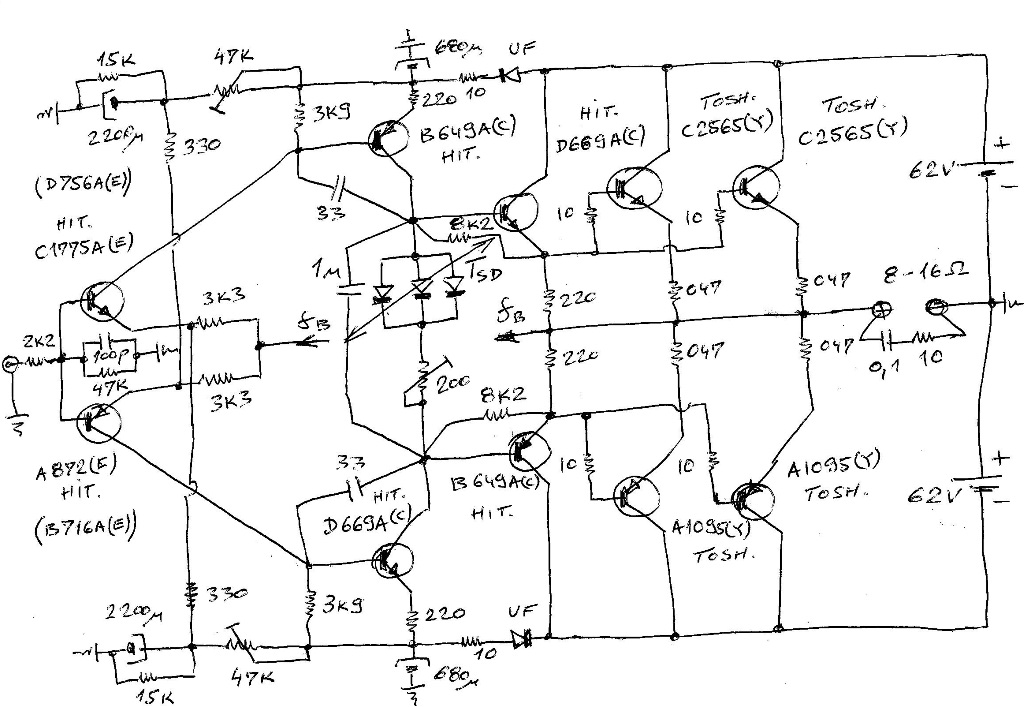

Hi gaborbela !
Want to try to DIY for myself pair of SS AB class Amp based on yours old symmetric Amp design , but instead of output power Darlington`s implemented with original discrete BJT components which come from one old discarded & horrible sounding Japanese PA Amp , relative big heatsinks come from same source to .
Here is my idea & proposed schematic , which can be further modified anyway !
Personally have no big experience building SS Amps , so what do you think about this schematic ?
Thanks in advance !
Thanks in advance !
Hello
These circuit will give you some idea, but these not my amplifier..
I did tested something similar and I run back to the Darlington.
Again you can use your own transistor set but most of the time is better to build something after a proven circuit specially if you are not an experienced guy.
Please forget that high voltage PS even if you would go with 2 pair power transistor specially if you would like to bias the amp for the first watt or so in to Class A.😕
There are several good sounding amplifier readily available at the forum built and tested by many DIY-ers, would be much easier to achieve a good result.
In case if you like these topology and you want to build something similar please use these circuit for starting point, but I have no idea about these circuit how will perform specially with your transistor set.
Greetings Gabor

gaborbela thanks for you answer !
Yes I have no big experience building SS Amps , mostly I have build & designed tube Amps ( OTL) , but I have plenty of experience repairing & tuning SS Amps , doing that everyday profesionaly as TV mechanicus .
Anyway I will continue to experiment with this specific topology from my attached schematic .
I think that your`s Amp topology and very similar amp topology from Mr.Bruce de Palma deserve some attention .
BTW ,
until now only SS Amp with acceptable good sound for me it is by me heavy modified old Revox A78 , which play music 24/7 in my kitchen, for many years I have try to use and listen many different SS Amps without any success .
Best Regards !
BTW ,
Best Regards !

Joined 2009
I agree with others here that it does seem that starting out with +/-62V is increasing the chance of thermal runaway. But you can help a lot if you increase the size of the VAS emitter resistors. Instead of 220R use more like 2K2 ohms. Put some big capacitors in parallel with these resistors. The capacitor will ensure you still have good gain at audio frequency but the large value resistor will help stabilize the VAS current. They will also drop some voltage so you will lose maybe +/- 10V of headroom but I think you can readily afford that with such high voltage rails. It would be better if you start with lower voltage rails.Personally have no big experience building SS Amps , so what do you think about this schematic ?
In a push, you could build each channel using only one half of the secondary, so that you have two single rail amplifiers, one with +62V rail, the other with a -62V rail. In each amplifier you must use an input and an output coupling capacitor. The two channels will then have half the total voltage, equivalent to more like +/- 30V and they will be well decoupled from each other since they will not share power rails. And if you wanted to provide a means to inver the input to one amplifier you might be able to bridge them (would have to think about that).

Now you understand why I wrote 40V to high for 1 pair darlington especially if you push the amp hard.
The same reason I mentioned the heatsink size.
I know these amplifier like the back of my hand. 20+ years testing, trying to improve etc that a lot of time.
Out of experience I wrote about the driver transistors to.
I did tested 3 different pair from Toshiba only highly recommended by experienced guys.
I can look up those transistors and post picture, but do I need to make someone belive.
Plus many other driver from other company was tested...
I can write the same about most of the parts I use, they where thoroughly tested and tested!!!
The reason I asked if someone really want to listen and test these amp or compare the amp at first may build after the circuit.
