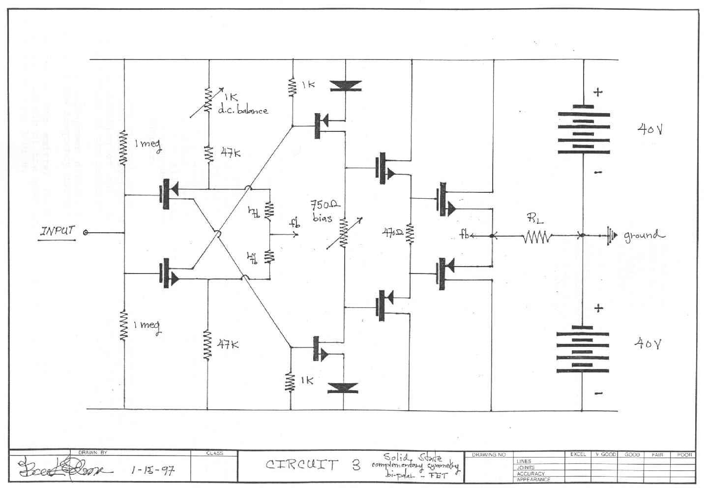

Amp designer Mr.Bruce de Palma long time ago in his design white paper : Analog Audio Amplifier Design
Best Regards !
I remember reading this a couple of years ago, although I was focussed on the tubes. Interesting (his circuit no. 3) option for improving temperature stability with the diode in the VAS emitter circuit. Not sure how it would affect the sound, but it looks like a viable option. However, in simulation it didn't do very well.

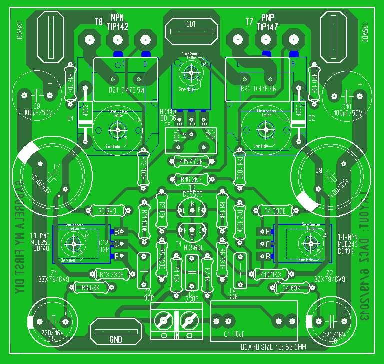

hi gaborela, here is 1 pair layout.
zobel not included
zobel not included
I think this amp needs the bias transistor to be located as close as possible to the power transistors. I'm not quite sure if mounting it on the power transistor like it has been done in some commercial amps, will be better. The easiest way is to try it out. I'll do it with my module. Just wonder if there will be a space constraint as my power devices are below the board.
Of course with LatFET's the issue of bias drift doesn't really matter anymore.
I'm going to compare the two. If the LatFET sounds practically like the bipolar I'm going to drop bipolar output devices from this design .

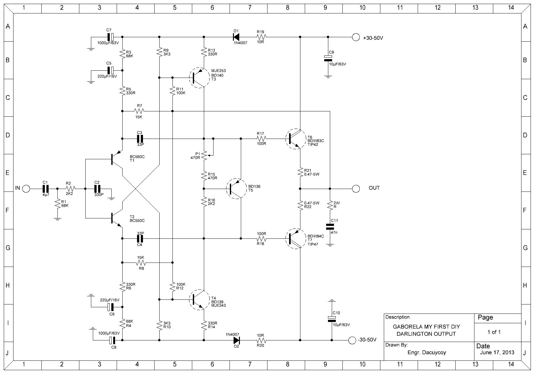

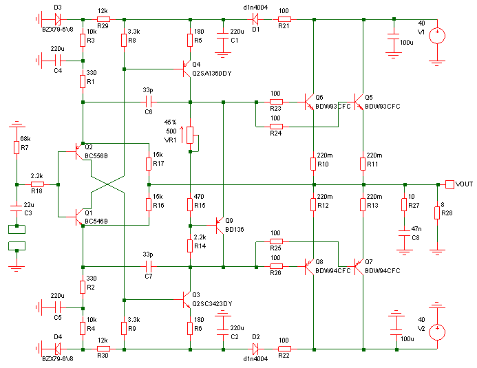

Hi
Yes it does look nice. I like these layout!
I thought you will go with 2 pair darlington. Of course if you go with 30-35V rail voltage (depend on the impedance of your speakers) even one pair will do the job.
Now I want to take a look the version which was modded by wahab.
According to him the 2PC 100K resister bad thik there..
Also he added some type of CCS, two zener diode (these mode was done long time but not tested yet) I do have the PC board for that test.
I'll test it soon.
I buy cheap 1% metal film resister these week for that test, I want to finish my high power Hitachi mosfet amp (just need some cheap parts and I can test that).
I bring these option to your att. just in case if you think it would be worth to ad to the PC board that extra two diode.
According to wahab these mode will help with the stability..

Joined 2009
I would anticipate that differences in sound between the different output devices might be less noticeable when high levels of feedback are used. If I weren't wanting to reproduce a sound I heard 20 years ago 🙂 then I'd go with the LatFETs and I'd save time by using Lazy Cat's pcb too. But as I have plenty of parts in my junk box (bipolars and darlingtons) I might prefer to use what I have, especially as I believe the sound will not suffer as a consequence.
I think having the bias spreader device on top of an output power device gives better thermal feedback (a hole in the pcb works - see my TGM5) - but you have to size the bias spreader resistors (operating point) to get the right level of sensitivity to temperature variation so that it doesn't over or under compensate.
I would suggest a provision on the pcb for a bypass capacitor for the VAS emitter resistors so that you can, if you choose, use larger valued resistors for better thermal stability and install a bypass cap to retain the gain at audio frequencies. I forgot to do this in my TGM5 pcb and so I am looking at how to add capacitors after-the-fact. I use large VAS emitter degeneration to get good thermal stability. This also means higher resistors in the collectors of the input pair - which raises gain and lowers distortion. It looks like a win-win combination on paper at least.

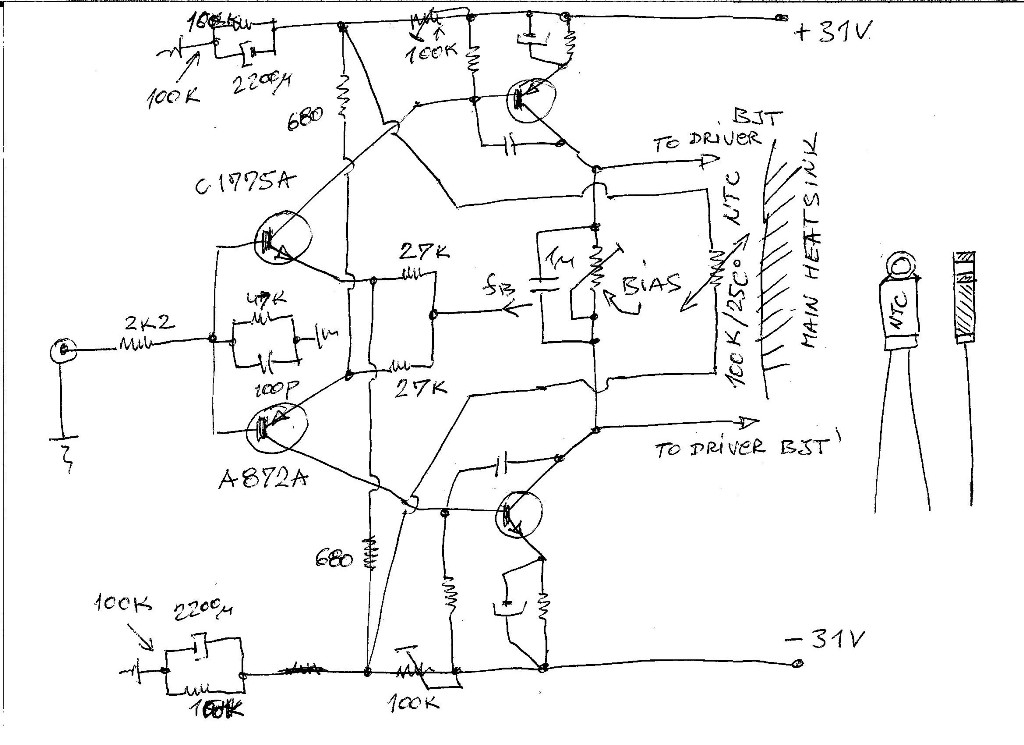

Guys sorry if I jump in again ! , but ....
Just one quick question for Bigun related to thermal stability of this type of Amp :
Bigun check Gaborbela schematic from above ,
Question :what if we insert ordinary small NTC 50 Kohm / 25 C resistor in between of two hot end of C4 & C5 ? (220 uf ) , and that small trough hole NTC is tighten on main heat sink to sense output power devices temperature .
I think in that way we can control BJT input pair emitter`s DC current injection level in common mode , and to thermally stabilize whole Amp .
Maybe I`m wrong ....
Best Regards !
Best Regards !

Here is my fast & ugly scratch schematic of my idea with NTC resistor as temperature compensation , it is same temperature compensation principle as I mentioned in one post before , related to Gaborbela schematic .
BTW ,
maybe I`m wrong but I think that NTC compensation between R 3/4 & R29/30 need two same NTC to be implemented , that solution of thermal compensation remind me on N.Pass F5 Amp .
This type of NTC ( 100K / 25C ) is common inside of PC SMPS PSU`s .
BTW ,
Joined 2009
I don't have the experience to know if there are some things to watch out for with Class AB (F5 is Class A) in terms of accuracy or how quickly the NTC responds to temperature changes but it looks like a valid approach. I think for F5 the idea is to wait until it has warmed up and then it just runs hot so it doesn't have to compensate accurately for temperature. You could do the same, but you could also make it more accurate with more effort - you may have to put fixed resistors in series or parallel (or both) with the NTC to tune it - an adjustable resistor might work best in practice which you could then replace with a permanent value once you have the amp set up in the chasis and have calibrated the right value by trial and error. Overall it looks simple and elegant and allows you to use devices other than LatFETs with more confidence.
Bigun
NTC react very fast to temperature change !
But you are right 100% ! , some experiment I have to made with this type of Temperature compensation to acomodate this simple solution in my real CFB Amp circuit, as you say maybe I need few NTC in series or in parallel , altogether with series or parallel trim pot ....
After all NTC`s are cheap and available .
