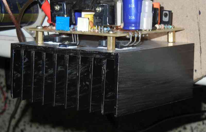

Did a quick comparison of this amp with levels matched against another CFB amp and a Creek 5350 amp. This amp sounds better than the other CFB amp but not as good as the Creek. But some aspects of this amp sounds different ( better ?) than the Creek. The Creek had better weight in the bass end. But as I have noticed earlier this difference could be due to the quality of the input coupling capacitor also. Transients seem to have more bite on this amp. The Creek has no input capacitor.
This isn't the end of this test. I will have to try it without an input cap !
Might cause some dc shift in the output. So the conclusion is that more controlled testing is required. Compared to the other CFB amp it appeared to sound louder and more dynamic even though it was level matched. An input cap problem on the other amp ? Interesting situation. I'm going to bed. Has been a long day.
Cheers.
Cheers.

I worried a bit when you push the amp all the way at 40V rail voltage. Your heatsink way to small, min double req. if you push these amp.🙂 and you need at least 2 pair power transistor. That has to be matched otherwise you invent some problem to.
Now I don't know how much you want to invest to these project, it is your pocket I can not recommend only can give you some advise or share my experience.
I never used at these project small power supply caps. I used 4PC Mepco 50 000uF CRC set up, and I used Mallory also 4PC 62 000uF. Those are my bench power supply.. I purchased for these project some Super Through 6800uF and Kendeil 50 000uF caps but not tested yet.

the bias adjust resistance must be in the base to emitter link.............Bias transistor question ( Q9). Any special reason for using a PNP instead of a NPN ? I used a NPN ( BD139 ).
The Creek is unlikely to be a DC coupled amplifier............. The Creek had better weight in the bass end. But as I have noticed earlier this difference could be due to the quality of the input coupling capacitor also. ............The Creek has no input capacitor.
The bass roll-off in the Creek may be arranged around the NFB DC blocking cap.
This will increase the low bass distortion and give the effect of a weightier bass.
Alternatively, the Rin/Zin of the Creek could be lower, or much lower, than your new amp. This would affect the filter that is created by your source DC blocking capacitor.
I suspect there is a scientific reason for the apparent bass difference and that your comparison is not valid due to unexpected filtering effects.

The Creek's input is dc coupled. No cap at the input. The amp I built has a coupling cap at the input. I was not referring to the NFB dc blocking cap.
I tried the amp without the input coupling cap. Sounds very good. Didn't make a comparison now. Just been listening to it for several hours. Nice. Low level detail is very good even at low volume. DC output offset went up from near 0mV to about 15 mV when the input was dc coupled. This DMM has a min 1mV resolution.
However the output bias does drift quite a bit when the heat sink gets hot. I didn't have a black anodised one so I painted this one matt black with enamel paint.
I had asked about the PNP or NPN bias transistor in case either one was better suited. But since the tempco for the junction for both is the same I figured that it was a choice of convenience.
It's too late at night to play loud and so can only do low level listening now. Have a lot of other things to do tonight. Will continue tomorrow or over the weekend.
Will try to get some of the caps mentioned. For the input I have some boutique caps. Will try them out also.

My experience the input capacitor it does effect more the tone of the sound than to get deeper bass (extension of frequency) etc. Of course a bad (quality or value) cap on the input can round done the bass, can make the sound muddy or can cause other negative effect to.
I would strongly advise to change the BD139 to BD136 or to the more available BD140.
Yes that play major rule at the bias set up, also it cant effect the all over sound to.
Your heatsink way to small for 40V rail voltage, and one pair TIP already pushed to the max or until the amp clip.
Be very careful if you blew up the amp that will take out your speaker in case you have no speaker protection!
You must be able to keep your hand on the heatsink any time, thumb rule.
I would not worried about the offset of the amp, few mV movement is not a problem.
I built the famous M Hiraga and the Class A to both has some offset movement how the amp warm up or get pushed.
Honestly I think you don't get close to the amp max performance..

Gaborbella: Are you sure my heat sink is too small ? It isn't a flat plate . It's a finned heat sink which is now painted matt black. The size of the heat sink is about 100x100mm and 45 mm deep. There are 14 fins each 45 mm long. I'll post another picture later as the original didn't show the fins which are facing down.
Yes in these profile your heatsink bigger than I taught.
Still be careful the 40V rail voltage a bit close to the max on one pair TIP transistor.
The driver does not need heatsink.
Please replace the input transistors and the BD139 to.

.....Yes in these profile your heatsink bigger than I taught.
Still be careful the 40V rail voltage a bit close to the max on one pair TIP transistor.......
The supply sags on playing loud. My scope unfortunately has a problem with the switches so the display is not accurate vertically. So I can't confirm what the real clip level is.Will have to fix this or buy another scope. Will try to fix the dead scopes first. Maybe just spray Doxit-D5 on the switch contacts first!
........The driver does not need heatsink...........
Most likely. But it does get slightly warm. Will remove it and see what happens to the bias drift.
.......Please replace the input transistors and the BD139 to.........
Yes I will search for the BC560C. It has to be here because I bought both pnp and npn at the same time.
......I advise to get read of that cap multiplier stuff and use a CRC capacitor bank..........
The cap multiplier does improve the PSRR especially at the LF end. But I did plan to remove it and make a comparison.

.......At my last test even with the mentioned cheap darlington with these drivers ans JFet on the input I got excellent performance.........
I will try out the input FET's ( 2SK246/J103) I also have the 2SK170 but not sure about the complement 2SJ74.
............Please replace the input transistors and the BD139 to.........
It would be good to test the drivers with out heatsink and with heatsink I mean to make some measurement.
I never did it.
I touched any time only it get slightly warm. In case the heatsink help to make the amp more stable please use it and let me know.
Thank you.
Be careful with the 2SK246/J103 those are not the same like the 2SJ74BL/2SK170BL.
If you do not have please stick with BC550C/560C.
The biggest difference between the JFet and BJT warmer sound to the favour of the JFet, there are some other differences but if you don't have.........
Those are hard to get and expensive today and only BL type the direct replacement for the BJT.
Yes I understand your amp sound good even with the Samwah caps to but I know how bad they are for audio. I did tested in the Symasym and after few sound track I trow them away... They are that bad!!!!
Panasonic FC great bad but in the bass area a bit weak.
Nichicon Gold or MUSE (the black) not expensive and great value for the money.
BD140 you need on the heatsink, also it influence the bias set up. I'm amazed the amp works properly with the BD139 to.
I understand hard to swap components because your PC board design (mounted on the heatsink).
That is why I don't like that type of PC board specially until the amp thoroughly not tested done to the last components.
I do had a friend who always designed our PC board that way with software.
I do hate that, when I want to test something always has to be removed from the heatsink..
It take lot of time, most of the time I'd rather left the amp how it was.😱
But you can mount my PC board the same way like yours to because small compact size..
All that I asked from you please take it as a advise only!!🙂
Only one think motivated I know the amp, I tested thoroughly over 20 years, I used a lot of parts it does sound good with most of them but with the rightly matched components it is incredible good.
OK please enjoy your amp and when you find out new thinks, improvement etc please share it with us.
Thank you🙂
