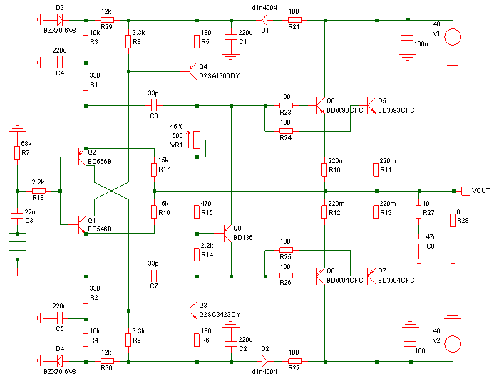

Albarry amplifier in 80' use 2 couple of tip 142/147 with overcurrent protection with +/-50 volts dc and can handle 4 ohm impedence, power around 200 watt on 4 ohm.
Hello
I even used one pair BDW93C/94C at 37V 50mA with 8 Ohm load. The TIP more rugged. Honestly I didn't heard sound quality decrease when I swap to TIP.
You can use them around 40V rail voltage for 8 load but please make sure the heatsink is large enough otherwise you will end up with a thermal runaway. That will take your speaker out!
How Mr. Pass use to say there is no such think over sized heatsink. These type of circuit do run hotter than usually bipolar or mosfet at same rail voltage at the same bias.
Probably because the Darlington package??
Your transistor set look fine, please use BC550/ BC560 on the input.
At 40V rail voltage will work fine! I do use those at 37-38V .
20 + years a go I used BC414C/416C at 51V rail voltage..
Again please start with low bias, with 50mA later you can increase it up to 100mV but these depend on the load and the size of your heatsink also.
I use 2 pair TIP for safety reason, that will give some headroom and a piece of mind.

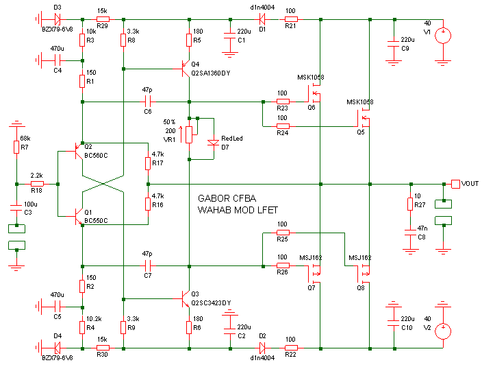

To be honest I did built several amplifier with Hitachi Lat. mosfet and nothing come close sound wise to these little amp.
Of course I do want to test these circuit with Hitachi mosfet to.
You find the circuit in these thread, modded, by Mr.Wahab.
Also there is a another Hitachi lateral mosfet amp modded, designed by Wahab, I'm 97% ready stuffed those boards to but still yet to test her.

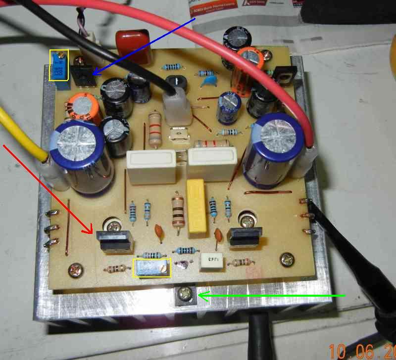

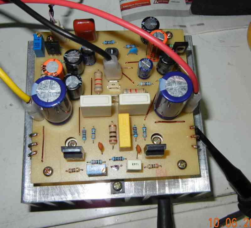

Hi G,
I found the BC550C but wonder what happened to the BC560C. Must be somewhere. But I didn't have patience and used BC546B/556B . Hfe 324 and 335 . I was surprised to find these two so quickly. I'm sure that generally they don't come that close.
Supply is +/- 40 V. I've used 3.3 ohm resistors in the supply line. Something is wrong on the board as the current is very high. But so far nothing blown ! Am currently going over the layout and the circuit diagram. Will confirm that the parts are the right way round !
Sometimes faults are not noticed if one keeps looking at them continuously. A break helps a lot. I'll post a picture tomorrow. It's almost 10 pm here and I want to turn in early. Last night I was up till past 1 am !
The board isn't very well done but I spent a lot of time to keep parts where I wanted them and so the tracks may not be perfect. Lots of space could have been saved. That can come after I get this board working. I made only one .
The supply is off board and has 2x10,000uF on each supply line ( that makes 4 x 10,000uF in the supply). On board there is a 2,200uF cap at the supply point on each line. Power supply to the input stage is via a capacitance multiplier. On simulation it gives a much better PSRR.
I'll try to post a pic in a few minutes if possible.
My input cap is a film ( polyester ) 1uF/250V unit that sounds very good compared to some expensive caps I have here.( Epcos, Solen, Mundorf Supreme, Jupiter etc.) I will try out the other caps because I don't know how they will behave in this circuit ! All electrolytic caps are either Samwah or Keltron. Keltron's are orange coloured.
Cheers.

The bias set up is correct?
I do like to set up the bias these way
Connect the DMM between the capacitor bank and the PC board, a set up the multimeter to 200mA.
Do not forget to check the trimmer to get the highest value before you ad any power to the circuit boards..
Most of the DIY-ers do measure the bias on the Emitter resistor (voltage drop), I do not like that way to set up the bias at any amp.
If you still has problem to power up the amp start to check the transistors, capacitors polarity.
Someone designed a PC board to me with one pair power transistor by software and I was unable to power up.
Something always blew up so I want back to my old hand drawn layout and that works perfect.
I hope you find the problem with out any smoke or fireworks.

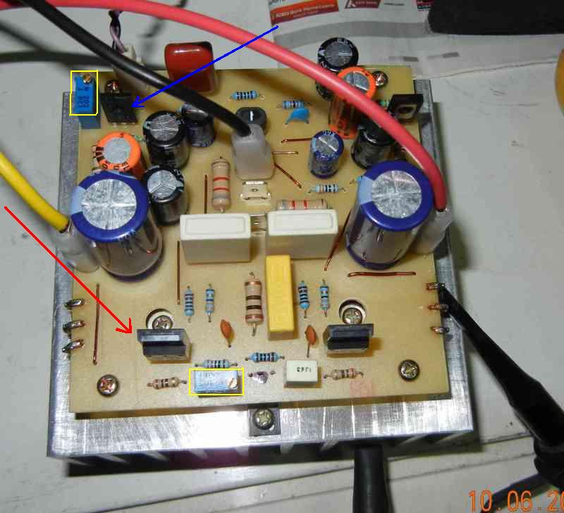

I did look at your picture you posted.
I see several questionable components
I did marked some of them.
Why do you have two pair driver transistor or what ever are those I marked with arrow? Red and blue.
You have two trimmer on your board (one for to get read of the offset??)
I do see to many caps on your board..
It is the best way to put the 10uF as close am possible at the power in and power transistors..
I posted my lay out 100% works. I will mark the component place soon.

OK. There were no suggestions and so I'm going to use BC550/560 or BC546/556
, 2SC4793/2SA1837 and TIP142/147 . Bias Tr BD139.
Supply +/- 40 volts. ( With LS protection/relay )
If you mean the green marked transistor on the picture (Bias Tr BD139) that has to be BD136 or BD140 PNP and not NPN.
Please check that to🙂

Hi G,
I could not post a reply earlier as we lost power last night past midnight and it's mid summer here ! Lots of other catastrophes too last night. Two scopes died ! Don't know why but they are over 10 years old.
Also discovered that I had interchanged the NPN and PNP output power transistors on the amp board!
After that was fixed I discovered too late that another electrolytic was reverse connected and blew spectacularly just as I noticed it !
Then the power failed and I decided to call it a day !
I mentioned that I had used a capacitance multiplier and that's why there are two additional TO126 transistors and about 4 extra electroytic capacitors ! The extra preset is to set the offset voltage . The other one being for bias current. I can revert back to the basic circuit by shorting out what is not required. I built this board this way so that I could compare the stock circuit with the slightly modified one . Just so happened that I started off testing the modified version first. Doesn't affect the signal path , only the dc supply to the amp. The board was designed to fit the heat sink that I had and that's why it looks the way it does. It's still a bit larger than I wanted but that can wait. Ultimately if I build two channels I'll put the power supply and speaker protection on the board too. The heat sink will be different too.
Now I will have to sit down and fix the blown capacitor and try to find out why the scopes died ! One surely has a psu problem as it emitted 'blue smoke' after sizzling for a moment !
Today will be a very busy day ! There are tons of other things to do!🙁

Because of that those have to be the last parts mounted to the board.
Jumpers are grey colored.
Greetings Gabor
Very nice. Looks like you are using two pairs of output transistors. I've used only one pair on my board.
My emitter resistors are film types and very short , pin to pin, and so cannot be used as shown on your board. However it is interesting to see how you have arranged the parts. You might have noticed that I wanted to fix the board direct on to the heat sink and so the power transistors had to be located under the board. Not a good place for trouble shooting ! Even changing parts is a pain as everything has to be removed and care taken when mounting it all back on to the heat sink . My current board is about 95x95mm. Quite large for one channel !
Up and running ! Great sound.
A quick update. Changed the blown cap and all is fine now. Offset adjusted to less than 1mV. Hasn't drifted by more than 1mV over a span of 2 hours but temp of heat sink has not changed too much either. Currently I can only get 60mA bias. The bias resistor has to be changed.
So on to the music. It appears to be VERY good ! On one channel it sounds great even with a protection resistor of 10 ohms in series with the power supply ! Will try it without the resistor as soon as I am sure everything is really fine. The bass sounds great while playing 'Sade'. On par with some other good amps here. But it might be even better without the protection resistor in the supply rail. Voice sounds very good and HF is extended without sounding clinical. Great potential. I'll have to get cracking immediately on a stereo board with two pairs of output transistors. I will try it with the capacitance multiplier removed and see what happens. Present load is a Behringer 2031B speaker.
G : This is a great sounding amp. Will make comparisons later with some other amps but as it is, it sounds great. Thanks for bringing this amp to our notice. Will rig up a stereo board with dual/single pair of power transistors.

Now I have these amp with power Lat Mosfet and also has another version where we invented some protection against drifting..
I didn't tested the modded circuit but I do not see reason for sound quality reduction.
I do love the mosfet sound but I think we never get the same deep bass from power mosfet in these circuit, based on my experience with mosfet.
Of course it has to be tested and proved.
For the input cap please try to use 2PC each mounted opposite direction.
I post the schematics for the modded darlington and LAT fet to.
I do has the lay out for both but again it was not tested yet!!!

Must check out dc offset stability and bias current stability. Maybe one should add non intrusive overload protection ! Like Apex ?
I set the offset to almost 0.000V ( 1mV min display). After a few hours it was +15mV. I was playing music loud all the while.

Bias transistor question ( Q9). Any special reason for using a PNP instead of a NPN ? I used a NPN ( BD139 ).

Did you find FET input transistors sound better than bipolar ? The Lat FET circuit has an advantage that it would be dc stable ! It's probably also fairly immune to shorts due to the high internal resistance of the device (?) . Since the circuit has NFB the internal resistance should not matter with regard to bass performance . Or did you 'compare' the Lat FET and Bipolar output devices and found a difference in the bass ?
