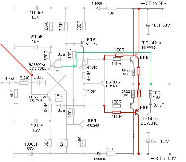

wahab do you think these amplifier with lateral mosfet can achieve close or similar performance to the orig darlington?
I mean the circuit you posted last time.
I modded the layout from the darlington to the lateral mosfet in case someone interested.
Now nobody can say " I do not like the darlington devices"! I'm not interested on darlington, etc......
Here is the opportunity to try out the same topology with laterals.
I used the the color coded method since I draw the layout with the paint program with out any software.
So I do not have silkscreen, please do not ask. But these is so simple hard to imagine someone would have problem to find the component locations.
Of course I'm more than willing to help. The layout not tested yet but very likely is OK.
Greetings Gabor

Hi Gabor ,
Since the schematic is the same as with Darlingtons , set apart
the components values , performances are close , with a slight
hedge in favour of laterals as their higher input impedance allow
lighter VAS loading and consequently more open loop gain that
will translate in lower distorsion although good quality darlingtons
would be on par.

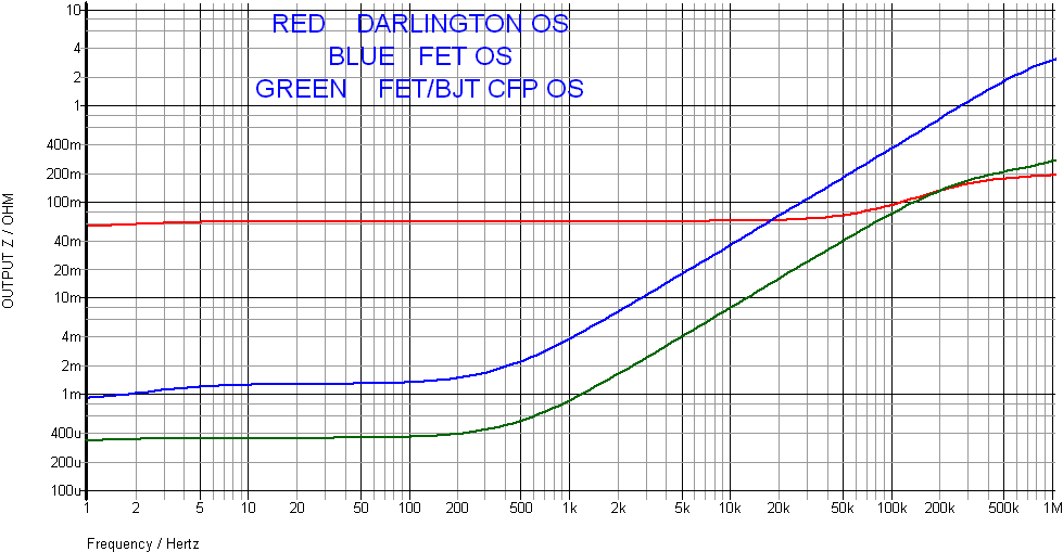

Can you simulate the output stage as a CFP with low wattage Latfet like the 2SK216/ 2SJ72 with BJT bipolars like the 2SC5200/2SA1943 . If you have no Spice models then use the 2SK1058/2SJ162 . I don't have the Spice models of these Latfets. Output BJT run under normal bias ( maybe 50 mA ?) and also alternatively biased to turn on only after the driver delivers about 0.25 Amps or so ( depending on which Latfet you use).

Coming to the amp Gaborbella brought up on this thread.
If i understand correctly , implementing FET/BJT current feedback pairs
as power output devices.?..
No problem , i ll take a look at it but at first thoughts , the difference
will be mainly in output impedance , distorsions ratios should be close ,
i ll check the "exact" numbers.

Wahab I would like to have a few question to you.
First I see you left out the 330pF capacitor from the modified darlington and the lateral Fet circuit to.
I think that was purposely. Can you gave me some hint, I do not miss that capacitor just I want to know is not an error.
Do you think these topology would work with out major mode with power BJT like the mentioned Toshiba 2SC2500 and complementary?
Please let me know before I etch the PC board, I'll give a try to the lateral version just to compare with the Darlington.

Hi Gabor ,
Well , this capacitor (along with the 2.2K resistor) will reduce the high
frequency -3dB cut off to 130Khz , down from the 240Khz if it wasnt there.
I suspect that it was added as RF filter rather as well as slew rate limitation ,
as in Europe the radio broadcasting AM band start at 150Khz or so with
emitters less powerfull than in the 70s , but still being a problem for
whom is living not too far from the antennas , so if you have nearby
RF transmitters it can be usefull to implement the said capacitor.
Other than RF concerns , this also limit the signal slew rate to cope
with the BDW83/84 6us slow turn off.(2us or less for the BDW93/94)
Replacing the darlingtons with two drivers and two 2SA1943/2SC5200 pairs
wont improve the perfs by a sizeable amount providing the comparative monolithic
darlingtons are not beta starved , in wich case there will be
a difference when driving lower impedance loads than 8R , and this likely
is the area where Sankens could have an hedge over the STMicro BDWs ,
wich are requiring tests before mounting to eliminate low beta samples.
As for popularity of darlingtons , or rather lacks of , i think that it has
more to do with urban legend than real technical ground , seems that
experiences with decades old slow devices like TIPs or Motorola s early
production where kept as definitive conclusions for all possible monolithic
darlingtons , past , present and future ones....😀

Any progress on the amp ?
I've just drawn up a schematic using Jap transistors and TIP142/147 based on your last schematic but with slightly modified parts values. Supply will be off board. Will attempt to make the board as small as possible.
Hope to have it ready in a few days.....if the work doesn't get stalled by unforeseen circumstances !
If it works Ok I might replace the 142/147 with 2SK1058/J162 and see what happens.
Cheers.
Cheers.

Hello
My advise to you please use first those transistors I used at my last test!
That will give you a base to compare some other Darlingtom, Lat fet etc...
Reason I write these because that was tested and works properly.
Al do Sanken produce some nice device not much information about and the chip inside built up not the same as BDW83C/ 84C or TIPs.
My last test I made with the TIP147/142- the result was incredible.
Yes I compared the TIP with BDW93C/94C and no audible difference at all! The TIP142/147 more rugged than the BDW93C/94C..
I know there are some new and better darlington chips out there but if not compatible with the orig after you get the idea the amp sound bad, not working properly etc.
If you use 2 pair power transistor please try to match them.. There is a matching instruction some page back from Wahab!
I didn't tested yet the modded circuit, was modified by Wahab. I need some clad board to etch the PC boards for that and the lat fet version to.
My advise to you please use the last circuit was posted by me at post #251.
U can use for input JFet or BC550/560 C grade.
I advise first use for VAS MJL243/253.. Reason I did tested several driver transistor here and to me MJL is the favorite.. Including some famous drivers from Toshiba...
After you can change use what ever you like but again you have a comparison base.
Be careful if you want to use lat mosfet because need some mode!!!!
Mr. Wahab already mode the circuit so we can use lat mosfet but that is not tested yet!

Please do not mode the amplifier until you do not test the orig! After if you feel you can improve it please do so, I'm not against that. I just want you to avoid you run into in to some trouble or get a bad result!
I spent ### hours with these amp I know what I'm talking about.
Another think, all do these look a small amp please do not undersized the heatsink.
Greetings Gabor

Right Gaborbela. I will use the TIP142/147 as I have many of them and have no other use for them right now. Second...if things should blow due to errors then it is a small loss. The Lat Fet's are expensive and so are other power devices.
I have some decent power amps to compare it by. Will let you know what happens. I've been curious too.
Cheers.
Cheers.
