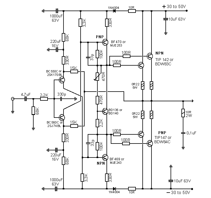

Hello
Catalin I hope you do not get upset because.....
You know so many guy wrote "I'll build or "I'll test that amp", please send these or that etc and until now nothing..
To me over the 22 years or so the best sounding amp I built.
I stated many time it was my fault the thermal runaway. We can not set up a new amplifier bias high and fall sleep.. Also many darlington device from ISC BDW83/84 (high power garbage)!!! I powered up the amp and after 20-30 min. the darlington gone at 50mA low bias.
The lower power BDW93/94 from SC micro worked perfect even on 100mA bias for weeks!!!
If you don't find BDW83C/84C from SC micro (sometimes marked Morocco) please buy TIP142/147
I didn't meet a guy ever who heard the amp didn't like the sound.
One think keep in mind these is not a PURE Class A amplifier. Those darlingtons can't take the heat specially not at 40V rail.

How will it be unstable ??.by wich mechanism that a simulator couldnt spot.??..
Also , keep in mind that we re talking of the circuit in this thread ,
not eventual versions that you perhaps has trouble with.
Do you think that your transistor models accurately simulate BJT tempco ???
I havent ever had trouble with this circuit, build it first time about 22 years back and with some input from JLH himself, the original designer.
In this case one can get away to some extent with the vas bias stability as the darlingtons are biased high and no regard is taken to THD, its even better with the circuit in class A operation but what happens when you want accuracy.
Why souldnt it be the case ?....
I dont understand why you think that such a basic parameter
is not accounted.
In sims i checked the variation from 20°C to 80°C , and the numbers
correlate of course accurately with the theorical behaviour.

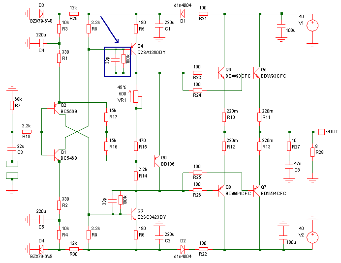

Hello Guys
Let s stick with the given circuit to comment that!
I do not say not to write about similar amplifiers only just we do not lose the focus.
Here I had these circuit which I think wahab made it "more" stable..
How I understood all the similar amplifier design suffer from the same problem.
By the amp warms up the bias rise up to, (that is true about the Mosnster Hiraga to, I built it. Mostly the bias after total warm up almost was double like at the start up)
Now if these not compensated with a large enough heatsink it will lead to thermal runaway. That is 100% sure. Doesn't matter if the amp use power Darlington, normal BJT, or mosfet.
I read someone had similar issue with power mosfet!!!
Again that mean these amplifiers req. the adequate heatsink size.
What I ask here if we can slow done these bias movement a bit.
wahab came up with a solution which will be tested soon, thank God and thank to wahab for the help.
Also if I understood well if we take the feedback only from the input pair these drifting will be reduced by a lot. Now I'm not sure until I don't test how that effect the sound is anyway at all. We will see soon.
Here is nothing to do with anything else. We (I) do not want to upgrade the sound of the amp!
The amp sound better than someone can expect from!

May i ask , the solution to what ?..😕
Seems that this topology s drawbacks are still not very well understood
by many people , not talking of you but of absolute beginners , think that
i ll soon make a little tutorial in this very thread to explain basicaly the
voltages and currents dependencies between the nodes , this will allow
non experimented people to yield an acceptably stable design.

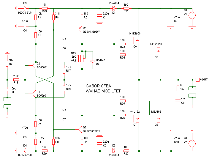

It is the solution to an unstable Vas current influencing the output device bias point. The common Vbe multiplier does not hold a very constant voltage differential under fluctuating current conditions, but the Hagerman topology offers a significant improvement - good enough perhaps. This is what I used and it measured good.
Thanks for the precision Bigun.
The VAS current variation itself can be reduced by increasing the voltage
through its emitters resistors but this will yield lower output voltage swing
as well as lower OLG since the VAS emitters resistors must also be increased.
The other source of VAS current variation is the input stage varying current
if ever the emitters DC loading resistors are connected to unregulated supply
as in Gabor s original schematic.
On the DC output offset variation , the input stage is the main culprit
and to make things worse thermal coupling of the input transistors
is of no real help , moreover as the VAS and output stage have
an influence as the feedback path has a significant DC current flow.

Wahab at these amplifier can I use those Hitachi driver transistors or better to use the Toshiba here to.
I would like to test BD829/830 transistors for VAS, I read those are great drivers all do hard to find them.
Today I received 10 pair TIP142/147, I have 10 pair BDW83/84C from ST also some MJ11015/15 & 2N6284/87
The last two pair are in metal case but I will test those to. I need those metal case transistor for Pass A40 amp.
I borrowed from that old circuit some idea, I'm not sure will help to improve the sound.
I added to you circuit wahab.
These circuit based on a Hungarian popular amplifier called HEED amplifier.. Very similar to my orig circuit accept the feedback was taken from the front and the 33p cap was added to the VAS.
If you think it make any sense to use those 100K resisters with the 33p capacitors please let me know. I will test that way to.
I have some clad board left over to make one more set PC boards.
For these amplifier I need the resisters also, I made the PC boards which include your mode.
Greetings Gabor
Greetings Gabor
As said in previous posts the BDW are the best choice in this list ,
i wouldnt recommend the TIP for anything other than as capacitance
multiplier where they would suit perfectly.
Greetings Gabor
Theses 100K resistors should really be eliminated for good , they only
help creating thermal run down as well as more distorsion , higher output impedance and so on , they degrade the amps perfs by any possible metric.
It is likely that this schematic has gone "borrowed" from a designer to another
with this original "feature" being unquestionned or even thought as possibly
improving the sound , but for sure not only it is the opposite but it has been
undoubtly a source of never ending hassle for non experimented builders,
i just imagine all the overheated/exploded devices due to this misdesign.....😀
The 33pF compensation capacitors are better left connected to the input stage emitters , as in your original schematic as well as in the modded version , since the amp is more stable with better phase response this way.😉
Edit : A possible mod is to add a 10nf capacitor from collector to emitter of the VBE multiplier ,
this wont change the whole picture , though , it s almost an aesthetical mod.....

Thank you for the information.
OK I'll stick 100% to the circuit was modded by you. Of course I'll compare that with the old circuit.
Those TIP transistors were ordered before you wrote better to use the BDW.They just arrived today after several weeks.
I will buy the Toshiba devices for VAS, I just don't want to get them from ebay or other unsecured source. Even in the local store here in Toronto we can get lot of counterfeit semis.
I do not mind the investment in the TIP ($20 for the 10 pair) including shipping.

Can I use Lateral MoSFETs, 2sk1058/2sj162 instead of output darlingtons, of course I'll change the Vbe multiplier bias resistors to adapt to the higher voltages required by the MoSFETs.
I see people work with these type topology a while but they use Lateral mosfet.
I would be happy to see these topology using BJT power transistors but not not something over complicated. Or someone would implement the Sanken (the thermal track darlington type)
Greetings Gabor
Well , laterals are quite forgiving and have the big advantage of a negative temperature coefficient , that is , the hotter , the less the iddle current , i also like those components but , contrary to an unexpectedly high number of members , i m a big proponent of darlingtons as well , i just dont understand why they are vilified , surely because there s a lot of misconceptions about them , the most recurrent being a very bad understanding of their beta vs current curves....😉
A straight forward replacement of the darlingtons by lateral fets
would work , that makes no doubt , but then the circuit has been
optimized for BJT output devices in respect of the input stage
to yield an acceptable DC output offset variation.
You can try directly this version using Lfets but if ever the output
DC offset variations are more than 20mV for 50°C temperature
variation of the WHOLE circuit , a few components values are to be
changed , see below , the feedback resistors should be reduced and
the compensation capacitors increased to 39 to 47pF to cope with the
resistors lower value influence in stability.

wahab thank you for the lateral version of these topology!
I have only one question, can I use source resistors? I ask because in that case it would be OK to use use my layout with a minimal mode.
Thanks once more
Greetings Gabor
Thanks once more
Greetings Gabor
Well , the Darlington version values would work as well , this variant
is only if it doesnt work good enough DC offset variation/temp wise
when switching to laterals.
Of course source resistors can be added usefully if the devices
are not matched but anyway two pairs are needed to provide
enough output current in safe conditions.
That said i think that laterals would find a better use in the FFet
Hitachi amp project as higher feedback allow to compensate for
their lower conductance.
