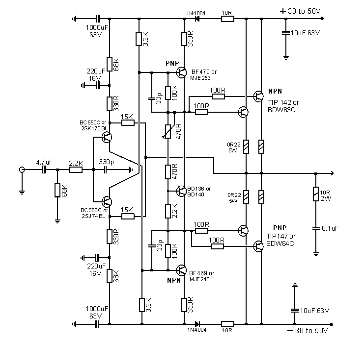

The 4.7R resisters has to around 20W?? otherwise with the resister temperature will change the measured V which would change by the warm up..
Can I use my 16V PSU here??
Yes , a 16V PSU is adequate as well.
The 4.7R resistor will dissipate about 2.5W whatever the PSU
but with 16V the transistor dissipation will rise to 8W.

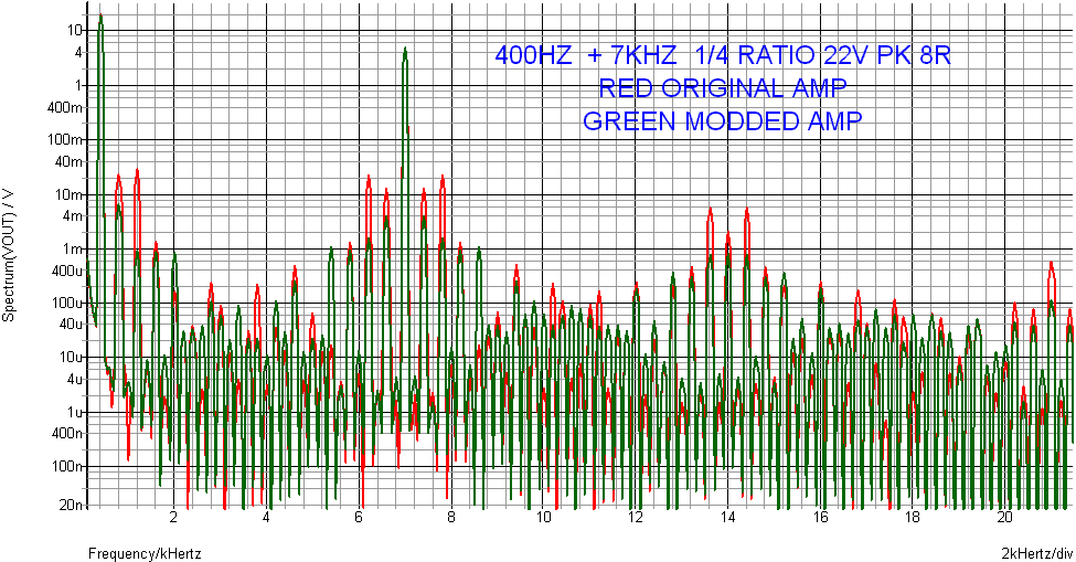

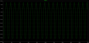

I suspect that this "warmth" and "tube" like sound is due to high distorsions ,
particularly intermodulation wich is at least 0.3% for 400HZ + 7KHZ 1:4 ratio test, and about at the same level that "good" tube amplifiers..
The effect of the 100K resistors influence goes beyond DC operating conditions as the resulting low global feedback has trouble removing intermodulation products.
For info , 400HZ + 7KHZ 1:4 ratio IMD is simulated below for both the original amp and for the modded version that get rid of the said 100K.
I let you imagine the picture with more than two frequencies , wich is the case for music...

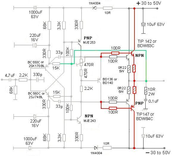

Hello

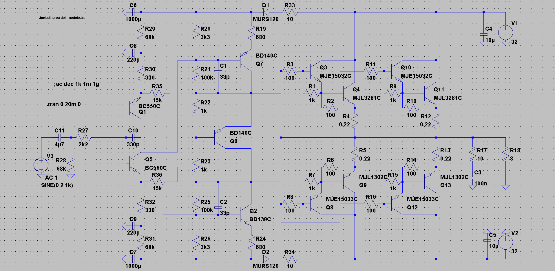

Wahab here is modded version of my Darlington.
Feedback taken only from the input transistor (in my case JFet), the 100K resister and the 2PC 33pF was moved to the VAS.
Probably with these mode the amplifier will be more stable. I'm not sure if these degrade the sound, it would be great to know.
If the sound would remain the same I would mode the layout to and I would test it.
I have to go anyway to do laser printing for the Hitachi mosfet amplifier, I added the latest mode to the layout.
Before I start the etching of PC board it would be great to have your opinion about these mode.
Would you be so kind please take a look at one more time. I promise I do not disturb anymore with these amplifier.🙂
Thank you very much!
I att: the old circuit to so you can have at your hand.
Greetings Gabor

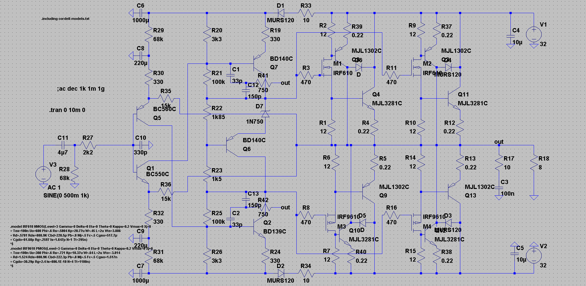

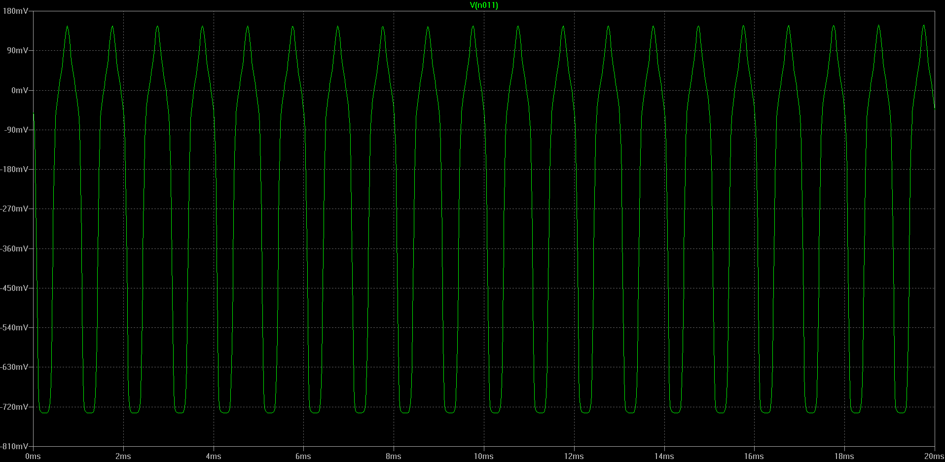

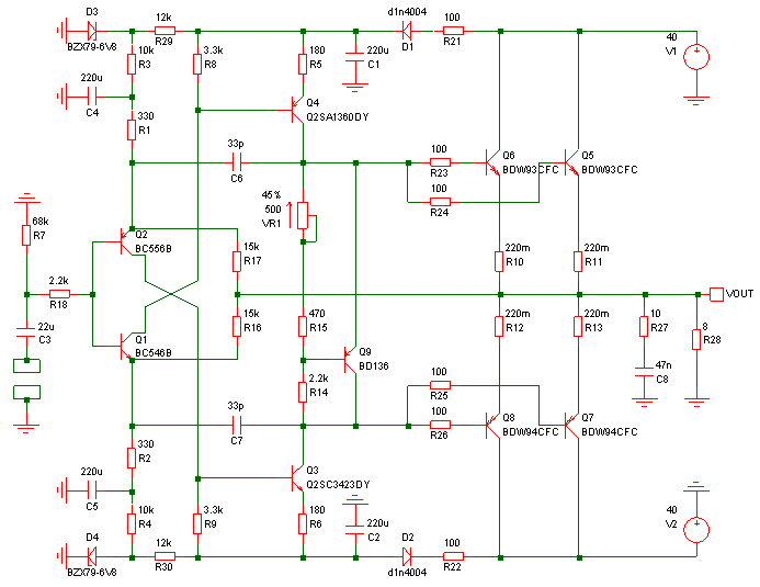

hello
I tried to make some sims with ltspice
and it was impossible to find the models of the darlingtons. Instead of this I used hybrid darlington made of MJE15032/3 + MJE3281/1302.
but the simulations are strange
please tell what should be done to make this amp ok?
thank you in advance
Hello
When you try to run some sim please look for the next darlinton pairs
BDW83C BDW84C
TIP142 TIP147
BDW93C BDW94C
BDX53C BDX54C these Darlintons are all good if U chose the right PSU
May be you find some model of the other two pair darlington
If not that is the big problem
I tested the Hybrid darlington in real life and sounded horrible
I spent weeks on tests and after I gave up. Even my best result had a huge sound difference in the favour of the cheap $2-3 darlington like night and day
My advise
Use only one pair hybrid darlington.
R1 must be much higher 7 to 10K
R2 has to be lower 40R or 25R
Now these darlingtons has a built in diode, I'm not sure but probably that is important to.
You must pick the right transistor to get close the same gain,speed, capacitance etc like one of those darlington pair
It is a big mistake to pick any two transistor to build up the darington
You must calculate the mentioned req.
Also you can take a look at MJ11015/16 darlinton....
I hope these help
Greetings Gabor

gaborbela, I like your amp, I built a very similar circuit 20 years back when still in varsity. At the time I had some correspondence with JLH himself who was the original author of the circuit back in 1960s. Indeed this circuit can sound very good.
What I dont understand is why you want to mod it if youre happy with the sound and it works ??. I see some potencial problems that can easily be cured to a large extent, just see how JLH used the circuit. Its best suited to class A and sounds great using two output pairs in class A without drivers. The dual feedback is part of the reason the amp sounds good although not used by JLH but similar sound can be had without it. A servo can also be implemented to better dc offsets if you having problems with it.
The only mod I would do to it is using either a baxandall super pair (my prefered choice back then) or the hawksford cascode on the vas to lower distortion a little and doesnt change the sound signature that much.
If youre interested I can post some versions that were commercially available and were renowned for their good sound, always described as tubey. Some even use mosfets as vas.

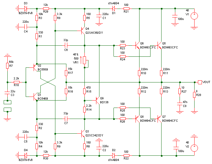

Input NPN and PNP at the wrong place (PNP should be above)
thanks Jay
this was it😀

My advise
I hope these help
Greetings Gabor

I like your amp, probably will build according to your schematic and part but with TMC.
I tried to experiment with it
added op stage like bigbt (Lazy's)
and TMC feedback type
correct me if I am wrong, THD decreased ~10dB and the spectrum is nice descending
Hello
I do not try to improve the sound and I will do everithing to keep it how sounded!
I only try to make the amplifier a bit more stable.
Not because is unstable but I want to fell I can avoid the speaker protection.
I pushed the amp to hard when I replaced the 0R47 emitter resister with 0R22 but I get a great dynamic increase and now I do not want to go back.
Actually at my last test it was my fault the amp got in to thermal runaway.
I set up the bias 250mA and after 2 hour listening I felt sleep.
About 6 hours latter I heard some noise I woke up and some parts of the amp went up into flame.
Emitter resister was red, the CRC PSU 10W resister was red, one darlington burned into charcoal, huge hole around the transistor on the PC board..
I would like to avoid these but again I do not want to compromise the sound I got..
Again the main focus to keep the sound and make it a bit more stable.
Also my heatsink was to small last time. Now I ad 3-4X as big.
About the amplifier sound 100% I agree how you describe it!
Far the best amp I ever built or heard in my system.
Thanks for your comment and if you have at hand or you find info about the amp you wrote please posted here.
Thanks one more time
Greetings Gabor
thank you
Hello
Interesting that power stage!
Can you post some sim result if you run please.
Thank you
Also please test the orig amp to, all parts a cheap, I posted the layout earlier..
I forget to warn you the two circuit I posted last time are different, they have different feedback and some other change to.
Originally I built the one where second pair power darlington drawn red.
Red because if U use only 30V PSU U really don't need to parallel them.
All do the amp very sensitive to the component quality are used I can ensure you you will be amazed even with the cheap 10C resister..
Greetings Gabor
Padamiecki, does TMC do anything here, it needs high loop gain to be effective and I dont see that here.
r
Hi Gabor ,
This connection of the 100K resistors will change nothing in respect
of iddle current stability vs supply voltage variation since the VAS collectors
are exactly at the output potential +-Vbe of the respective transistors.
That is for DC currents stability.
For AC behaviour ,the feedback from collector to base of the VAS will linearize
only this stage contrary to the original version , hence distorsions of all kind
will be likely higher.
As for moving the 33pF caps the designer was smart at least on this aspect and changing
their connection will degrade phase response.
The 100K resistors implementation as well as feeding the input stage
through 68K resistors that goes directly to +-VA are both two major
flaws of this design and it s just impossible to get DC stability by keeping
them in place as they are currently , either in the original or in this modded
version.
I benefit from this post to point a problem already noticed by Rod Elliott
in his site , that is , designs or bad habits that are to be avoided.
There s scores of non mature designs hanging in the web and regularly
they are picked by some innocent guys that just dont know the trouble
they will experiment because a designer has made a design while negligating
some parameters that may have appeared as non significant at first thought.
The consequence is huge time quantity lost by lots of people debugging again and again
what could have been easily fixed from the start.
So it goes for this amp , if you want to use it as it is then you ll have
to provide the front end with fully regulated ans stabilized rails.
Rather than going this complexe route i proposed to get rid of the 100K
wich are creating trouble while having no benefit in perfs , quite the contrary,
as well as replacing each 68K resistors by two resistors with a zener , wich will
make sure the input stage current will remain stable whatever the supply voltage.
In simulations the original version has iddle current variation of 4% per %
in respect of supply voltage variation , meaning that if the supply voltage
increase by 10% then the iddle current will increase by 40%.
In the modded version with zener the same 10% supply variation will
yield only 5% increase of the quiescent current.
I repost this stabilized version , it is likely the one that will help get rid
of most misbehaviours and , i hope , end all the time waste devoted by
builders to this schematic.
Anyway , if you have trouble understanding how currents and voltages
are defined in this schematic i ll provide further explanations if necessary.

Hello
Wahab thank you so much!
I really appreciate the job you done (explaining to me) the difference between the one you modded and the orig.
Now I see you 100% understand the situation I have here and I'm more confident.
That is one of the amplifier misbehaviour you really touch by your comment.
All do the designer advised the amplifier can be used from 30 to 50 rail voltage with out any mode that in the reality not 100% true. Need some attention when we chose the rail voltage..
Also somehow became unstable when I increase the bias, here not a simple solution to just chose bigger heatsink...Something else most be done to!
Again those who want to try the amplifier it is stable by choosing the right bias with the right size heatsink. Sound extremely good even at low bias like 100mA or so.. I write these because several guy wrote they would like to build the amp!
I'll give a try to your modded circuit instead to the latest I posted. Only difference I'll use a pair decoupling capacitors close to the power transistors like the orig may be 47uF or 100uF I'll test it!
I think that is very important (I do have experience with that and also I read these how important at "upgrading the NAIM amp site")
The designer (he told me he know the amp because he designed the circuit)or let s say the guy who drawn the circuit and give it to me when he saw I used those large Mepco (50 000 or 51 000uF pair) asked me to leave out from the orig circuit the pair 10uF caps the 10R resister and those diodes next to the resisters.
The amplifier sound become more tubby but in a bad way, bad character.
Like those 60 years old tube amplifiers..
I could not listen a complete CD like that (knowing how great was before) I made back the amp to the original version.
A bit I was afraid (now I end up again like that) but I see and understand you 100% get the problem I fight against here!!!!
Again how I stated the sound of the amplifier more than great to me.. I do not want to upgrade the sound just get red of some that behaviour I did experienced in real life.
I write these done gain because fellow DY-ers ask if you like the sound why you want to mode the amp...😕
Yes I like the sound so much I can't give up on these amplifier!
Wahab I have a question to you
With your mode using those zeners and 40V rail voltage can I stick with the BC550/560C pair?? Also I need to know the 220uF V rating. Before 16V was more than enough..
The reason those are special low noise signal transistors.
When I was looking for the orig BC414C/416C which became obsolete I did tried a lot of transistor there but nothing did the job good as the BC550C/560C.
And I was informed the 414C/416C was replaced by the BC550C/560C which has a bit higher voltage but lower Hfe.
In one word I would like to keep the BC550C/560C at the input. Knowing that those transistors are still OK I can swap them to JFet to.
With JFet I get in the mids area more neutrality, more air between the instruments.
I do the mode on the lay out and I'll test your mode!
Thanks one more time🙂
Greetings Gabor
