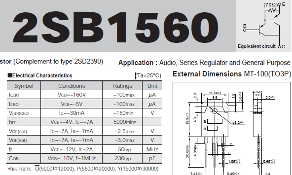

Sanken darlingtons should provide not only better distorsion
figures but also higher power supply noise rejection due to
the absence of base-emitter resistors for the drivers ,
wich are implemented in Banat s replacements with a classic
double EF , those resistors are to be removed , as well as the

Sanken darlingtons should provide not only better distorsion figures but also higher power supply noise rejection
This is the type that I have, they look very nicely made. It would be handy to have spice models for these but alas they are not to be found.

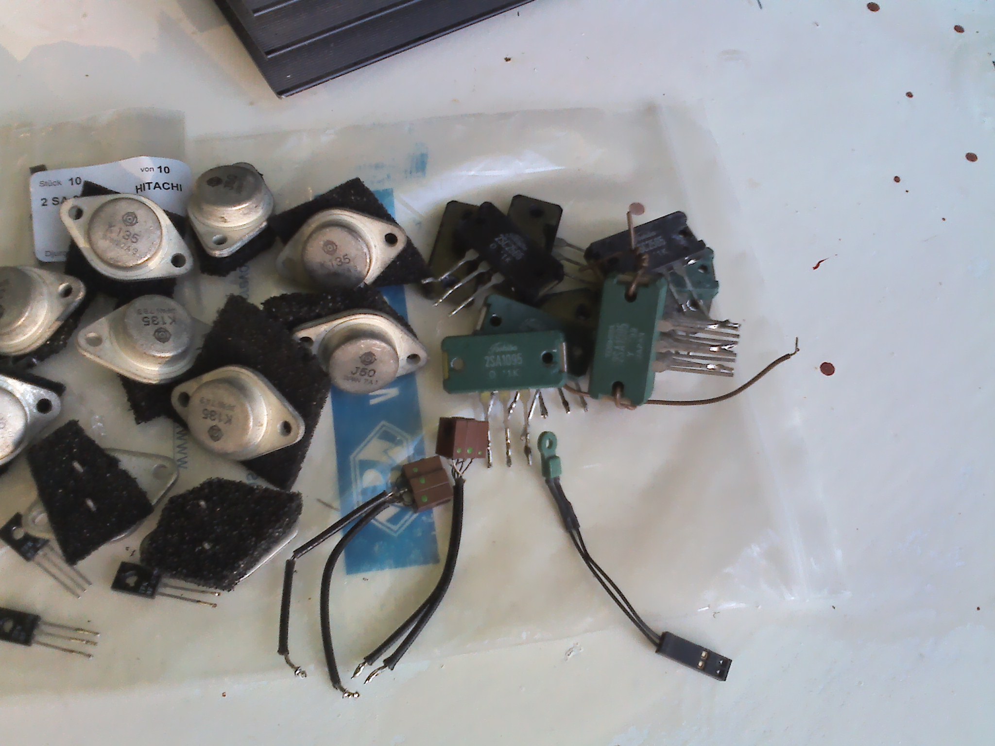

About the Exicon LatFet
I tested the Hitachi vs. Exicon in my DIY ProFet amplifier.
I do preffer the Exicon in that circuit.
But again that a Class A amplifier similar to the N Pass F5 with LatFet.
I do have no interest to promote the Exicon in any way!
I'm happy you still follow these thread, we need your help, advise here.🙂🙂

wahab do you think it would be worth to give a try to vertical mosfet like Toshiba 2SJ201/2SK1530 in these circuit?
The reason for ask I have a set for a stereo, I purchased from the forum GB to a lower power F5 project way back a few years ago, now it look like that project will not going to happen.
Because those are precision matched it cost me a lot, for that reason isn't worth to just re-sell them or keep in my box among the rest of the semiconductors.
I know it would be need to take care the different tempco, any other modification?
It would be great to find a good use for those higher power mosfet.
Another reason I have several LatFet project already.
For these circuit with LatFet I designed the PC board layout but not the PC boards yet.
I could modify the layout in case if it would be worth to give a try to those Toshiba mosfet.
Greetings G

I have some 2SK1530/2SJ201 bought for a different project. They were far more expensive than the 2SK1058/2SJ162 .
The gate source voltage required to turn them on is I think higher ( 1.6 V )than the Hitachi's ( 0.6 V ) but lower than the ( about 4 V?) of the IRF hexfet's.
Your circuit will probably clip a bit earlier than the Hitachi's. Apart from that I don't know of any other reason why you can't use it. It is physically larger than the Hitachi devices.
Vds sat is also high at about 4 V at 5 Amps. So for a certain supply voltage you will get less unclipped output than using bipolars. But this is similar to the Hitachi's.
Are the 2SK1530/2SJ201 still in production ?
Edit: OK just found that they are no longer in production !

Hi Gabor ,
Theses are excellent devices , many people in this forum
prefer them over the Hitachi s due to their higher conductance
but contrary to the laterals they have not a negative temperature
coefficient , meaning that they need a thermal compensation ,
either using an adequate VBE multiplier or more simply two
or three diodes coupled with a trimmer that is parraleled
with one of the diodes , i ll take a look with the simulator
to check a good arrangement.
On the NS application note they have slightly less distorsion
than the laterals but nothing that could make a difference ,
we re talking of 0.008% instead of 0.006%.
I d like to point that there s extremely low returns when
using expensive devices with the Profet , F5 and other low
feedback amplifiers wich mandate very high quality transistors
with careful matching to reach quality levels that are still
sub par compared to high feedback designs.
For the record , i think that this amp is better than both
F5 and Profet due to its higher feedback.

Hi Gabor ,
I m sure at 100% that thoses resistors bring absolutely nothing ,
moreover with F5/Profet whose caracteristics are only transistors
dependent , so dont waste money on devices that are hyped
and wich have far less influence than the layout.
If you want to use the toshibas you can use the VBE multiplier
of the darlington version although a resistor will have to be adapted ,
likely that the one in serial with the trimmer should be slightly reduced
to allow for a convenient current range.
Once Ashok or Bigun try the Sankens we ll have an idea
of how they perform , i ll also use thoses devices to check
this amp s eventual bugs.
