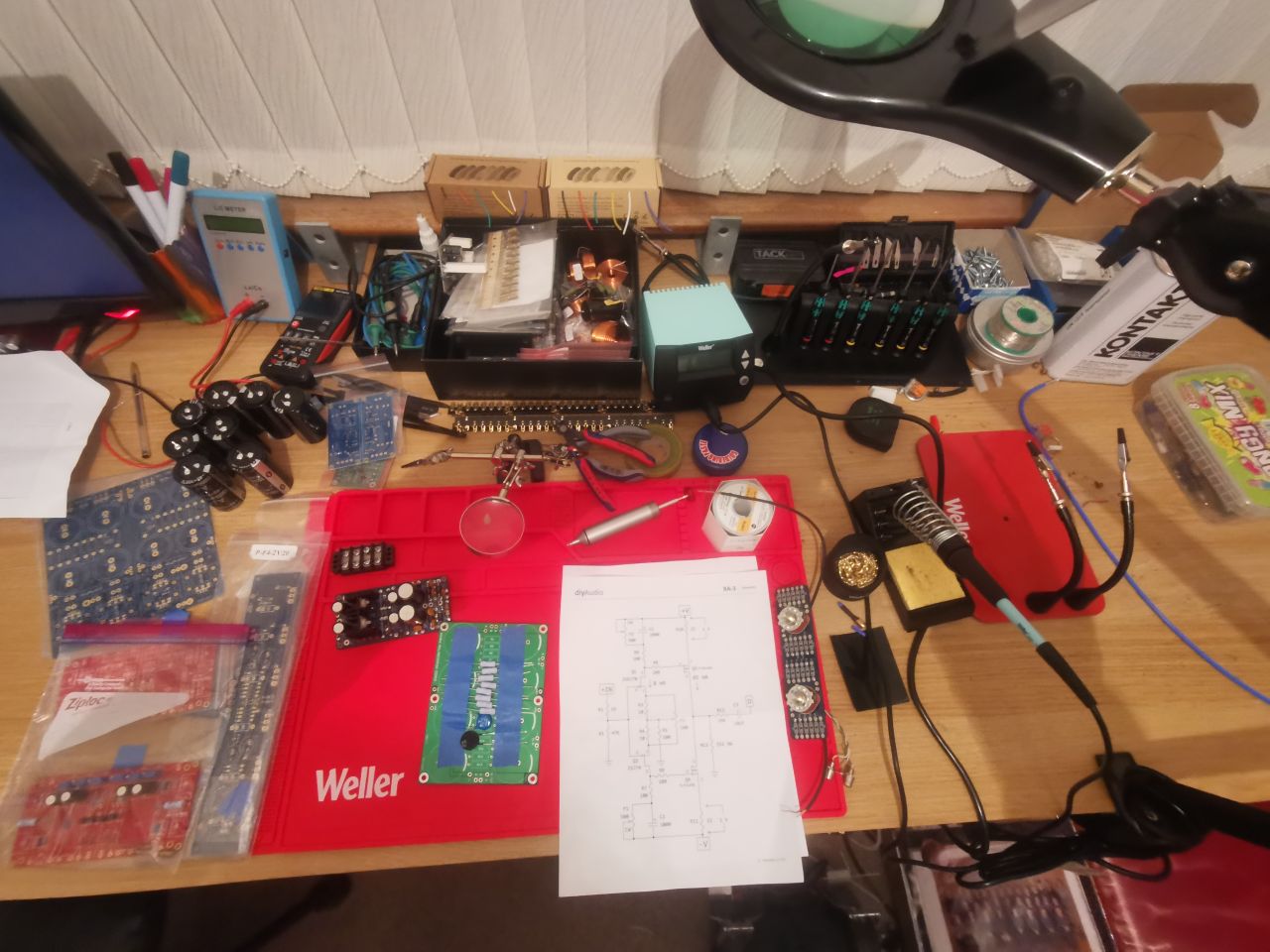

By the end of the week almost all materials should be here, ready for the build.
All that's left (I think) is the cases and transformers. I'm waiting on an email back from Tiger Toroids to see what they can offer me.
I've informed my wife that she wont be seeing me for a while

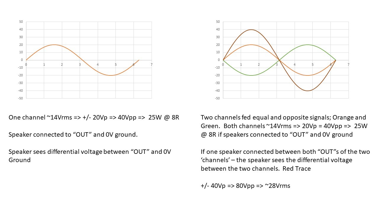

It was brought to my attention that this is not +/- 14.4V.... that is true and I'm guilty of being somewhat sloppy here.
My read on how Nelson spec's driving the F4 in balanced mode, is that one channel will be "push" and the other "pull" so the differential voltage will be 28.8V.
Also, when I write "V", I mean Vrms, just got sloppy and short handed. So I believe the true number is a differential 28.8Vrms across the inputs of the F4. That makes sense because that will yield 100/200 wpc at 8/4 ohms.
I hope I got this right this time. Thanks.

"My read on how Nelson spec's driving the F4 in balanced mode, is that one channel will be "push" and the other "pull" so the differential voltage will be 28.8V."
So, so close. I think you have it right in your mind, but just not quite correct in terminology. Here's how I think of it... and maybe even I have it incorrect. It's not because one is push and one is pull. Both channels push and pull. That's the topology of the amplifier. You're interchanging terminology. It's because you effectively have two signals. One is the "standard" signal, and the other is equal and opposite. One runs on one channel, one runs on the other. Because they are equal and opposite, when you hook the speaker to each of the channels, when one channel is outputting +20V, the other is outputting -20V for a Vp of 40V => Vpp of 80V. Graph below. Back home, so I have a computer. Sloppy, but whadda ya want over my first cup of coffee and a few mins of work. I can tidy it up if needed ... if you think it may be useful to anyone else...Back to work on your particular thing.
You can use the same calculation to show that you need ~28Vrms to get 100W into 8ohms. That's not the same as +/- 14V or even +/- 14Vrms (which would be nonsensical).
Anyway... As you've noted... double the voltage ... 4 times the power output (assuming you've got enough current). Start there. Note... This is not the differential voltage seen at the speaker terminals. It's not the +/-. It's just the Vrms. Unless you're referring to Vp, I'd stop putting in the +/-... but that's truly just my opinion. Carry on if it makes sense to you.
The differential voltage that your speaker sees for maximum excursions one way or the other is... +/-40Vp => 80Vpp. See graph. Peak differential voltage is 80V. Like I said, I think you've likely got it correct in your mind, but it's just a VERY slight differential (see what I did there) in terms. However, the terms and the notations around them are important... particularly if you want to convey what you want to a builder. Like I said... it's fun to play around with the numbers. I set all my stuff up to run with a nominal 4ohm load.... b/c I can. I don't need the voltage swing, but I tend to run more devices in parallel for ooooooomph in the bass where my speakers dip a bit lower than 4R.
Appreciate you reading my ramblings re: why I was confused by your original post, and how I think through it. Again, not saying you're incorrect, just explaining my confusion.
If you want 100W into a 6ohm load... I'll let you finish the math.
Enjoy!!!!!
Edited to add - If I were being pedantic and even more correct ... but possibly more descriptive ... in the notations in the graphs and above, I'd have said... The speaker reacts to the difference in "potential energy between the two connections, which is measured as a voltage".... You know that, but...
- As you noted, when using the 'Ohm's law power equation' all AC voltages are Vrms. It's super helpful to note this.
- Vp generally is considered "max" voltage. Some specification sheets (IMO) mistakenly will say "max voltage" and quote a Vrms or not use a suffix at all. To me, that's misleading at worst and confusing at best. Why?
- A rated power may be at a (somewhat) arbitrary THD figure particularly for pre-amps and/or the maximum voltage output to clipping might be higher than the voltage at a level of acceptable distortion. Example - Output at X% THD might be 20Vrms. Max output could be 40V. Assuming symmetrical clipping +/-40V => Max output would be 28Vrms. Nice headroom, but who knows what the distortion looks like above 20Vrms. Either way... I just wish spec sheets would be more consistent. Slightly irrelevant, but that's what can cause some confusion.
- Some people might quote max power based on Vp vs. Vrms calling it "peak power" particularly for power amplifiers. To me that is misleading
- +/- Voltages are generally noted as the max swing => +/- 20Vp => 40Vpp => 14Vrms. This is why people often say you need a pre-amp that can "swing" 20V to drive an F4.
Enjoy!!!!!

one "normal" amp is having +/-24Vdc rails (nominally, but we'll stay here)
that means - available voltage envelope for output signal is 48Vpp; call it window, call it range, whatever
we always have some voltage losses ( due to drive mechanismus ( rail to rail, less, more), due to series losses in OS devices itself) so, let's say that F4 is having some 4V losses yadayada, leaving 44Vpp
44Vpp/2=22Vp
22Vp/1.41=15V5rms
15V5rms@8R ....... as P=Urms^2/Rload, means 30W
now, if we take two "normal" amp channels and connect them in bridge fashion, these two ( now) halves are working see-saw, meaning they're working antiphase
which means - speaker is now connected between their hot outputs, GND is not involved in speaker current path, and while one amp half is going up with voltage, second halgf is hoing down with voltage, result being that zpeaker is getting doubled voltage, as sum of two voltage halves
so, if one half-amp is able to give 44Vpp, second is same but antiphase, and sum is 88Vpp
88Vpp - 44Vp - 31Vrms
31Vrms@8R - 120W
in praxis , we have less than 30W, and less than 120W, reason being that rails are just nominally 24Vdc; 18Vac secondaries, CRC filtering........ rails are in vivo 22V5dc, under heavy modulation slightly going down
so, 25W@8R, 100W@8R
what's not to like?
