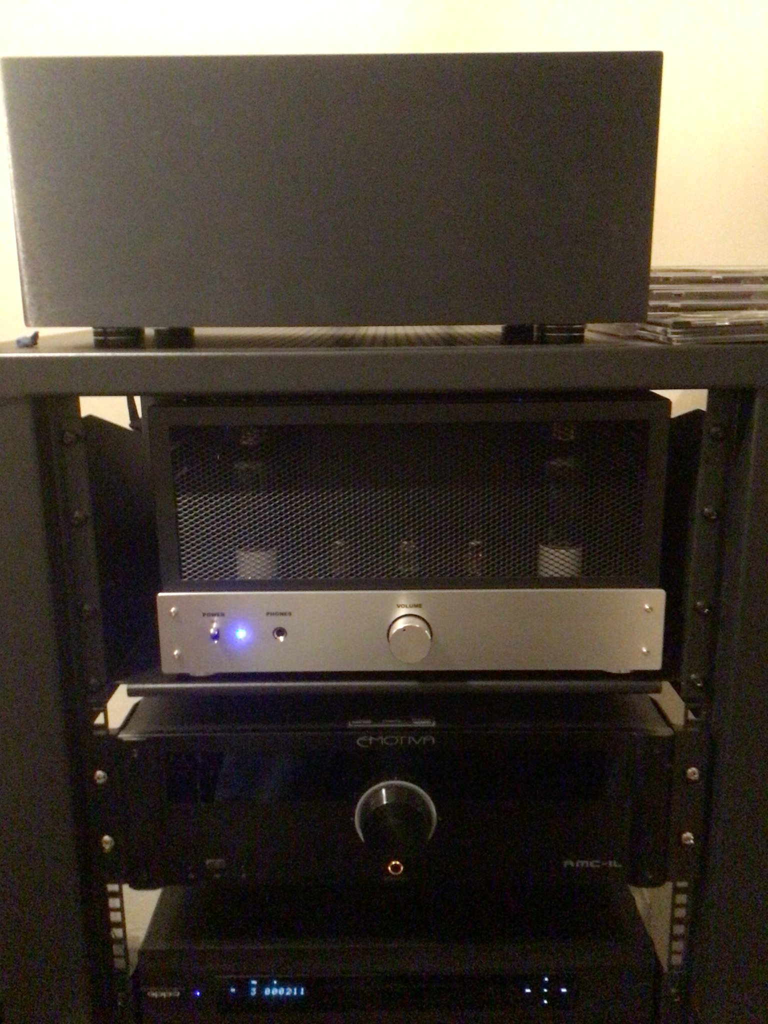

For anyone who has built either the F4 or the Elekit TU-8600S 300B integrated amp I want to report amazing results using the 300B amp to drive the F4. Imagine the delicacy of the treble and mid-range of the 300B combined with true low end grunt that the F4's current supplies. I've tried all kinds of preamps with the F4, but none of them sound like this or drive the F4 to full output (except possibly The WHAMMY!).
Nelson's white paper on the F4 said that you could drive the power buffer with a flea watt amp. Well, here you go. I strapped Mills 15 ohm 12 watt non-inductive resistors across the left and right speaker terminals, and set the Elekits taps to 8-16 ohms. I made interconnects with banana plugs on one end and RCA jacks on the other. Then you just feed the signal from the 300B amp into the inputs of the F4. Holy cow!
The chain in this system is Oppo BD-95 feeding its digital output into a Denafrips Aries II DAC. The DAC is connected to the input the Elekit TU-8600S and the 8600-S to the F4. Speakers are Arendal 1723 Towers. I haven't tried it with vinyl yet. Unfortunately the Elekit only has one pair of inputs which means some cable swapping is required to get my tubes4hifi phono pre connected.
Has anyone else tried this?

It’s perfectly legitimate in all honesty. And you probably have a good amount of voltage swing from the TU-8600S (I think it puts out 9 watts RMS/8 ohms so about 8.48V RMS into 8 ohms.) With the much higher input impedance of the F4, your peak to peak voltage will go up.Has anyone else tried this?
You now have a tube hybrid amp, pretty much the best of both worlds if the sonic splendor suits your fancy. I’ve heard similar setups, very pleasing.
So carry on and enjoy! Arendal 1723, towers! Excellently designed speakers with constant directivity paradigm in mind .
