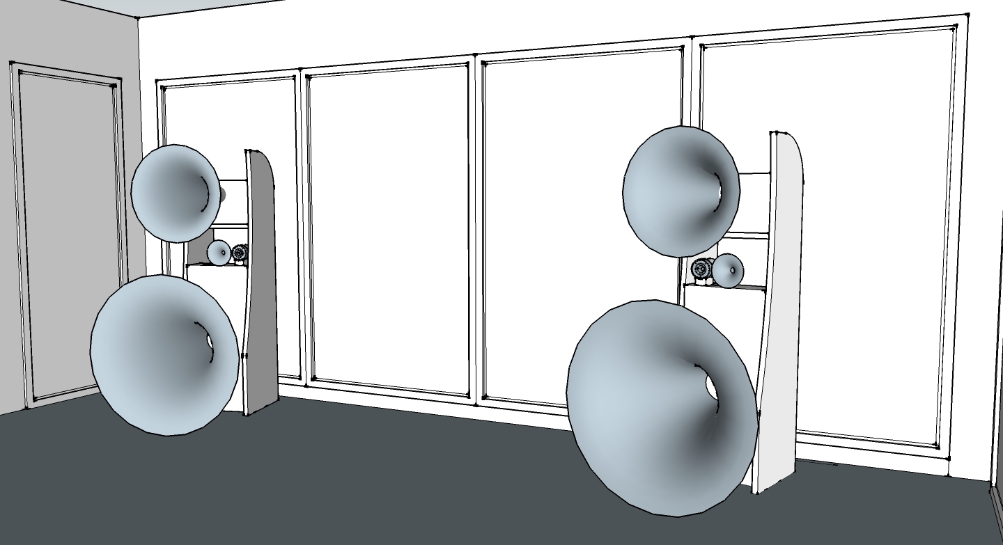

Here it is, What do you think?

Thanks for the offer. However, I plan on a 100-650hz horn with two 12" drivers in each horn
Yes, I think so too. That is why I have arranged mine from 2.4khz to 45khz at ear height. I put the tweeters near the JMLC 1000 as they play over 9.6khz, it won't have a problem being off centre. Keeping the mid-bass 10-15cm lower is more important for me. This whole thing is around 180cm for 4 channels.
Looks very good and sensibly laid out!
It all comes down to the frequency ranges of each driver 🙂
Yes, I am going for
100hz - 600hz with the uppebass horn using supravox 285-2000 with 2:1 throat compression and small back chamber
600hz - 2400hz with 2" throat, 200hz tractrix with Radian 850pb
2400hz - 9600hz with 1" throat, 600hz tractrix with Radian 850be-pb
9600hz - 45000hz with Fostex t500amkII
I have a tapped horn that I have built and it is very good for 20hz to 80hz, however I don't want to push it up to 100hz and prefer to keep it even lower (60hz or so). So I was interested in your bass solutions. If I could find something that would blend nicely and can play from 30 to 120hz, it would be really good.

A tapped horn is also very powerfull, but as you say, not very good above about 80hz depending on size etc. OB's are more able to play upper bass, but the SLOBs also have some issues above 200, again depending on size/drivers etc.
