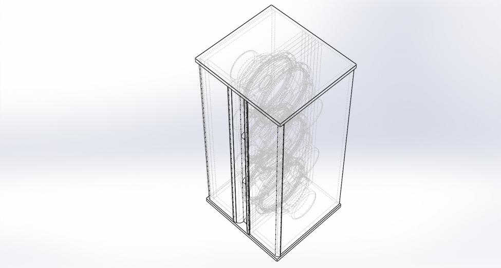

As you can see in the previous picture, there is some room above the OBs in this position. I had ordered the woofers I needed for a solution with 6 drivers in each SLOB, but a fellow audio nerd commented on the extra height. I went back to the drawing board and made a sketch of the room and a higher SLOB to verify that I could actually make it work. And it fit!
The production drawings were sent to the cabinet maker and other vendors, and the wait had begun.

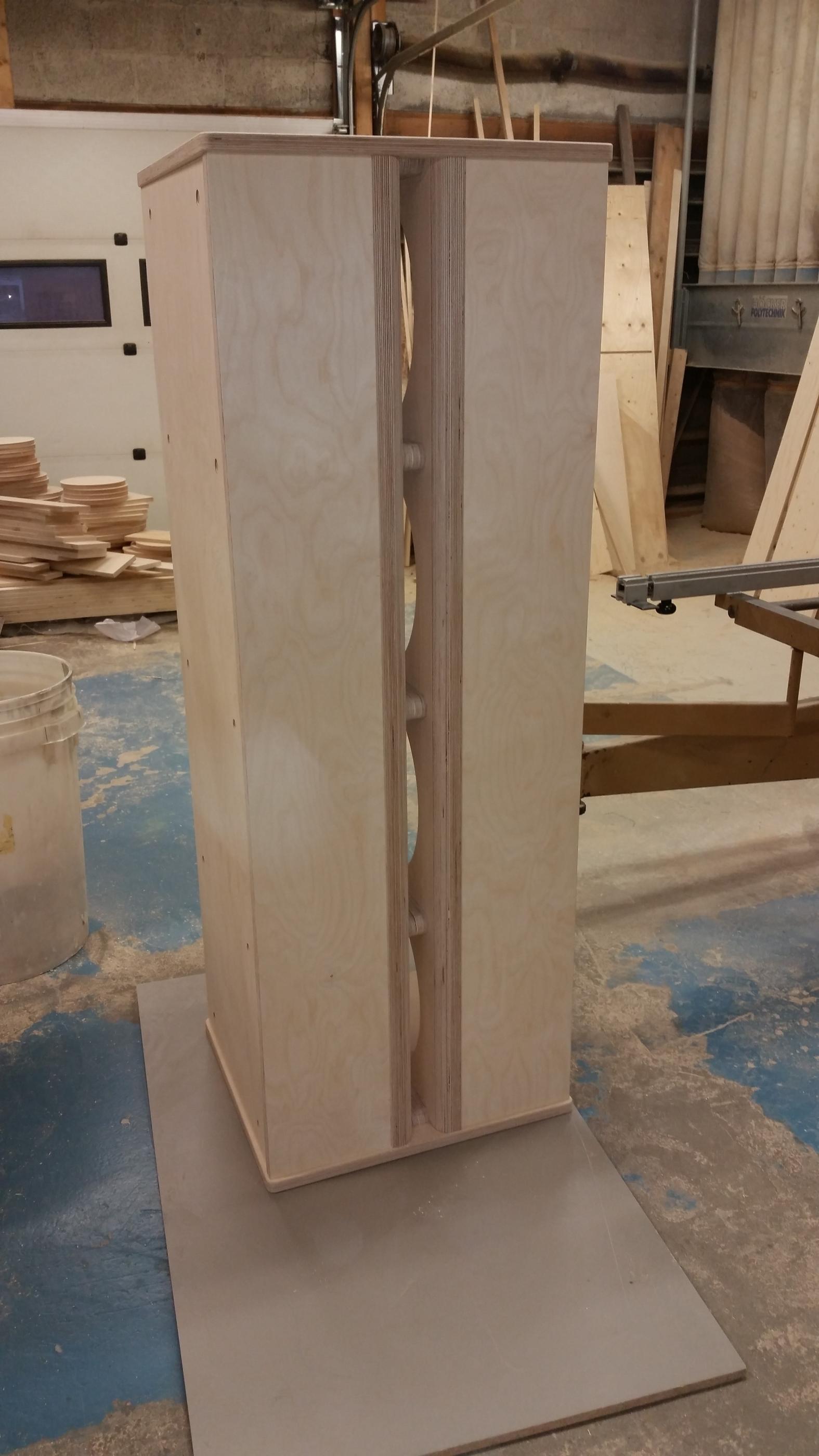

After a while, just before christmas, I recieved this picture via e-mail.

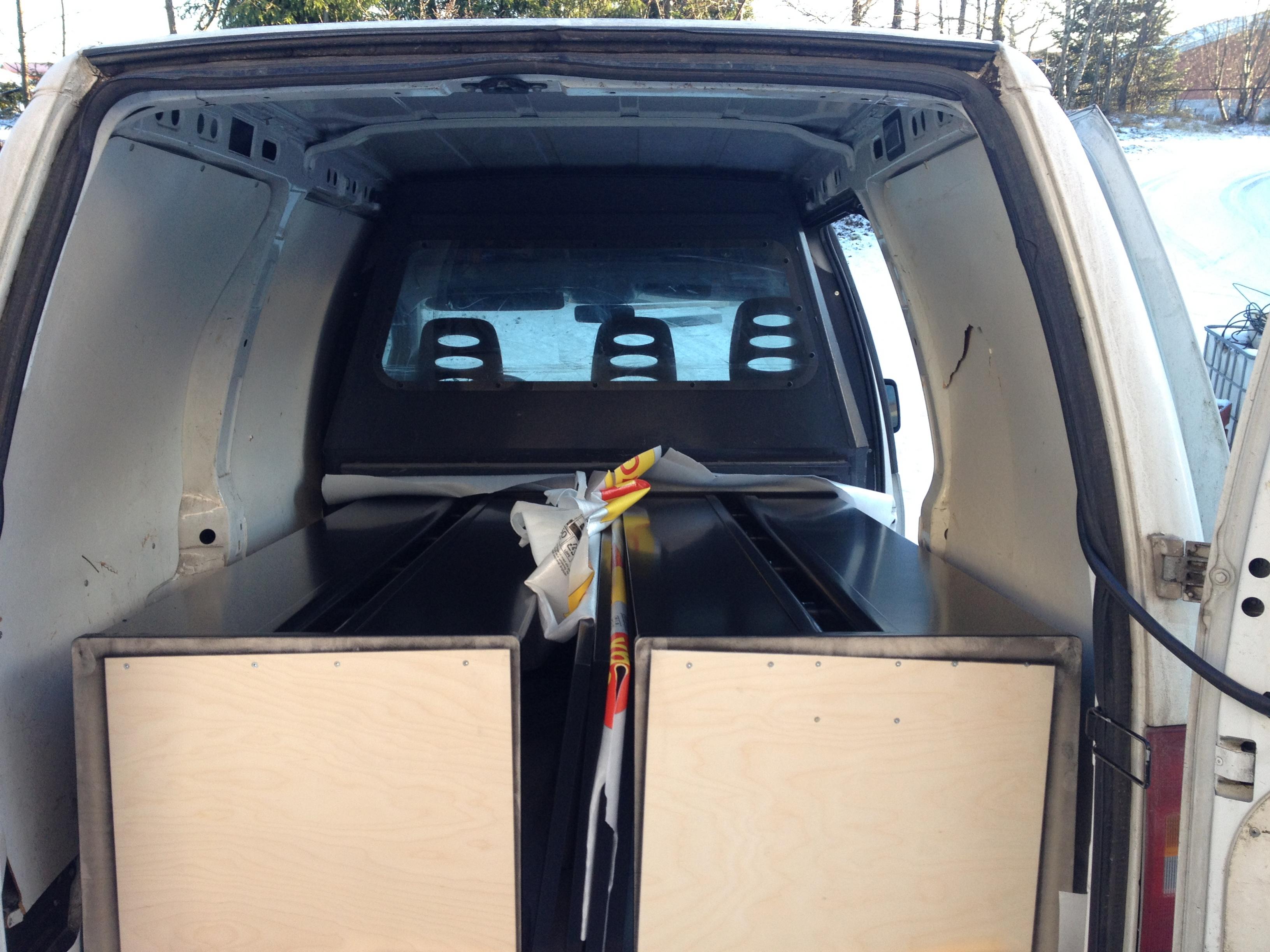

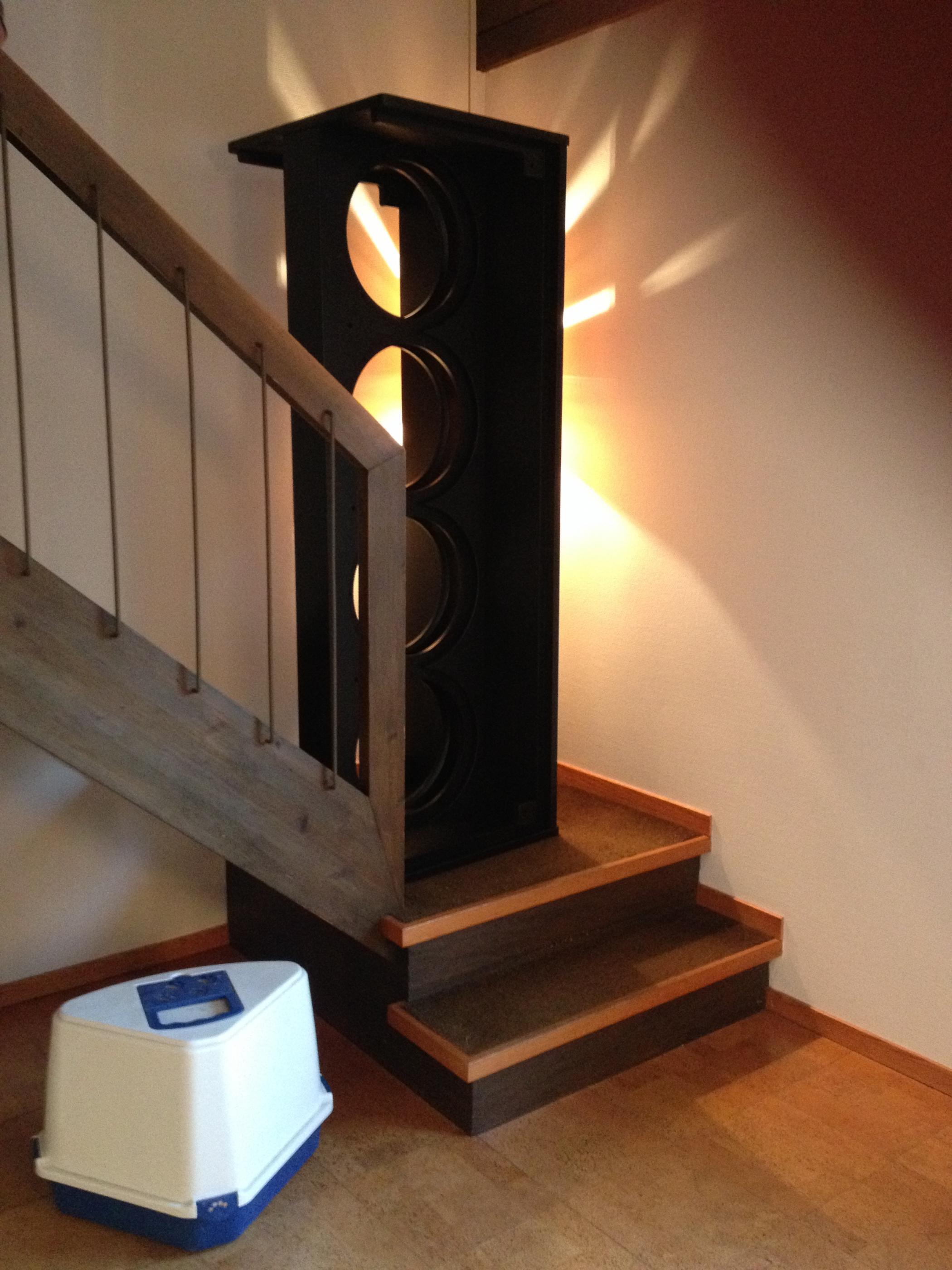

A few days after, I got the message that the paint had dried up and they were ready to be picked up.
I borrowed my fathers car and went off. They barely fit!
