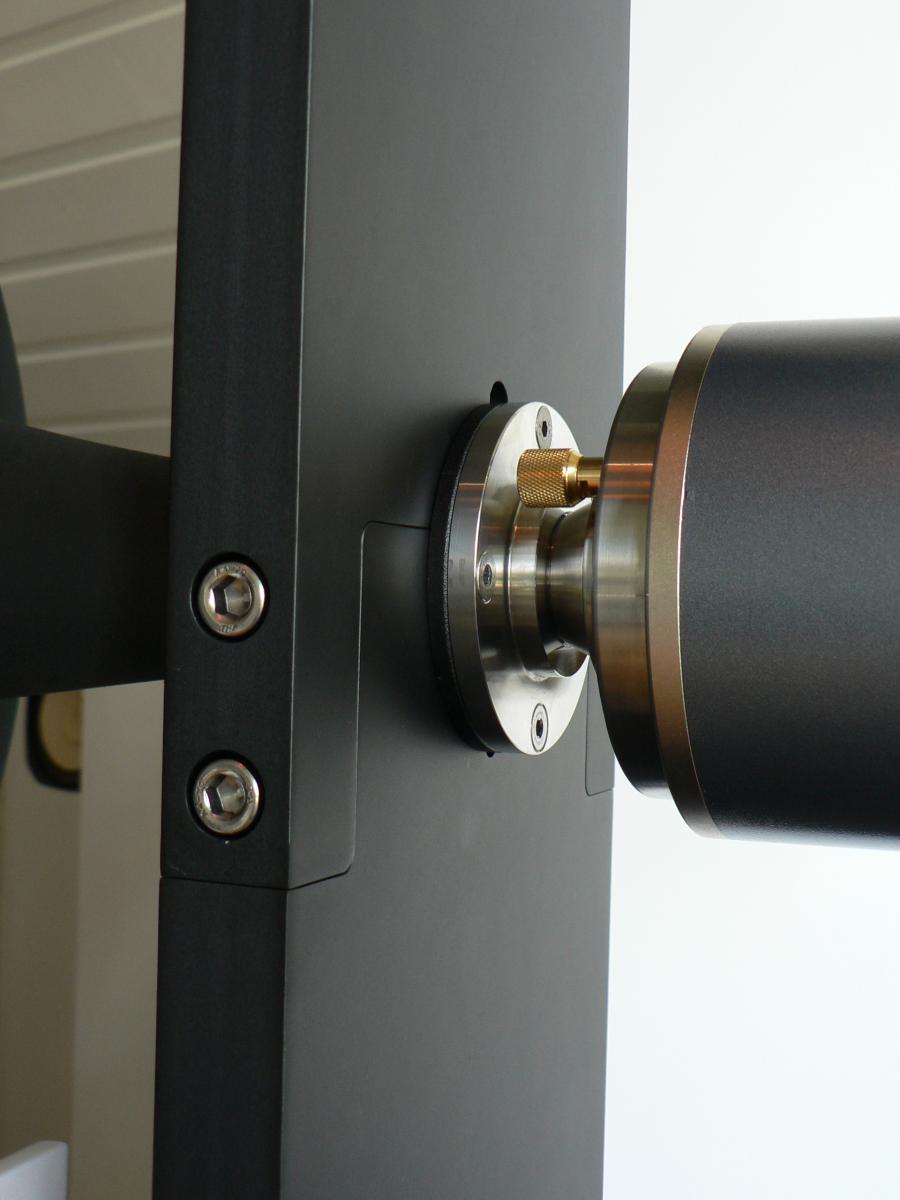

Have you considered using dense birch plywood of the same thickness instead of Alu? I mean there is not that much stress on the structure and the $$ savings would be considerable. Plus the warmth of wood...
It would be more expensive to do them over in any material😉 seriously though, I did not pay much for the job and aluminum looks way better than plywood. I did not go for aluminum because of the strength, at least not for now. Should I go for a larger ALE driver the case might be different😉
About 2% of the project budget was spent on the stands for mid and tweeter. Not wasting money, IMO.

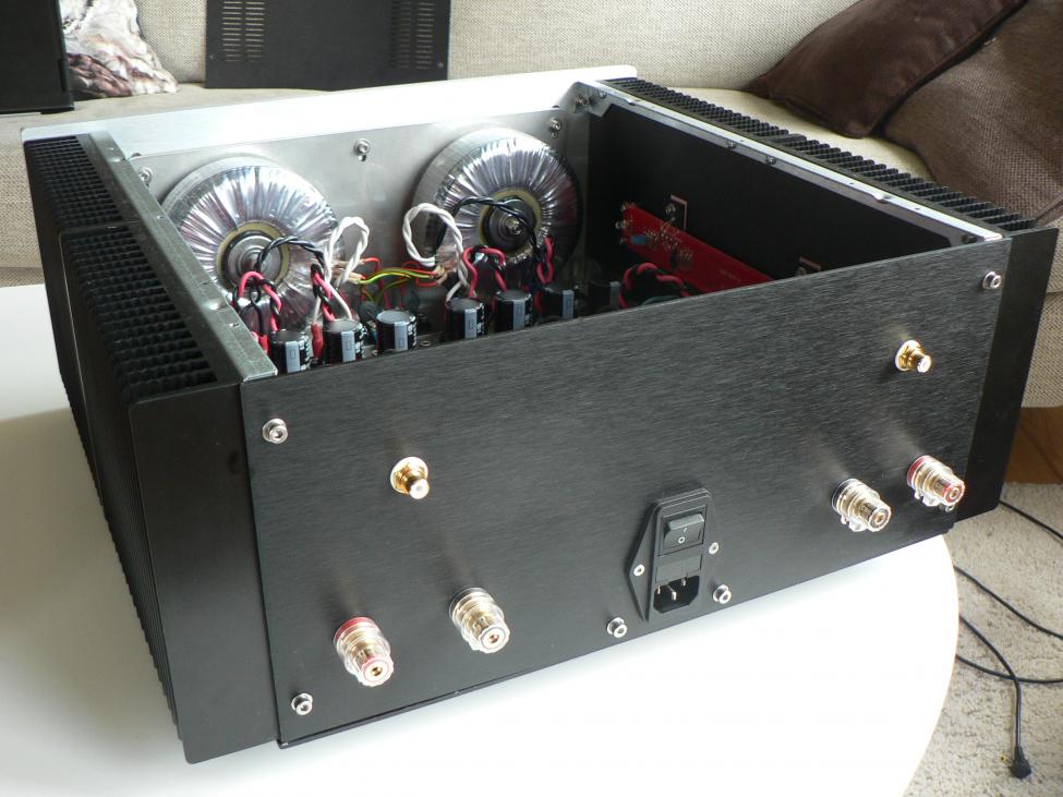

About the same time I got both First Watt F5s up and running. I got brackets for the transformers, PSU boards and chokes custom built. Dual mono CLC. Very happy with them.
Here are some details:
Back to the speakers, more details of the build.
Here's the threaded adapter I made for the ALE 4550 to fit the regular flange of the JLMC350. Stainless steel, of course.
