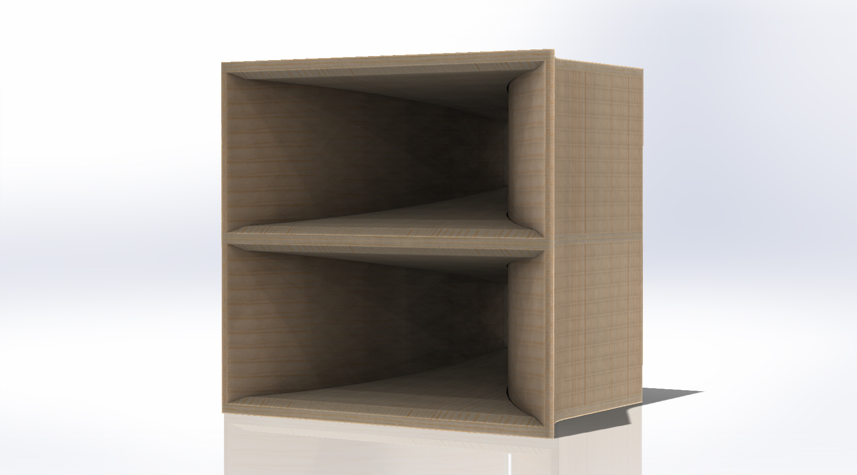

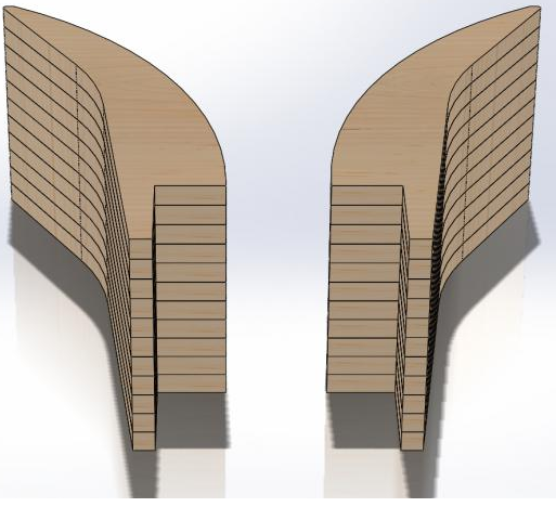

This will replace the j-horn I guess. I am waiting to hear about the differences. These will have the altecs in them?
My project is going good too. I decided on sealed bass arrays with 4x12" ScanSpeak 30w/4558t00 each from 38hz up to 160hz, then cross to cf110 round tractrix. I am planning on powering them up with four hypex nc400 modules with two smps1200a400.
So the tapped horn I had will be covering from 20hz to 38hz and wont be operating in regions that it lacked good performance.
Yes, replacement for the J-horn. They will not have altecs, these are made for 12" drivers, and I need something more "tight" then altecs for powering a horn with higher compression. Been looking at some neodymium drivers from Precision Devices.
Those 12" will need to be very efficient as well. You can check what I am using for the similar frequency range. The supravox 285-2000. It is around 11". Model it and see if it works for you. This driver sounds really good (at least thats what I think)
