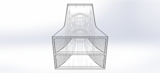

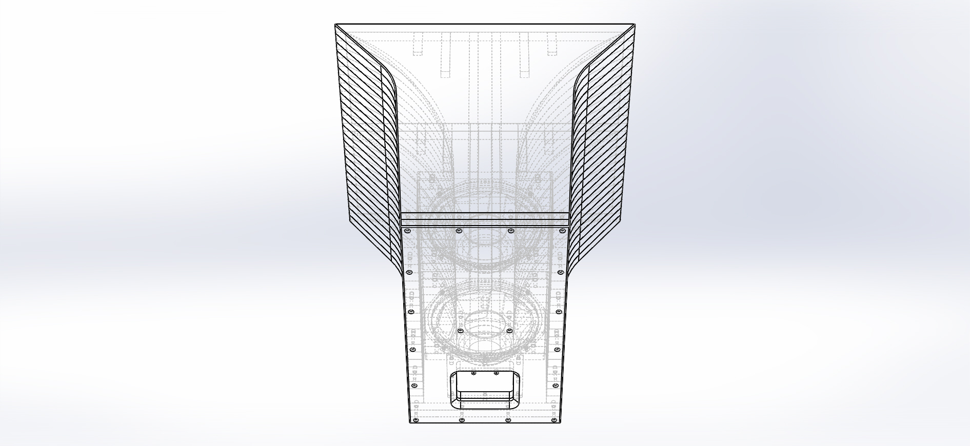

Could you describe the midbass horn so I can simulate it in Hornresp? I know what driver you use and that there are two of them. Do you remember your throat surface (S1), mouth surface, and horn profile you are using?
BTW, why two 12" in a horn? Isn't one driver enough?
Throat = 240cm2
Mouth = 2498cm2
Conical vertically
Horisontally a smooth radi from throat to mouth.
Two horns stacked together gives a very nice effect of going even lower and having a smoother response.

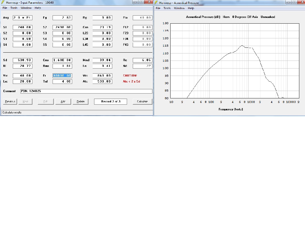

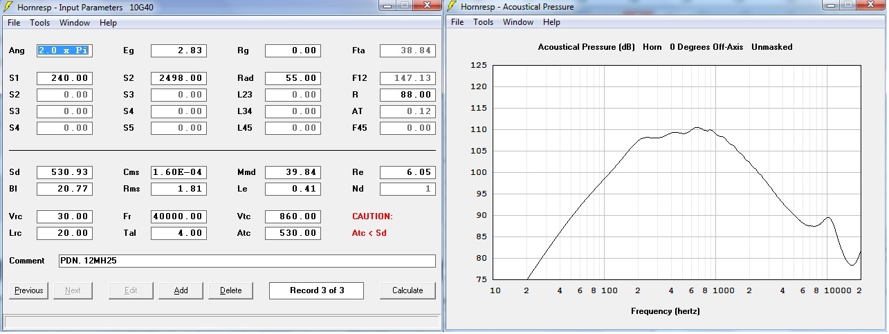

Not sure what a smooth horizontal radi means. I took a shot at modelling it on Hornresp as a conical horn. Is it representative of your horn?
Not even close...I found a very early simulation we did from my first sketches of the horns.
Fortunately!! What I posted didn't look good at all.

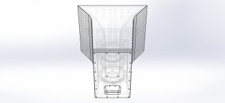

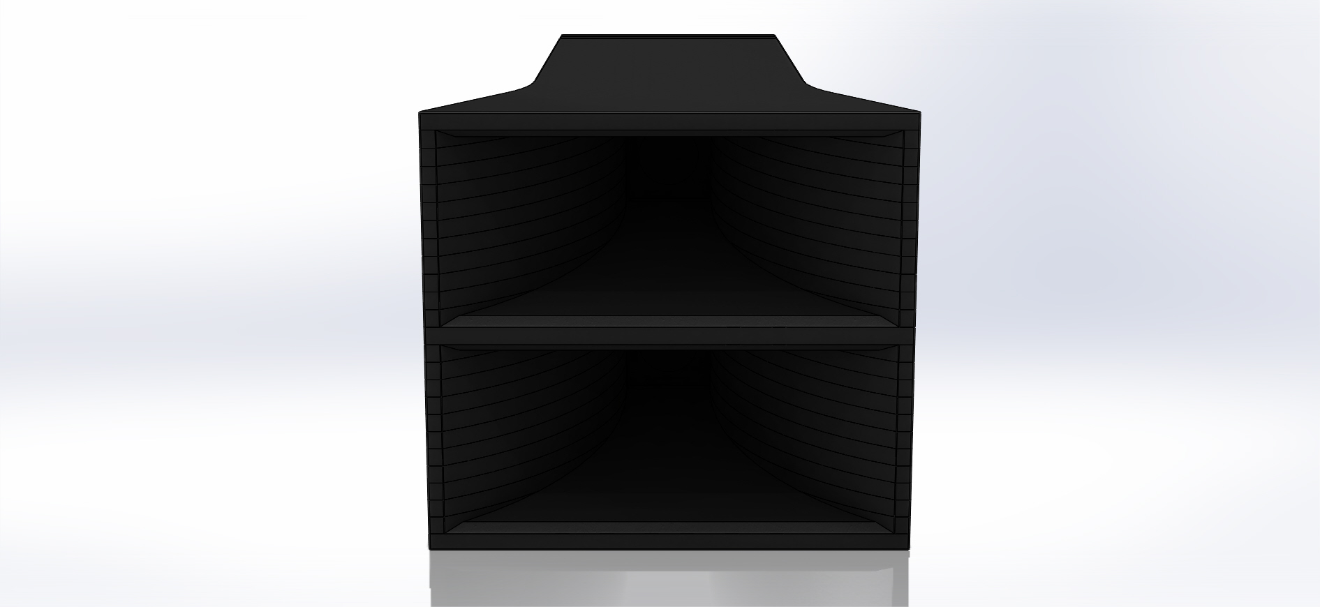

How do you model your horns?
How long is your mid bass horn?
I have Beyma 10G40, that I purchased with the idea of using two per side in sealed enclosures.
I model them using SolidWorks 3D-cad, see attachments.
The horn itself is approx 550mm deep.
For midbass horns you are typically looking for Low Xmax, Qts and Le.
I'm not sure if your woofers are very good for this use, but they should be based on a specifically designed horn. I not believe downscaling my horns would be a great idea.

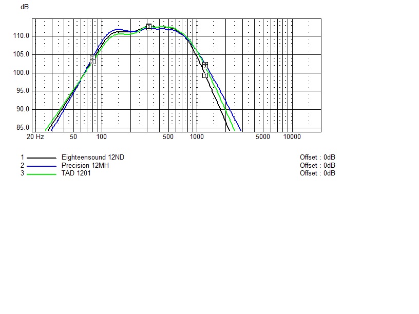

I meant what you use to simulate the behavior of the drivers in the horn. What did you use to get the graph you posted on #153?
Downscaling your horns is not really what I'm after. I am more interested in understanding their key parameters. If you were using Hornresp, for example, an image of the input section would suffice.
I've taken a second shot at simulating on Hornresp (only 1 driver). It's closer to #153, but fc is 147Hz. You mentioned you intended to use the horns from 80Hz. What's the fc you are working with?
I thought he used Hornresp, but now I'm not really sure looking at the graph.
However, I do not have these simulations.
The simulated acoustic response is down to 80hz. Inroom response might be a bit different both ways, so we will see. Luckily I have a bass solution that is quite adaptive in that regard, and I can experience with what XO gives the most natural and snappy midbass respons from my listening position via the DSP. Happy days ahead!

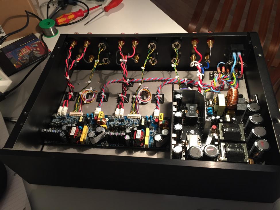

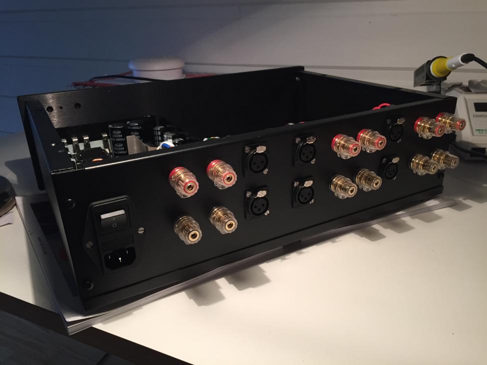

Hi guys.
Just recently built a multichannel amp for a guy that bought my previous horn system. Here are some pics:
Not the smoothest cabling or layout in the world, but with a design criteria revolving around separating 230VAC, signal in and out as much as possible this is the result. And successful, no audible noise from the horns even with the volume control totaly open.
The two smaller modules are Anaview AMS0100 and the big one is AMS1000.
