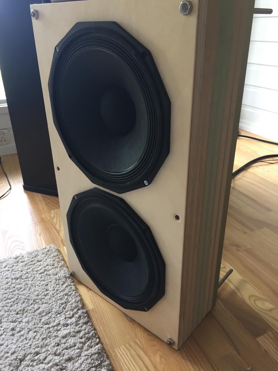

After other projects have been finished I felt the need for a better temporary setup.
Step one:
Step one:
Step two:
Had some leftover parts from a test I did with 12" woofers in a closed box for midbass purposes earlier. Rebuilt into open baffles with a bit of a U-shape.
Would you be able to describe the subjective sound differences between the open baffle array, the SLOBs and a monopole configuration? Do you feel you ever miss the feeling of room loading that you get with a monopole? And have you considered going with tapped subwoofers?
Near as I can figure, PMA's room is quite a bit MORE sensitive to bass than a typical room.
I say "near as I can figure" because in most cases, open baffle bass simply can not compete with the ease and power of a monopole type woofer system.
PMA also speaks about "first note bass", or some such thing that I probably have not remembered correctly, but that is the kind of "half-note" sound I hear from any and all open baffle bass attempts that I have auditioned. To me, they are just not right; not even close, but oddly enough, that's the very same kind of sound that so many of the open baffle crowd seems to love. So, as usual, different strokes for different folks. At the end of the day, it's each system's owner who either enjoys his own sound, or does not. No one else's opinion matters at all.
