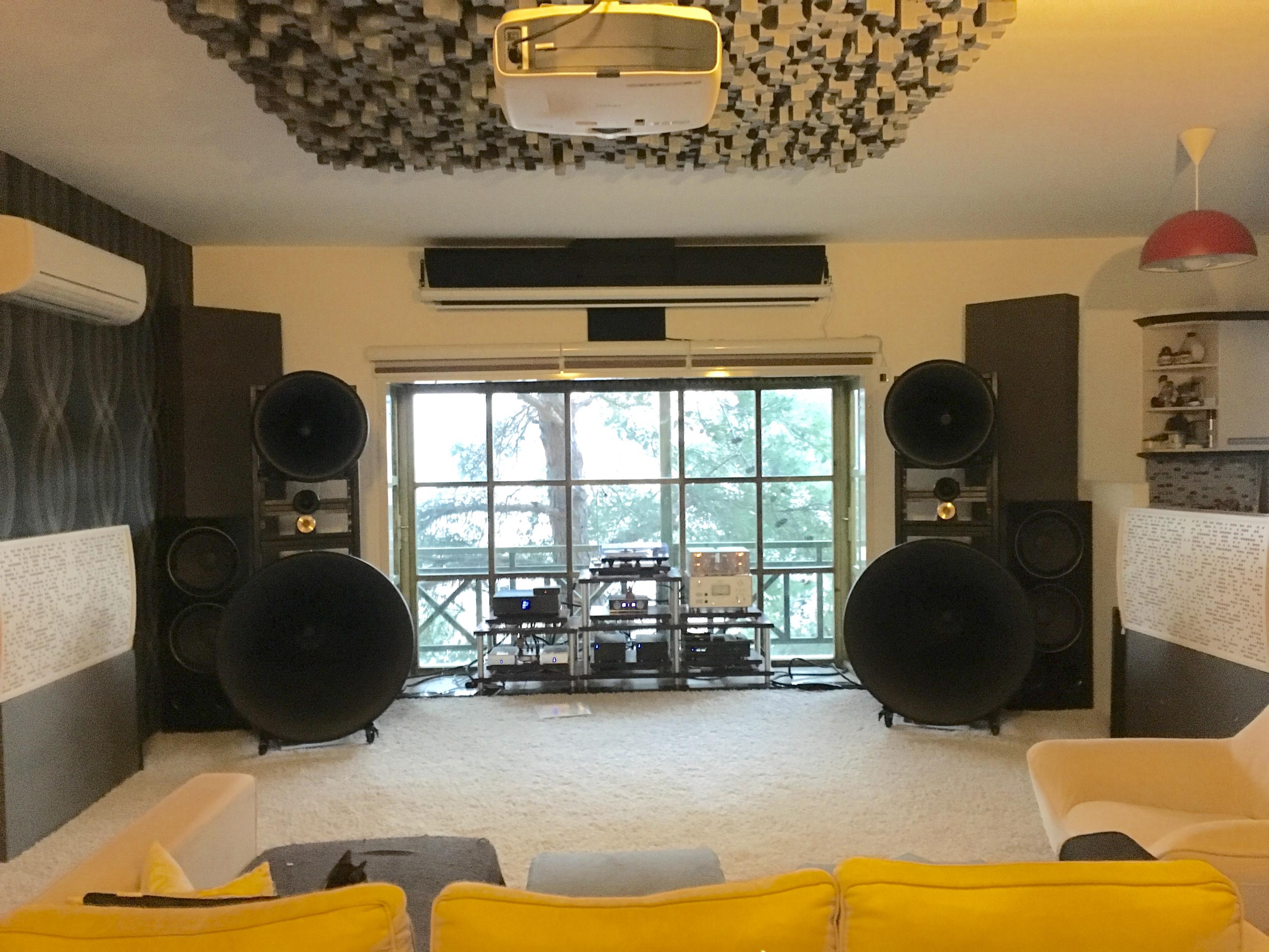

My setup is as follows from top to bottom:
Fostex t500amkII
cf 1400hz round JMLC with Radian 475be
cf 200hz round Tractrix with Radian 850
cf 110hz round tractrix with modified Supravox 285-2000 with reactance annuling back chamber
Dual Tad 1601b bass reflex 200L boxes
20hz volvotreter tapped horn with Eminence 4015lf

Forgive me, but that seems overly complicated. In my experience, anything greater than a 4 way and you are really into diminishing/or/ negative returns.
The TAD 1601 drivers are quite impressive, though !!
I do not want to hijack his thread, so pm me if you want to talk about my project...
When I designed theses speakers I also designed the space they will be in. I have not built that space yet, still they sound terrific! I had the chance to have own very nice systems and also had the pleasure of listening to many high end and also good diy systems. I rank mine amongst the best ones I heard. It is great and relieving after all the work me and people who helped me has put into it 🙂 The final help and the most important help came from hornfabrik in Germany. Their crossover solution elevated the speakers up a few notches.
These speakers may have been complicated to build, but properly positioned in room and on the right listening spot, they disappear completely. Everything plays with ease too. The first speakers I am satisfied on classical music... If people are only into jazz trios or female vocalists or audiophile recordings this would be a total overkill! or for people who are married 😛
Well, Sir, that is quite impressive, and it does look like it lives up to your observations. So, like I said before: Please forgive me. I am in a similar situation, in that it has taken me quite a few years to get where I am at, and also in a devoted room, but yours ranks considerably higher when it comes to aesthetics. This thread is called "My DIY Horn setup" so perhaps not very far off topic !

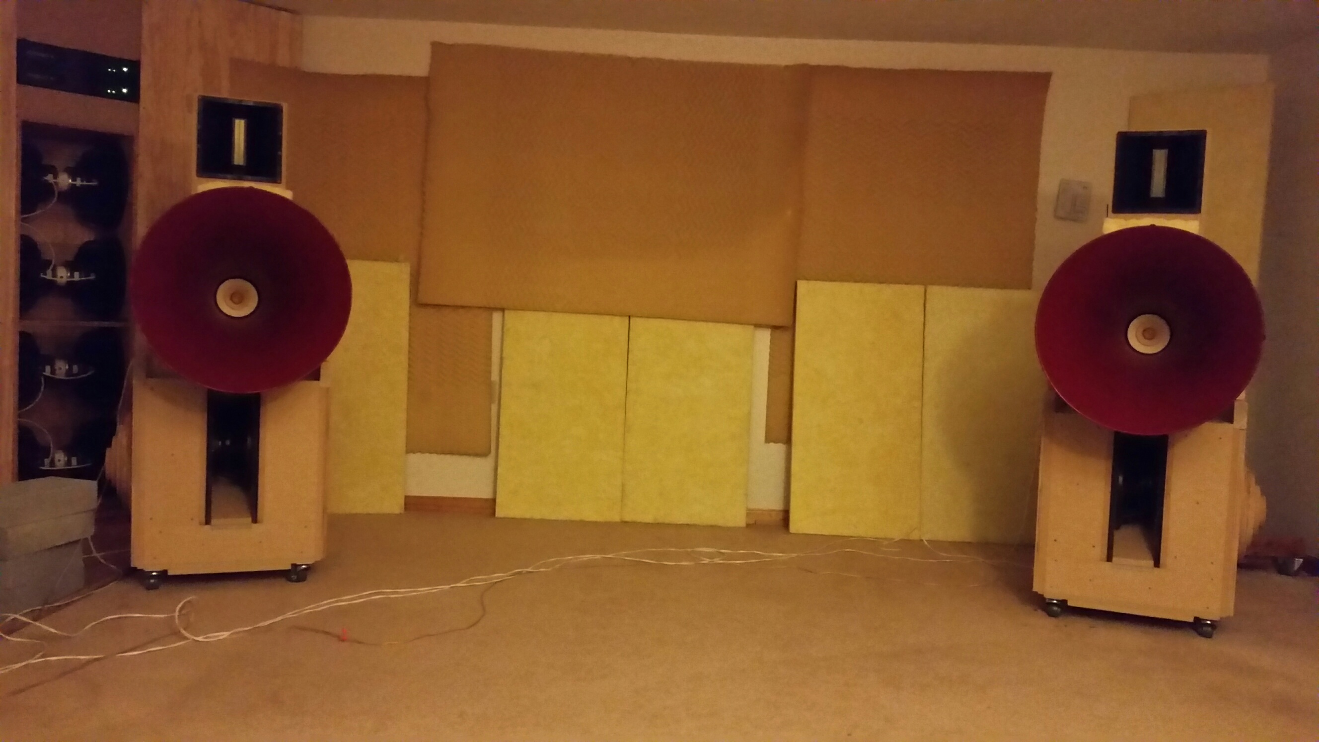

I have not sold the SLOBS. In my existing room I can't think of anything better. I am helping a friend design and produce an extreme basshorn solution for his stereo. 140dB @ 15Hz at Xmax! In the future room I have just started planning (a year or two+ in the future) they will be considered as a trade-in for the SLOBS. I will not trade SLOBS until I have measured, tuned and heard a bass solution that surpasses them in overall sound quality...luckily I will have first-hand experience with them when the time comes. They are HUGE, haha.
Thanks for sharing pictures, setups look very cool!
