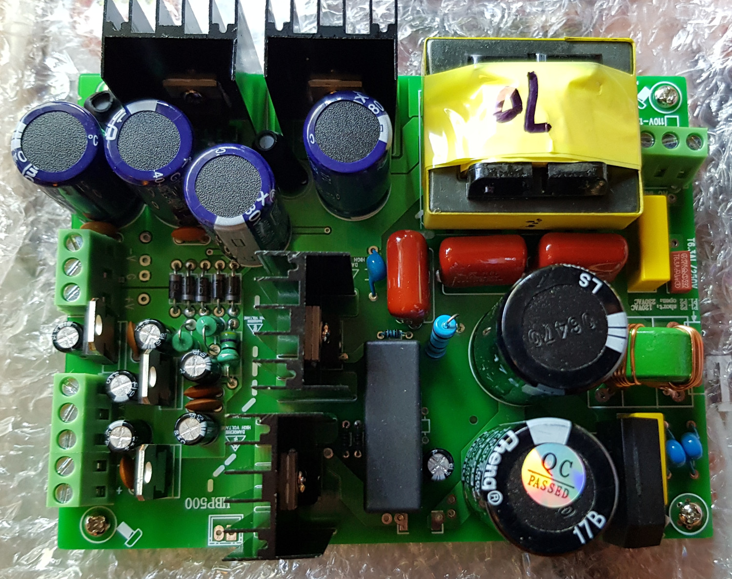

A question as I am, at least mentally, getting ready to test the L20D modules. At first with a +/-72Vdc SMPS(I'll see if I can lower the output of the SMPS with a few volts using the pot next to the terminals).

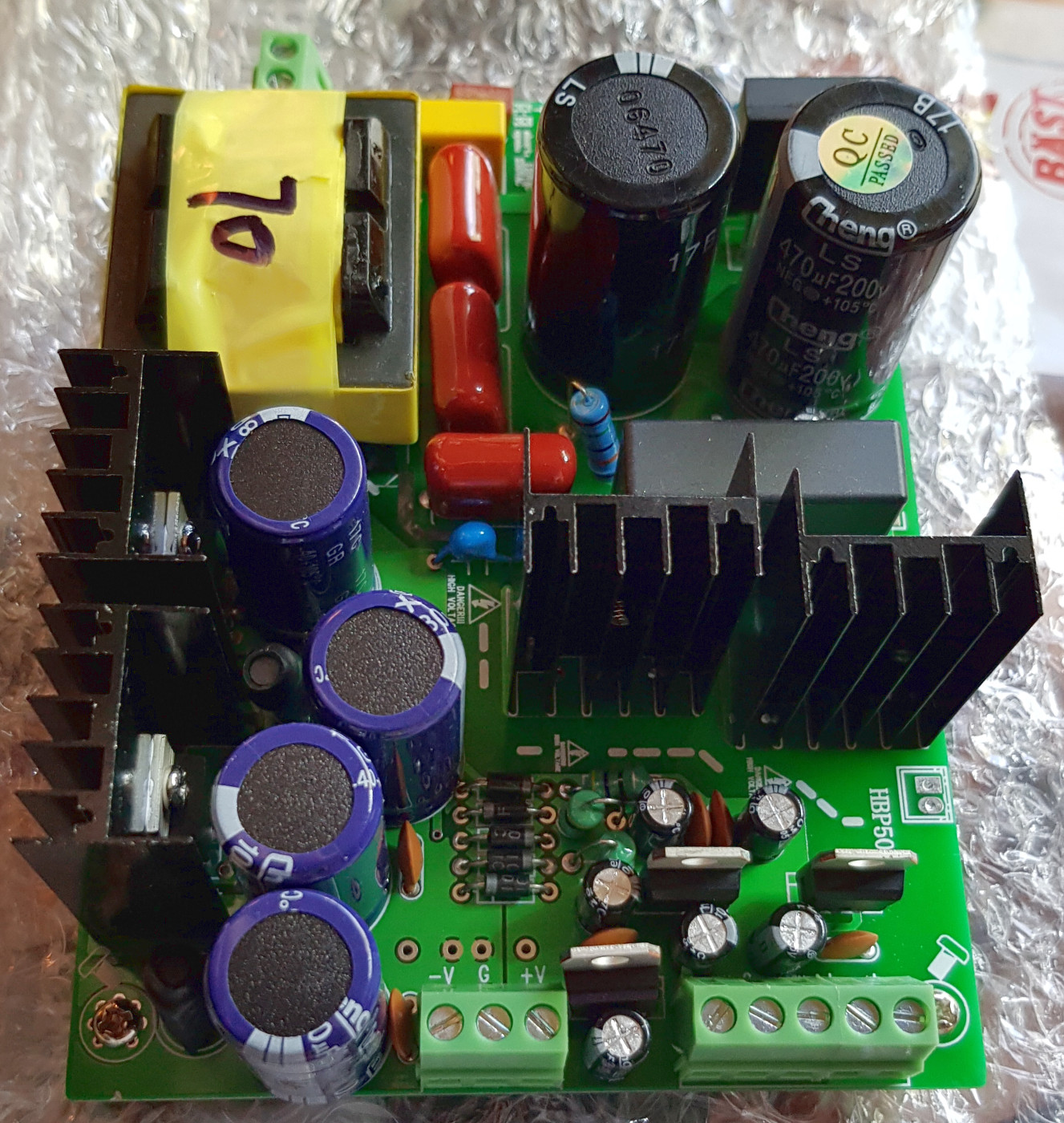

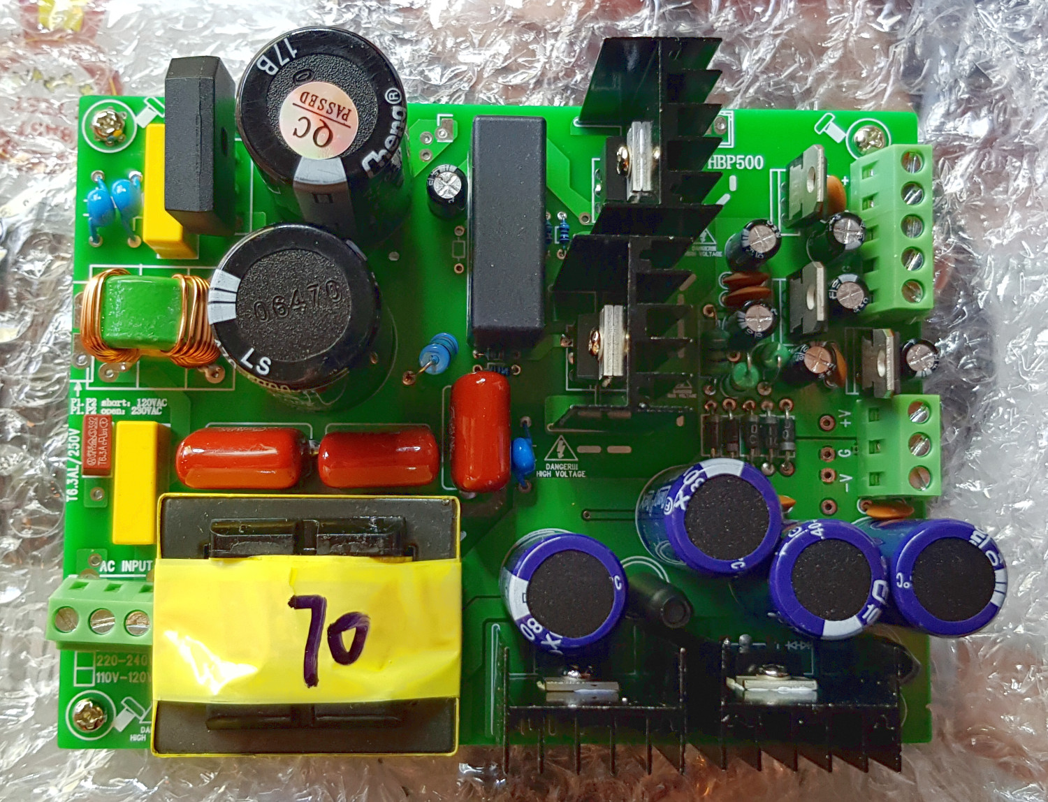

This is the information I have on it(and a few pics)
Switch Mode Power Supply (500VA) +/-70Vdc, +/-15Vdc 1A, +12Vdc 0.5A
Transformers: 0.1mm*100 Multistrand OCC enameled wire.
Efficiency: 90%
Dimensions: 100*133*50mm

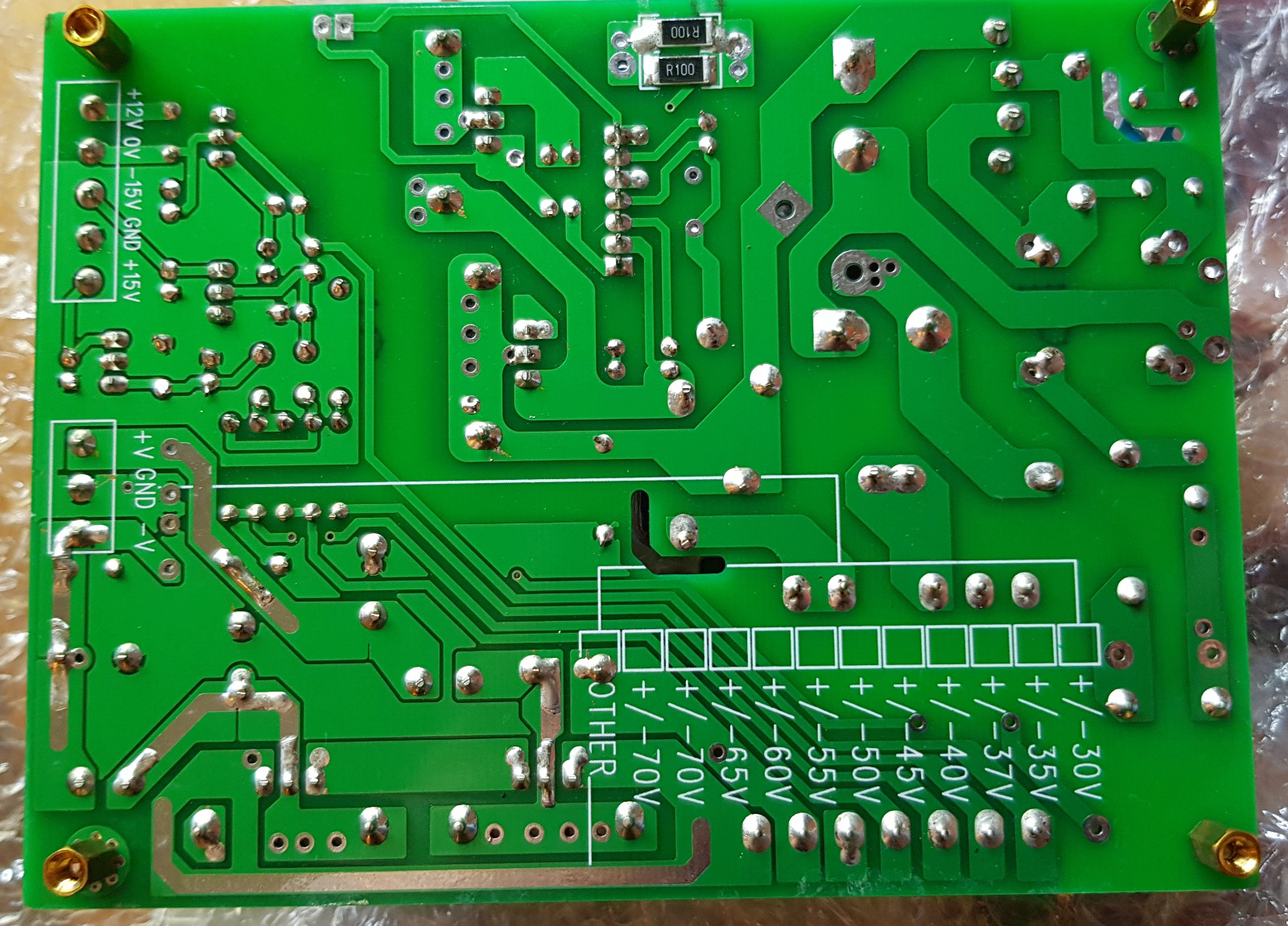

SMPS Supply is out, atleast for the L20D
It's labeled +/-70Vdc, but powered up my DMM climbed to +/-74Vdc before I decided I didn't need to measure how far it would climb(this was in 10-15 seconds at the most) as it was already over the +/-72Vdc I read is the roof for the L20D modules. The switch mode supply was not loaded by anything while I measured this.
