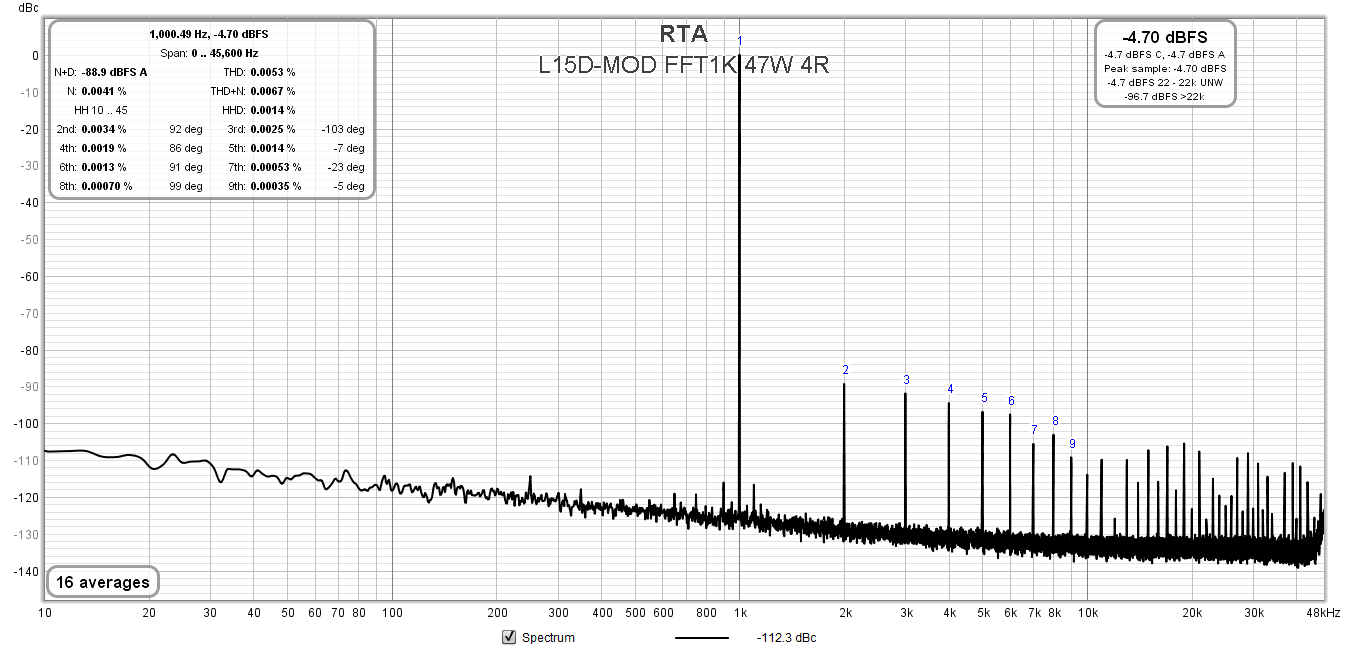

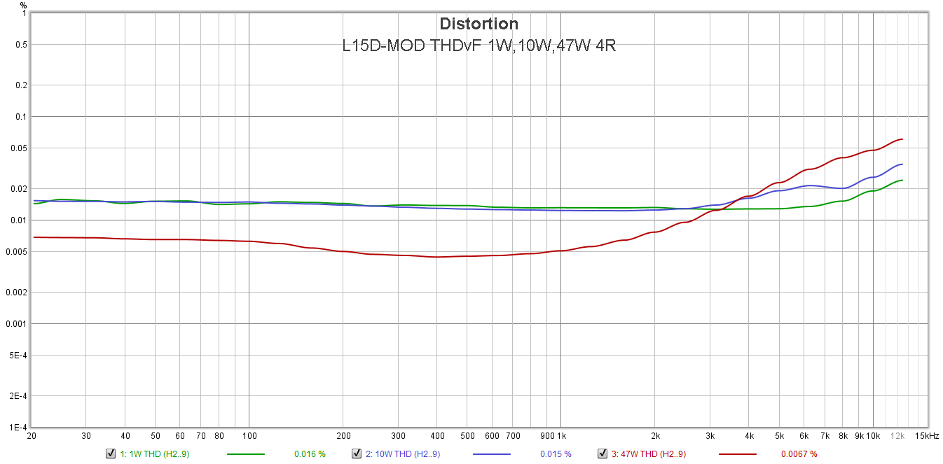

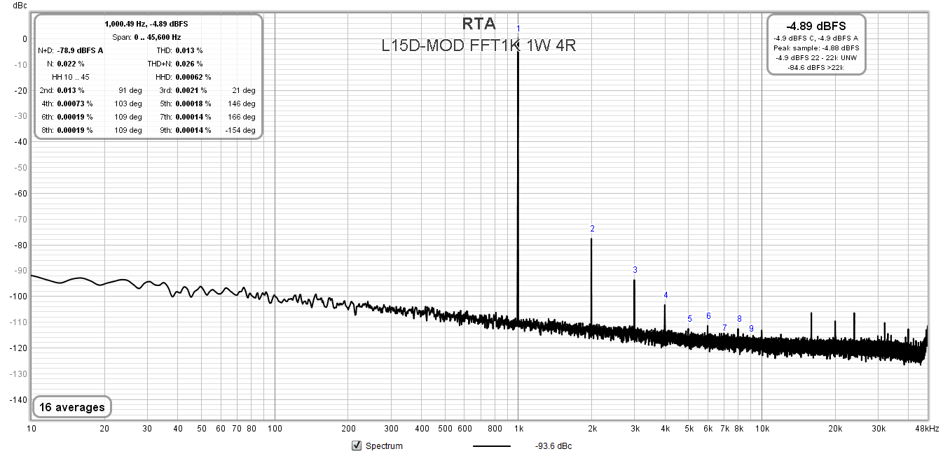

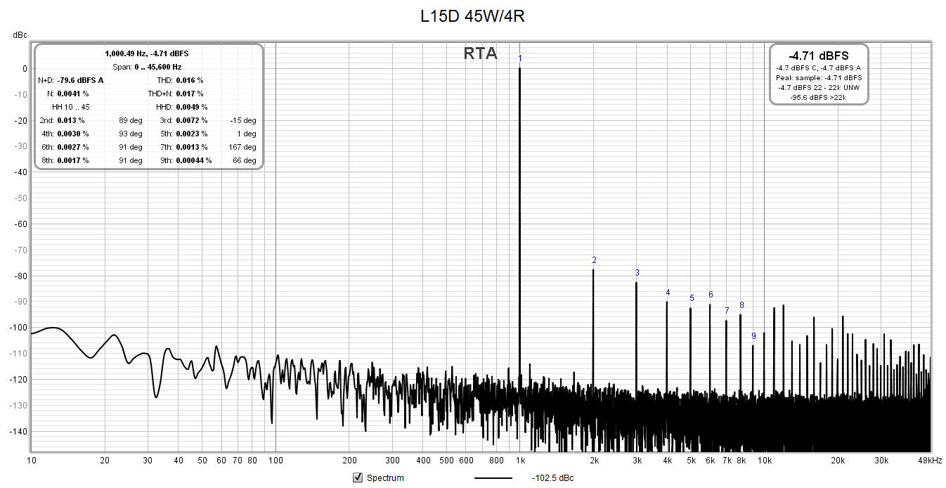

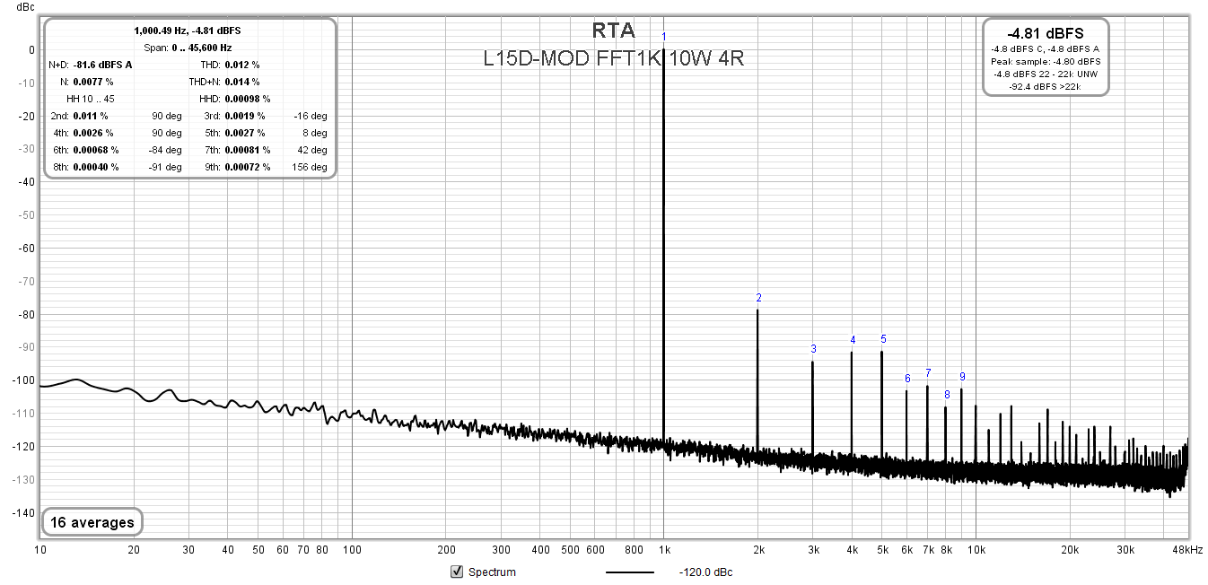

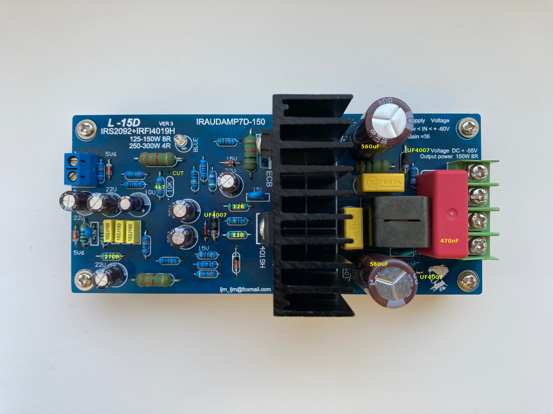

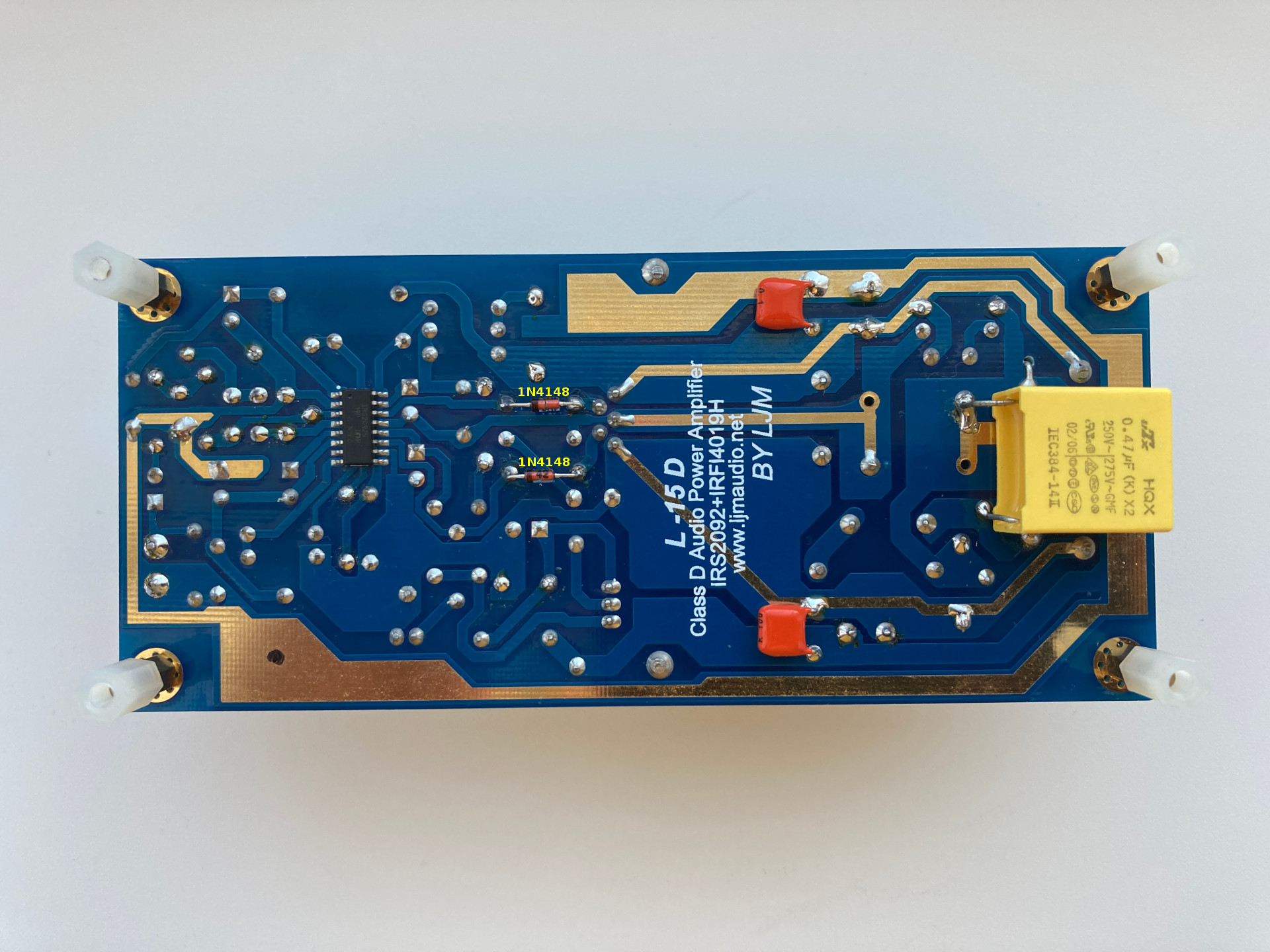

"What, exactly, is your modding?"
* osc freq 400kHz
* Dead Time = 25ns
* 12R base stoppers, 1N4148 parallel to them
* fast diodes UF4007
* doubled output capacitor
Is this mod to make it run on 2x48VDC?
